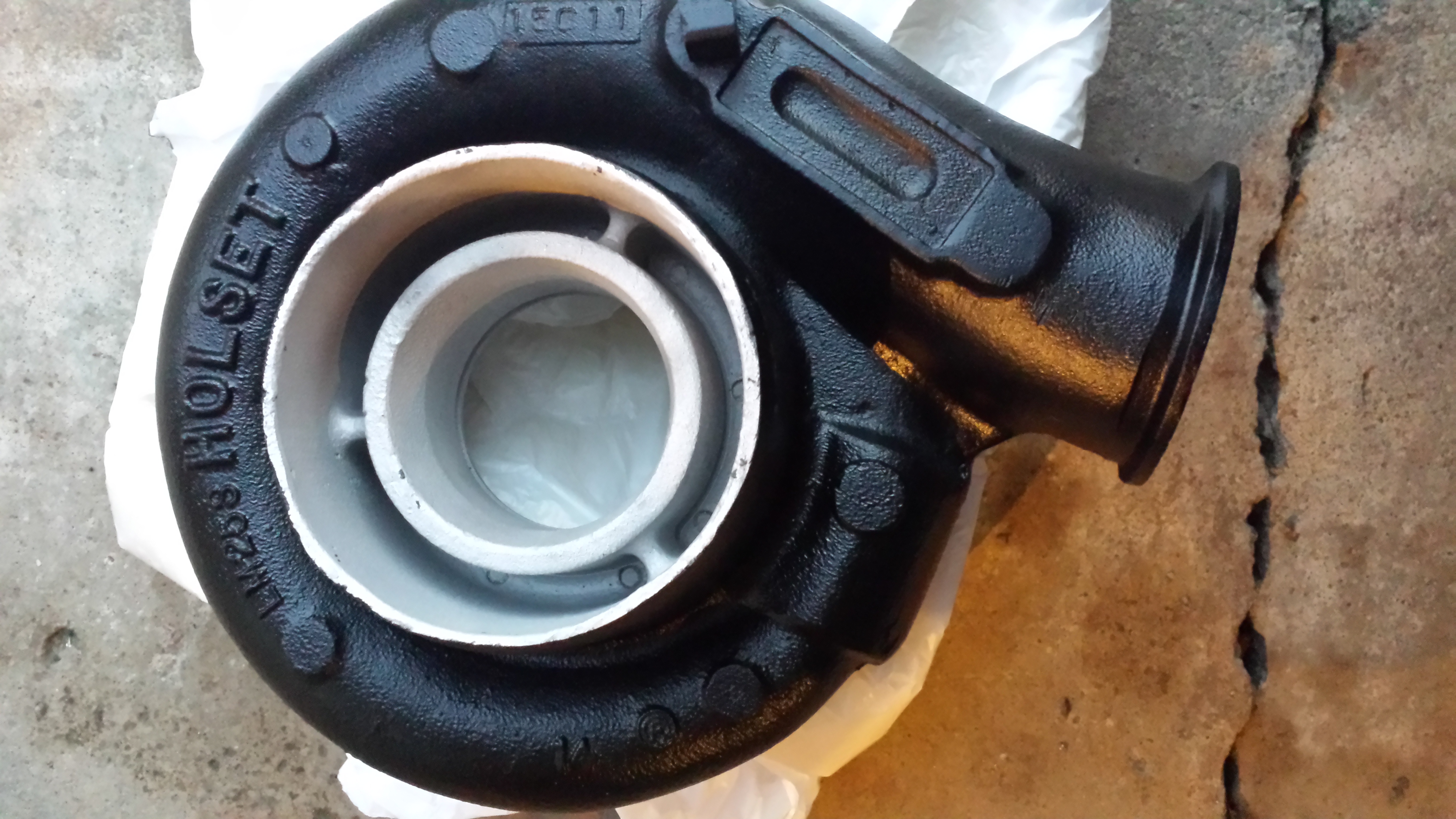

I haven't checked fitment yet. Should I be concerned that the OD of the smooth portion of the discharge pipe is only 2.5" OD vs the 3.5" OD of my current housing?
Am I crazy or did they sell me a 56 mm housing instead of a feckin 54 like he said he would? That's a big gap! :bangshead:
It only fits with the huge oring on the housing to prevent clearance issues with the compressor wheel
Whoa wtf?!
1.971 inches =
50.063 mm
That's my inducer blades measurement. Tiny?
Need moar turbz
WTH is this mutant turbo?
I don't get it. I never read anything about an HX35 being this small :nuts: Now I'm wondering if I should keep the compressor housing so that I can upgrade the compressor wheel to fit it. I have no idea if that's possible tho as there's no info easily found about modifying this small hx.
Anyone have any knowledge to bestow?

Kudos to goldfarb. Sending me the correct housing for shipping alone. "I thought it was the smaller wheel (54), not the SMALLEST one." It's official, everyone. My turbo has micro-penis. FECK!
I feel like I just wasted alot of time and money rebuilding a turbo that is the most undesirable one available! If I put in a 54 mm the DP would probably connect too far forward or backward.. looks like I'm sitting tight on this one.
The incoming housing has the groove/webbing with the same dims as this one they're letting me keep. Can't say I'm excited but at least this turbo won't run out of breath and is a full 1/4" larger inducer than the hybrid. Feel like G&A duped me tho

What I find strange is I'm pretty sure that 50mm hx35 has a 7 blade wheel instead of 8 as I have

In a major stroke of bad luck.. they can't find a housing with the groove so it's a "have not" now. They're refunding me for the housing.
Instead now I'm having him check for the correct go##am 54 mm turbo core I originally wanred. Looks like I'll have to buy the fu##er and do this all again. This is so disappointing.

Lol I just slipped and fell on my back on icy concrete steps hard. BUT... G&A can have a 54mm HX35w for me by Wednesday for a good price. Maybe I should take it. Would need to use my hotside for it they said

That 54mm HX35w is on the table for $150 (for me to buy I mean :D ) but I haven't confirmed I want it yet. An extra 4 mm :we:
