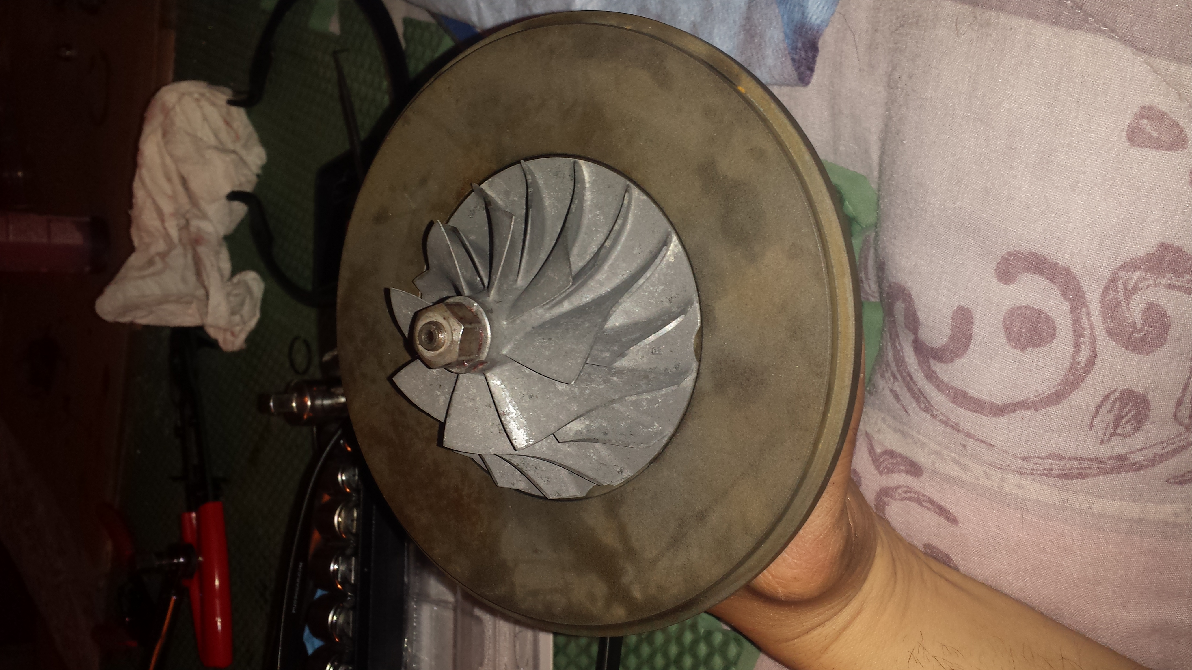

Short of taking it back to the bead blaster guy, what would you guys do with minor surface rust on the inside diameter of the front of the chra. It's not on the inside past the thick oring but towards the comp wheel.
Actually there's some surface rust inside the chra but not where the moving assembly lies (whew!). I'm afraid to address the first area as I'm worried about scuffing where the oring would sit and the second area I just haven't decided how crucial it is.
Light sanding (fine grit) shouldn't hurt anything. Or you could get one of those laser rust blasters.
I remembered I had krud kutter for rust removal that I had sitting around for a couple years from a failed attempt as using for body work. I let it soak all morning and it wiped out ALL the rust internally. Freakin awesome stuff when let sit awhile. I was going to sand later but no need now :D

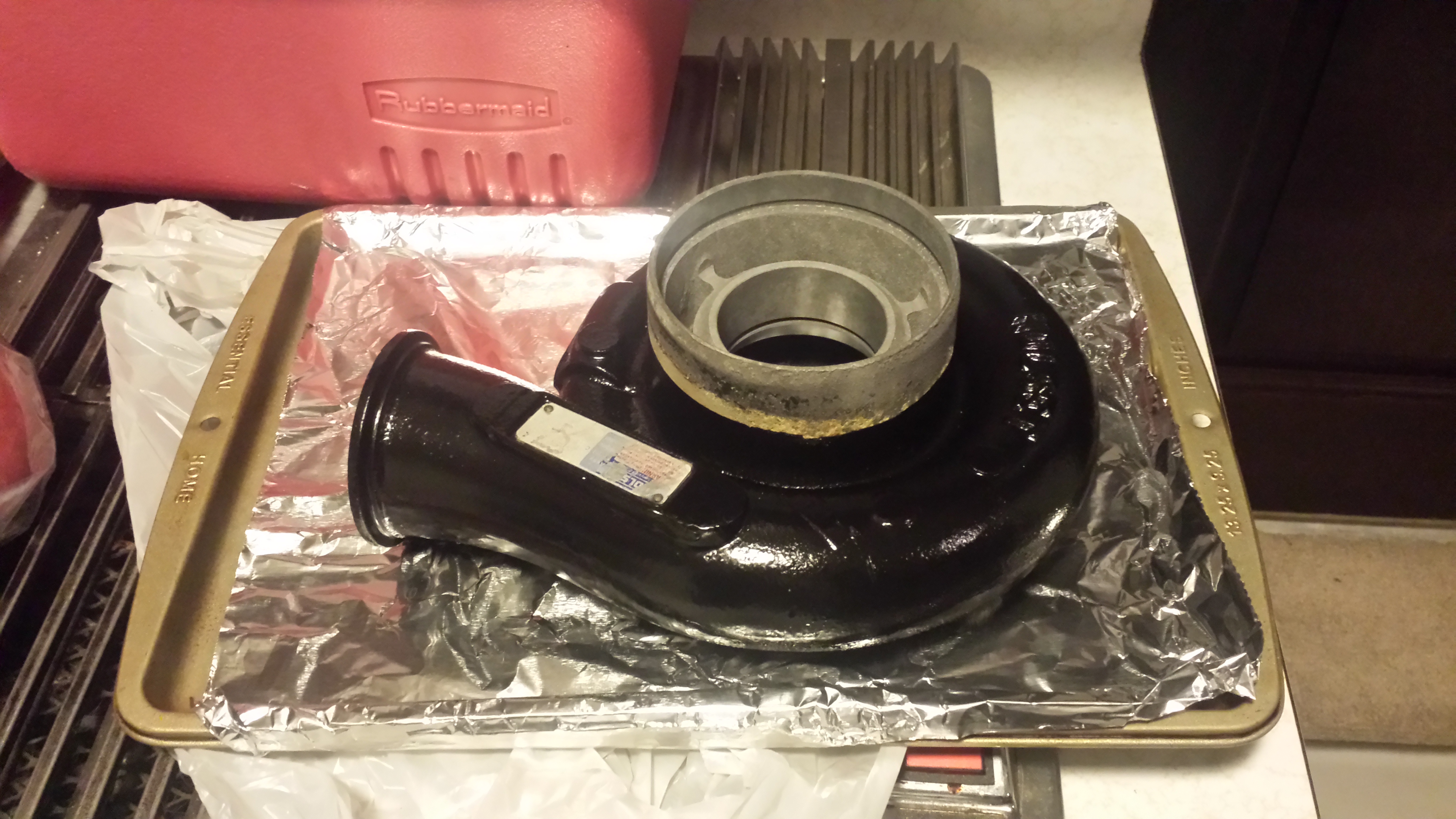

Cookies anyone? I've since painted the remaining snout area and cooked again. Turned out ok I guess for afterthought.

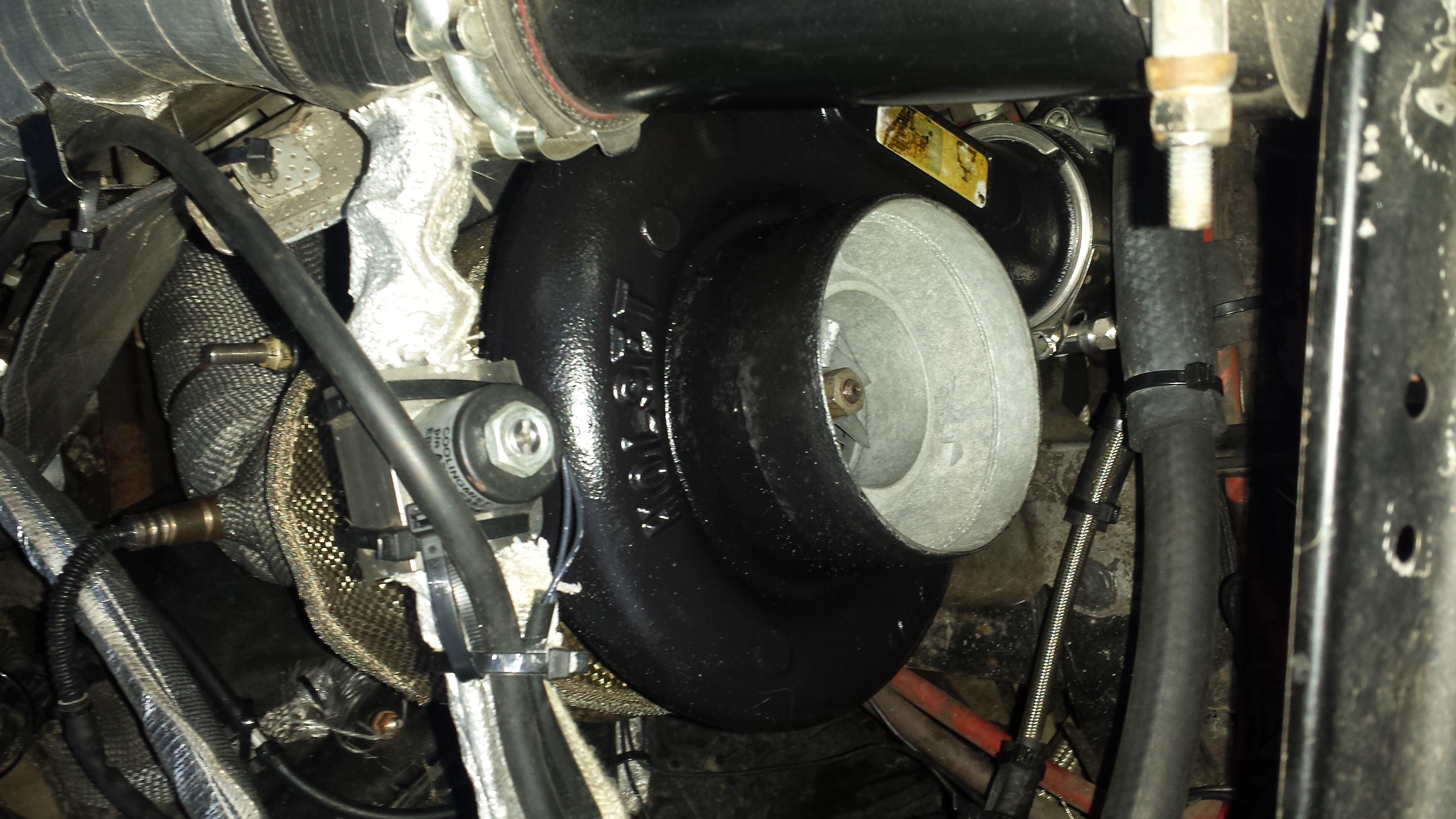

Ok so I finally got this menacing fu##er installed. It SOUNDS beautiful. I am not seeing a difference in lambda values tho. I really thought I'd go more lean with the switch. I like it so far.

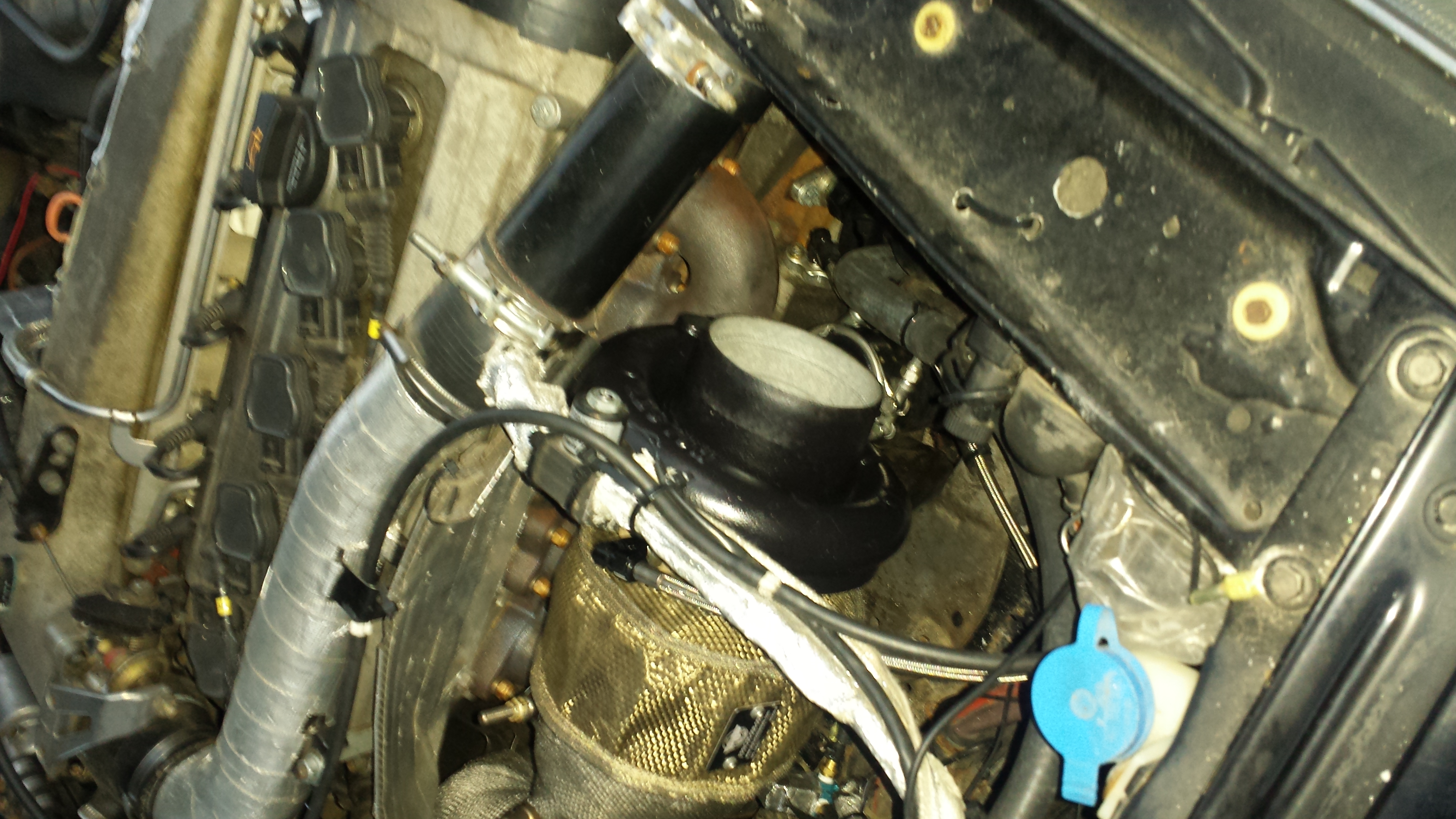

Before:
After:
Now... retune AGAIN!

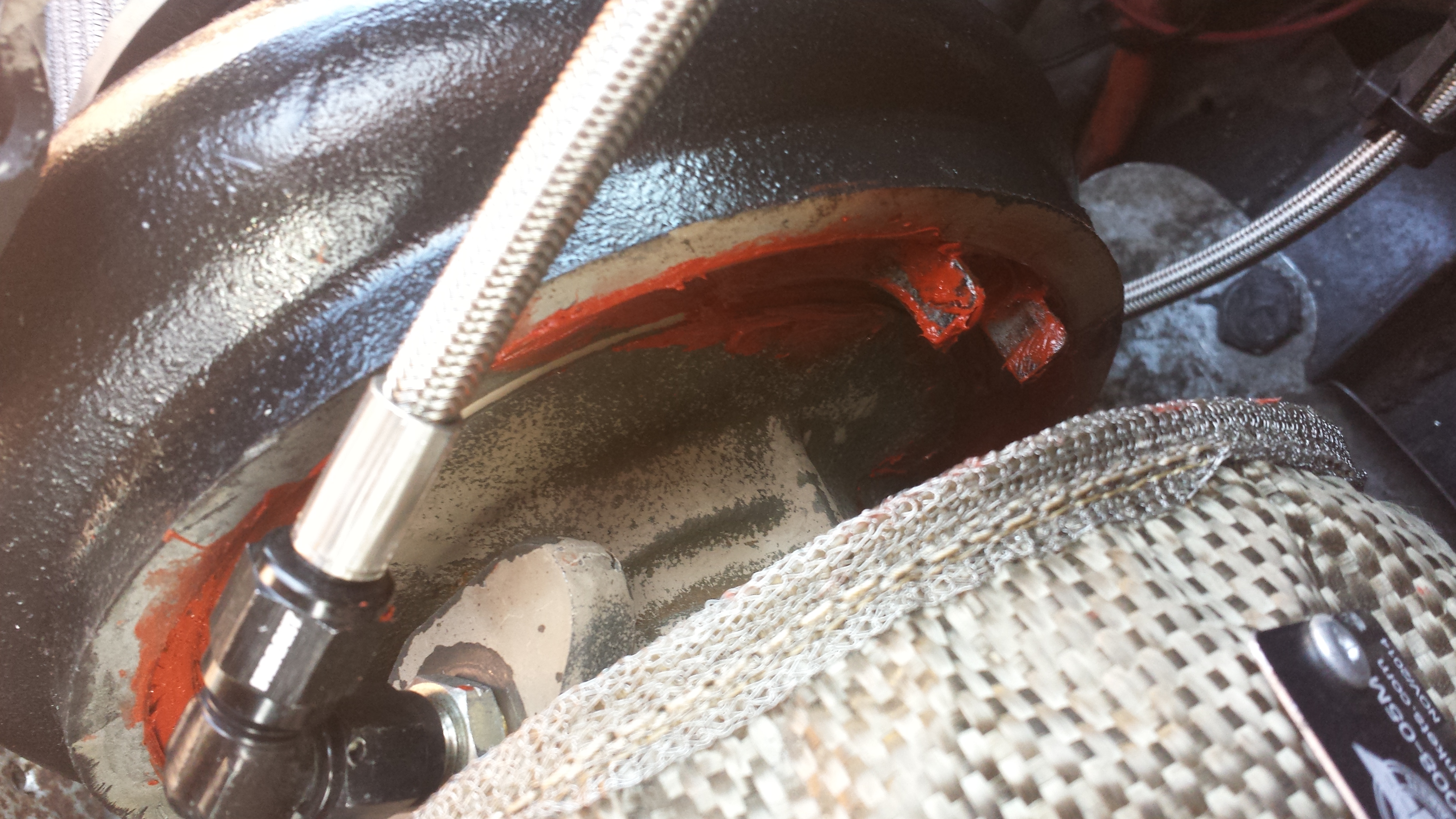

Sealed this extenally in case I need to remove in near future. Supposedly helps spooling?
It would help spool if there was a leak there
I was seeing lots of "perspiration" marks I guess it was. Looked like it was bleeding through from the seam. Hopefully it was worse than that and the effort to silicone pays off more
