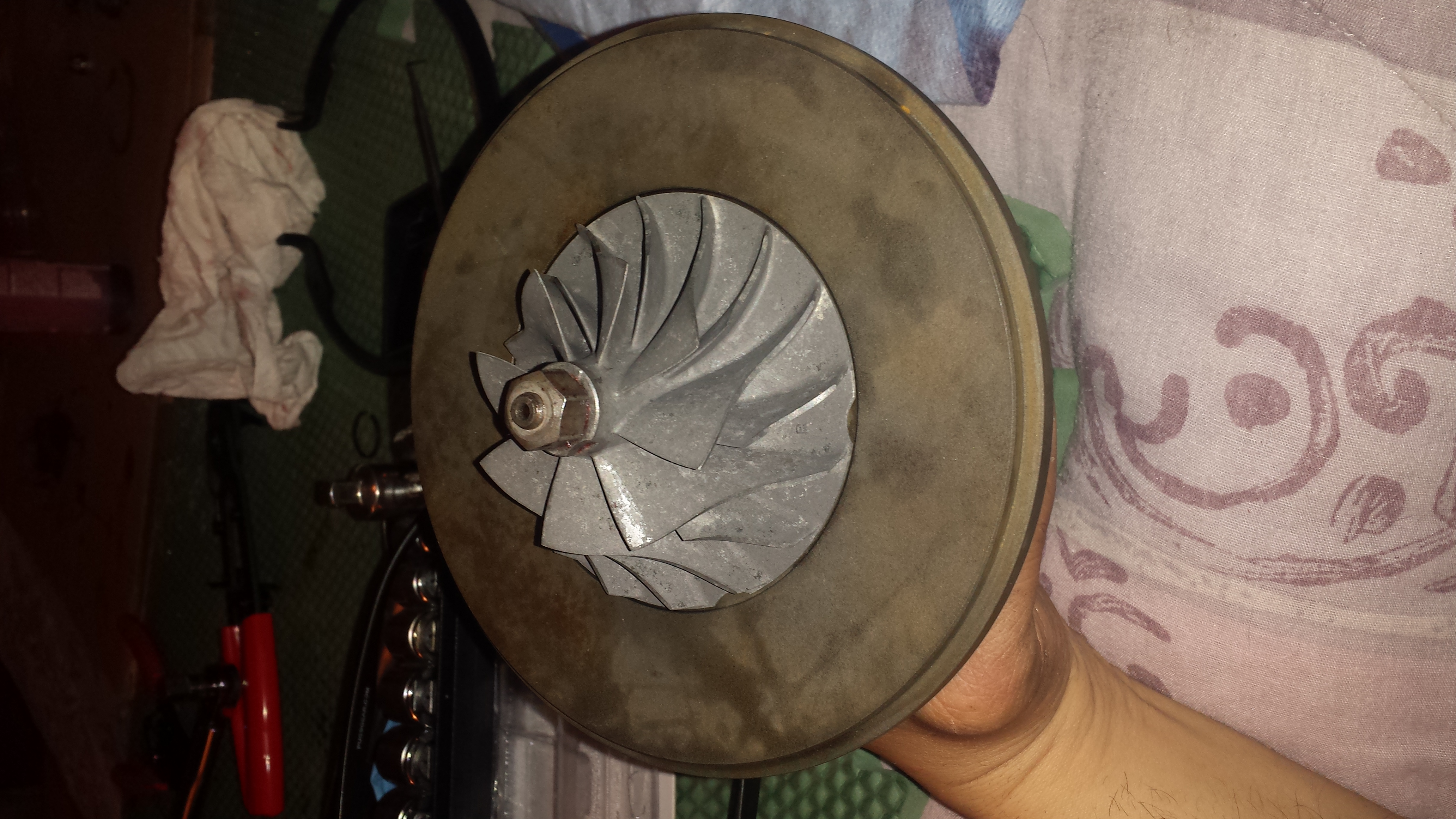

Short of taking it back to the bead blaster guy, what would you guys do with minor surface rust on the inside diameter of the front of the chra. It's not on the inside past the thick oring but towards the comp wheel.
Actually there's some surface rust inside the chra but not where the moving assembly lies (whew!). I'm afraid to address the first area as I'm worried about scuffing where the oring would sit and the second area I just haven't decided how crucial it is.
Posted: Mon Apr 11, 2016 10:42 pm
Light sanding (fine grit) shouldn't hurt anything. Or you could get one of those laser rust blasters.
Posted: Tue Apr 12, 2016 12:16 pm
by 88a5tq
I remembered I had krud kutter for rust removal that I had sitting around for a couple years from a failed attempt as using for body work. I let it soak all morning and it wiped out ALL the rust internally. Freakin awesome stuff when let sit awhile. I was going to sand later but no need now :D

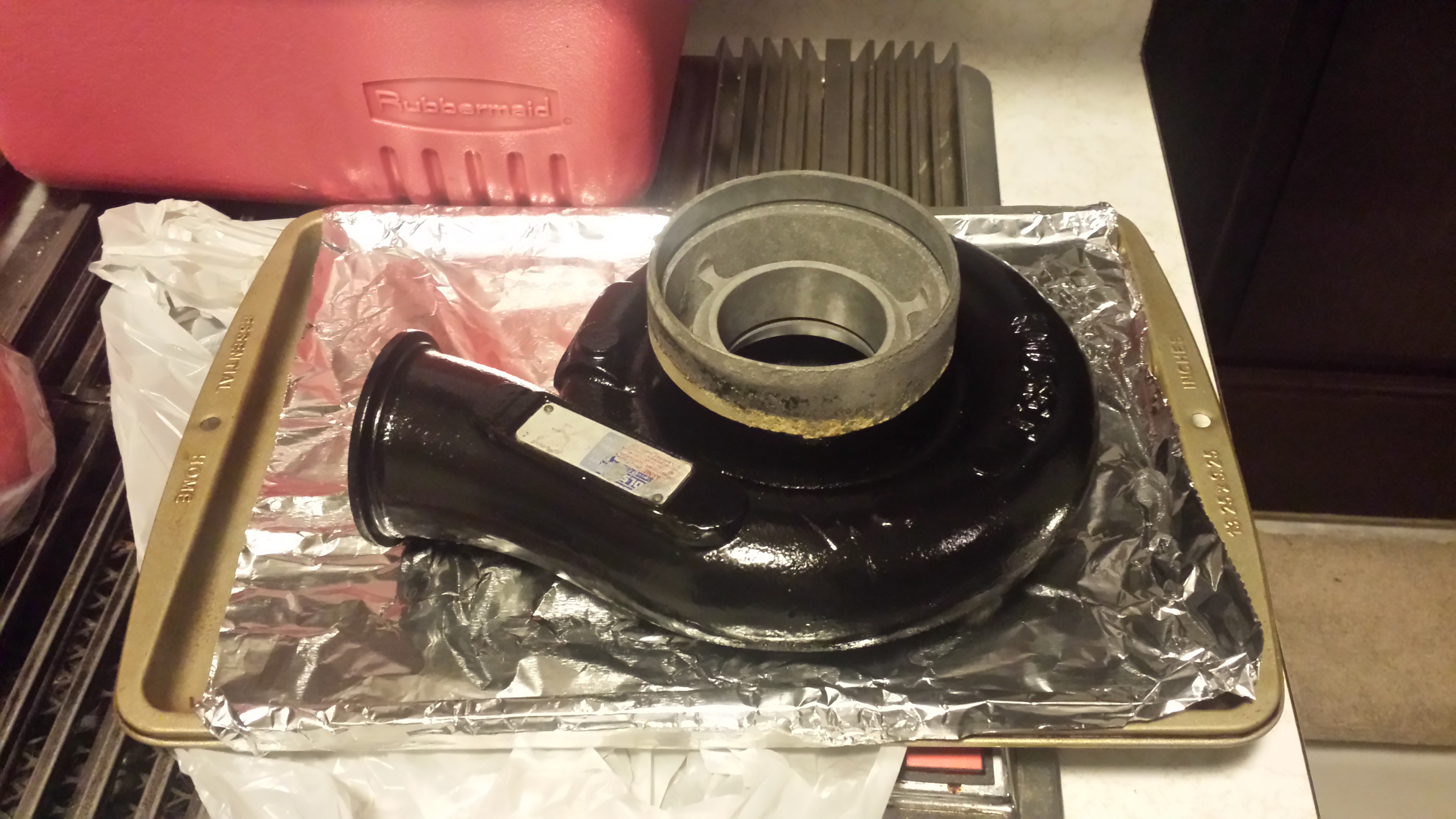

Cookies anyone? I've since painted the remaining snout area and cooked again. Turned out ok I guess for afterthought.

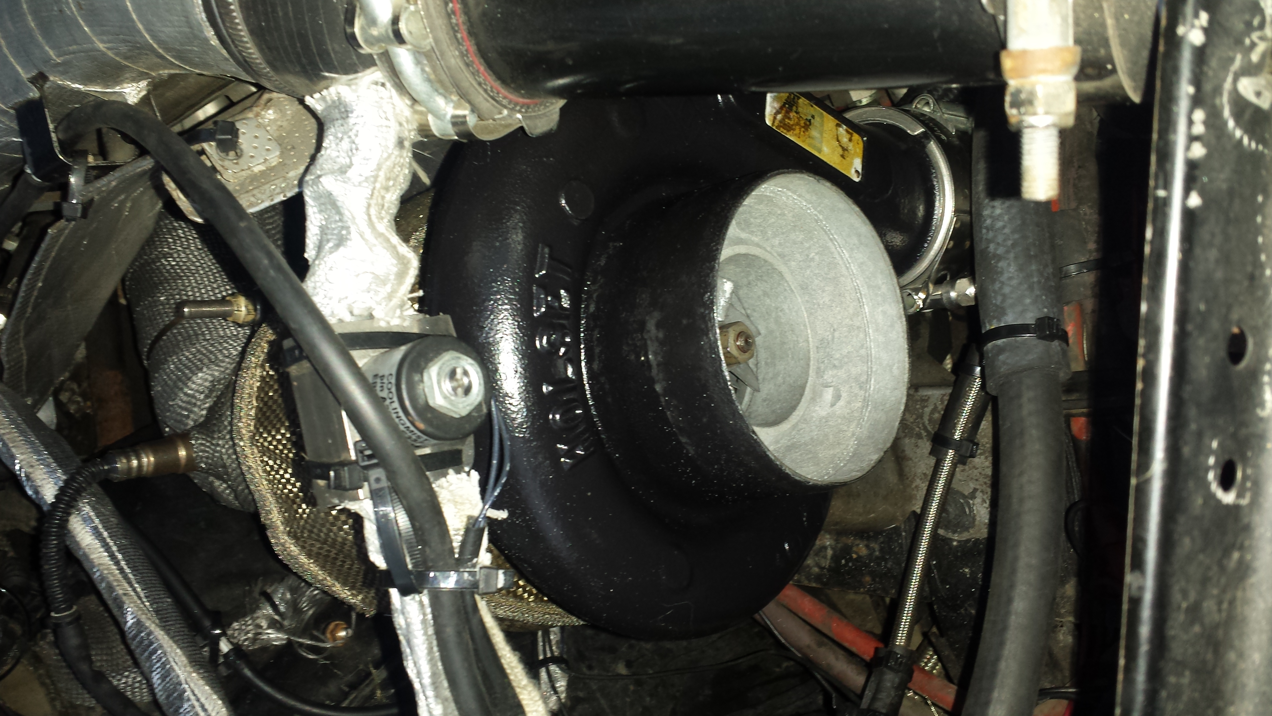

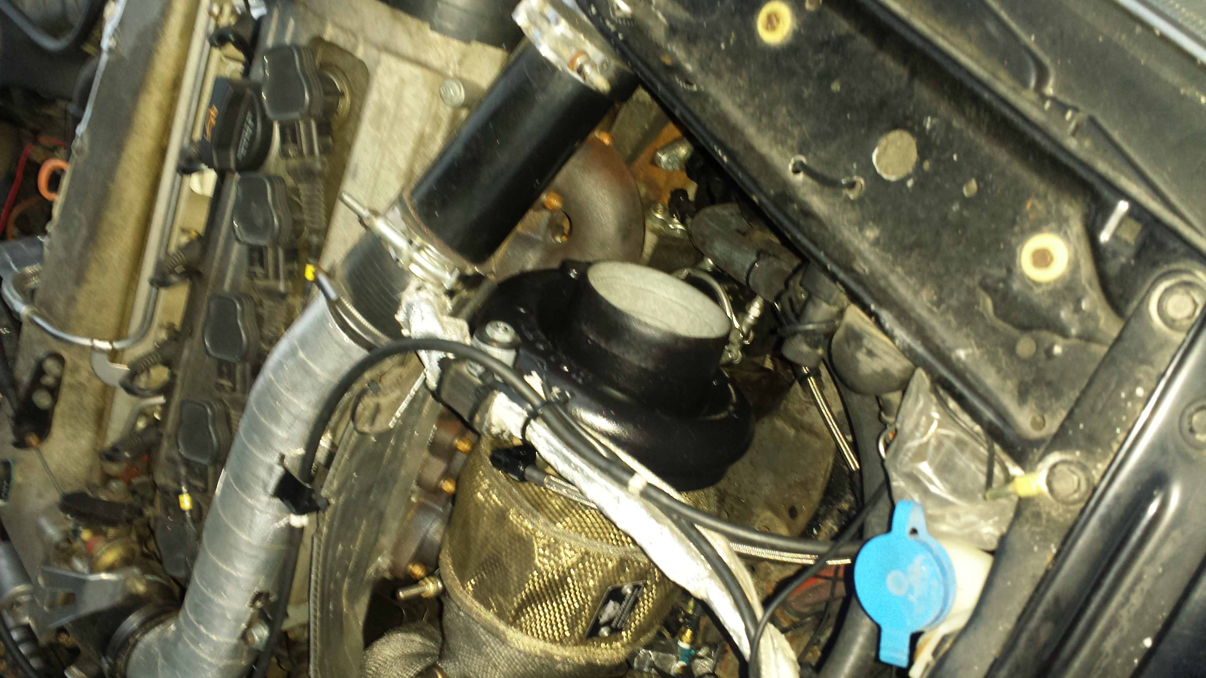

Ok so I finally got this menacing fu##er installed. It SOUNDS beautiful. I am not seeing a difference in lambda values tho. I really thought I'd go more lean with the switch. I like it so far.
I took the old holset out for its farewell bearing and almost took flight at a right turn yield area near a HEAVILY congested intersection. It was freakin awesome! And yes, I was the only one in danger lol. The other cars were well away from me and nobody was in my area so I just tore it up at 27 psi.
About 5 mins later I get a text from my college car enthusiast buddy who lives out of state. His mother knows my car sort of, saw the huge turbo recently and called it a sleeper a weekend prior. She asked him if it was me screaming down the road in a black car earlier. She said it was crazy lol.
An hour later I'm ripping out the turbo and she texts him again saying "I think they're looking for him cuz there's a speed trap and lots of cops lol."
So I went back up in the car and asked the police who they were looking for in person like an inquisitive ass bahaahha! No I'm kidding but also easily amused :D
Just thought I'd share :)
(Also I made that very detailed story up :hide: )
Before:
After:
Now... retune AGAIN!

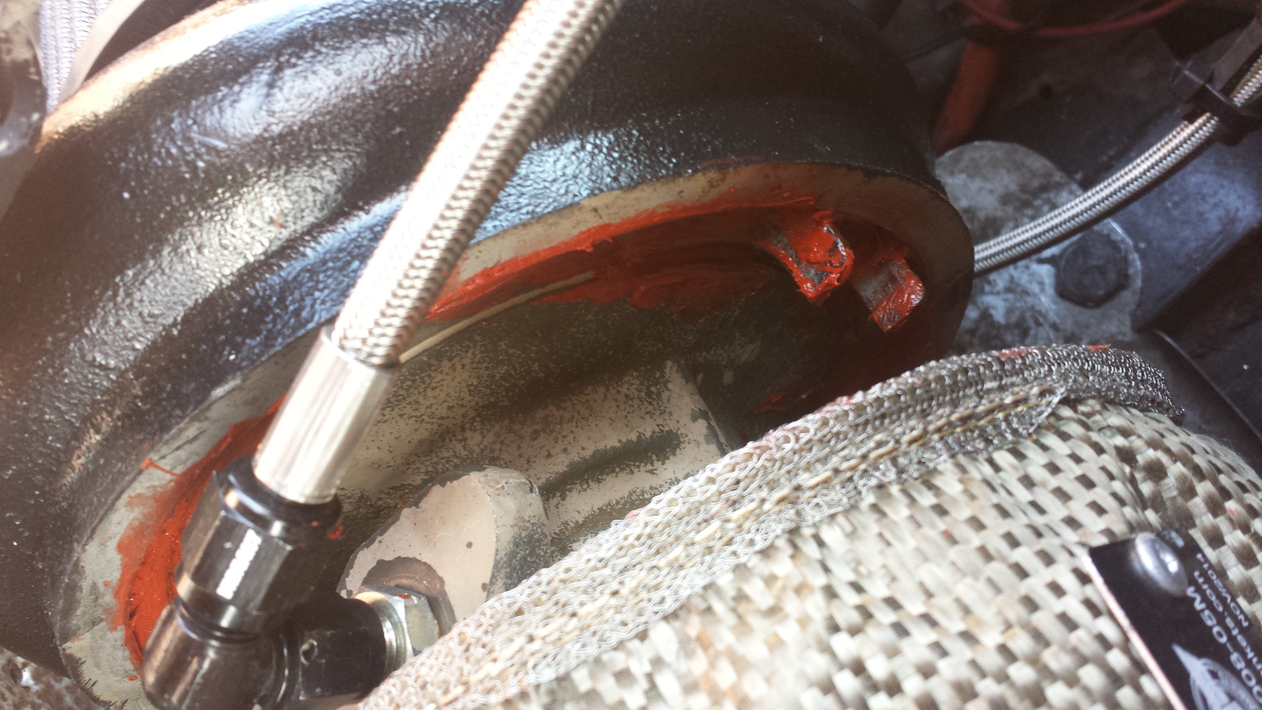

Sealed this extenally in case I need to remove in near future. Supposedly helps spooling?
Posted: Wed Apr 20, 2016 5:08 pm
It would help spool if there was a leak there
Posted: Wed Apr 20, 2016 6:34 pm
by 88a5tq
I was seeing lots of "perspiration" marks I guess it was. Looked like it was bleeding through from the seam. Hopefully it was worse than that and the effort to silicone pays off more
