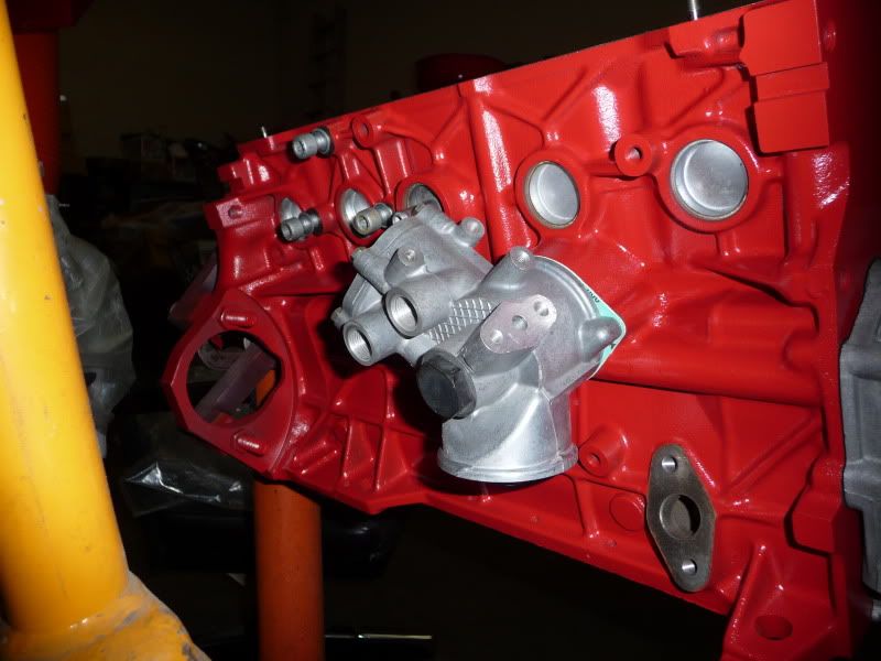

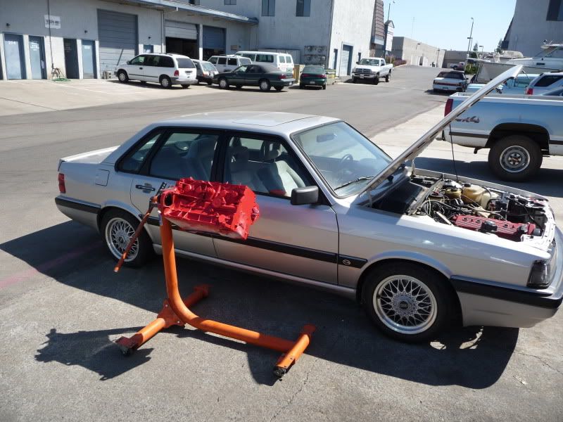

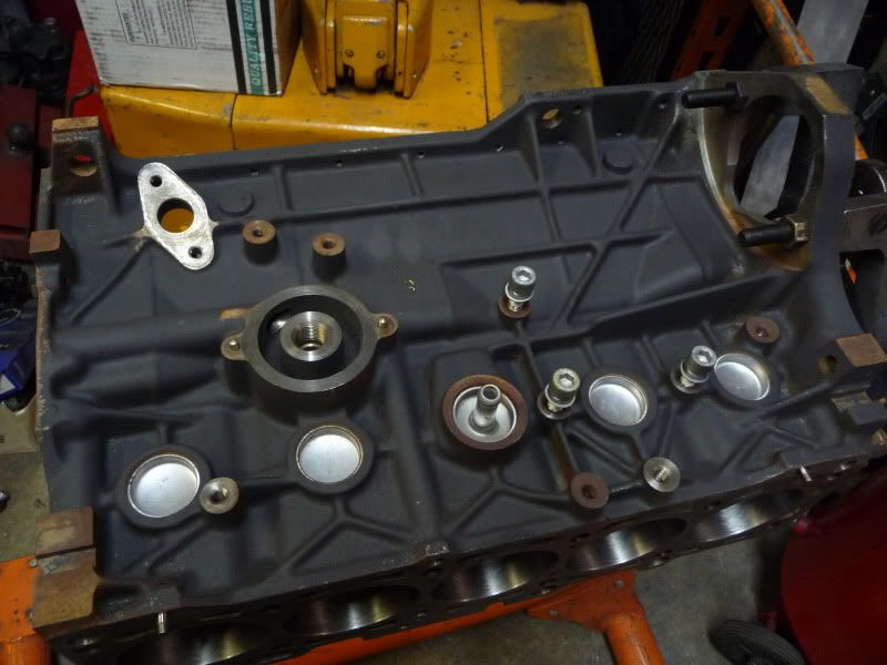

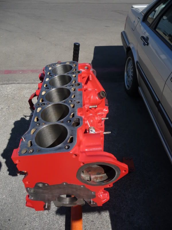

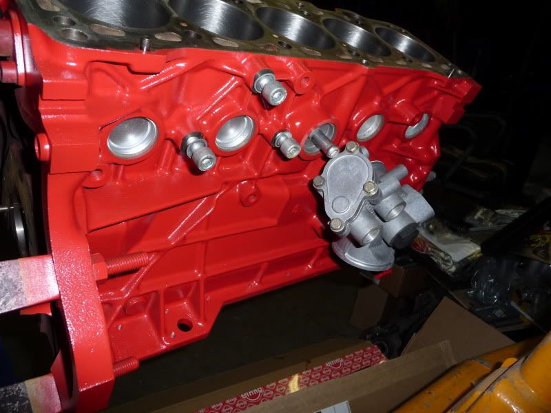

engine build numero two-oh. i got an absolutely minty mint, mint mint mint 3B block. the bores are absolutely perfect, line bore is perfect, no corrosion inside the block, all surfaces perfect. harvested from a 130k mile 200 20v that had been hit in the front.
i am still in awe that the cylinder liners look like this... i've never seen clean ones before.
i'll be transferring the rotating assembly minus pistons (i have the ones from this block), new rings (finally), a windage tray, possibly a crank scraper, possibly a custom oil control grid in the pan, all the ARP hardware, etc into this block, fix the bent valves in the head, install the HD valve springs, finish port matching (which i somehow forgot the first time around), and then the engine work should be done...
