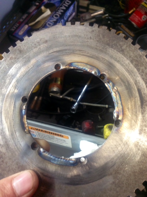

There are several issues w/ the 60-2 trigger wheel setup on the crank pulley.
To me, the biggest issue is the wheel is attached (via bolts or weld) to the "stationary" non-isolated piece of the pulley, and then the outter ring is left to isolate as it should. The issue that arises here is that there isn't enough clearance between the 60-2 wheel and the portion of the pulley where the belts ride. So when you're running the motor at various RPMs, the vibrations of the belts/motor/etc will cause the outter portion to deflect, and (from what I could tell) cause contact to the 60-2 ring. So regardless of whether its welded or held on w/ the tiny 2mm screws they used, it's only a matter of time until you fatigue the connection point and cause it to break.
I had this setup fail twice on me at the track... one year apart. The first time the machine shop was able to redrill and install 3mm bolts. The second time, the bolts snapped off again and sent the head of one through my timing belt. Thankfully, it didn't cause the timing belt to shred! But I had to bring it back to the SAME machine shop, and this time he welded the %hit out of it.
I think there needs to be two things done on those pulleys. One, machine away more material from the outter/isolated portion of the pulley to give more clearance between it and the 60-2 wheel. Two, BALANCE the pulley assembly itself and make sure there are ZERO deflections when run at varioius RPMs WITH the 60-2 wheel permanently attached. Obviously this won't isolate the different stresses that are put on this once belts are tightened on, but it'll help... at least in my mind, though it's been a few years since I've dont any of this since graduating college :-P.

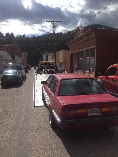

So I limp the car into Idaho Springs. I was just sure the car was running too rich at altitude. What else could have been so perfectly and coincidently paired to the quick climb up to 8600ft after cruising on the highway for 700 miles?
The car's final landing place just behind the library in the tiny town of Idaho Spgs. After walking back and forth across town (1 mile each way) (no less than 7x) to the local, price-gouging autoparts store, I settled upon the conclusion that;..

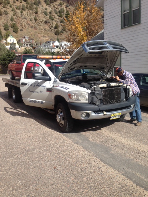

Day 3 stuck in Idaho Spgs. I wake up and decide its time to admit defeat and call for a tow. My insurance won't pay to tow it 200 miles home because there's a perfectly good Audi dealership in Denver only 50 miles away. Sweet, and not really helpful.
That was the first phone call of the day. Then something happens and I lose cell phone coverage. So does the rest of the I-70 corridor from Georgetown to Denver. Apparently they decided to service a major powerline or tower and the ENTIRE town of Idaho Springs lost connectivity. Every business immediately went to cash-only sales. There wasn't a single internet signal, landline or cellular device that was operational anywhere in town. Then I found a coffee shop that was apparently the only wifi signal anywhere within 30 miles and the entire town converged upon it. I gained the ability to text but no phone calls or even skype.
Not really helpful while waiting for a tow truck driver to call me back to set up the tow. Good grief, at this point I started to believe that the Audi was a bad omen. Remind me again why I like old cars? I've been on a roll for the last 6 months of old-car ownership...
Luckily I was able to call upon my new friend Dace to not only coordinate the tow but coordinate a shop other than the stealership to tow the vehicle to. Tow truck finally shows up and its such a relief. Then this happened. No shite. The tow truck's 4 wheel locking brake system decides not to release. Not only that but the truck has a coolant leak. I could not be making this up, for reals. Really?
Not really helpful while waiting for a tow truck driver to call me back to set up the tow. Good grief, at this point I started to believe that the Audi was a bad omen. Remind me again why I like old cars? I've been on a roll for the last 6 months of old-car ownership...Luckily I was able to call upon my new friend Dace to not only coordinate the tow but coordinate a shop other than the stealership to tow the vehicle to. Tow truck finally shows up and its such a relief. Then this happened. No shite. The tow truck's 4 wheel locking brake system decides not to release. Not only that but the truck has a coolant leak. I could not be making this up, for reals. Really?

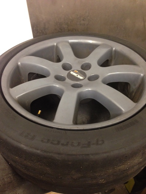

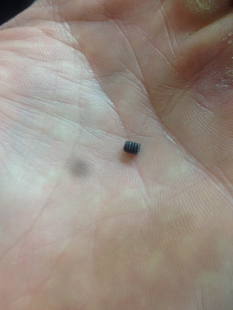

So late in the day we finally arrive at our destination. Enter Apikol. These guys are amazing. I'd heard of them and have even ordered parts from these guys but somehow had no idea that they were in Boulder. If you need service done on your car and you're in the Rocky Mtn region, check these guys out. Troy and Doug are awesome dudes and are genuinely interested in YOUR problems. As soon as I walked in I felt at home. Little did I know, Doug and I are acquaintances from way back in the days when he was racing mtb's. Cool. That's my peeps.

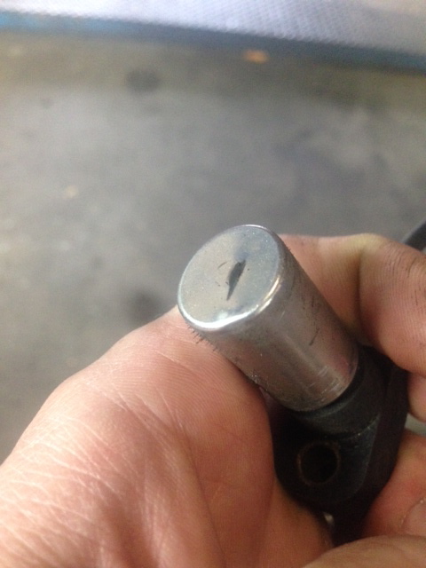

So after troubleshooting the car for about 3 minutes and finding that I'd gone from a weak-spark situation to no-spark, we (Troy) discovered that the 034 trigger wheel was now completely detached from the pulley. Ok, now it was all starting to make sense.. Apparently the miniscule .00000000001mm bolts had somehow managed to shear off
. 034 has never heard of this happening but on a positive note, they ARE now for some reason producing a "Now Improved" version of their product that has never failed.
I believe the wheel started coming loose, as evidenced by the groove worn into the CPS sensor. Anyway, didn't have much choice but to have Troy work his magic and re-attach/weld the wheel to the shitty potmetal surface of the crankpulley with absolutely no guarantee of how long it'll hold. Well, it held long enough to get me home and may well hold up for the rest of time? I'm investigating a better solution until that time comes.
. 034 has never heard of this happening but on a positive note, they ARE now for some reason producing a "Now Improved" version of their product that has never failed.I believe the wheel started coming loose, as evidenced by the groove worn into the CPS sensor. Anyway, didn't have much choice but to have Troy work his magic and re-attach/weld the wheel to the shitty potmetal surface of the crankpulley with absolutely no guarantee of how long it'll hold. Well, it held long enough to get me home and may well hold up for the rest of time? I'm investigating a better solution until that time comes.

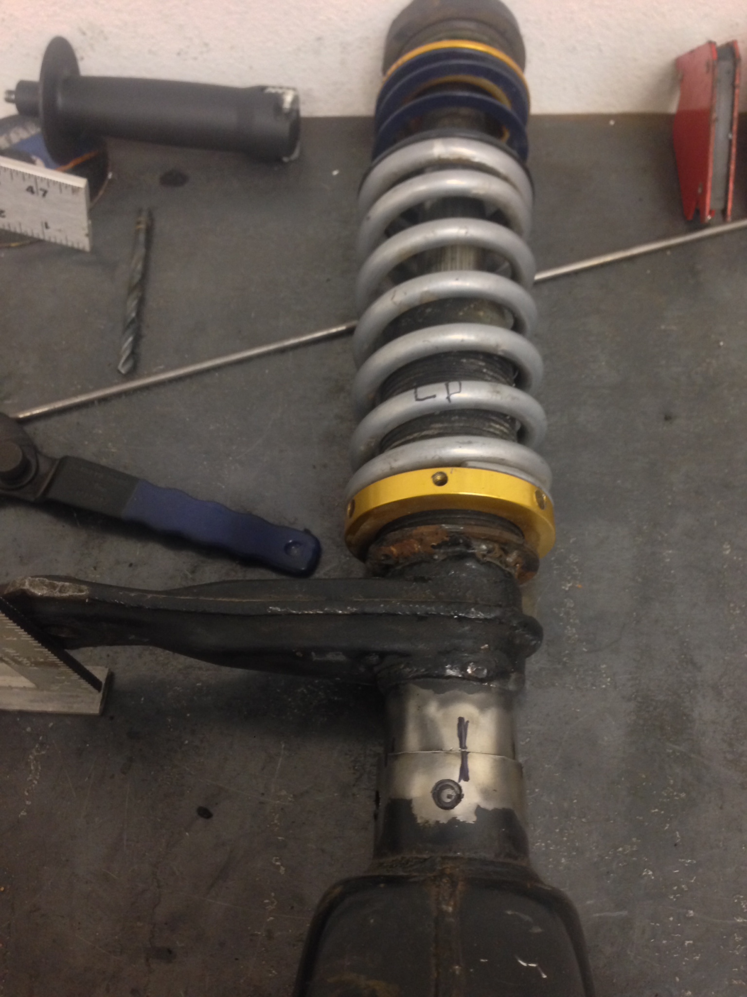

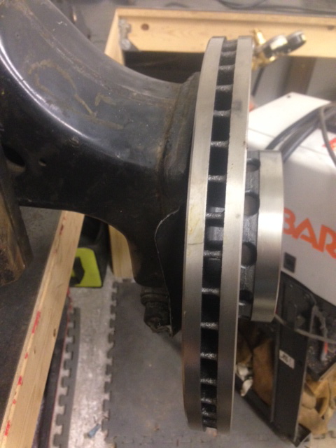

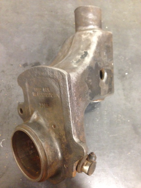

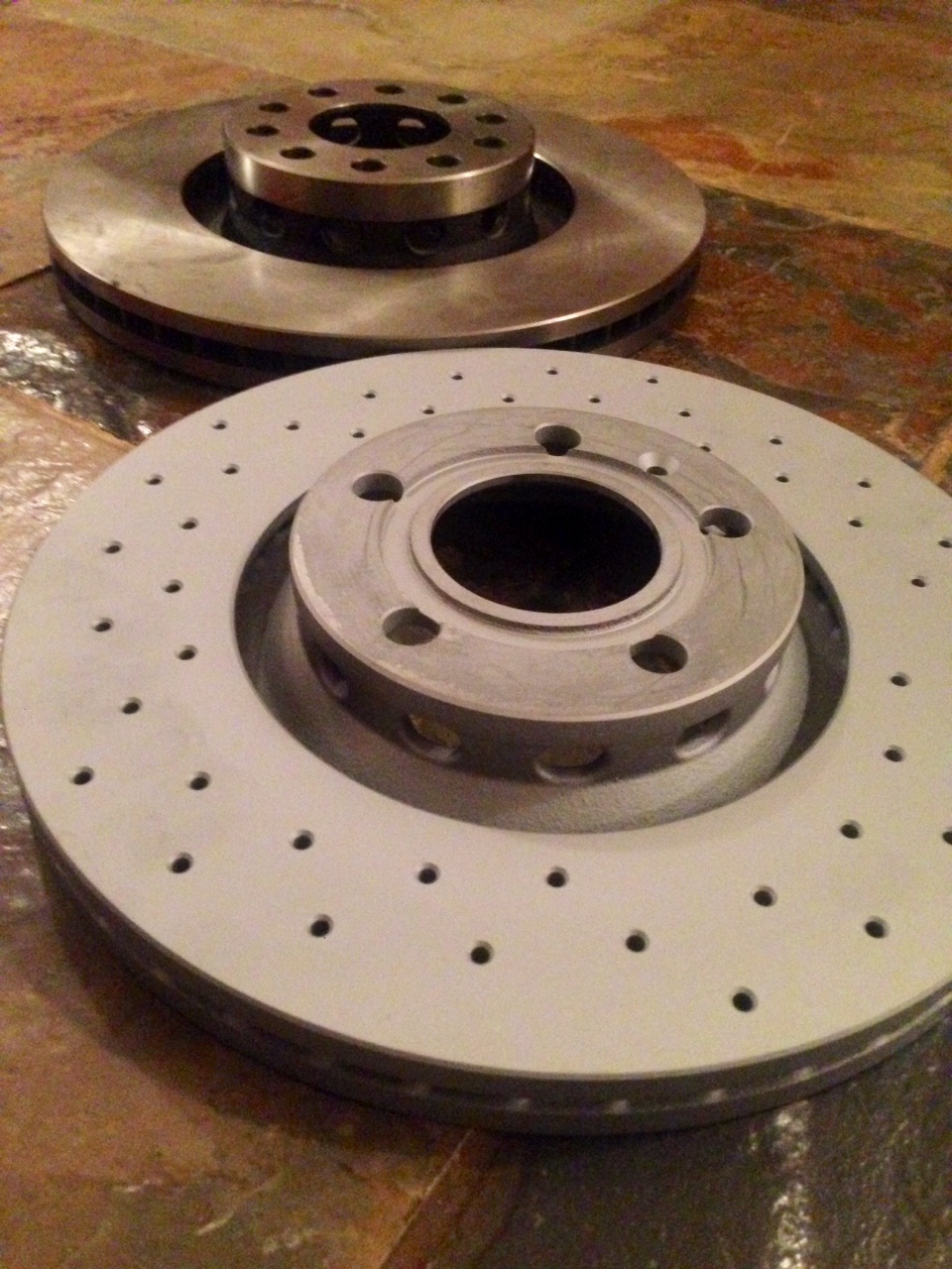

Ok moving right along. I got home without a hitch, massive thanks to all the kind people that helped me do so. You guys are awesome, the community is so great.
I got home from the hellacious return home and drove the car for about a week. Even before the launch control novelty had worn off, I had the car on the lift and torn apart. I couldn't help it. The car was scary without real brakes. Upon returning home I started compiling the list of parts necessary to not only install the 993 BBK onto the 4000, but do the 5 lug conversion outlined in several places on this forum. I sourced a pair of URS4 uprights, Audi 200 (auto) front hubs, new wheel bearings, 5 bolt hubs, 19mm ball joints, MK2 tie rods, 4000 rear axles, etc, etc...
Unfortunately, the shop that was pressing the new wheel bearings/hubs into the housings, messed up and pressed the old 4 bolt hubs back in. In the process, the brand new wheel bearings were obviously ruined while being pressed back out. They made it right and ordered a new set of wheel bearings for me but this set me back another week.

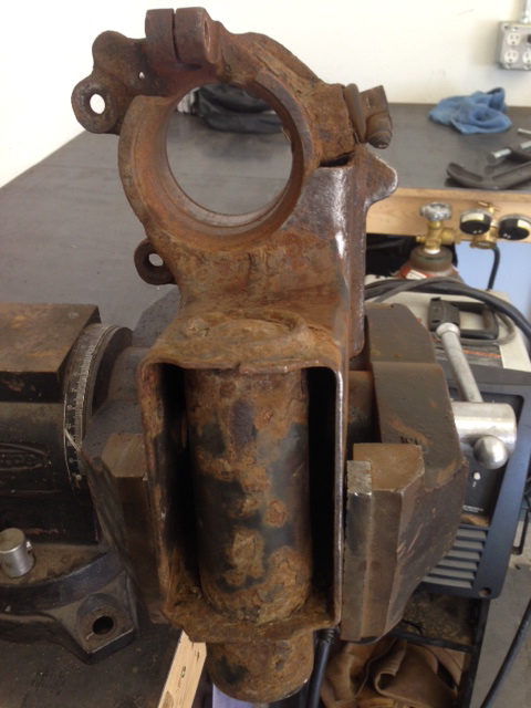

So here are a few pics of the progress. I chopped the URS uprights and cleaned them up a bit. Once housing was just nasty with corrosion so I cleaned it up with the wire brush wheel and my media blaster, then primered and rattle canned it black. It'll do for now. I also found that I had to work the inside of the URS housings with a brake cyclinder hone to get the 4000 uppers sleeved down far enough to be at the right ride height. I clocked the steering arms in about 1/4" from stock location and will slug weld them as done by those before me. I really wanted to retain the coilovers that the car had and also use the BBK that I got from Chaloux. So far so good but I haven't received the new wheel bearings so the project is on hold for a few days.

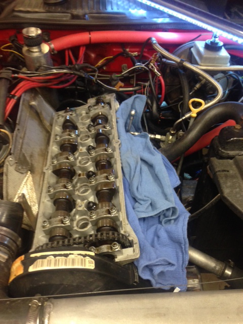

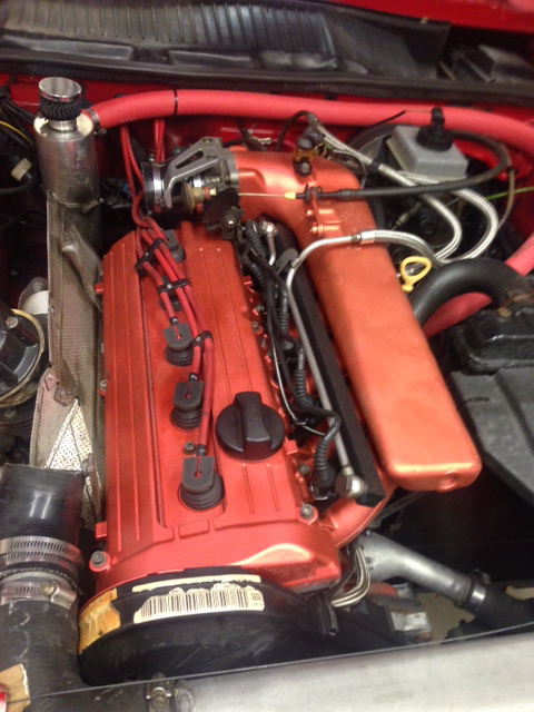

Then I decided, while the car is down, to do something about the horrendously, hideously, gawd-awful color of the rattled-canned intake manifold and VC. I just couldn't look at it anymore. No offense Matt, I know that's what you had in the garage. Run what ya brung and all that.
So I pulled the fuel rail, VC and Intake mani and have them off at my buddy's shop for powdercoat. That'll make me (and 4FoxSnakes) feel much better about ourselves.

The 323x30mm A8 rotors I initially ordered had the wrong offset (rotor height) and were not even close to being right. I measured the distance from the center of the hub to the outer limit of the 993 caliper and also found that I needed a 312mm rotor. I did some searching and found these Zimmerman Sport, c-drilled rotors with a 46mm rotor height as opposed to 60mm on the initial A8 rotor that I sourced. They just showed up today so I'll head to the garage tomorrow and check the fitment. I'm going to assume these are a go. I hope.
- photo 1.jpg (106.38 KiB) Viewed 38758 times
- photo-183.JPG (439.38 KiB) Viewed 38758 times

Re: 4 FOX SNAKES -
Plus the Zimmerman Sport rotors are 4lbs lighter, bonus. It'll help offset the weight of the Ronal R28's I'm hoping to use. These weigh 28lbs each, ouch! The SSR's on my E30 M3 weight 17lbs. The 4000 also has +100hp advantage over the M3 though so I guess its acceptable
- photo 3.jpg (97.95 KiB) Viewed 38755 times
