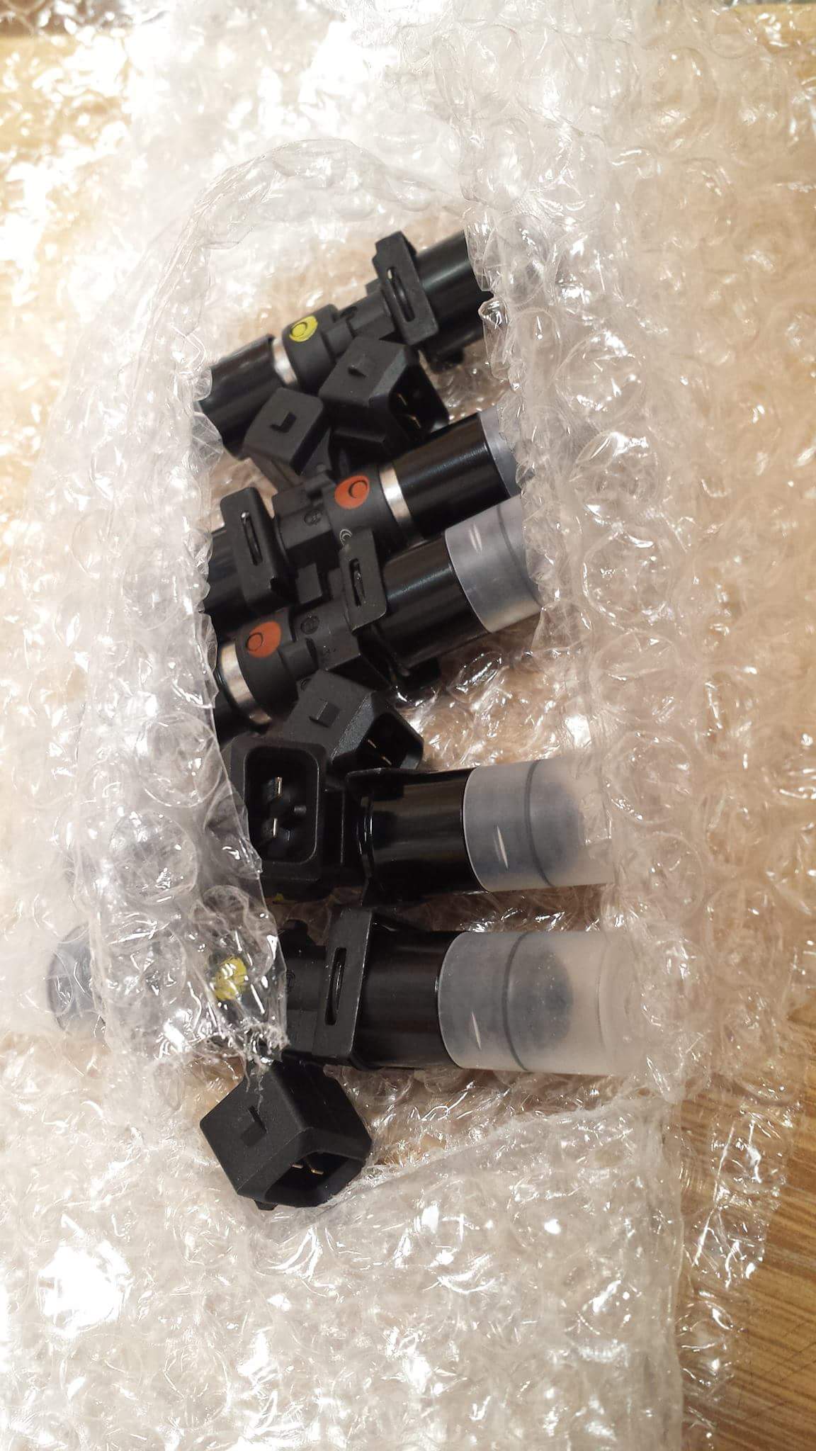

by 88a5tq
Eww Chris don't call me out on that lol! Now I'll have to change it hah.
Thanks guys it means alot to me :)
Guess what I DID! Chris helped too!!
THANK YOU CHRIS! Awesome deal man. They're in and I'm driving with the auto-tune going after I changed the e tire VE table to as close as possible judging by idle. Wooo! 1200cc FID injectors
