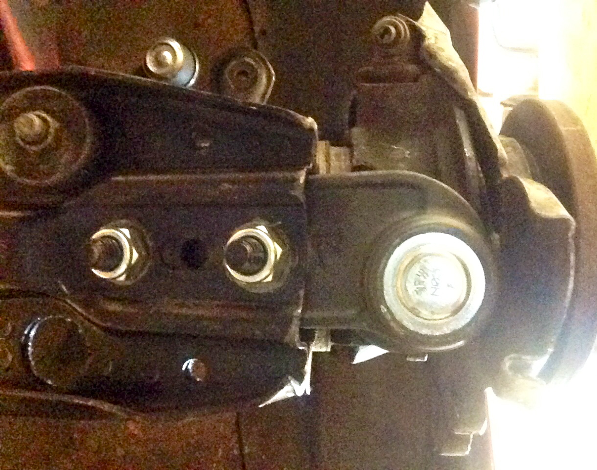

Well, I'm still not sure why mine are looking so centered. I actually have positive camber by +5mm. I just ran a level across the wheel well (at the level of the spindle) and made sure my measurement points were perfectly level and equal, and measured the distance from the center of the spindle to each point. Its exactly 350mm to the front leading edge fender measurement point and 355mm to the rear point of measure. That gives me positive caster. Truth be told, I cheated the ball joint a tiny bit forward before tightening the two bolts to achieve that. I angled it forward a few millimeters as you can see in the horrible cell phone picture I've attached. But cheating it forward that much only really relates to a few millimeters difference as well. So, what am I missing? I think I'm just going to put it together and see what the alignment expert says. It seems ok to my novice eye.
The ball joint reversal offset plus the existing offset of the pinch bolt location seems to be working ok. The struts are already welded and installed and its not that much work to remove them (save for another alignment) to revise if I absolutely need to, so I'm going to have it aligned and will report back. Still waiting on brake calipers from powdercoat though.

It could be that when I lower the car, the travel of the strut will cause that measurement to change a bit. I can't imagine it changing much though, that coilover assembly is so low and tight it doesn't hang that much.
ralleyquattro
Posts: 858
Re: 4 FOX SNAKES - Ross' 20vt 4kq
Post by ralleyquattro »
Hi Russ, we are talking about CASTER, which is a lot harder to measure without proper equipment.It is the angle between the lower and upper pivot point (ball joint head and upper strut mount center). It is measured by turning the steering wheel side to side on the alignment rack.

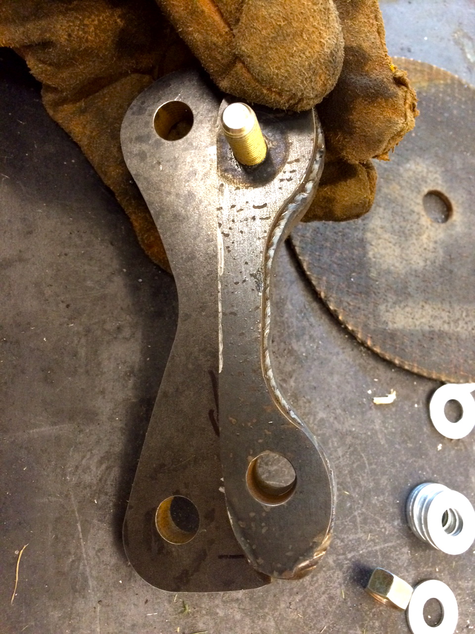

On the lines of braking :D , I happen to have a spare set of E30 M3 front brakes that from when I went BBK on that car. They've just been sitting in my garage for 2yrs so I decided to put them to use. I built custom brake caliper adaptors in order to run them on the back of the 4kq. I'm pretty happy about more braking on Chaloux's car. I read Ben's post and love looking at his Porsche BBK, front and rear, but I just can't justify the expense right now given that I have a pseudo BBK sitting in my garage. So now I have budget big brakes all around and the car has, lets just say, ample braking power. With R compound slicks it locks up all four tires without much work (not that I want to do that), but still has damn good modulation with hiperf pads all around.
The adaptors should be plenty strong, I started with 1/2" steel and and the secondary plate is 7/16". Plus welded and bolted.
