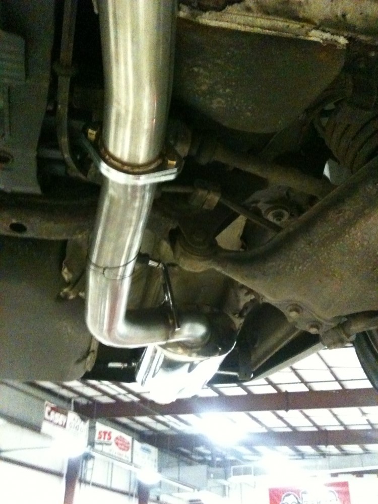

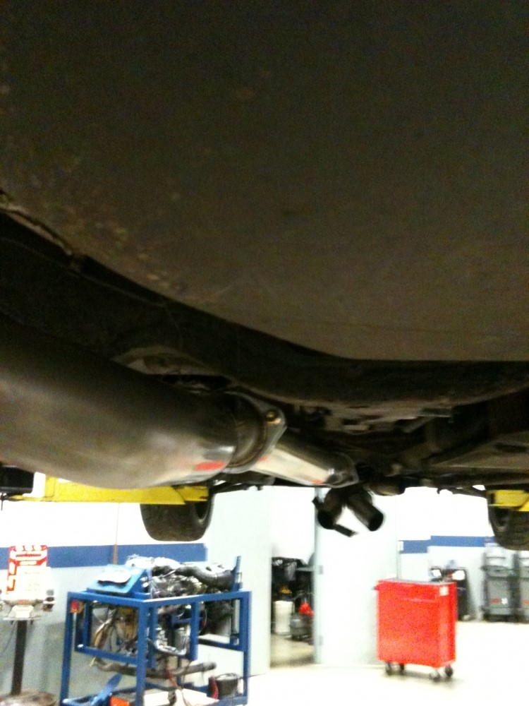

In an effort to get you into a decent exhaust, I recommend one of those 2003 2.0 Turbo WRX jobs that UrS guys can make fit... I'm not sure if C3 chassis would accept it though...
exhaust 001.jpg (184.66 KiB) Viewed 95807 times
exhaust 003.jpg (144.22 KiB) Viewed 95807 times
exhaust 004 (1).jpg (162.36 KiB) Viewed 95807 times
Re: Magellan's 1991 Audi 200 Quattro 20v - Spring 2015
bumper exit spot on t44 and c4 look to be very very very close, everything else under there should be the same.

mushasho wrote:In an effort to get you into a decent exhaust, I recommend one of those 2003 2.0 Turbo WRX jobs that UrS guys can make fit... I'm not sure if C3 chassis would accept it though...
TANABE EXHAUST GOOOOOOOOOOO
