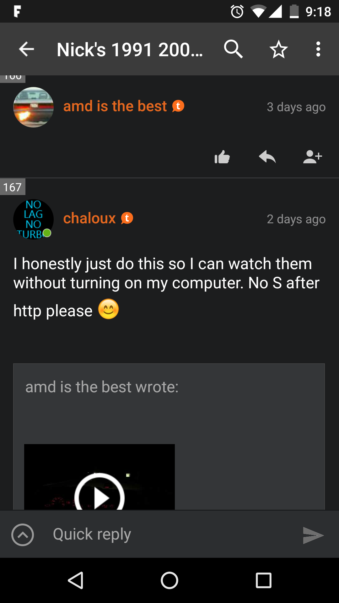

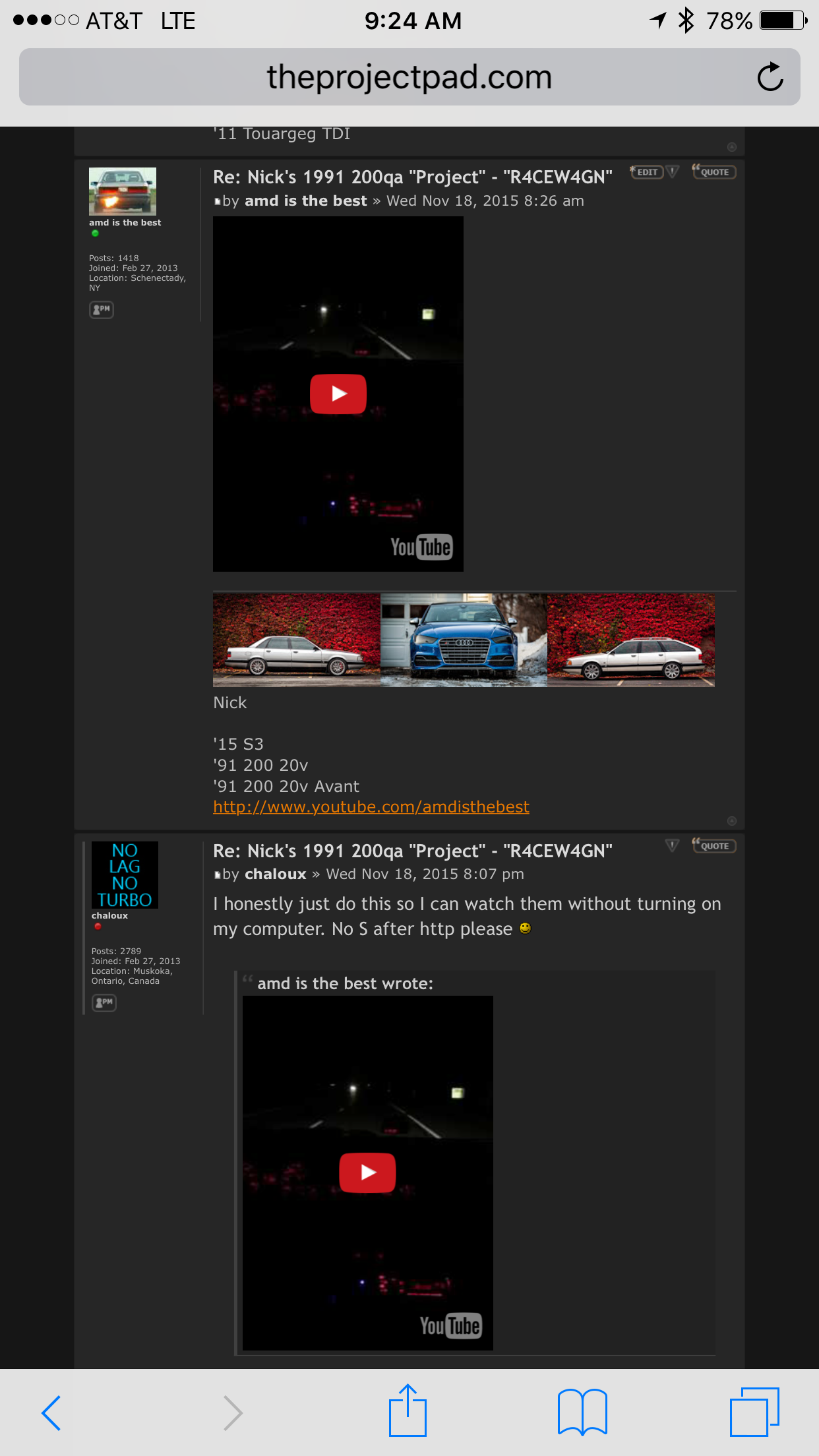

Re: Nick's 1991 200qa "Project" - "R4CEW4GN"
I honestly just do this so I can watch them without turning on my computer. No S after http please :)
amd is the best wrote:[youtube]http://www.youtube.com/watch?v=vq2ya5QQdno[/youtube]
amd is the best wrote:[youtube]http://www.youtube.com/watch?v=RJBxmPvglGo[/youtube]
Looks like you're using a browser? Matt's talking about tapatalk users.
app needs 'secure' connection - I hope there is more flogging posted soon
Yeah from within Tapatalk specifically.
This is what we see:
