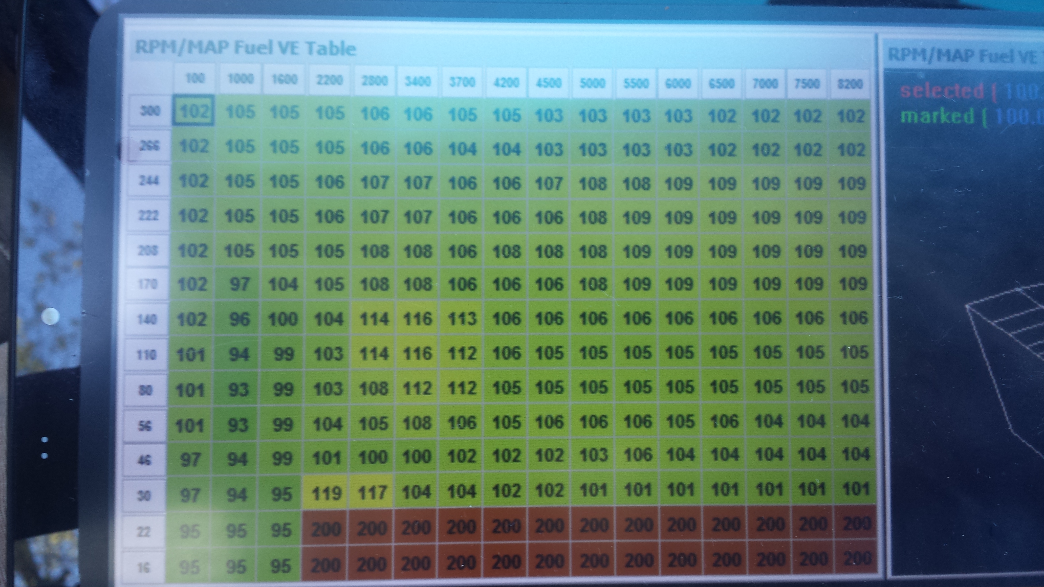

I knew sombody would ask haha. 5k needs TB jobber, I have no idea of hp on 200, 200 won't have cutouts for another month (yes Chinese shipper!) and finally this strange fueling anomaly between 80 and 140 kPa and 2800 and 3700 rpm. It's weird but I guess the engine VE has just increased there from straight pipes?
Also glad to see your project where it's at now :)
That fuel anomaly is present in a lot of maps on our cars. I'm not sure what causes it, but it's nothing to worry about. Just tune it correctly there. It should need more fuel in that region, all the way to the top of the map... but your turbo probably never gets there at that RPM.

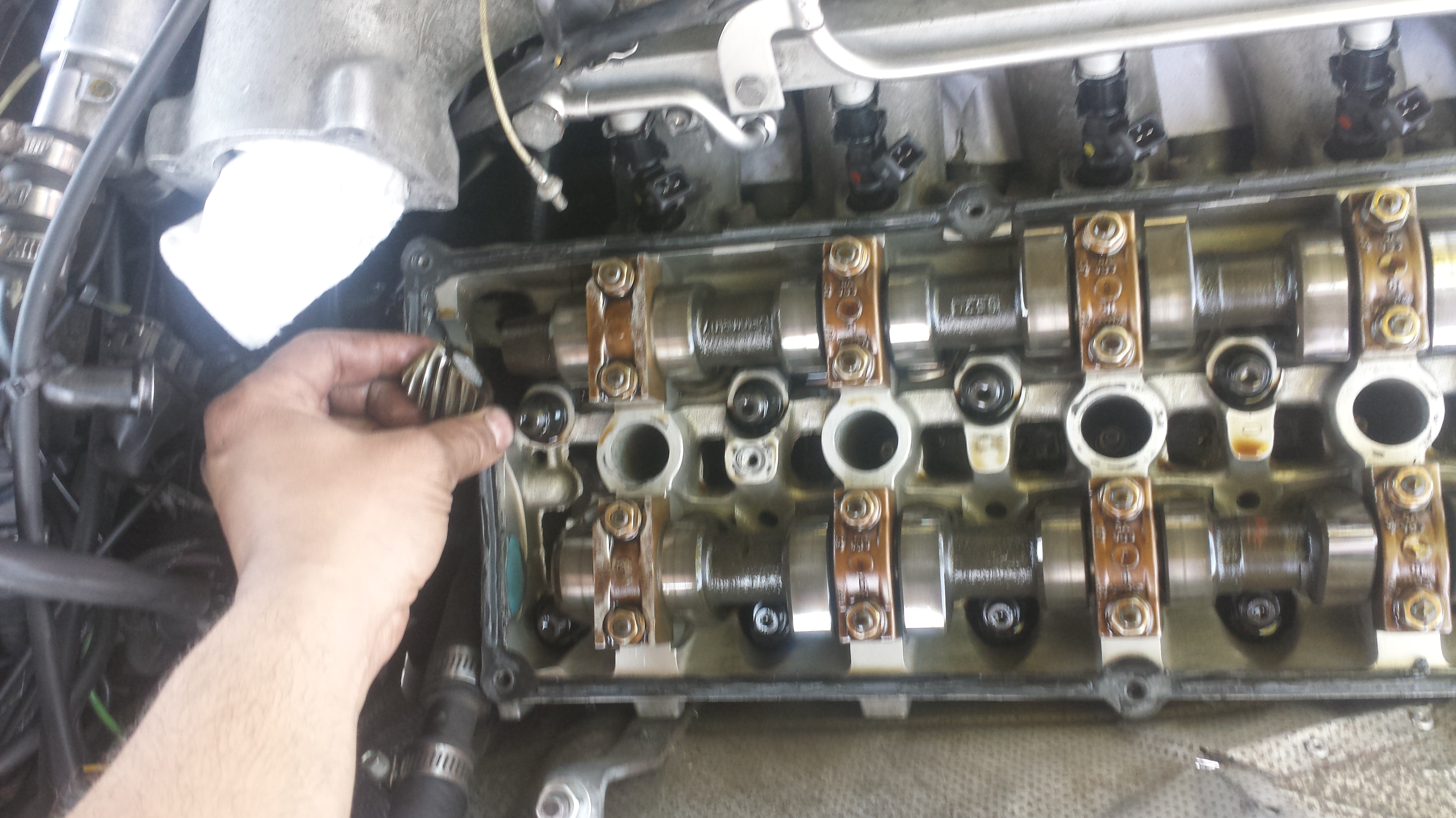

Ahhh SHIT!! My dizzy shaft is spinning relatively free. Dammit! Time to yank it out and observe the carnage :bangshead:
It even has the brass gear :wah:

Wut. That sucks man! It gives me flashbacks to when I snapped a 7A cam in a very similar manner, but it was during install. I wonder how that happened. Did the dizzy bind with anything to keep it from spinning freely?
Actually, I'm now wondering if the plastic dizzy gear was originally intended to be a designated failure point, since that would be far cheaper to replace than a cam in such an event. In any case, I'm glad it sheared off cleanly and the piece didn't cause any permanent damage to the head.
Well that'll do it
I totally agree on all your points. I would figure the plastic gear is plastic for that reason. I don't think I over revved or anything. Probably held under 5k rpm most of the time. As of now I'll be putting my new lifters in I guess. Probably a new cam chain too
