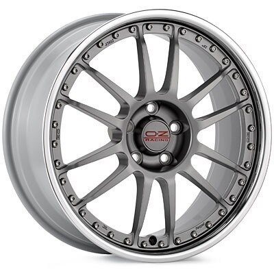

Thought about Light grey centers on the wheels?
like this color:
That would slick with white... any white.
like this color:

Justin517 wrote:Thought about Light grey centers on the wheels?
like this color:
I agree that that would look good, but I'm trying to get away from anything dark. I like colors that pop. Two black sets of wheels got to me I guess.
