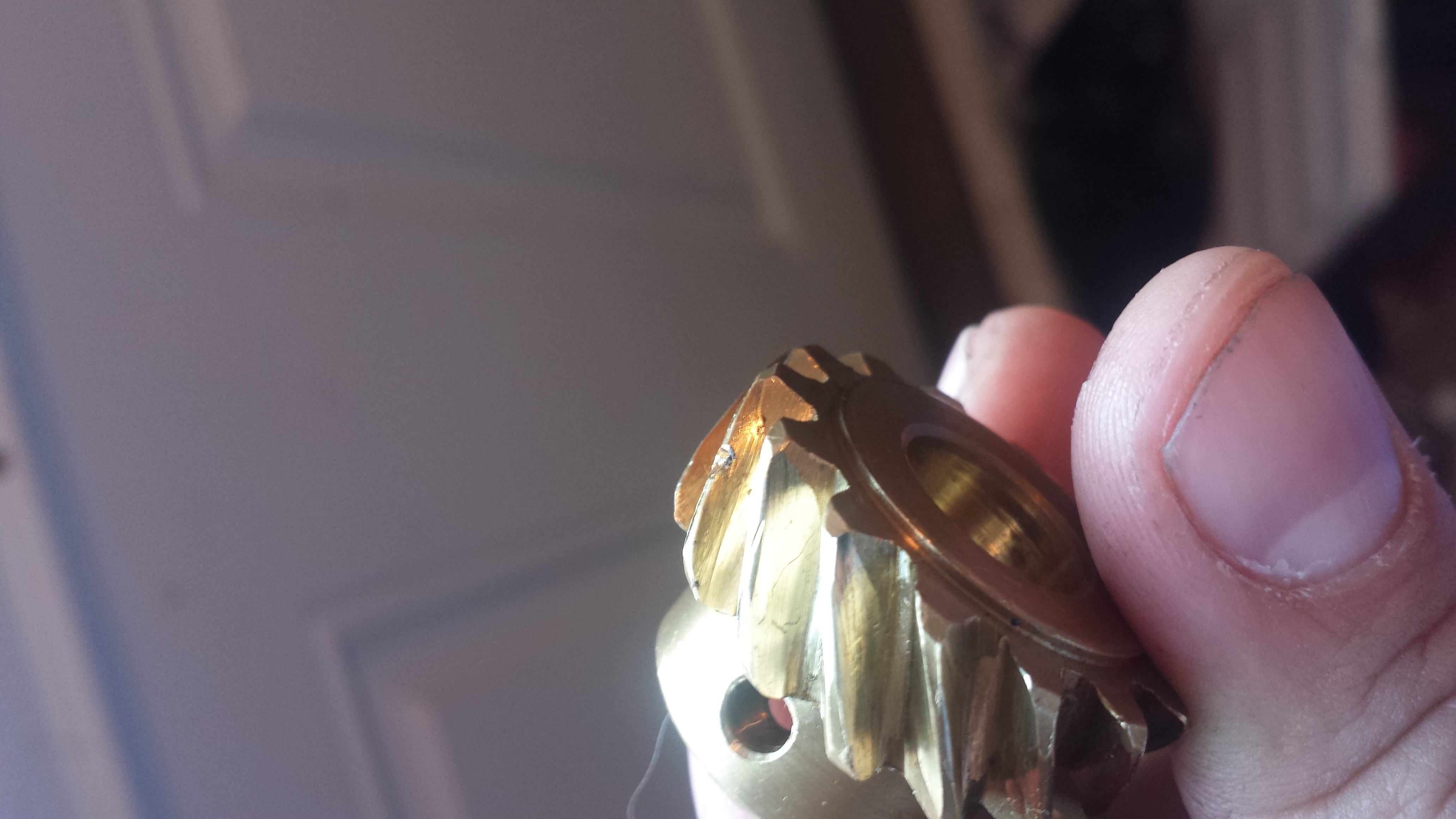

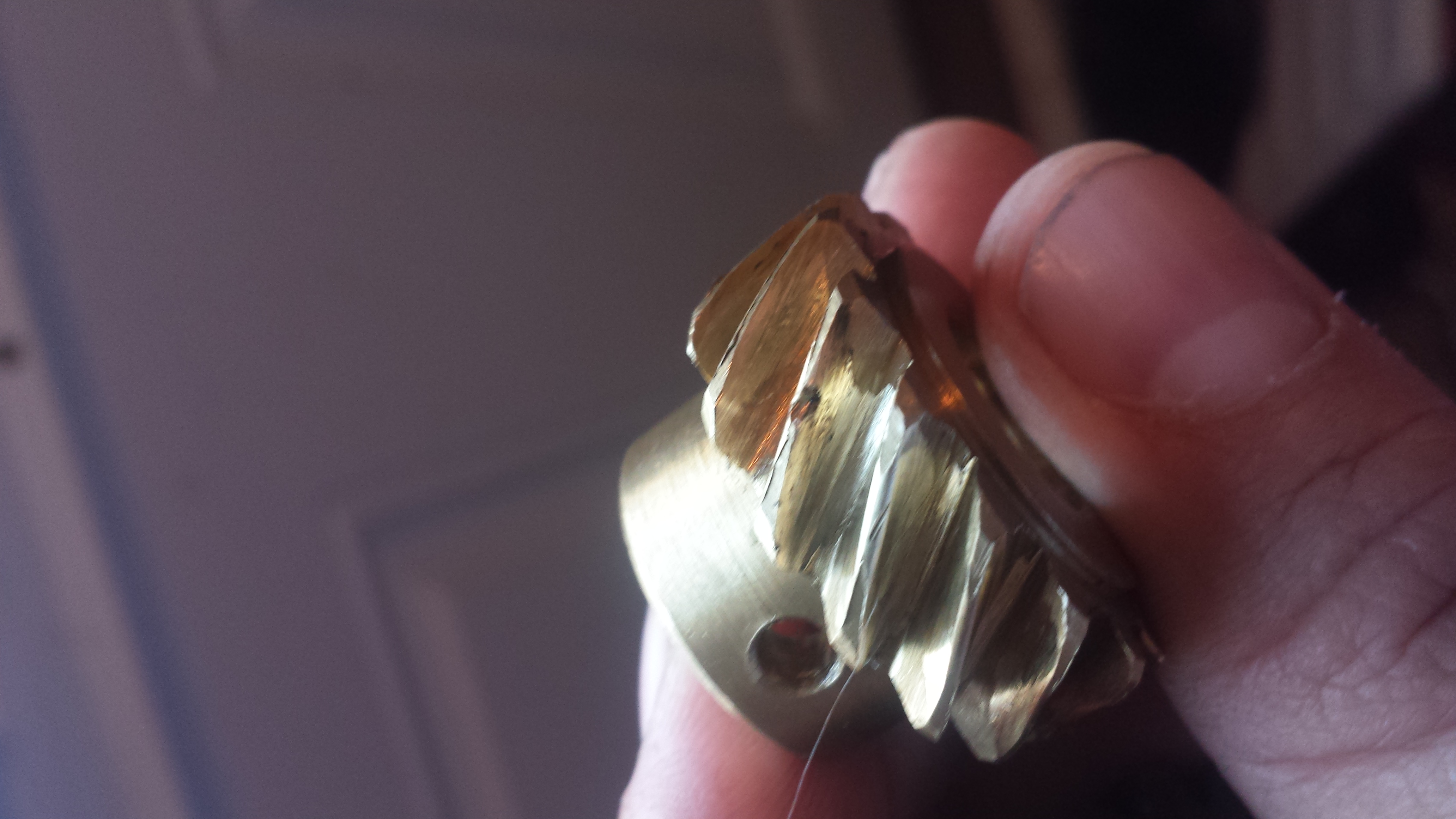

All I saw was the gear on the dizzy showed a dent in one tooth where I'm assuming it clashed and didn't mesh with the cam gear and just popped the piece off.

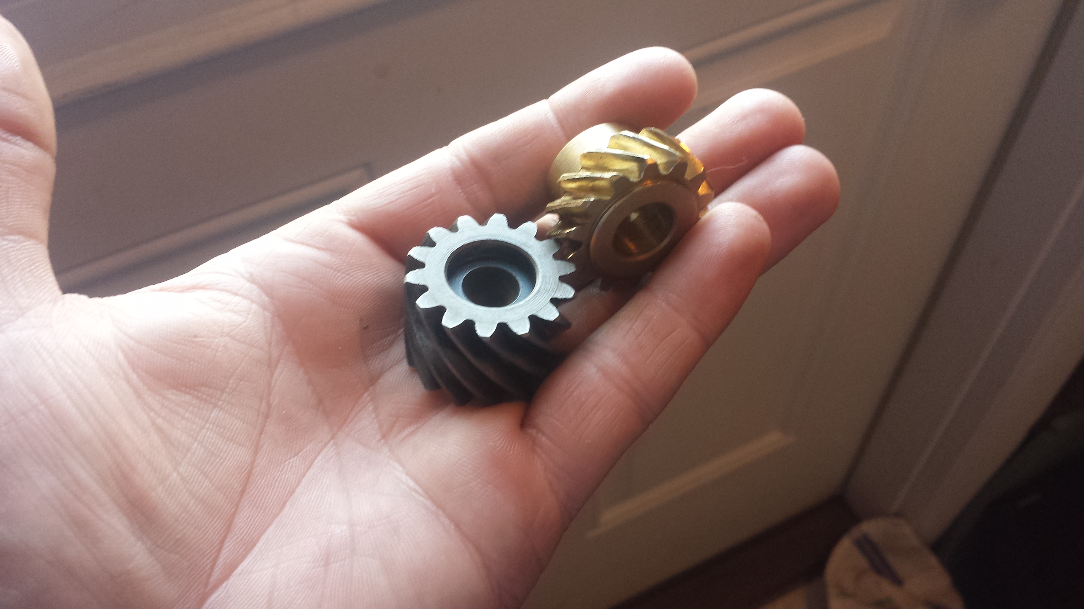

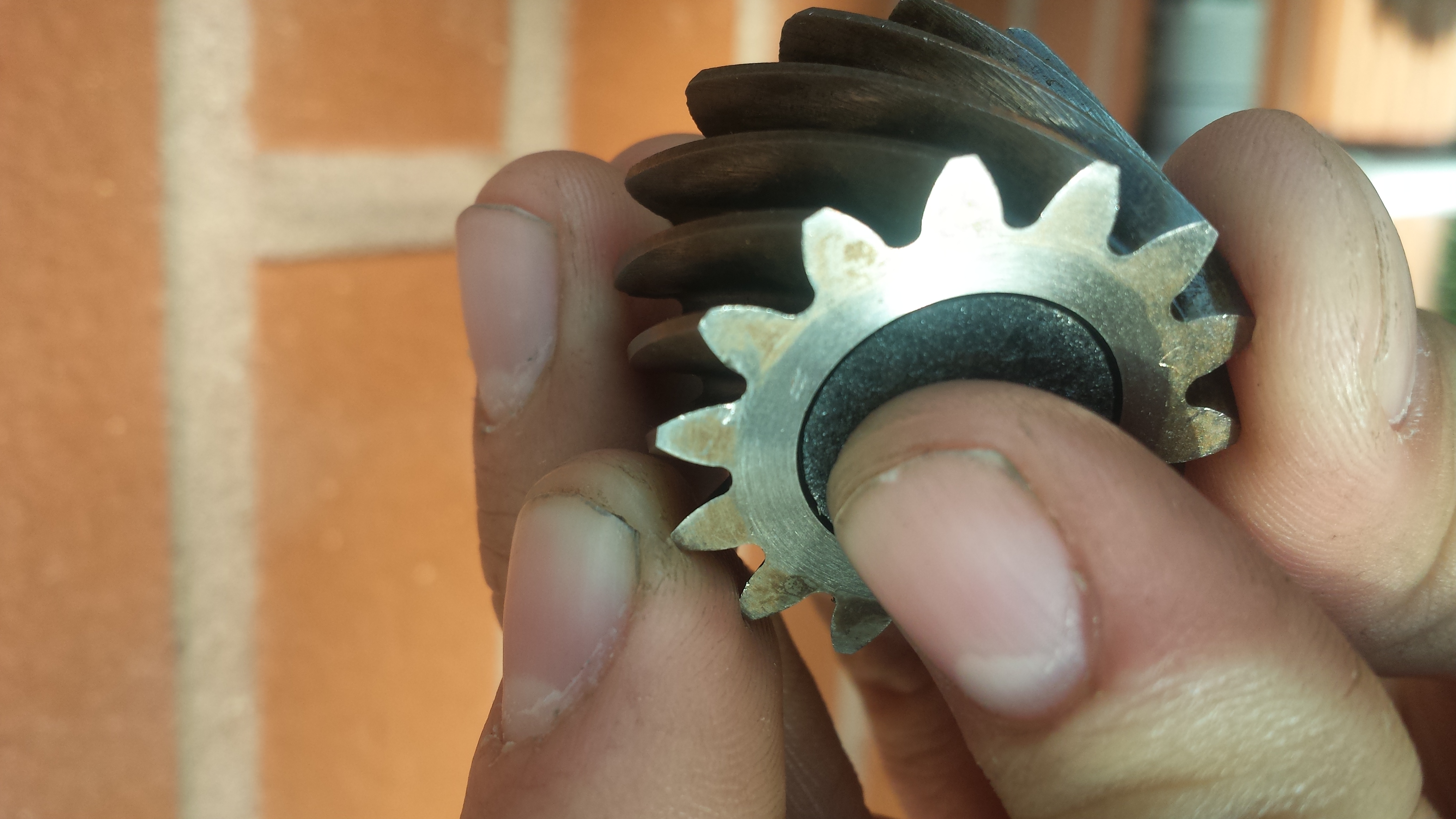

This is all I see on the gears. I've foc u ssed in on their blemishes. I think theyre just from when the gear got caught in the dizzy gear after the breakage occurred though. Then again if jk what really happened. The break was after I stopped doing donuts and the motor was low rpm. Sounded like I ran over a piece of sheet metal when I believe it broke. Oh well, onward!

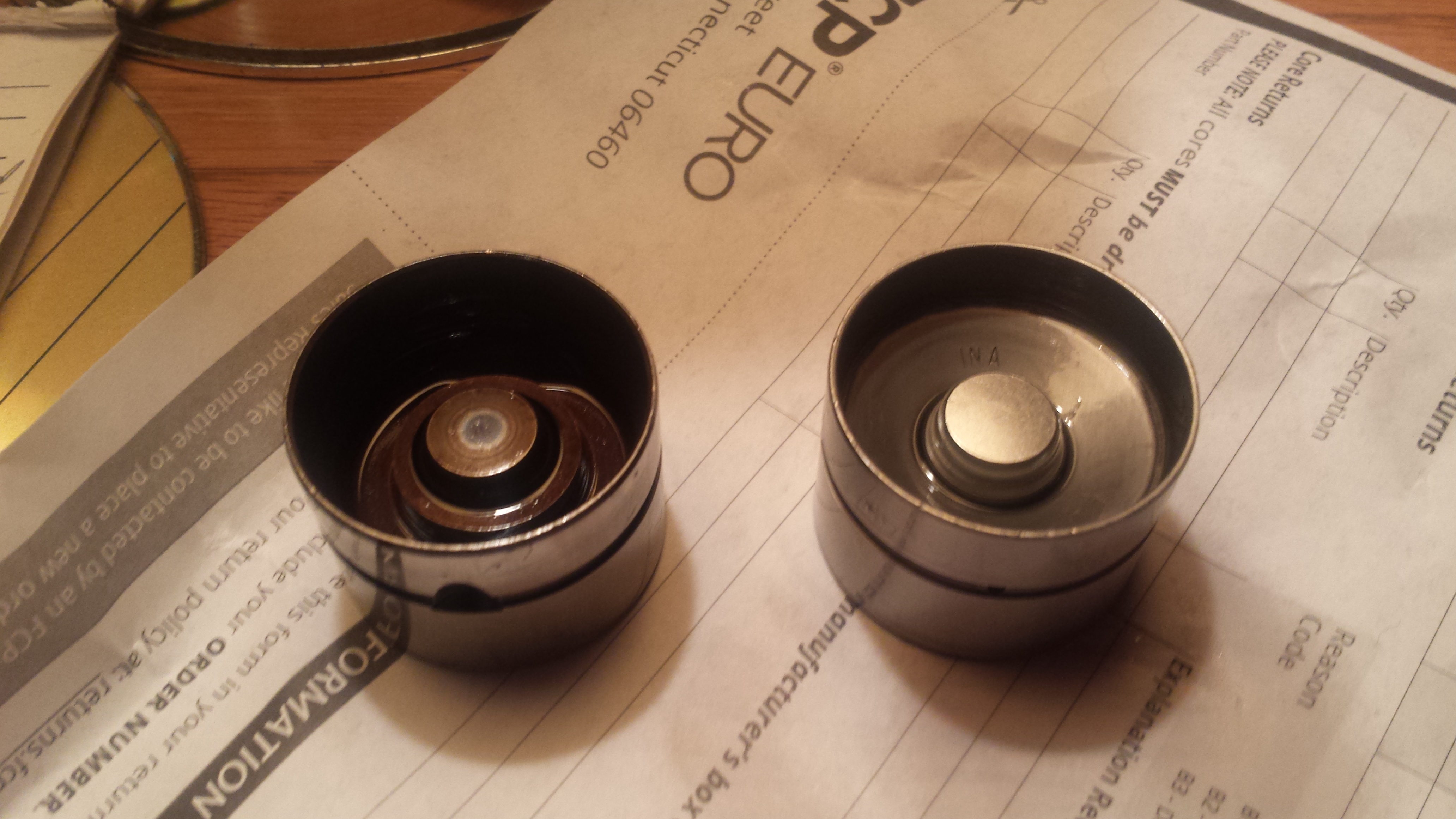

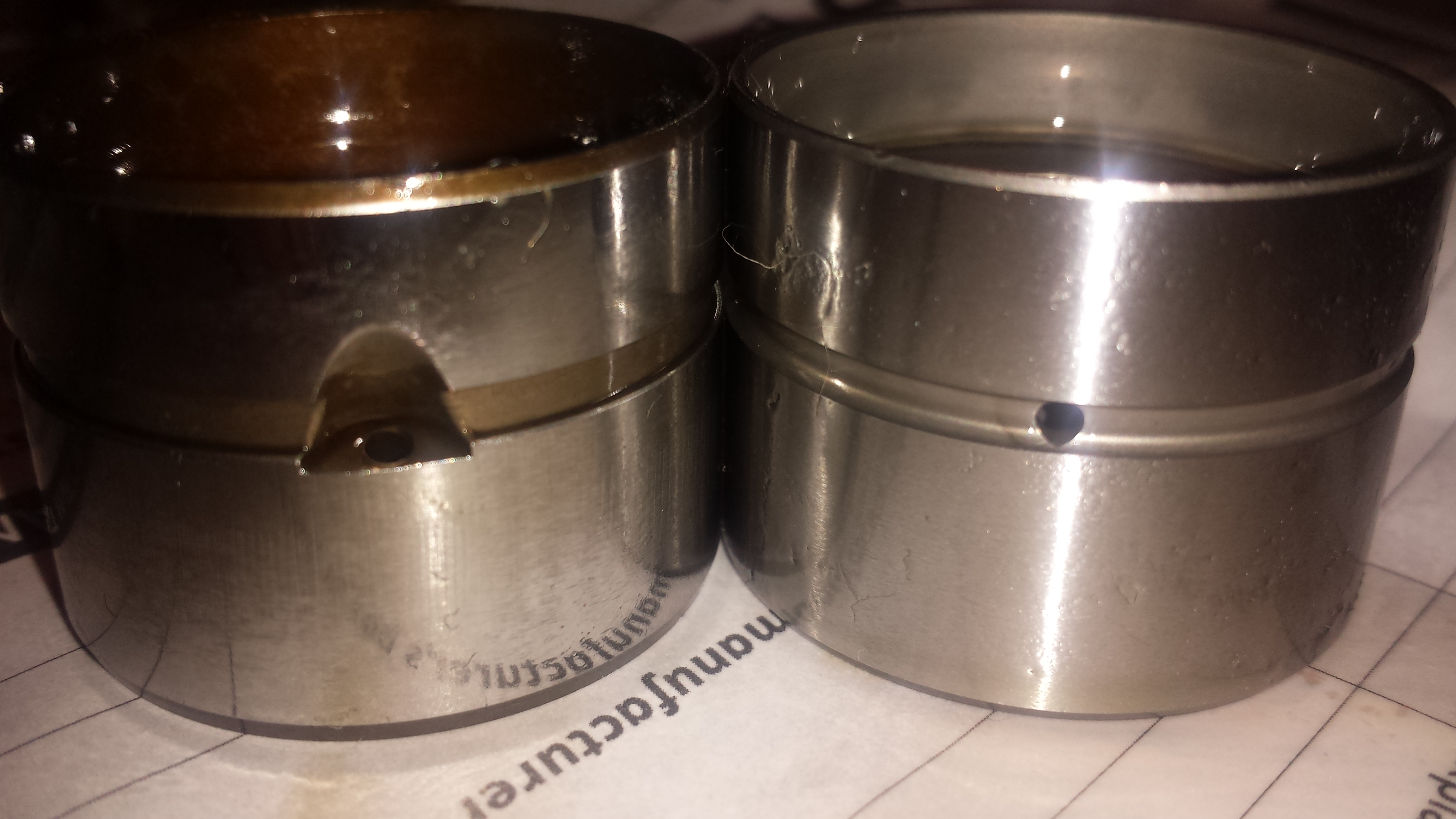

New lifter on right. Updated design? INA branded. What I find odd is that the cam surface of the new ones is not polished
