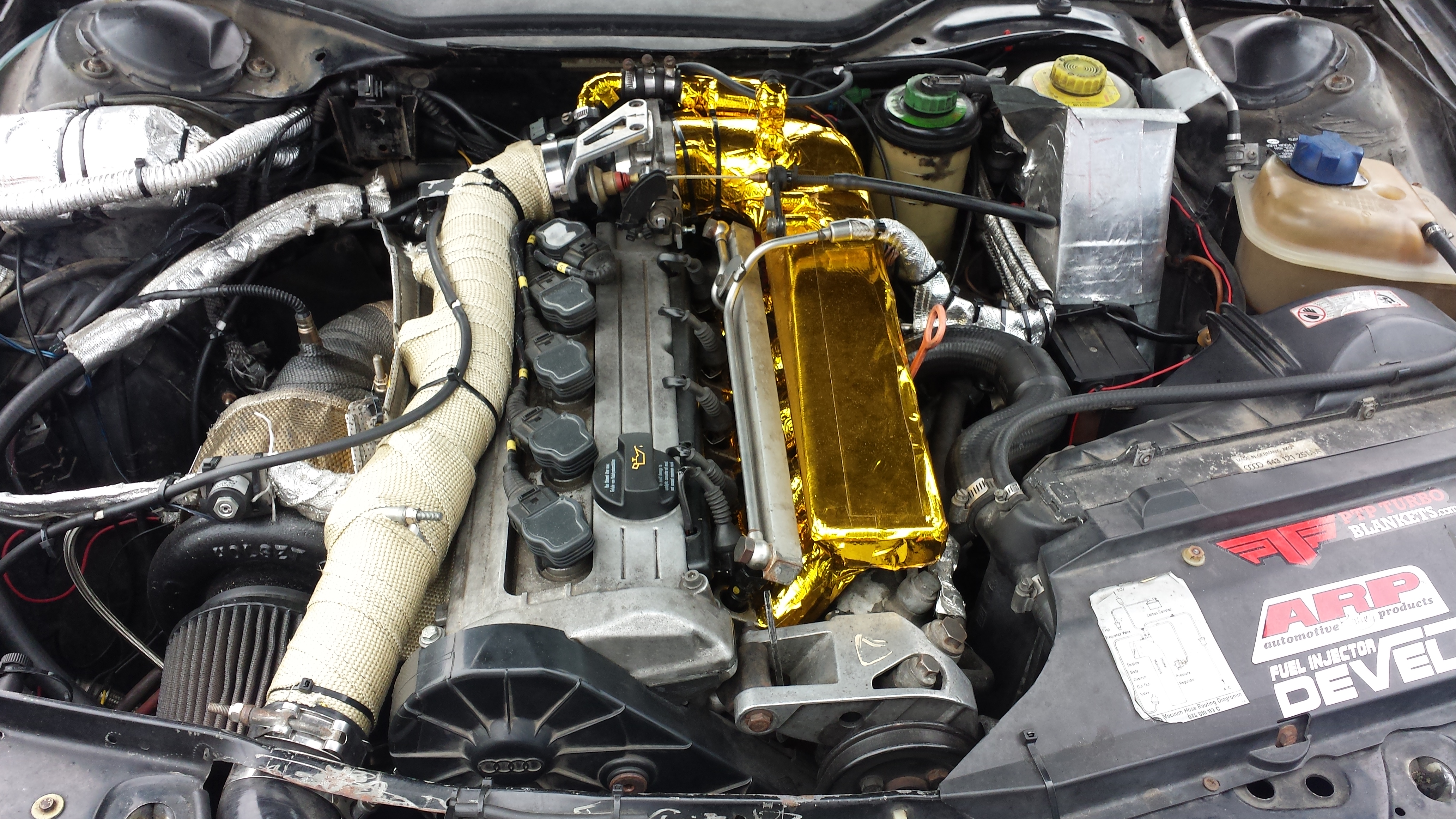

Some of you may feel like I've ruined my car but everything I do is FUNCTIONAL. Lol now look at what I've done!
The intake pipe to the left has reflect-a-gold as well underneath the header wrap. That trick was relayed to me by a local friend with a 1000 hp SL550. Although he did say titanium wrap and not the regular stuff from DEI :hide:
It is making a huge difference in preventing heat soak at lights and keeping temps steady. Coolant temps are even WAY down.
I'm happy with it.
NOW I am having a slight issue right now. When cruising my temp will be 30 C and then SPIKE way down to 25 and back to 30 C in a fraction of a second. This is at cruise. I have to check if it's doing this all the time or not though. I will change the sensor on the manifold shortly since I have another new one already.
Thoughts?

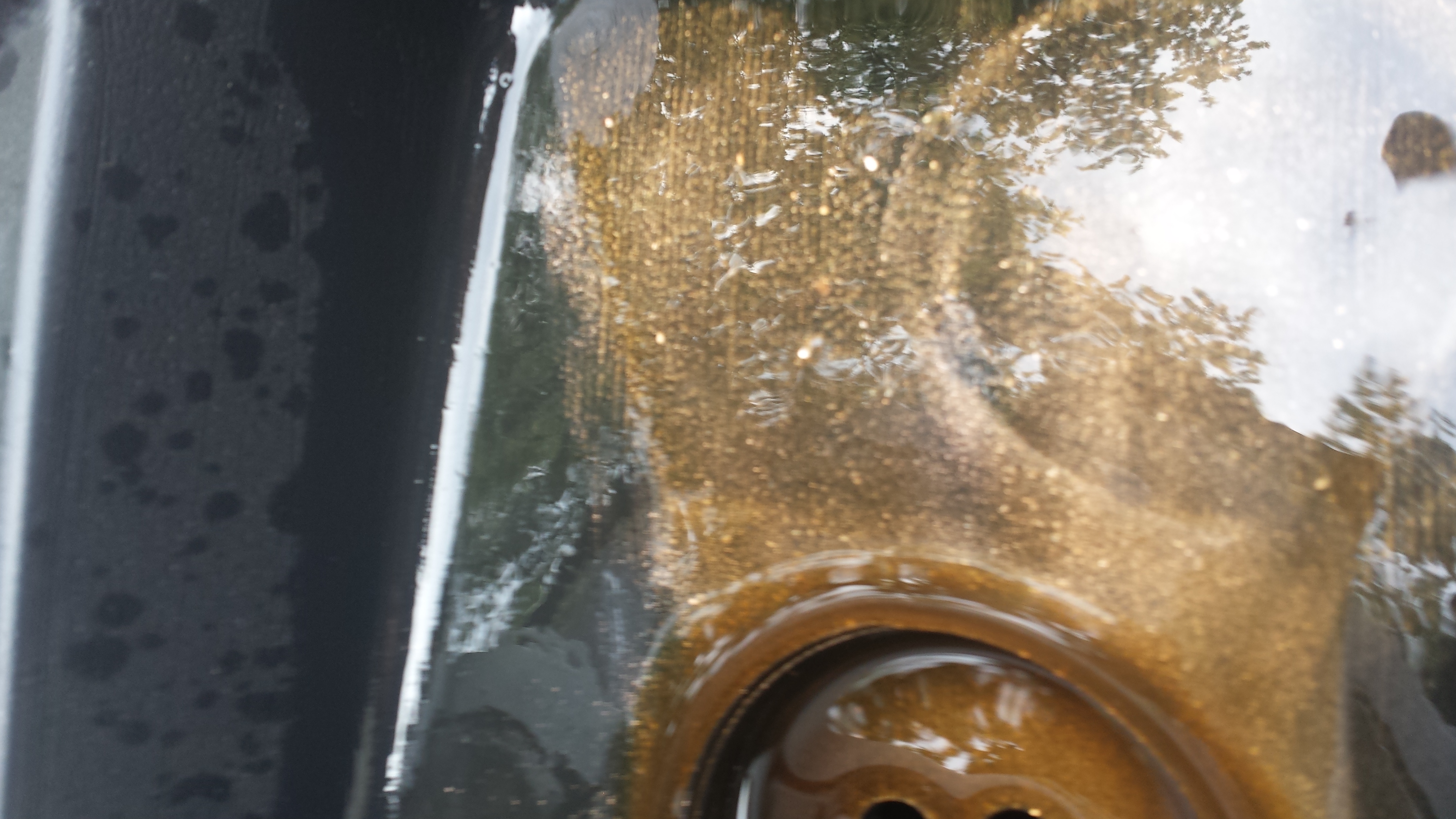

Spun bearing? I had put about 10 minutes on a brand new oil change with valvoline high mileage 20w50 before the awful noise of rod knock began after leaving a gas station. I barely made it home. Ya I drove it 12 blocks home too! Low rpm but it won't matter lol. Pretty sure the block will be junk. At least I have the other motor. I'd like to open it up and put these in it before transferring it over:

What is that a picture of? Don't get eBay rods man. Even scats are junk straight out of the box without a little work.

That's a picture of the oil I drained out before I did a very wasteful oil change :hammer:
Not my finest moment lol. I was certain the noise I was hearing was from the valve train and even after I saw the bearing material I began the "nah" faze hah. In my quest to ignore a bearing about to go, I wasted a $26 oil change special which is all on me lol.
I cant believe those are so shitty. How sad. Not sure what to get now. Oh well on with the show!
Posted: Wed Aug 10, 2016 7:05 am
Wow! The pic didnt load for me last night. Looks like you drained glitter out of that thing. Very sad that it happened, but I'm sure you will get it back and better!
