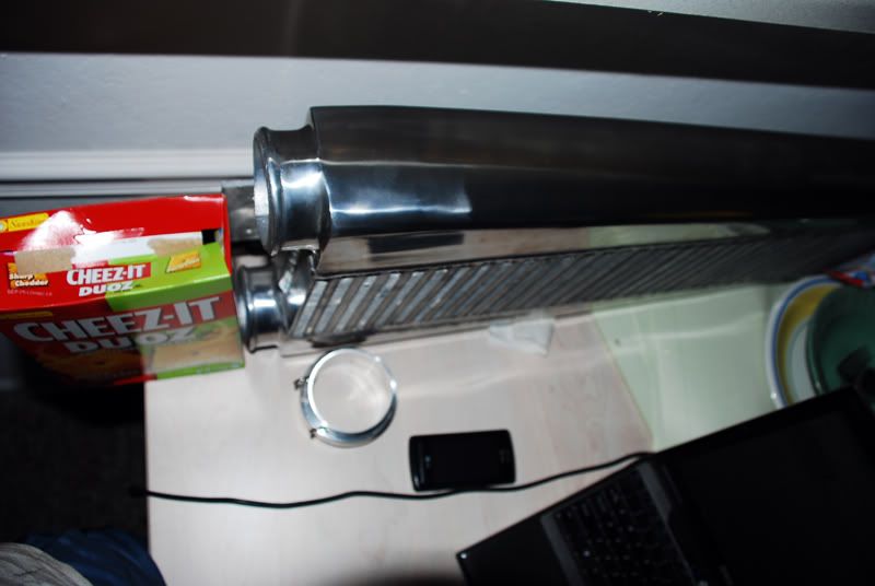

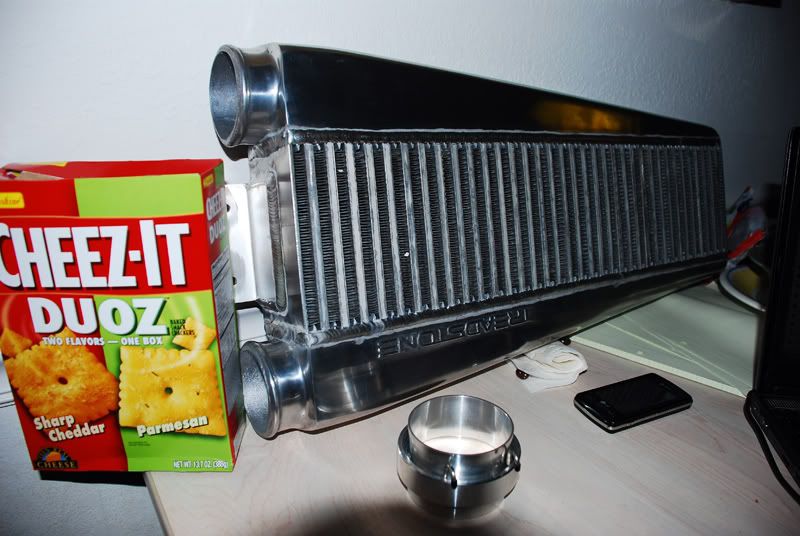

Treadstone came.
cheeze-its are for scale and are very scrumptious

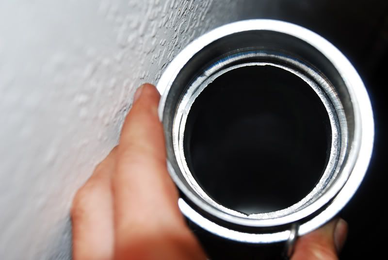

this is the ID of a hargett up against the ID of the treadstone. I think I'm going to kinda "port match" the treadstone to match the ID of the Hargett.
the intercooler is so much smaller than what I have come to expect of capable IC's but its all due to the fact that its vertical core. The end tanks are huge. If it flows 1492 CFM it flows 1492 CFM, there's no way around that. Should do the trick!

oh yeah, fin density is good...its got the staggered fins. So it looks like it doesn't have a lot, then you look harder and you see the other fins in there. This is the best pic I could get. (friends camera) He managed to get the whole camera inside the end tank lol
