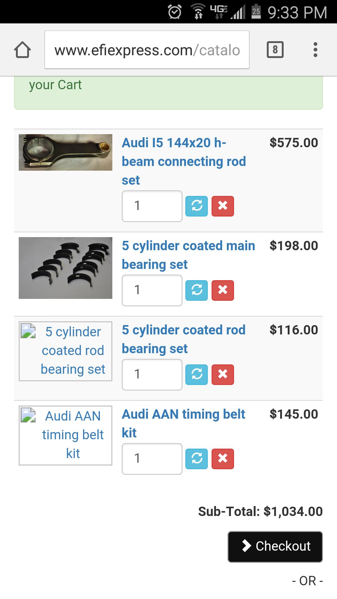

Thanks for chiming in Shawn :) not too long before you posted that I had already added the scat rods to my cart at 034. I'm pretty much sold on them though.
Gonna do stock rings for sure. Recommended mfg'er?

Why not buy rods from Jeff @ FRP? My buddy Adam got a set of SCATs from him for something crazy like $400. Failing that, Marc sells a set of h-beams for less than what 034 is selling SCATs. 034 are... well (to me at least), the vendor of absolute last resort.

Talk to Jeff about SCATs. He'll tell you why he doesn't like using them out of the box. It might not matter for a relatively "low" power build, but it definitely could for the higher revving and more powerful ones, and there is a longevity component to it as well.
Anyway, I'm sure they'll be fine for what you want to accomplish, the point is that if scats have quality issues, imagine what no-name rods are like. They're probably all made in the same factory anyway now that I think about it lol.
I believe the important part is that the finishing work be done in the USA. Keep that in mind when you're making a choice.

So I know I tend to be the 'throw caution to the wind' kind of guy, but are you having the rods and crank machined to account for the coated rod bearings? I thought they were proven to cause a lot of problems when the bearing tolerances weren't opened up.
Haha I saw a thread on that. Supposedly where I read it they were saying the coating was "soo thin" it was negledgeable. How do you feel about it :) I will ask Marc as well
You'll know when you plastigauge it. As long as it's in spec I'd run it.

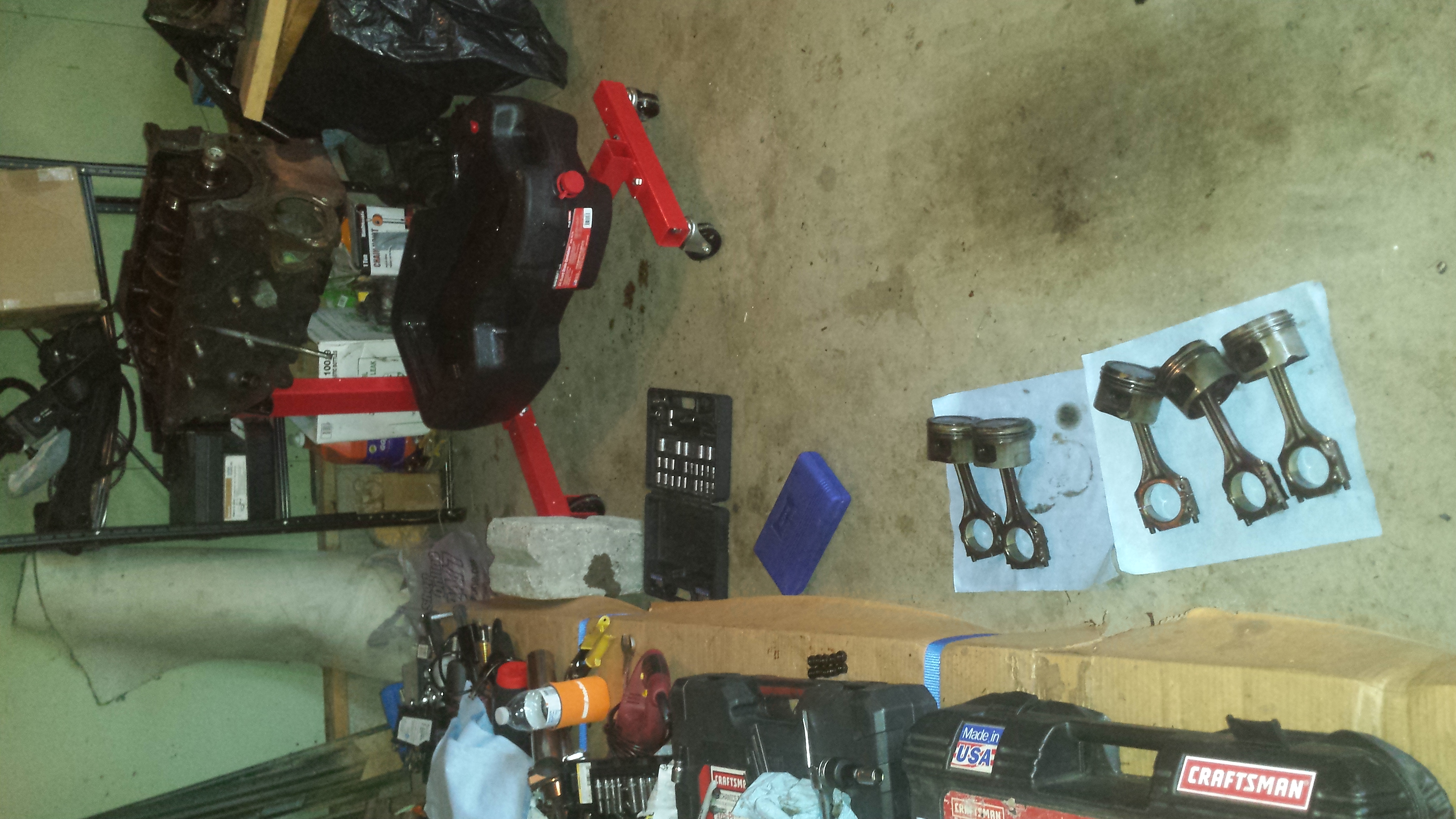

So far the rod bearings look good and the cylinder walls too this is the spare motor I bought from Ohio with an unknown record 2 or 3 yrs back. I've decided to ship the block out to my local Machinist for tolerance checking and cleaning.
Actually I did find a lot of debris from the oil fill cap internal plastic thing over the cams. It was in the sump and a lot was in the oil pickup :o

I know it's anecdotal, but I wouldn't worry about that too much. It's happened to me, and several others and I never saw the oil pressure drop. Just clean it up and go!

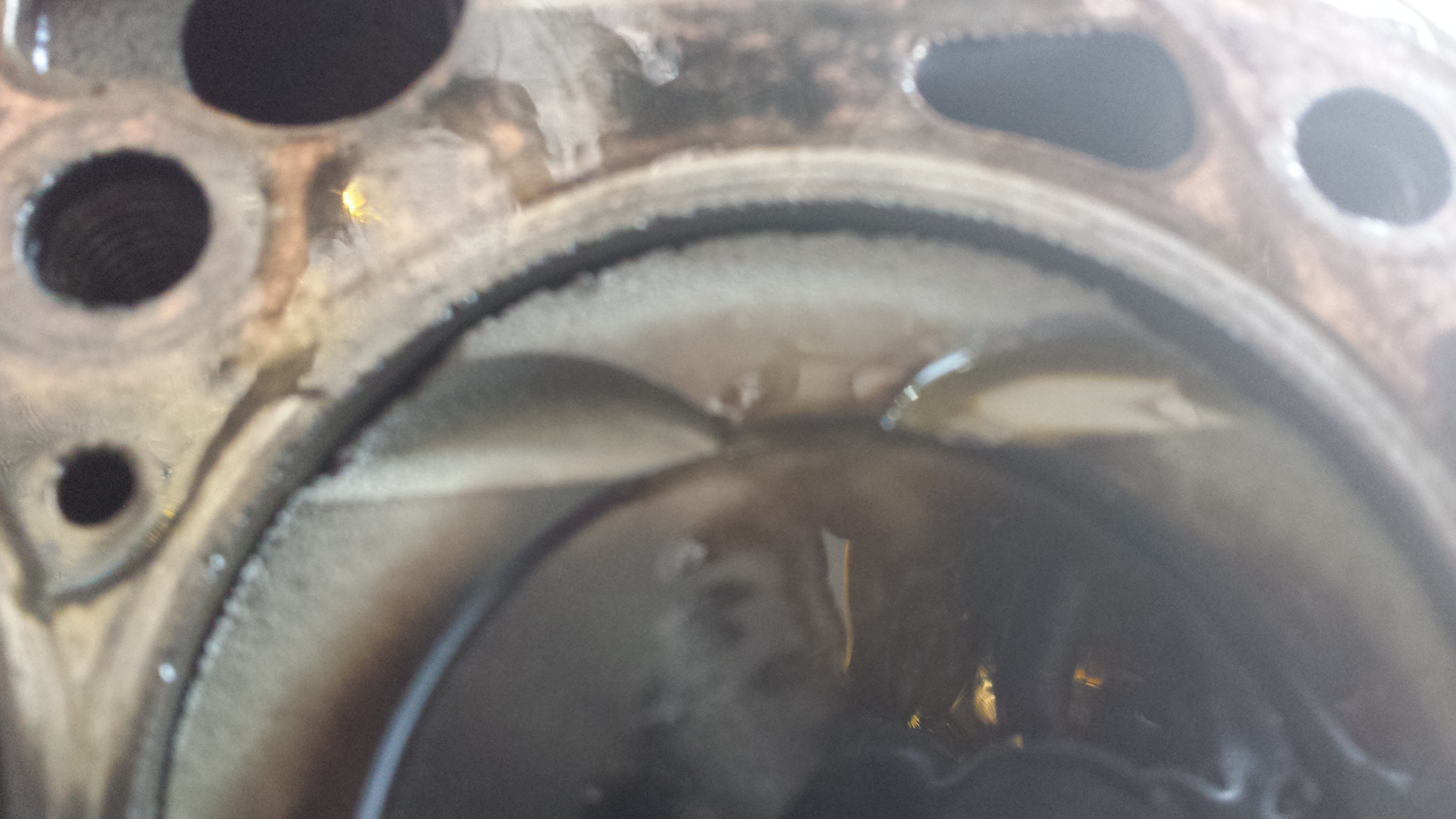

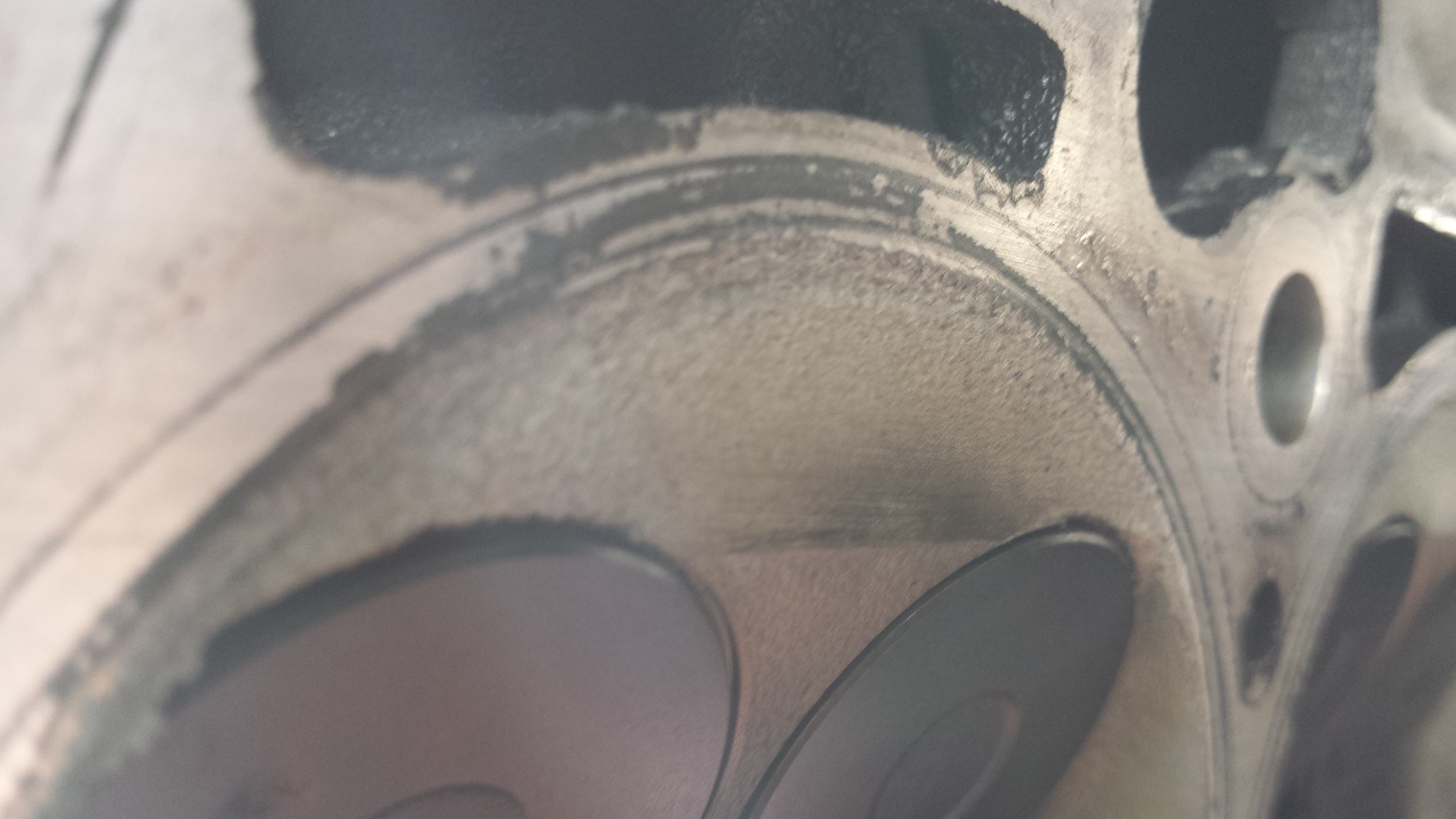

Yes you read right. 4 out of 5 pistons and cylinder head chamber areas directly next to the intake valves looked as though mice had been chewing on them. Cylinder head is scrap now. :wah:
dettttt bruh
Anything to do with overusing LC? I thought my ignition table was still somewhat conservative
