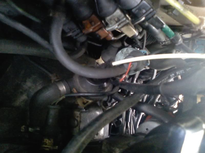

I also had to connect this vac line (the white one)...not sure what it is at all. It goes thru the firewall. Maybe cruise control or something? Either way, it had no effect on the problem.
