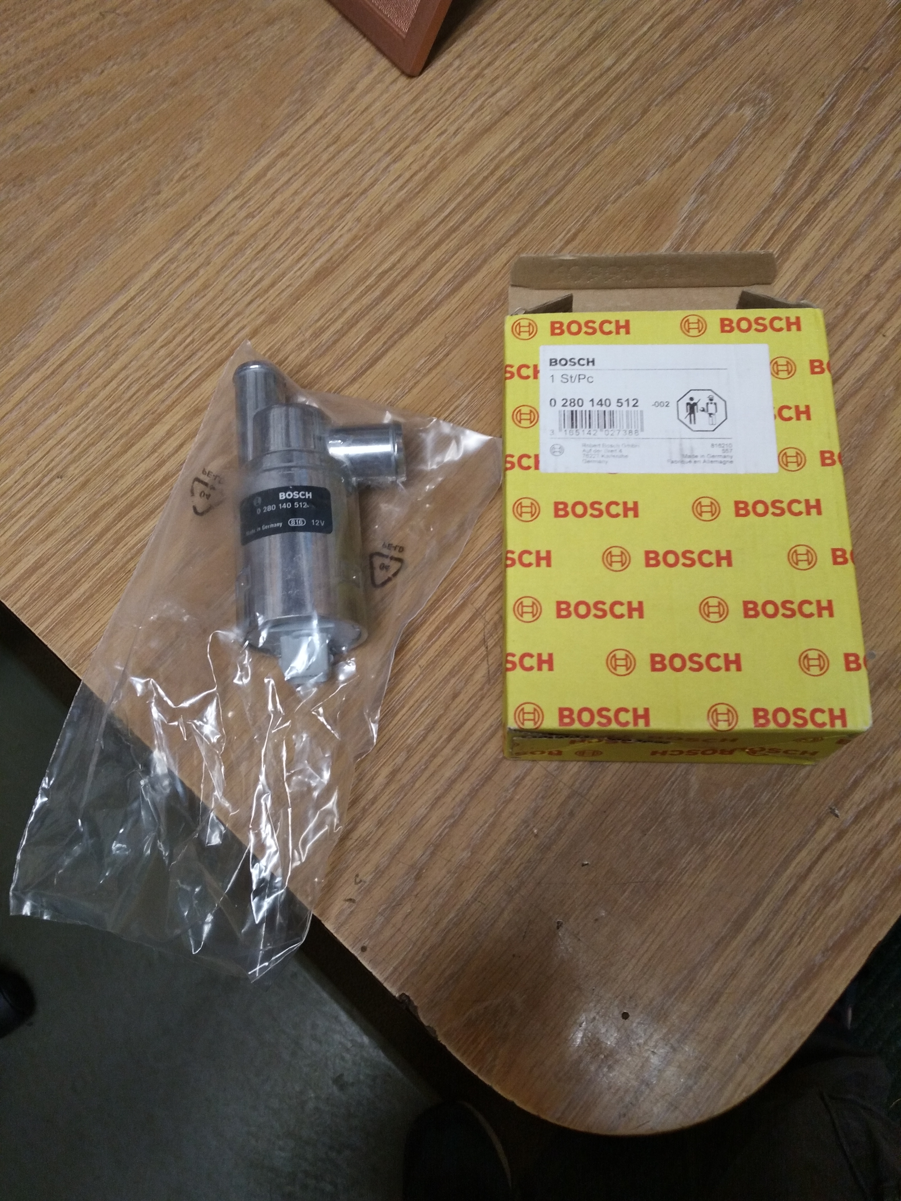

Just this week alone:
One defective IACV from eBay
One defective m1-205 oil filter Frome Autozone (had a rattle internally)
:idunno:

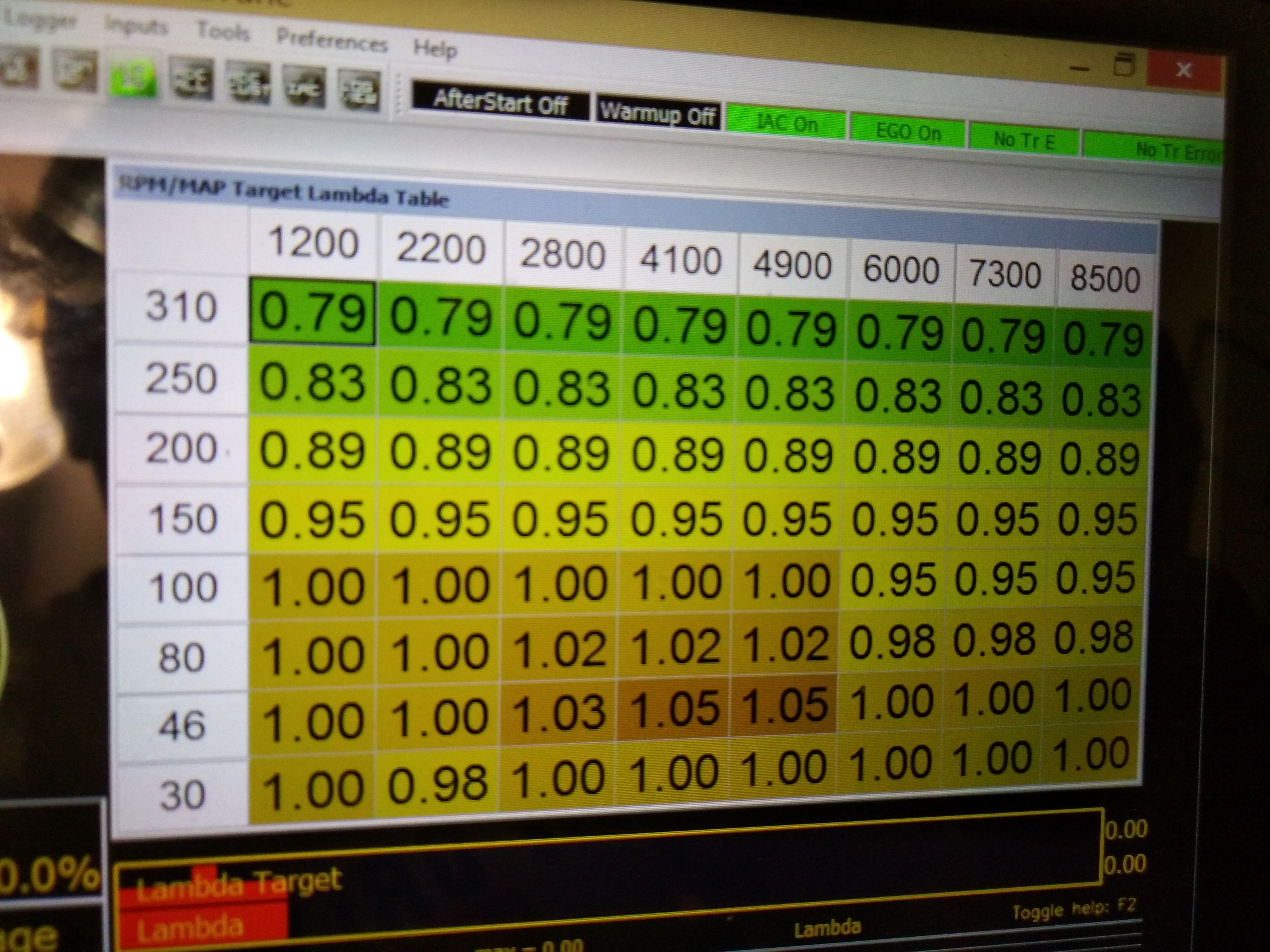

Is this reasonable you guys think? 0.79 lambda at 30 psi seem too rich or good? This is with the new direct port meth injection spraying. Feels very healthy at that afr.
Posted: Thu Nov 24, 2016 12:06 pm
by 88a5tq
Marc says this all looks good for lambda target. Happy Thanksgiving everyone!
Posted: Sat Nov 26, 2016 11:59 am
Yeah doesn't look bad to me. Happy Holidays
