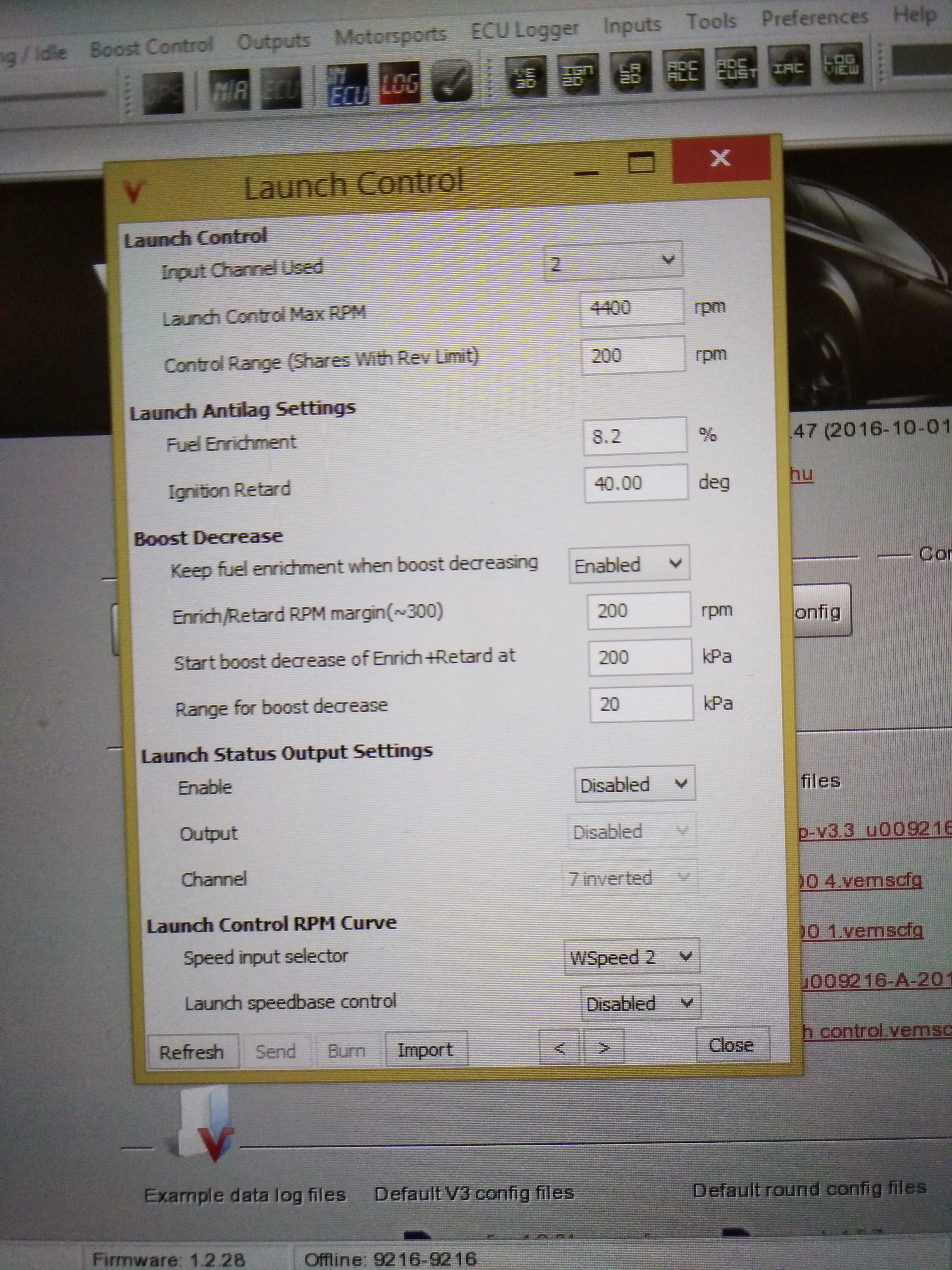

- IMG_20170105_231846.jpg (3.75 MiB) Viewed 47444 times
50 control range was the money shot

Finally got around to trying it today
Mine at 20 was sweet for a while, but seemingly is different now. Maybe I'm used to it. I'll have to try 50 next time I decide to drive ole turdquat
Hahah that thing sounds nasty. I miss having a screamer of a turbo like that!
Sounds wicked, man! Can't wait to see it at Carlisle this year
Thanks guys it was definitely awesome! I just made an interesting discovery about LC today too. I know, late to the knowing party hah. As I do LC so sparingly, especially since the rebuild, I only just found out today that LC didn't work as I expected unless I had just done a full boost pull (so far, first and 2nd gear were sufficient like in the video) right before doing it. Last week I free revved at a lifted truck that was up my ass with his seemingly only 55w HID on bright in my eyes. After the free rev above my LC rev limiter I hit LC and revved lightly real quick again and backfired real hard on his bumper lol.
So apparently the turbo has to be spinning fast enough to create ~2 bar at least in my case. Is this anyone else's experience? I guess I thought LC was used to spin the turbo up instead, simultaneously.

I'm not exactly sure what you're saying but if you hold the throttle down and hit lc above your rev limit it all dump a lot of fuel and then ignite it when the rpms hit the lc threshold. And then boom
I mean if the turbo is not well spooled in advance, the car makes no boost during LC for a good 3 maybe 4 seconds. My old settings I used at the strip made it spool up during LC but it didn't make all the backfiring. I wander if there's a way to have all these things at once lol
Corrected a typo /\
I've noticed something similar, but I think it has more to do with the extra heat in the exhaust manifold and turbo from being on boost.

Ahhh interesting. That's a very good point. I can see that especially being a factor for me with w/m injection. Maybe the lack of boost leaves the charge air and manifold too cool to create the effect. The system starts injection at 1 bar atmospheric so maybe that's the hold up I'm seeing at that pressure. It will hover there with no backfiring for about 3 seconds before the pressure rises to around 120 kpa at 3 to 4 seconds according to the log. Good to see I'm not alone on this. Thanks Jake
