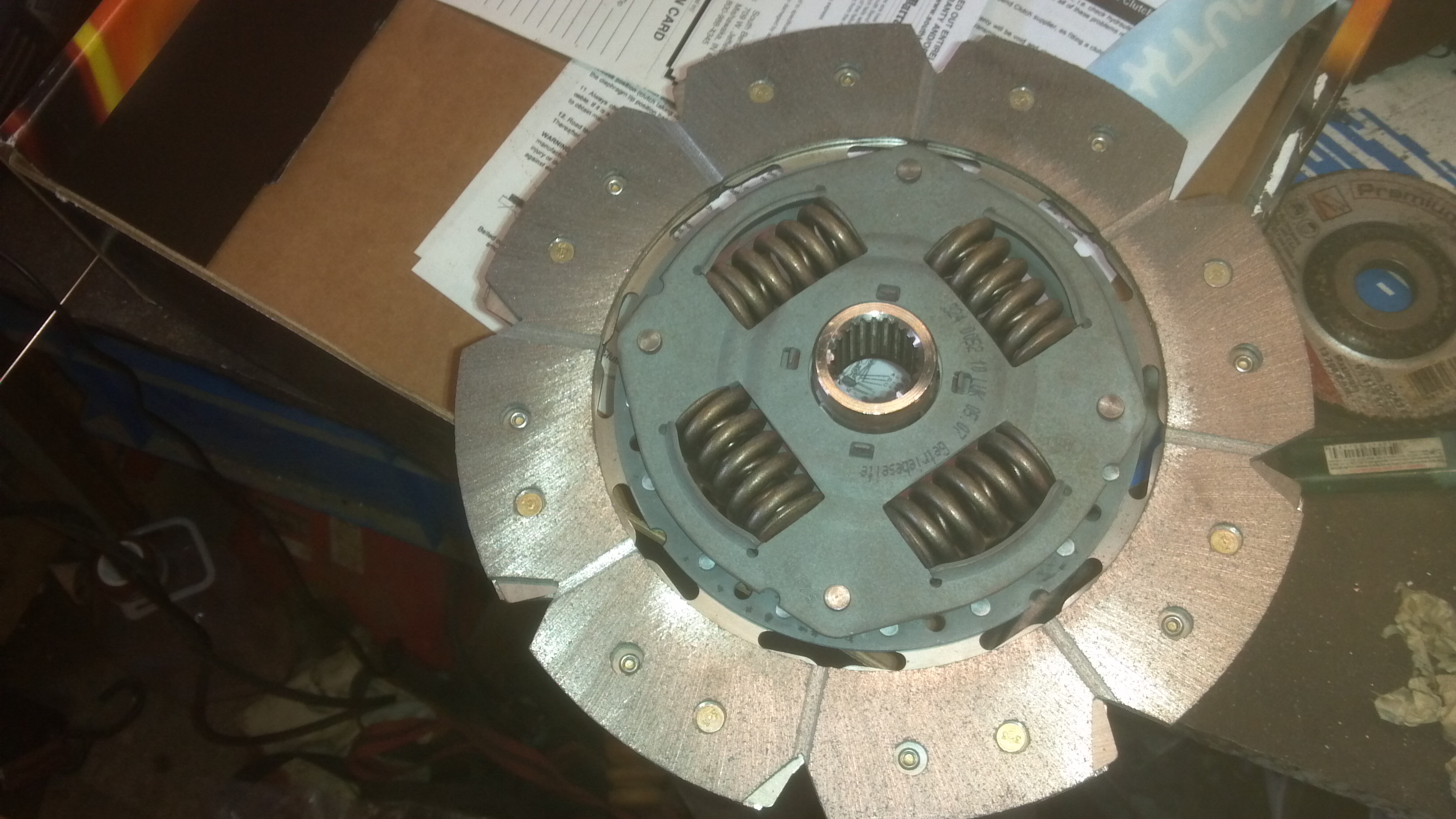

SO i got myself a stg 2 "xtreme" SB clutch. highest rated full face disc they have. Feramic/Feramic. Also being coupled with the stg 3 SB PP.
SB stg 2 extreme disc

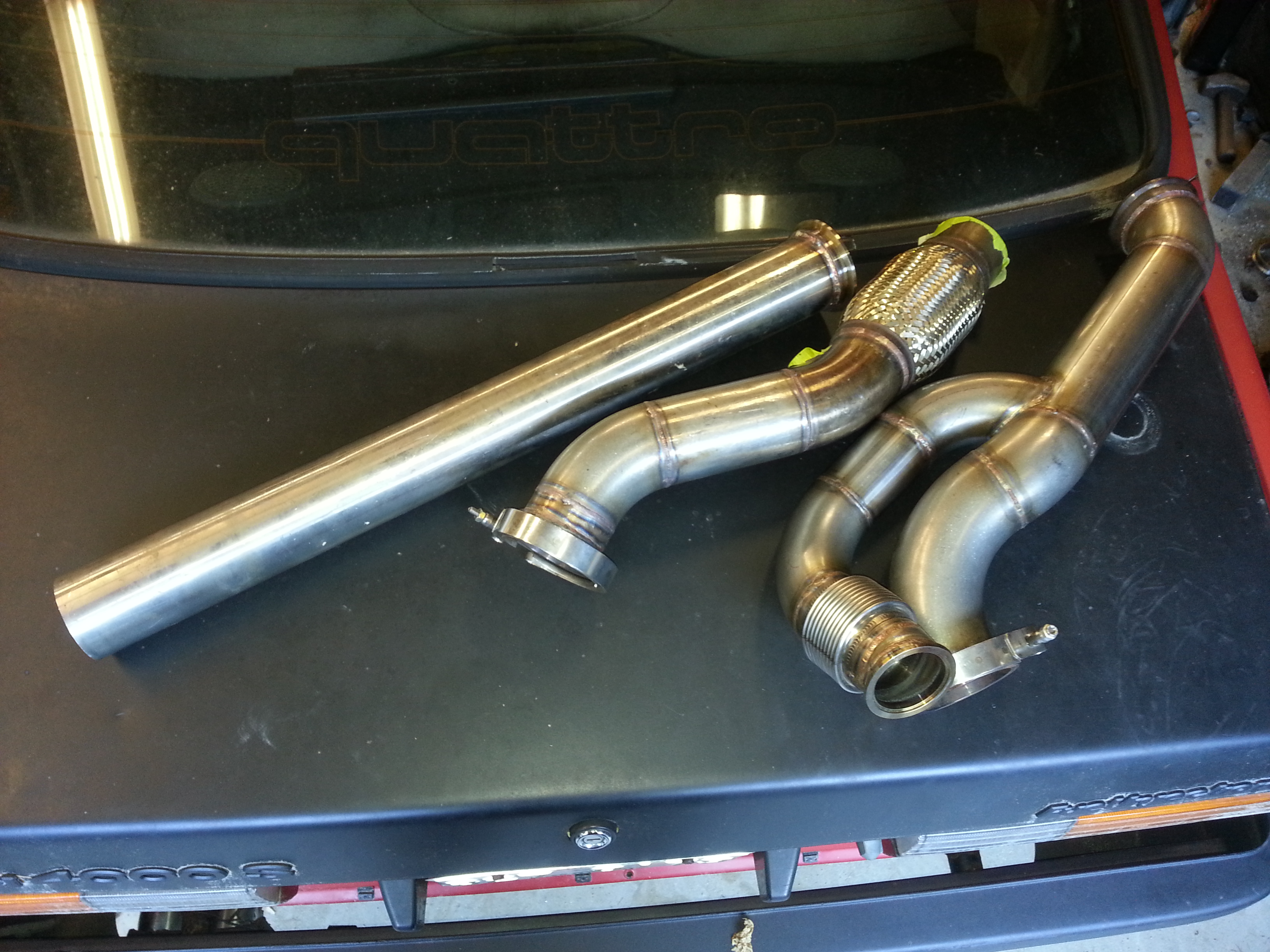

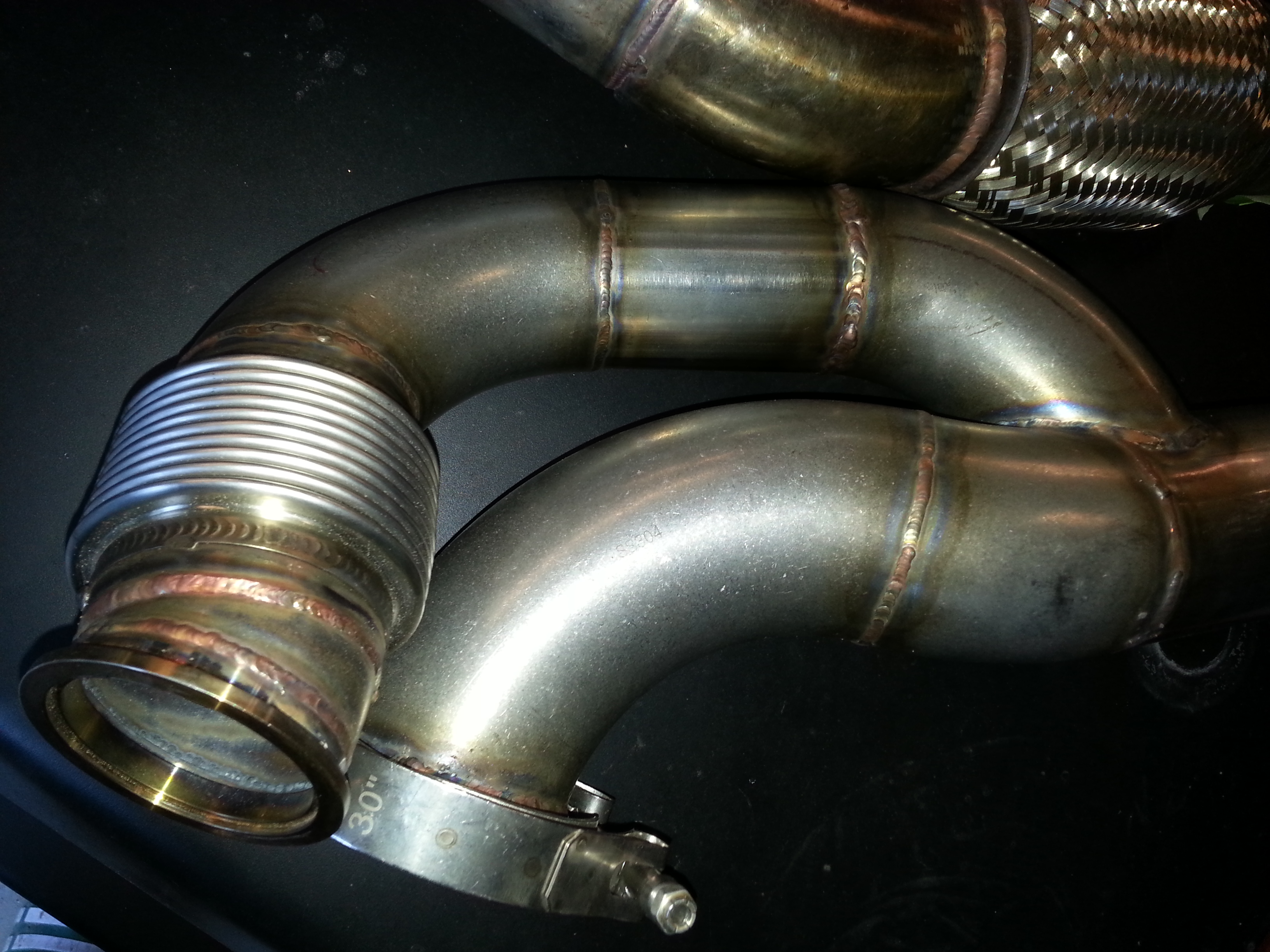

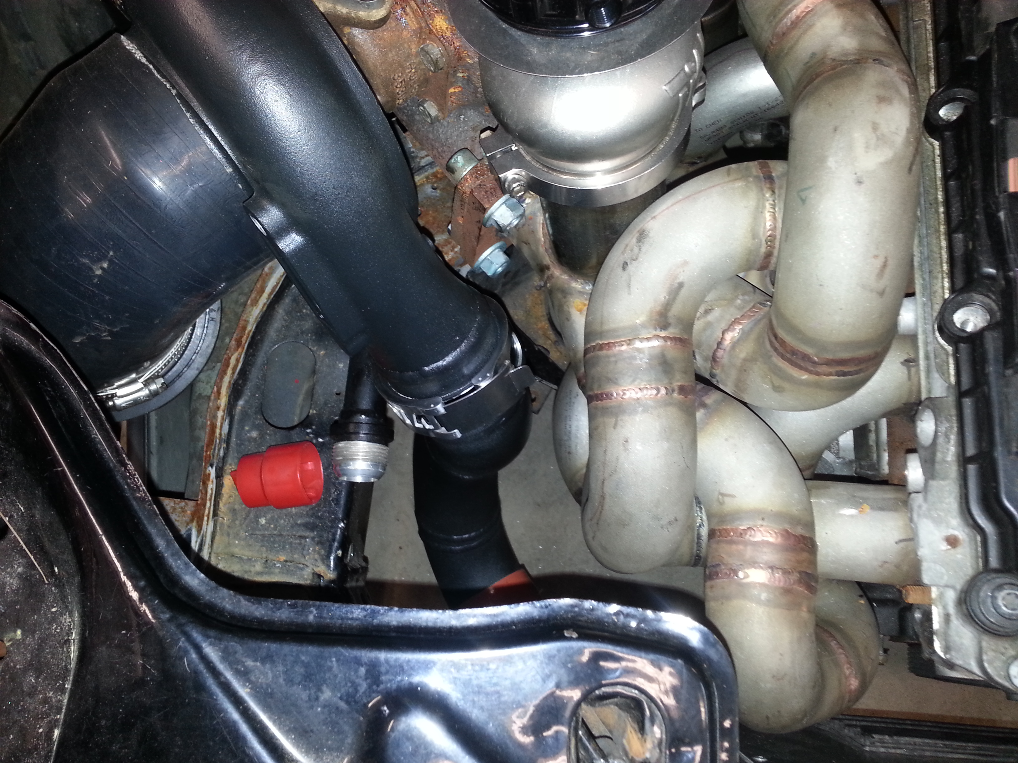

Ryan and myself finished up the DP and 90% of the exhaust. also making the center section 3", which it was 2.5 before. Then the Van-jen clamp was finished and cold side got coated. Then the injector leads were repinned for ev1 connectors.
DP action
DP action
DP for days
DP for days
vanjen clamp final and turbo housing coated.
Injectors repinned for ev1

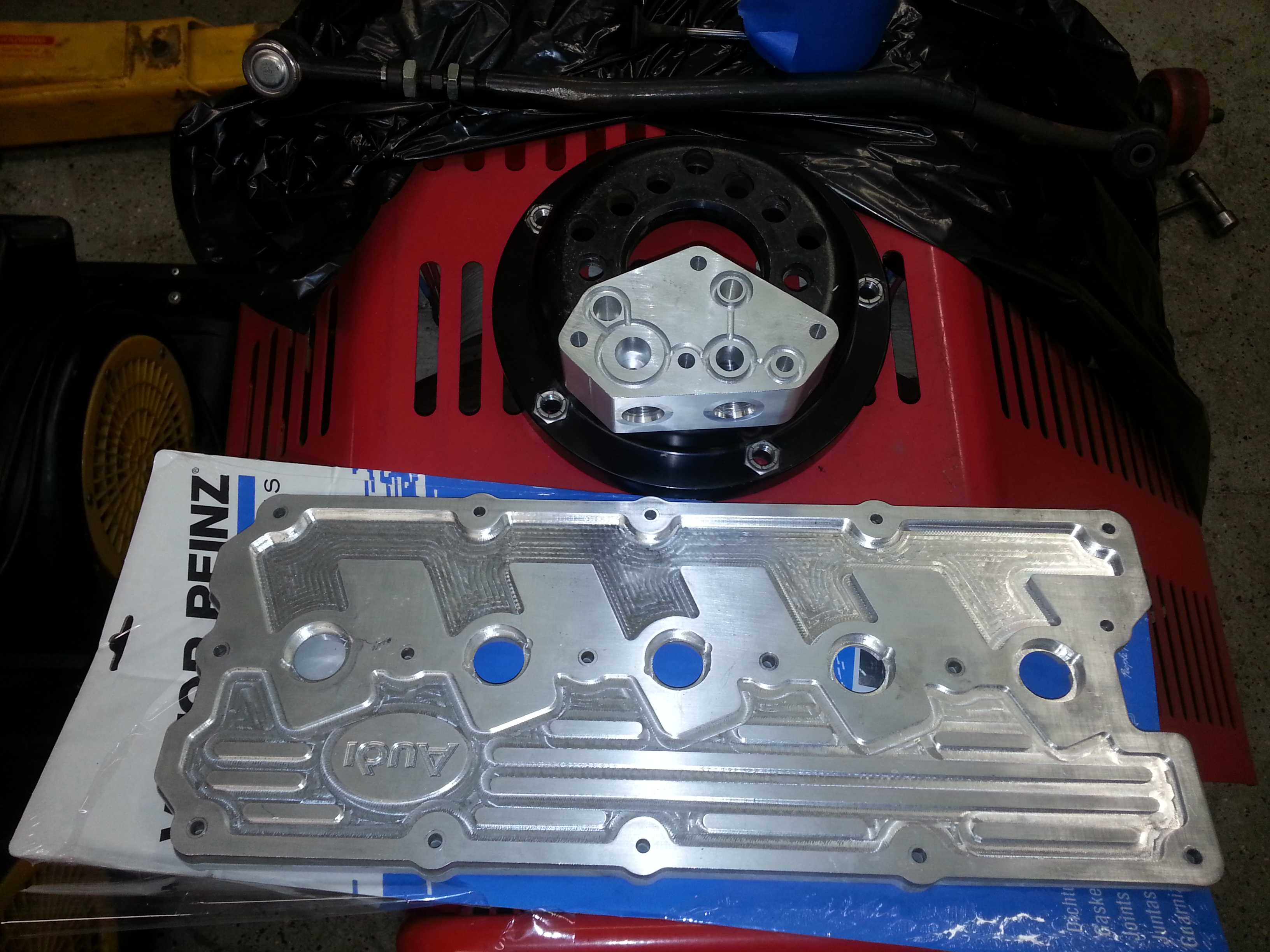

So Ive been dying to get more fancy parts. Thanks to Hank here are a couple Ive been missing.
some stuff Ive been watiing to get my hands on...
pan teaser
pan teaser
more tease
more tease

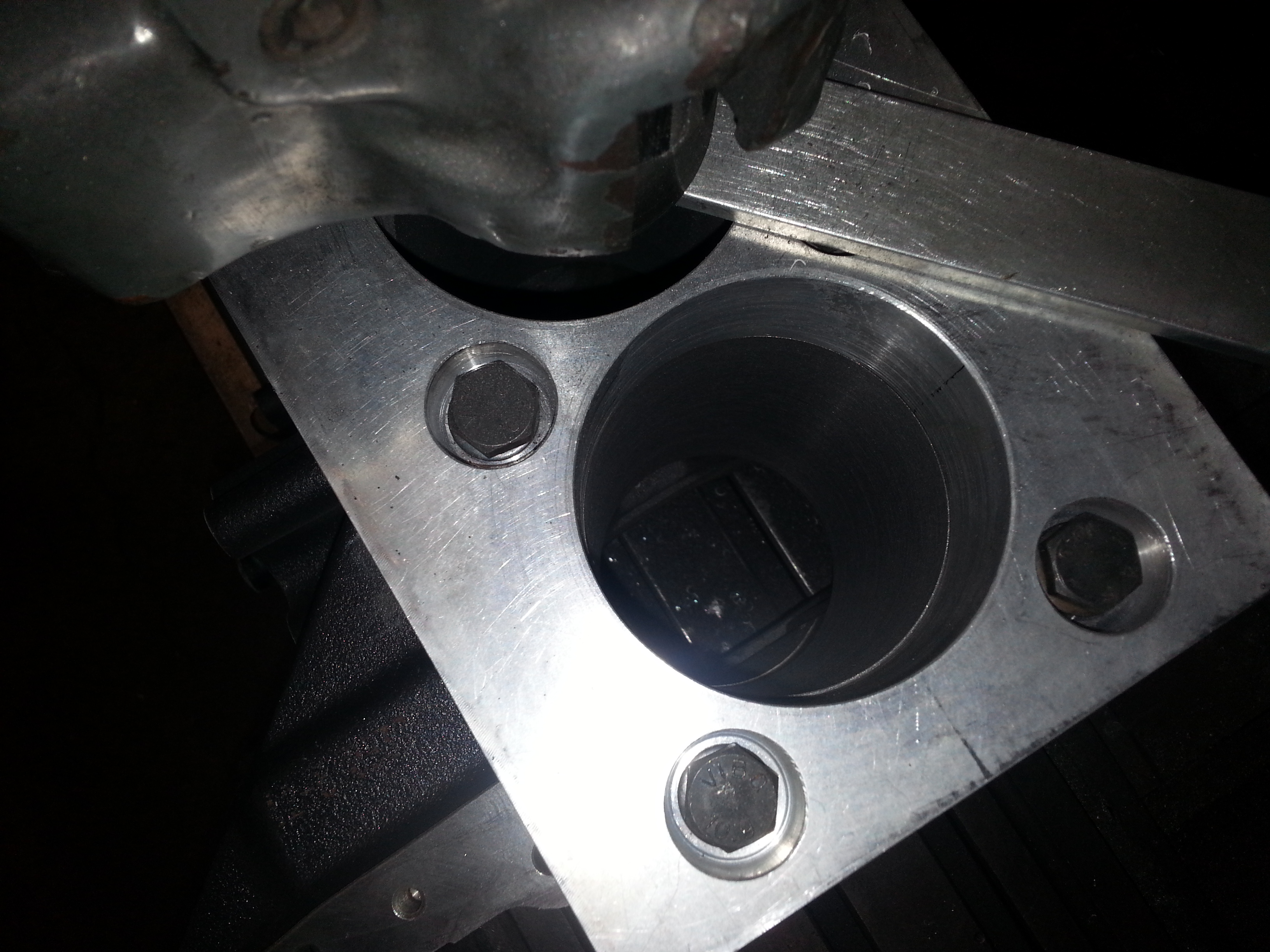

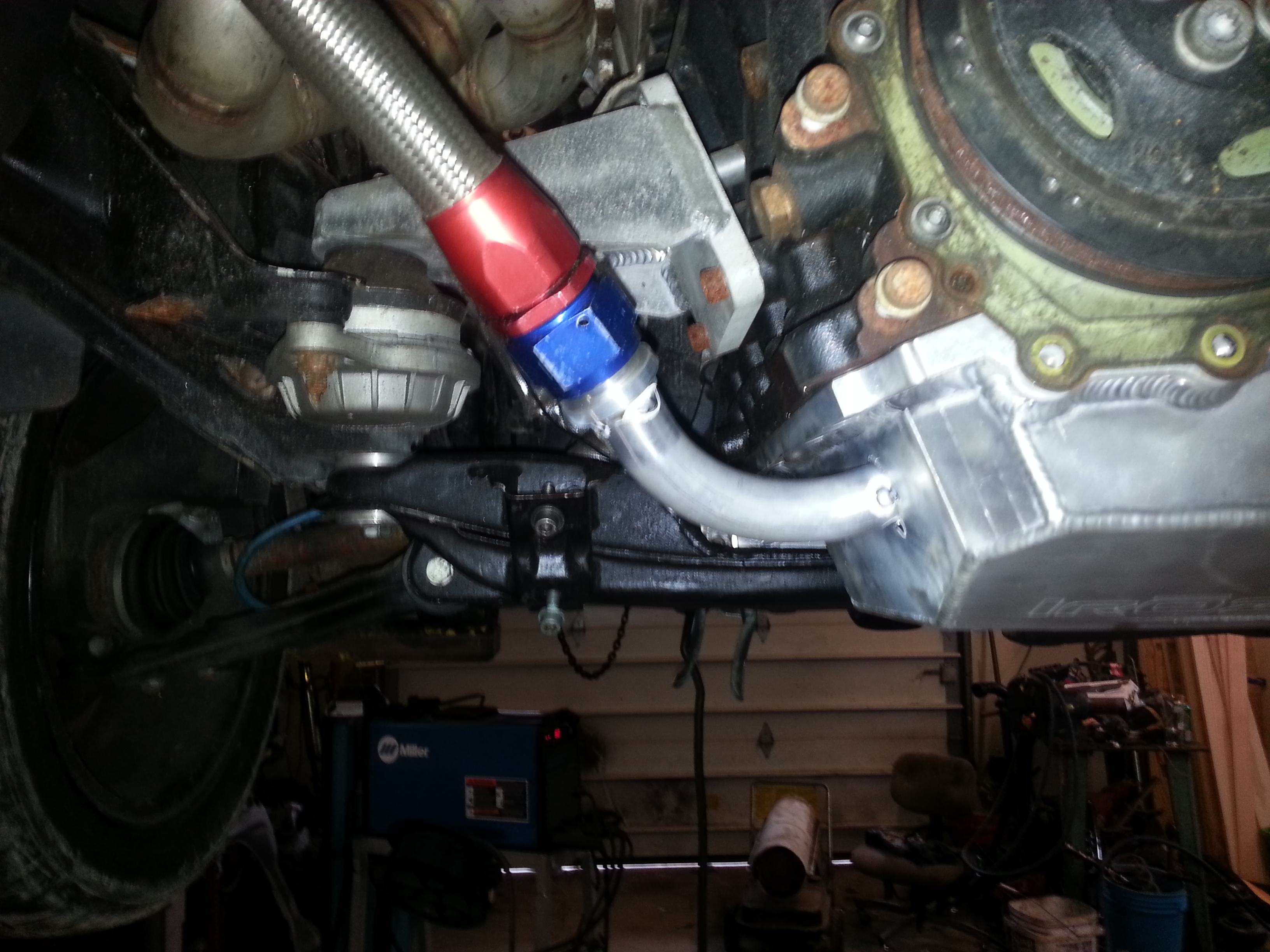

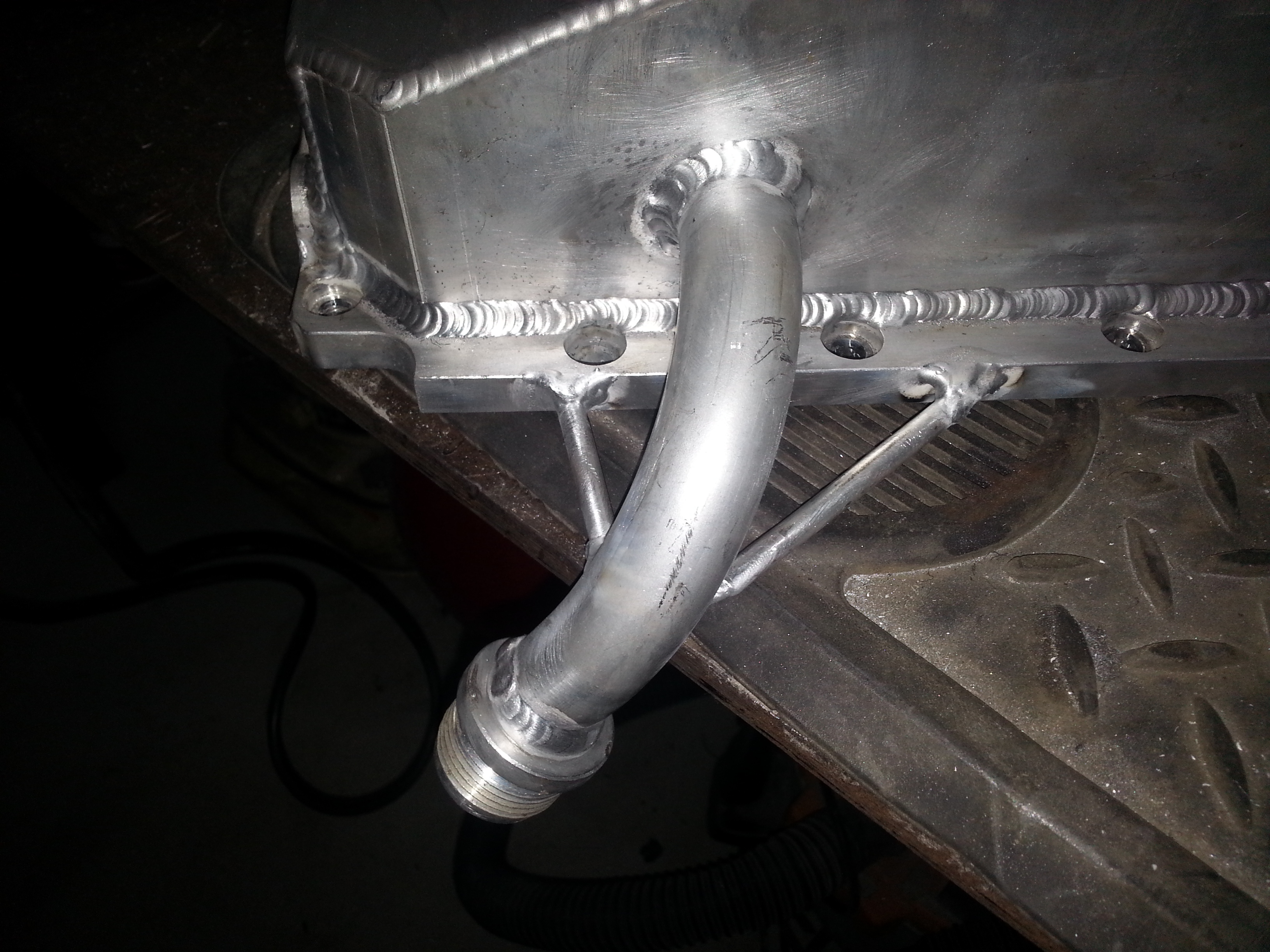

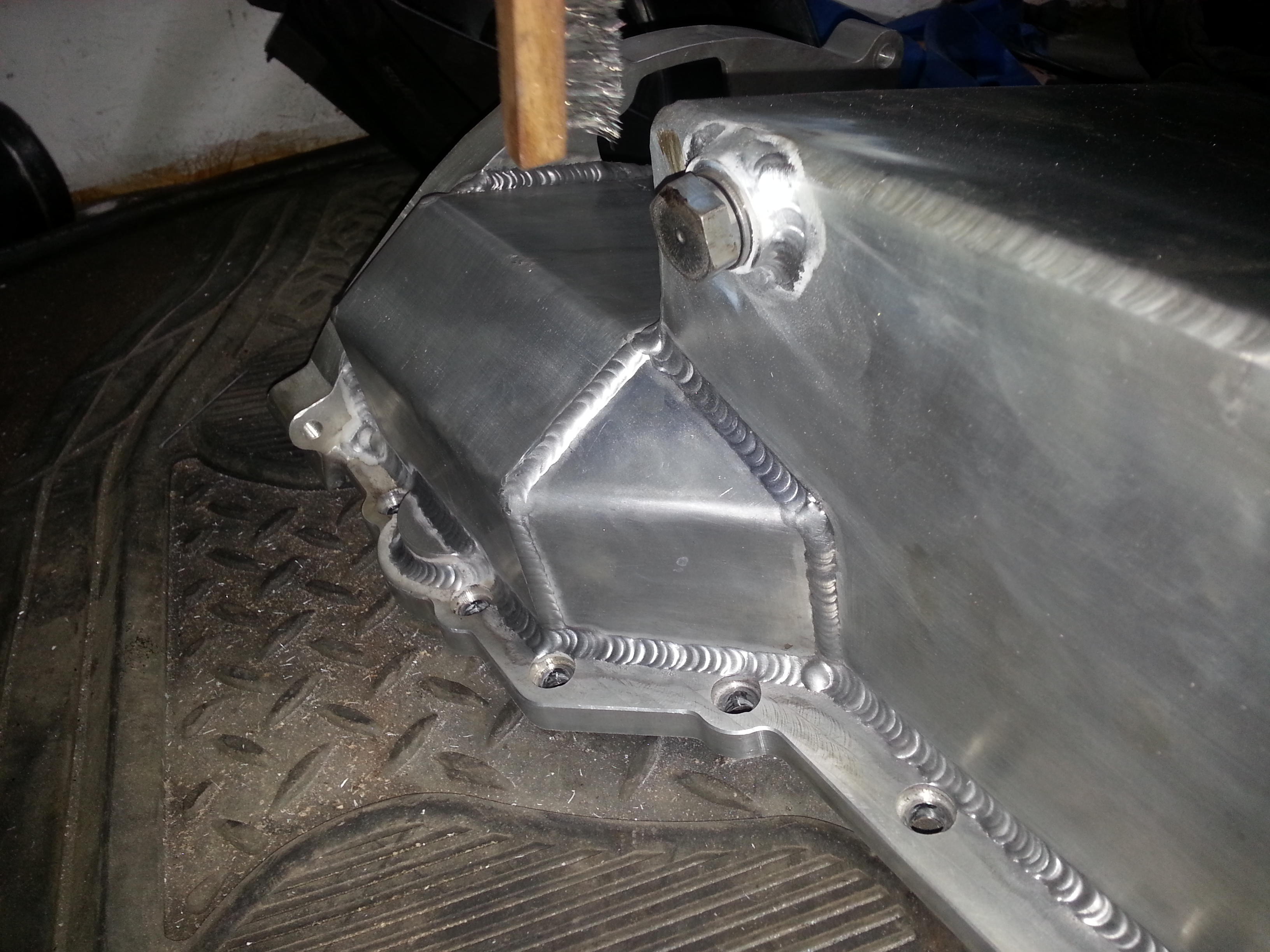

So what do you do with expensive custom one off parts...cut holes in them!
This was an early pan that wasnt finished(no drain plug\turbo drain)
turbo oil drain
turbo oil drain
drain plug
drain plug

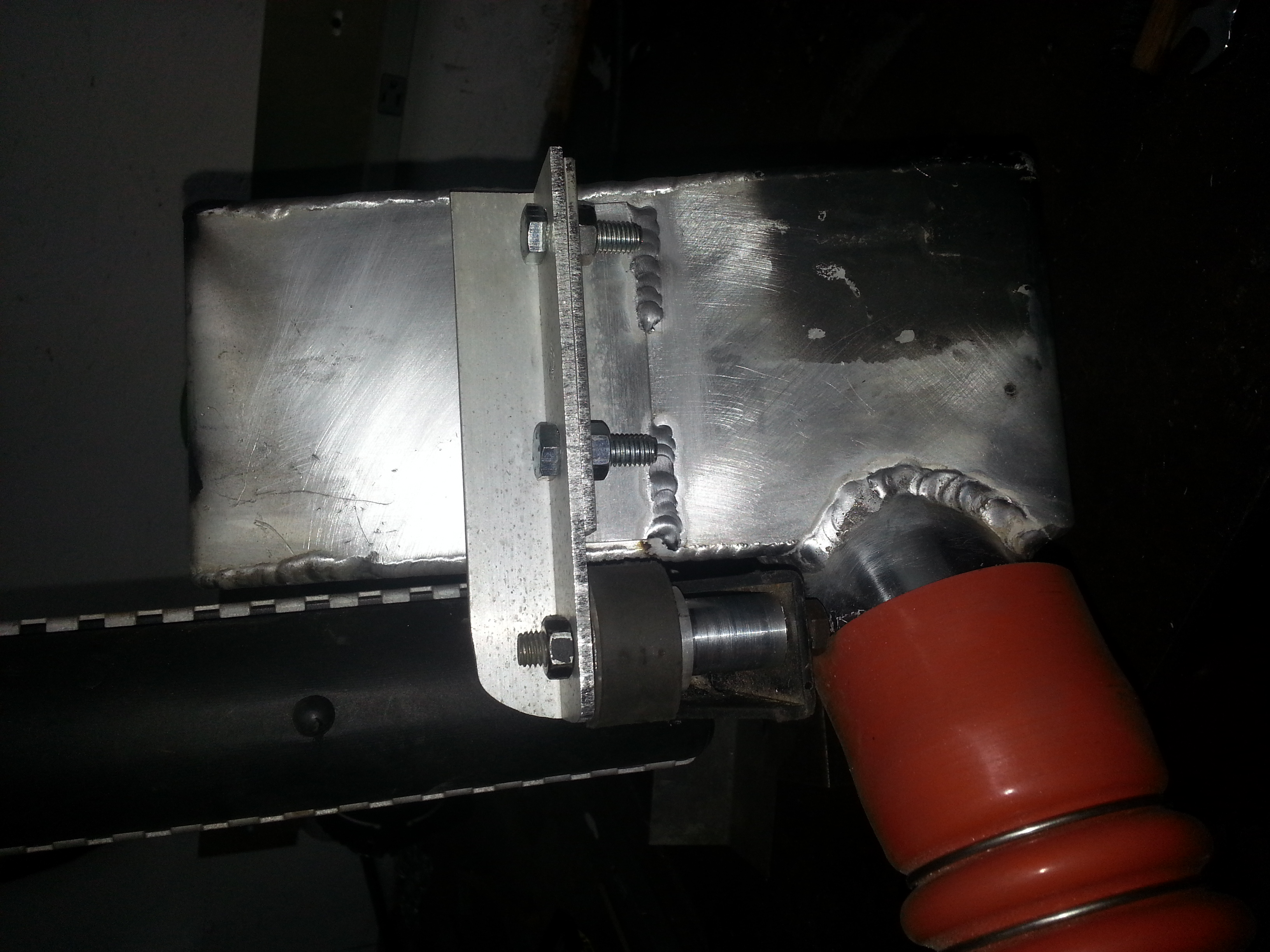

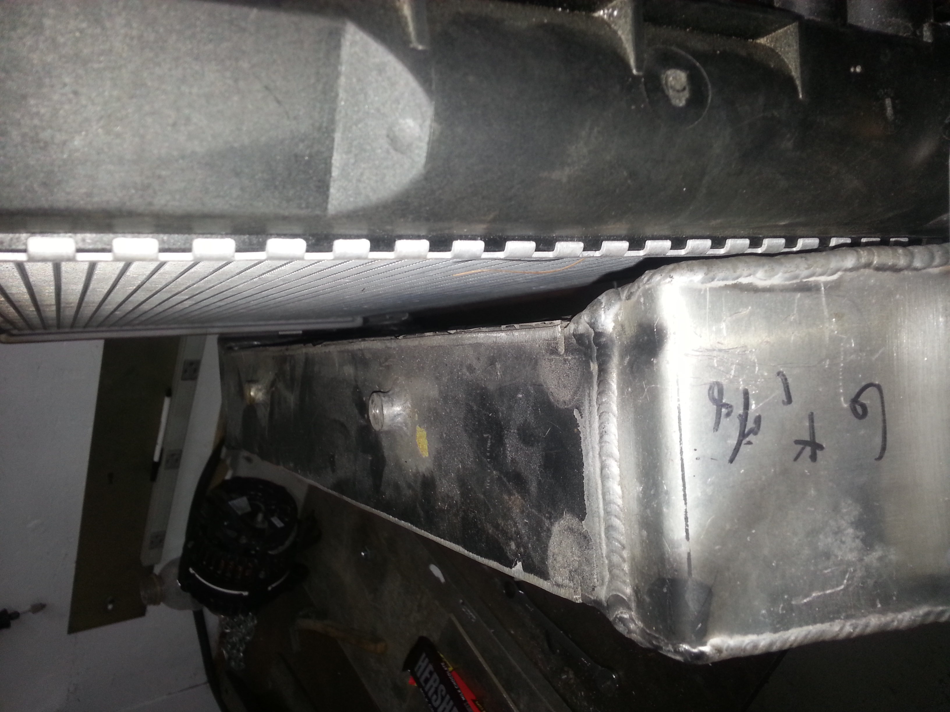

Some boring stuff but all has to be done...
boring rad mounts
boring rad mounts
rad clearance to IC
rad clearance to IC

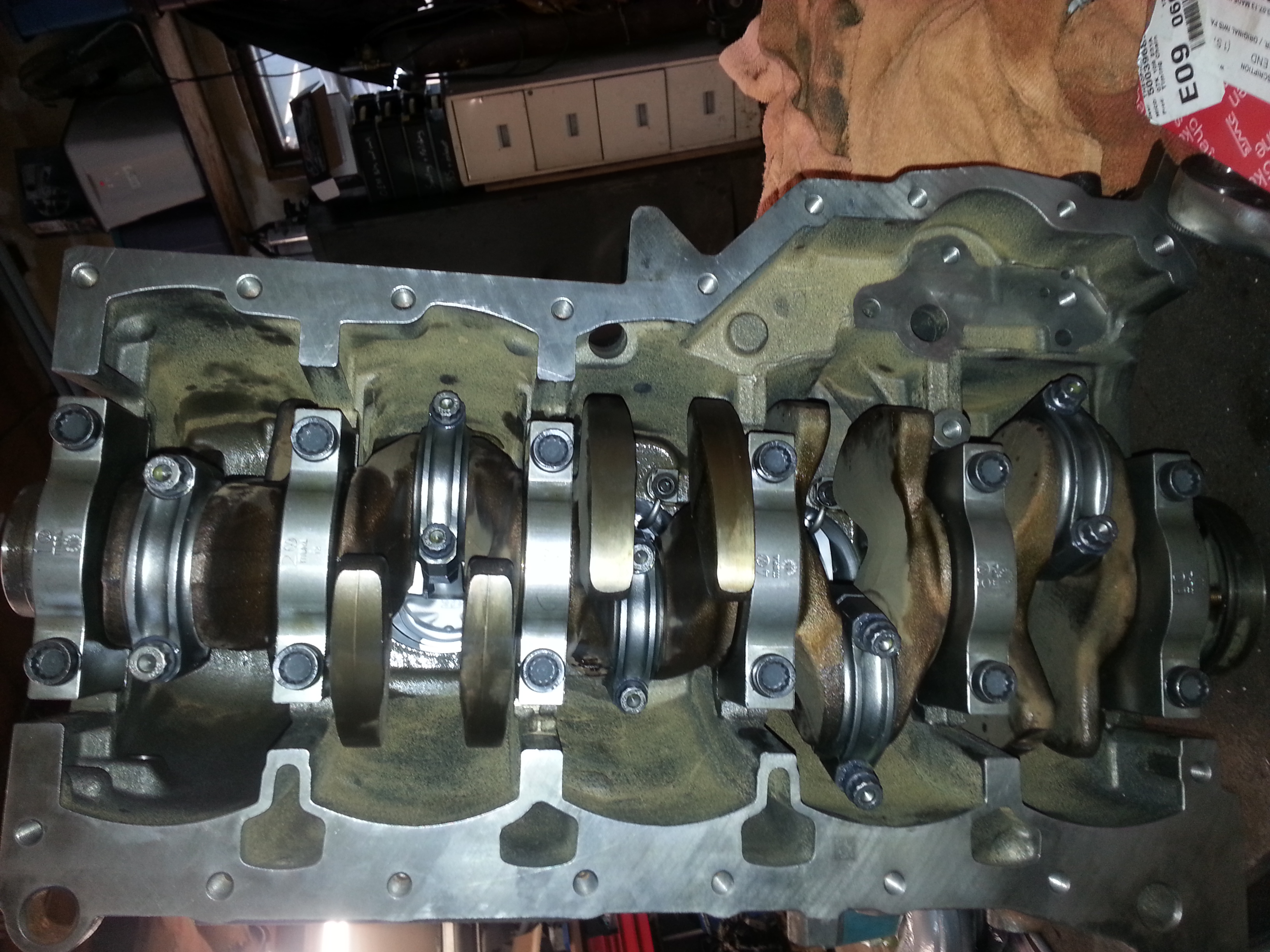

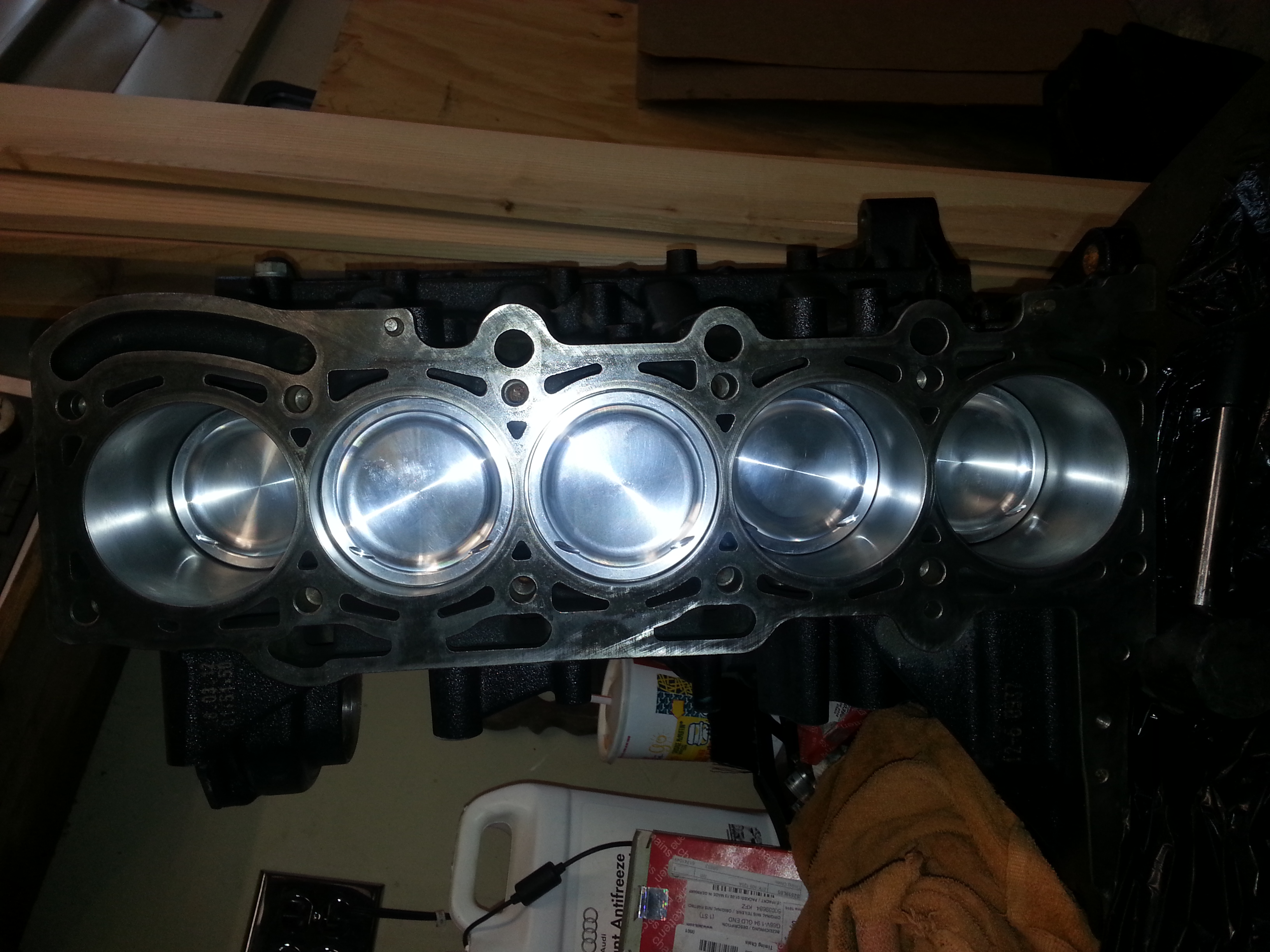

Im done for the day. Lots of progress was made and maybe I'll go snap some more pics tonight of my low miles head(28k). I removed it from my 08 07k longblock I had and prepped for installing on my now almost finished block. Heres some pics
bored to 83mm
bored to 83mm
aw theyre cute together! Marcs and mine

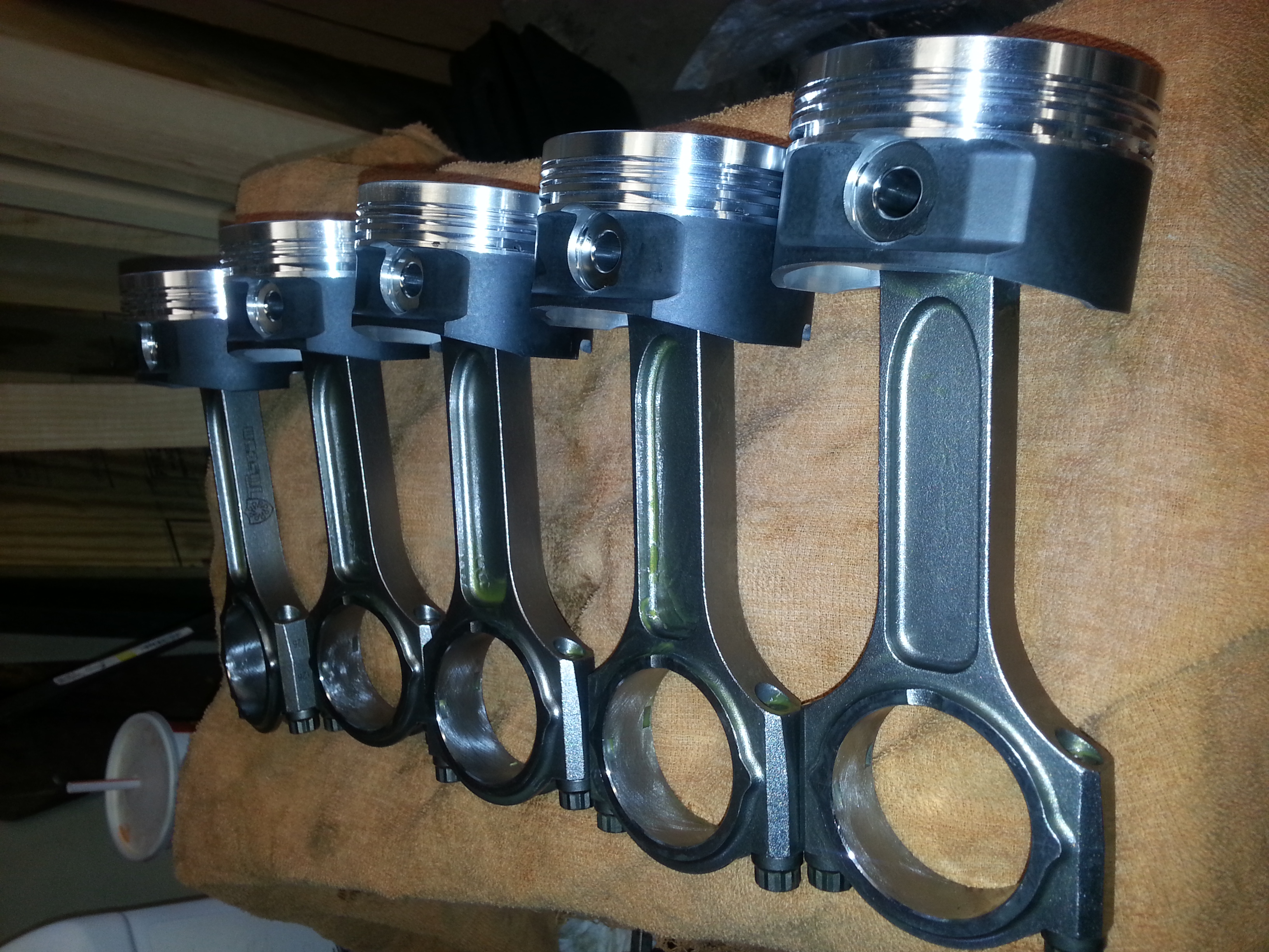

rods\pistons done. just rings now
voila!
voila!
yes i know the rods have loose bolts lol
thats it for now boys and girls. maybe ill get froggy and go snap some more pics tonight.

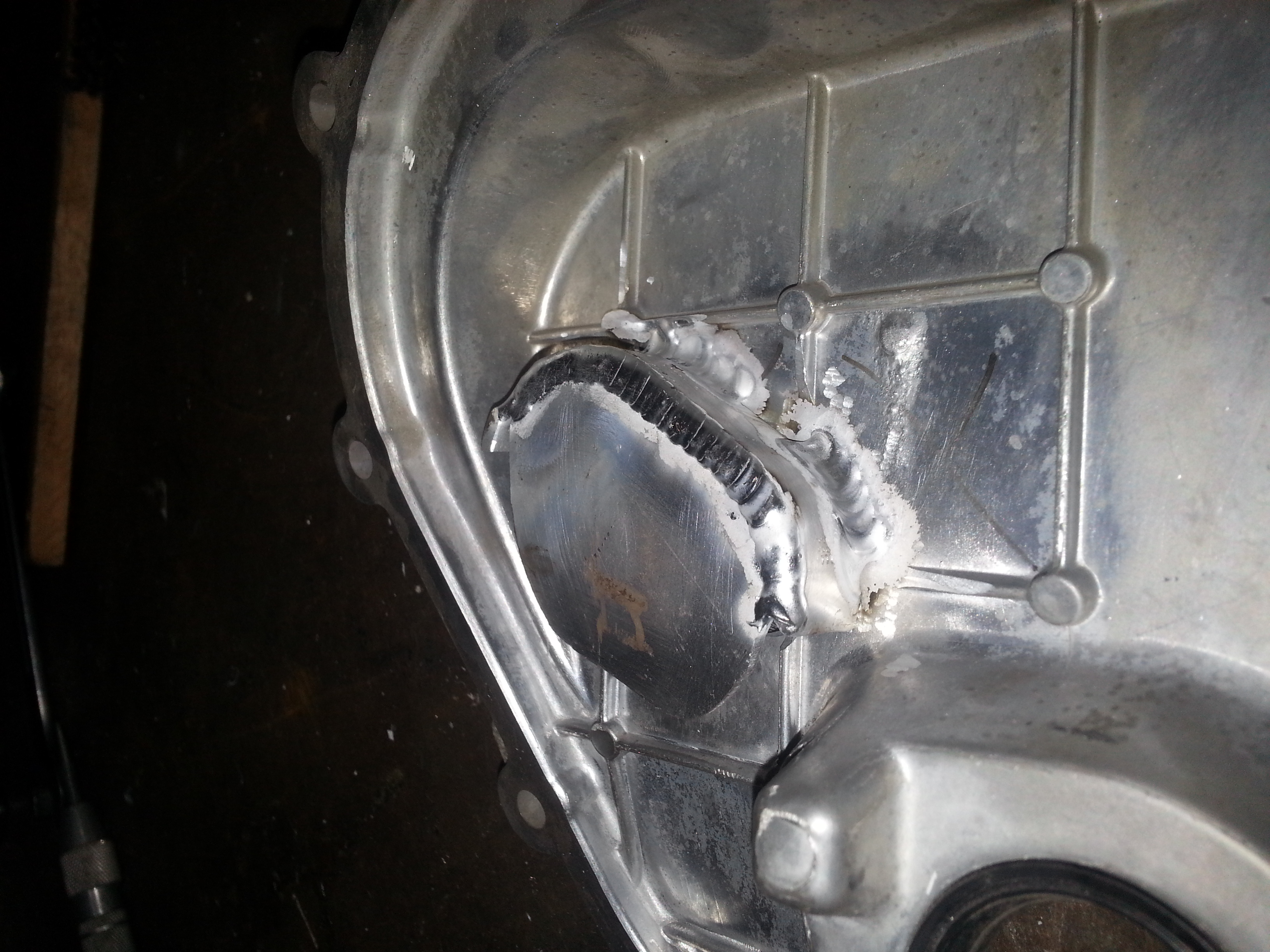

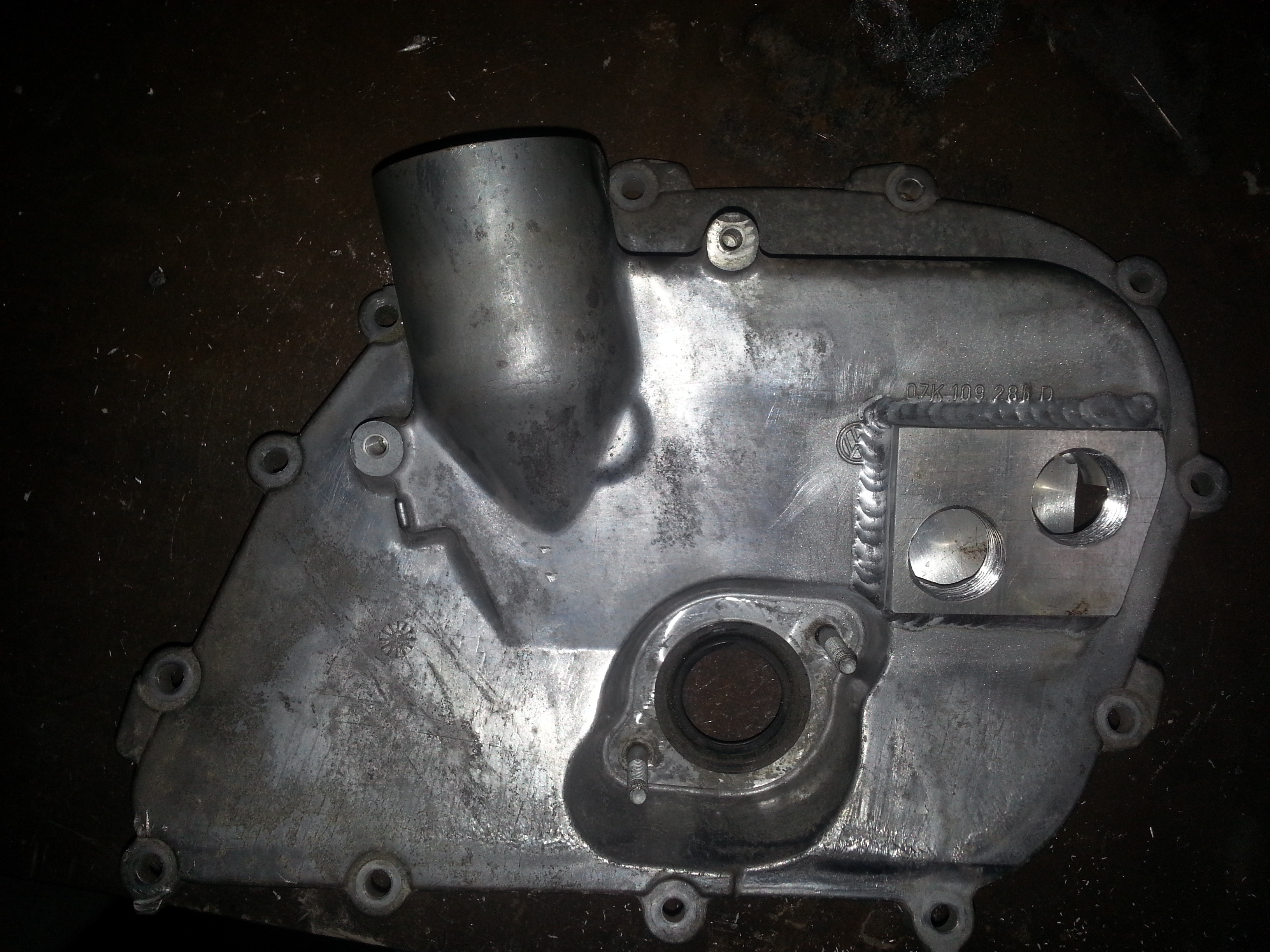

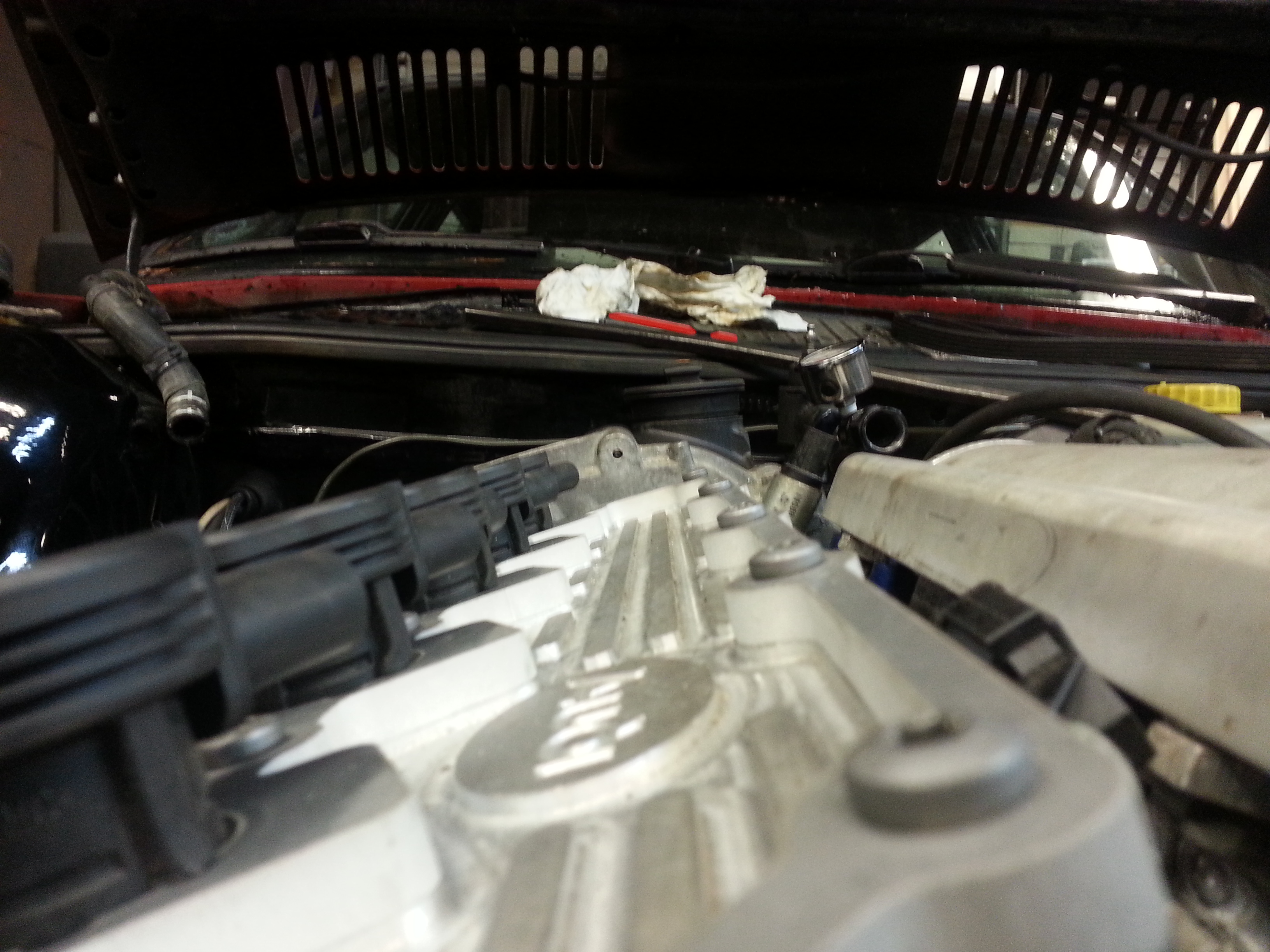

this too. shortened it at least 1/2"
for hood clearance i shortened the timing cover oil filler.

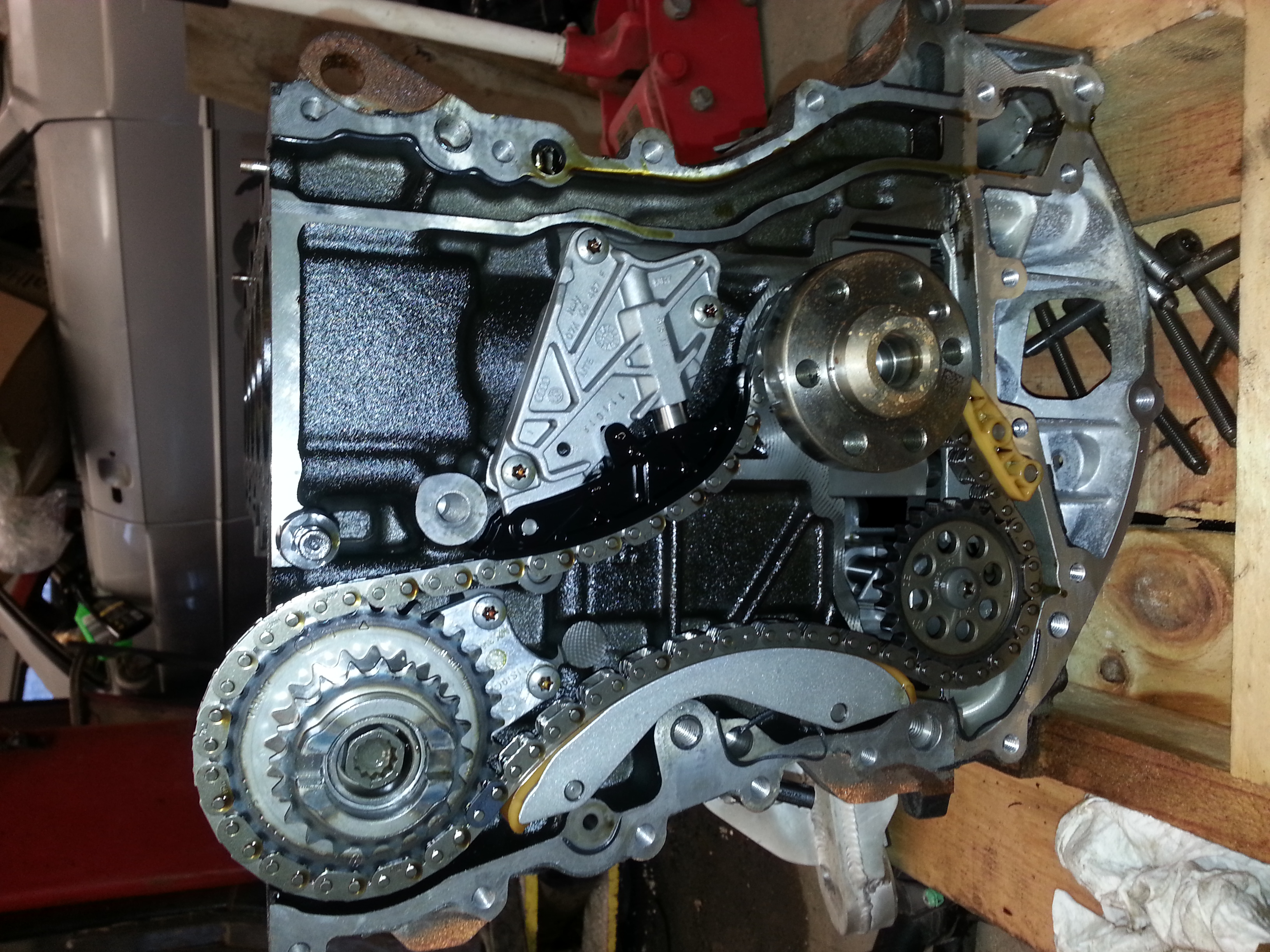

and a quick example of how simple the chain system is..
much easier than a b7 s4:-D

Oooooooh oops. The rods are Integrated Engineering tuscan I beams and the pistons are JE 2168's. Tool steel 22mm wrist pins also.
