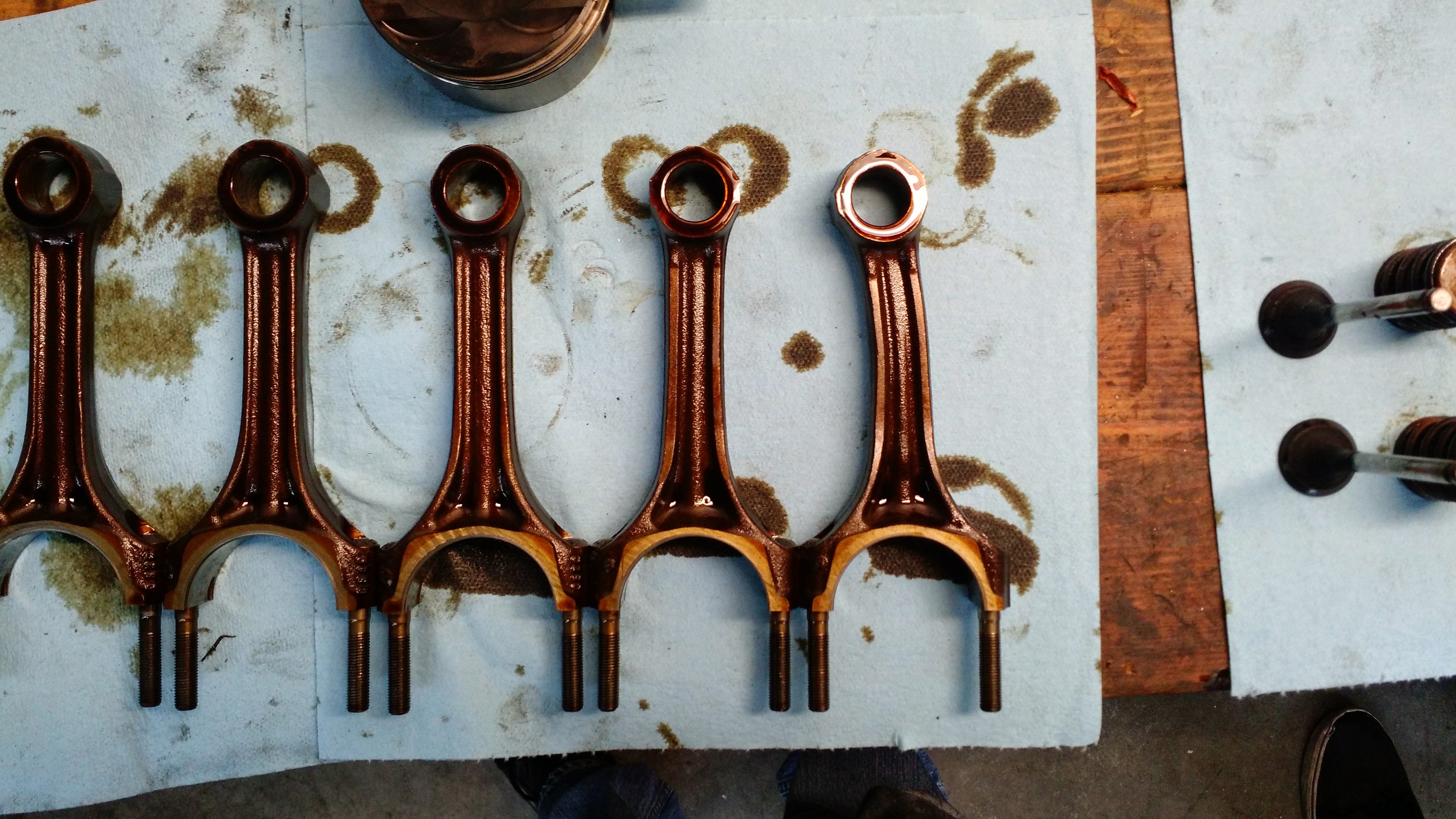

So, some things have been happening.
- IMG_20150201_160650273.jpg (2.19 MiB) Viewed 45607 times
Re: Phil's 20vt 5ktq, Get Bent
"One of these is not like the others"
Upgrade time!
So. Found a bent rod, found where the gasket blew up, got the steering rack swapped out, found a decimated pilot bearing, rebuilt the head with new Valve seals. Among not shop things, the mule DESTROYED a 335i, had some delish food, Got some fun rides in a quick car, saw some bad-ass projects, and had some fun times with Colin and friends.

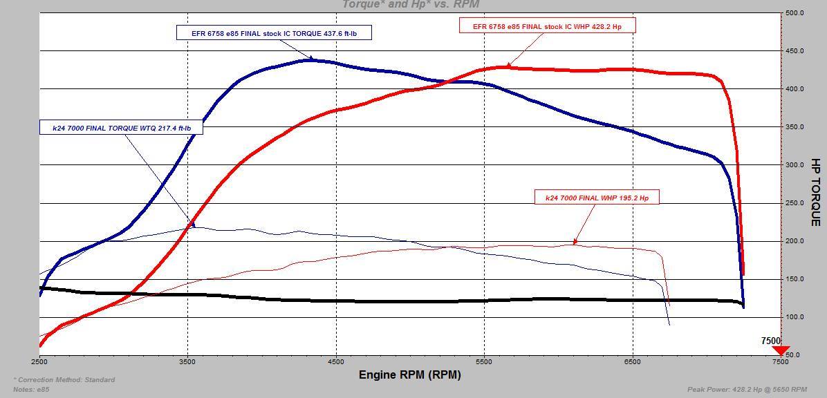

Nice! What is the mule running now, an efr kit?
That is where the FB EFR graph came from, I think... (the mule)
Wait, what?
Which EFR are we talking, for those of us not on facecrack?
Nice work, that's the turbo I picked too.
Can someone post the graph? (Do I have to ask?
I don't know why it wasn't put here in the first place.
I can do it tonight, travelling with the family today.
I can't make my phone do it.

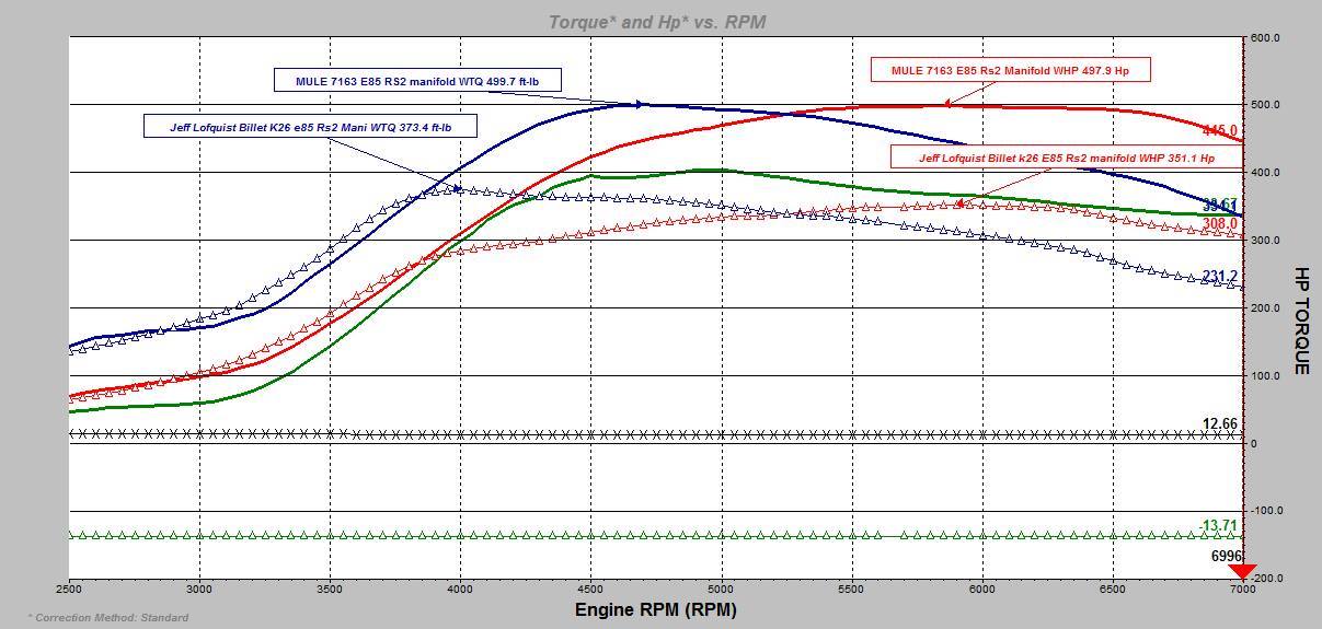

Mule on 6758
and currently mule on 7163

That is hilarious. Hank is going to have to get a new dyno that reads below 2k at the rate this is going.

I should mention, during the destruction of the 335i Colin left it in 5th and just stomped on it and STILL managed to decimate the poor guy. The spool on these things is crazy, and the powerband is fantastic. Neck is a bit sore from the pulls.
Stock ic too. Corn is amazing
Both those pulls were on the stock IC, He managed to fit a bigger FMIC in there recently, albeit a not very good one.

Dyno numbers were stock IC, The Mule has an FMIC now. (That is probably much too small, but way mo' better than stock)

If I had kept the 4k I think it would have seen an efr with qsv eventually. Damn I wish I had the money to buy that car back lol
Those graphs are awesome. So the 6758 spools like a k24 and the 7163 spools very similarly to an rs2. I would really love to see some pump 93 dyno pulls.
Spools nearly the same, transient response is (far) superior on the EFR. Especially the 6758.
