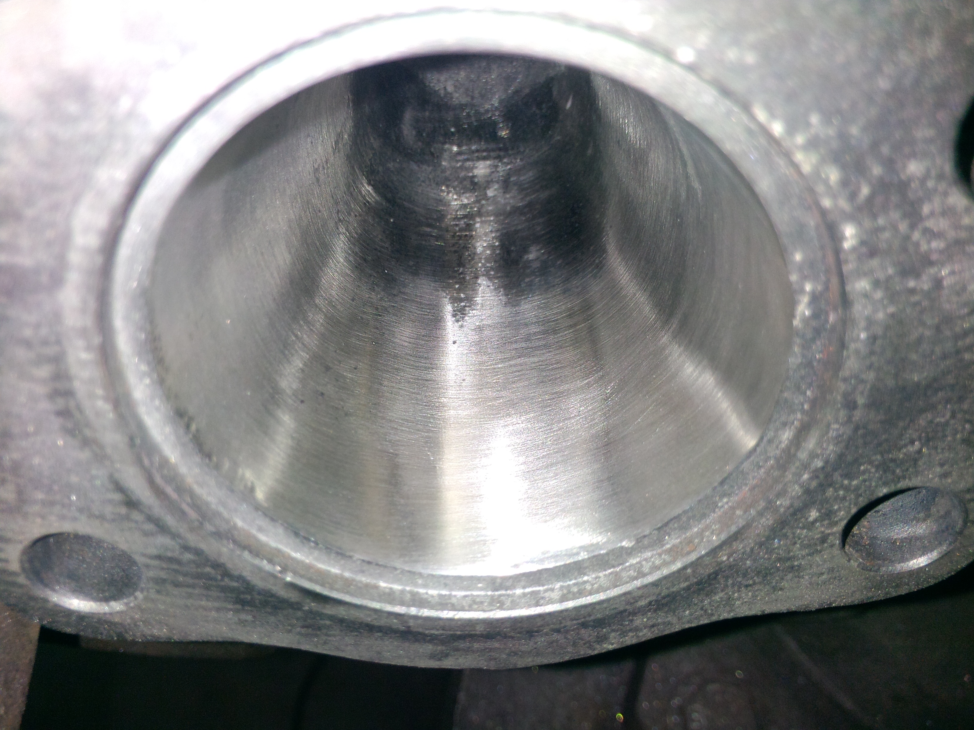

scubadave
Posts: 496
Re: Taco's 4KTQ 20vt Swap: The Red Baron - DEATH TO CIS!!!
Post by scubadave »
6 inch long shank (flame) cutting burr. 60 grit tapered sanding cones, and 120 grit flapper drum. thats not done yet either. it will be a mirror if I have the time to do so. I got maad skills.
AngryTaco
Posts: 2657
Location: Hayden Lake, Idaho
Post by AngryTaco »
Well took hotside to the ceramic coater this morning. Wanted like $100 for the damn thing. Screw that Ill just polish it completely. Ex manifold was $115. Bleh.
