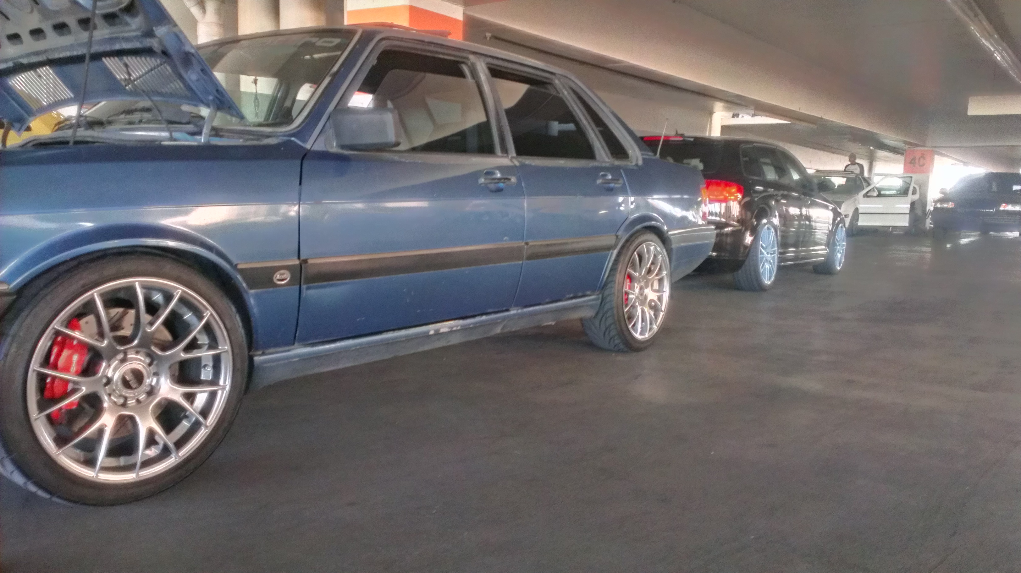

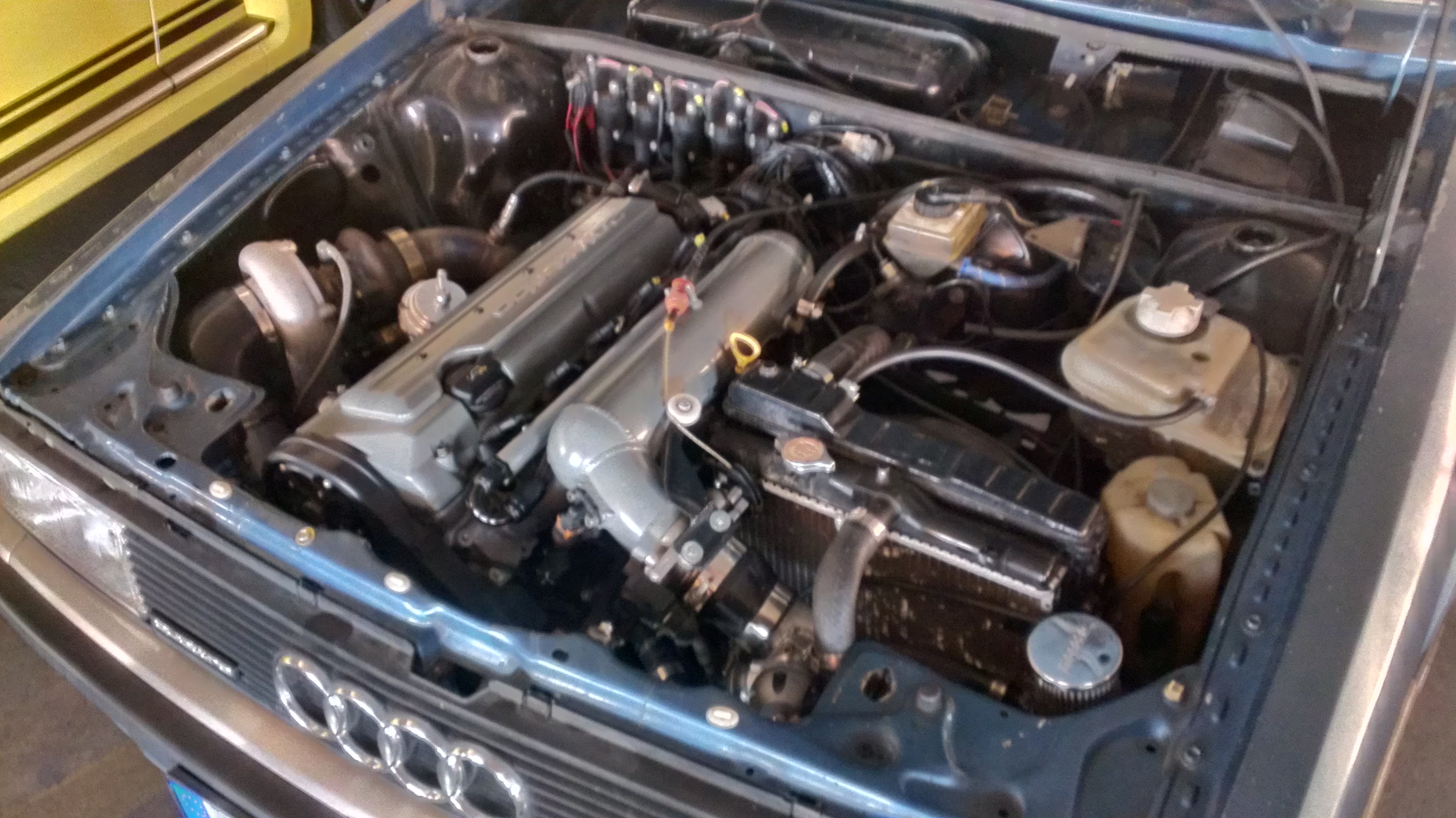

Yes. I creeped a bit on Saturday.
- IMAG0604.jpg (1.52 MiB) Viewed 37544 times
- IMAG0606.jpg (1.7 MiB) Viewed 37544 times
Re: Ben's Oceanic AAN 4kq - boost life - Visited Hank: 488wh
What's the story behind the double radiator setup?
Sam Stone
Air water intercooler exchanger
AngryTaco wrote:Air water intercooler exchanger
I forgot about that, we need IAT logs from the dyno!

I'd had a hunch that one could retrofit an old AC condenser into an aftercooler for AWIC and make use of the stock parts and placement.
Is that accurate?
Is that accurate?
Well, right now my IATs are too high under heavy load but my recovery time is awesome. So, I'm thinking with a bit more pump/volume I might be able to keep them down.
