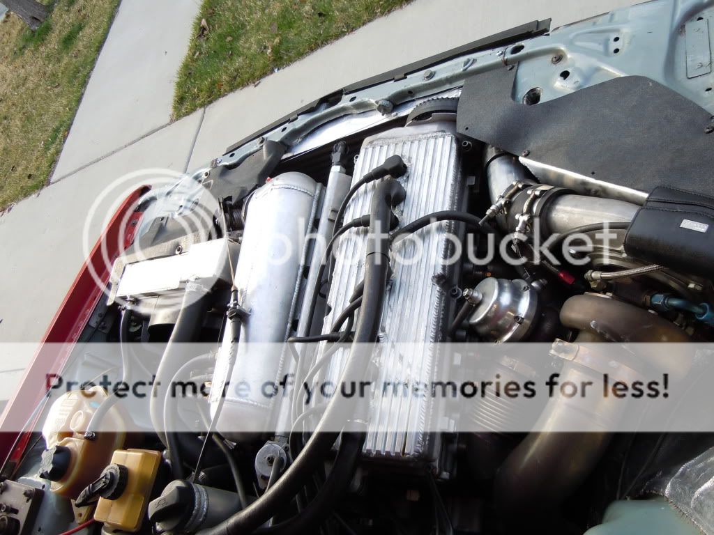

Latest revisions.. I have always like Jims routing off the turbo into the IC. IT cuts out about 12" of plumbing, plus a couple of bends. It also makes it faster to remove the turbo, and also it is easier to shroud stuff.
And so Dave would get off my back for not having dual outlets, I put these guys on. Aluminum, naturally.
Anyway, Bikes are buzzing around. The smell of spring is in the air. I had better go clean this beast before Tomorrow's dyno session! I am nervous!

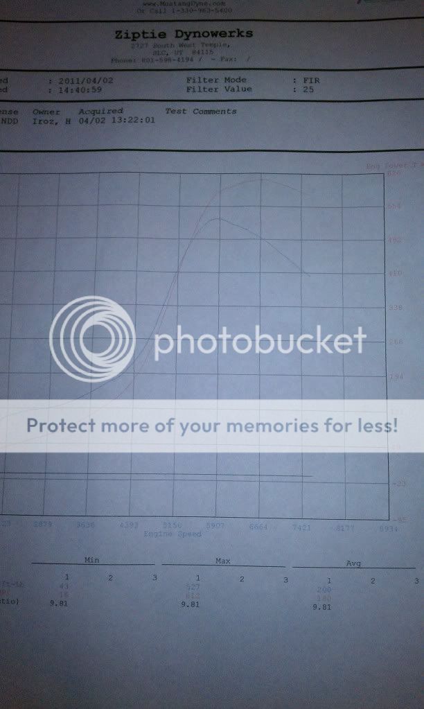

612 whp and 527wtq pretty much maxed the turbo out. Broke the awd dyno record for torque but whp was 23 shy

nice. I cant remember, did you end up putting a billet wheel on that turbo? EFR next? mwuhaha.
Re: Hanks 81 URQ Dyno 612whp 527wtq
Yes and yes Marc.. hta 3582
Very nice Hank. I guess it liked more fuel, more intercooler, and more BOOST!! I see that in Dave's thread that he did some very respectable numbers and mentioned that John's RS4 did just under 300whp. What did he think about you doubling his very nice yellow car? Wish I could have been there!! This is the same car that you drove down to Vegas a couple of weekends ago with your family (dog included) in the back seat right? Nice family ride! 8)
