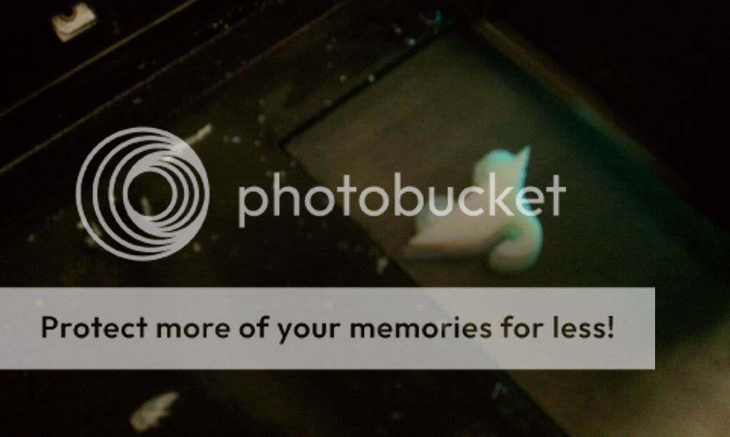

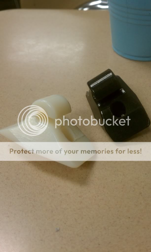

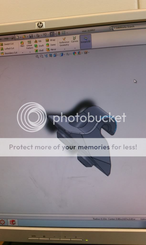

Mine were shot, when I was in Seans Helios car, I noticed they were shot, My Dad has one good set amongst 2 cars, and Swanson told me he needed some. So I looked at my fractured set and thought I would just take a simple silicone mold of the superglued version. The problem was that it was just too deformed from 30 years of use. I decided to do a ground up clip
SolidWorks Model
Sent it over to the rapid prototype

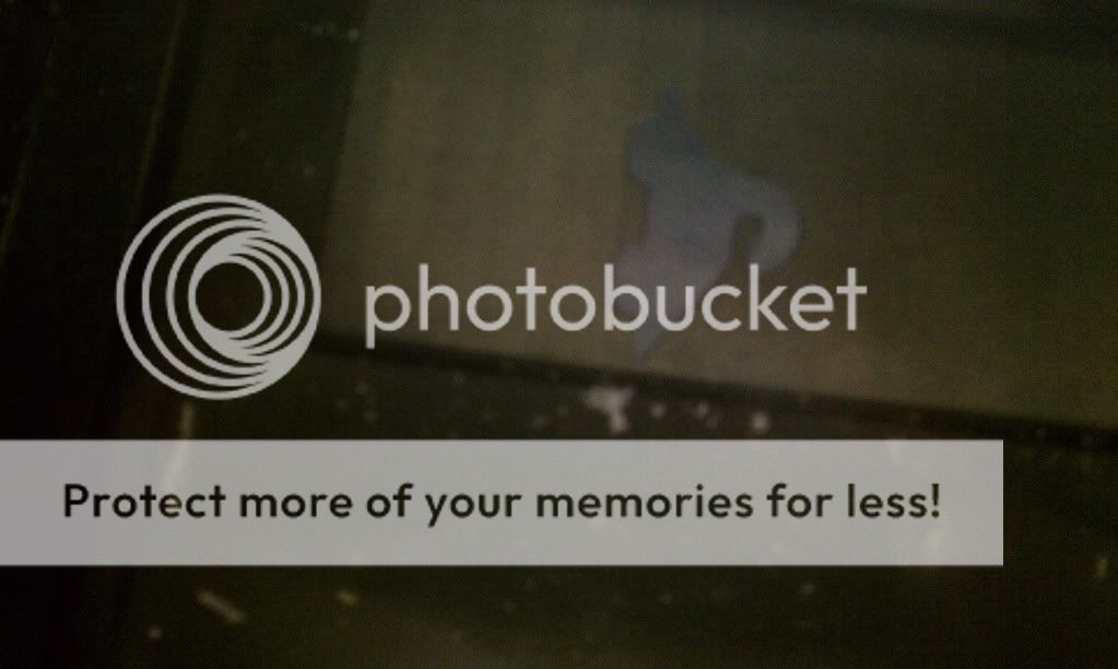

Made a silicone mold and produced these with the sprue still attached
I made some black ones for my own car as I have the suede headliner
Anyway, fun little project. The PolyUrethane I am using is a bit too stiff for the application, so I have some lower durometer Poly in order.

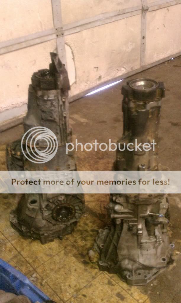

In other news, a DSY rs2 6 speed showed up at the shop yesterday in addition to the EDU 6 speed destined for the URQ the next time the drivetrain is out. The narrow 5 is holding up really well right now, so I will keep it in there till it makes bad noises. The DSY is destined for my Dads Stroker URQ monster.

Nice job on the clips Hank. It's nice having access to all the tools they have at school isn't it?
Time to get a rapid prototype machine for the lab?
Re: Hanks 81 URQ Dyno 612whp 527wtq
Very nice. I'd like to make some of those plastic trim thingies in a similar fashion

Those brackets look nice!
Speaking of brackets, your dad doesn't want that rs2 trans, it has proconten brackets... I'll step up and swap him since that's the kind of guy i am.

Those brackets should sell like hot cakes...I know mine must have disintegrated many moons ago, as there is just some plastic 'dust' left beneath the fastening screws...so I want a set too...
Question, though...why didn't you add texture and/or remove the RP build lines on the master before making your mold? Or is that phase II, now that the approach worked for you?

cbrydon wrote:Those brackets should sell like hot cakes...I know mine must have disintegrated many moons ago, as there is just some plastic 'dust' left beneath the fastening screws...so I want a set too...
Answer to the question is that I started on Friday and had to have it turned in on Tuesday :)
I have already sanded down one of the poly pieces smooth to get rid of the support material and rapid lines. I will make a master mold of that one with pull out cores so no final machining is needed. Then I will probably make 5 separate silicone molds so that I am not waiting 15 minutes to produce just one. I Probably could have just turned in the RP version and received a good grade, but I wanted to make them in quantity.
So yeah, Phase II will have more flex and no texture like the factory pieces. The factory pieces are actually pretty poor on casting/ parting line quality.
