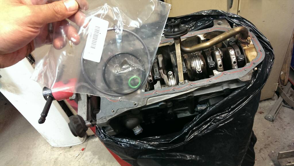

Anyone have clue what these extra gaskets go to?
Re: A tale of Rubí... Bottom End Assembly Commences w/PICS
Posted: Fri Jun 07, 2013 5:14 pm
by Toph
Splitting hairs but I'd think that more rows/in³ would be the more efficient.
More surface area exposed to cooler air, also agree with the hair splitting :D
Medium one looks like a tstat oring...
Small one looks to be the size of the water manifold orings (three of em though...and I've only seen those in yellow, so I'm not sure)?
Large one may be for the water pump?

They were in with the oil pick up gasket and O-Ring... I'll confirm in the morning once I get back at it...

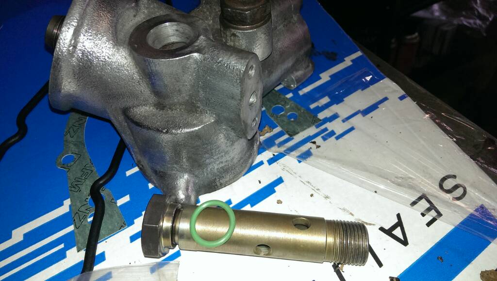

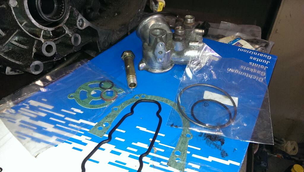

Confirmed that the green one is for the oil filter housing bolt... The other 2 in the above pic are indeed for t-stat housing and water pump...
Still got a few more to go... I've got the green gaskets already in the right places... But the other ones are still in question... As I go along it may become clear where they go, but I don't wanna go so far to have to undo it all again for 1 overlooked seal...

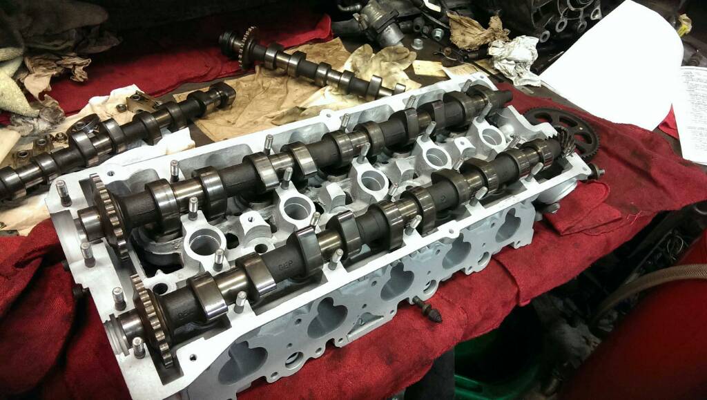

How about AAN exhaust cam on the intake side paired with 7a exhaust side?
Posted: Mon Jun 10, 2013 12:53 pm
by EDIGREG
That will work just fine, but the most gains are with both 7A intake/exhaust
Posted: Mon Jun 10, 2013 1:11 pm
by Hank
Use 7a exhaust on both :) Some machining/degreeing required.
Posted: Mon Jun 10, 2013 1:50 pm
by mushasho
7a & 7a it is... Assembling now..
