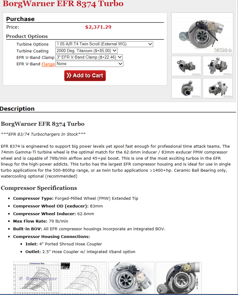

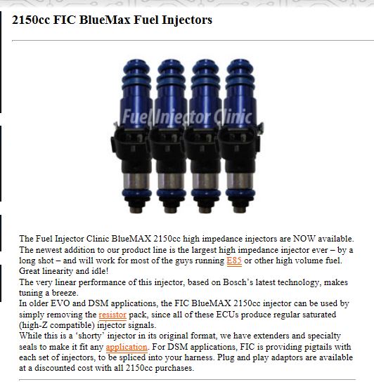

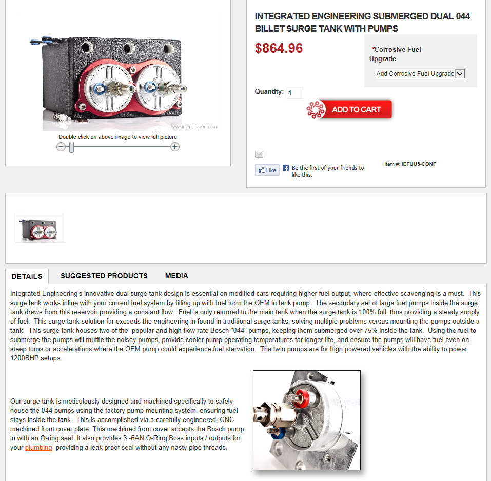

So I bit the bullet and forked over the dough for a my turbo, fuel injectors, surge tank with pumps, and fuel pressure regulator. I have the fueling situation taken care of. factory pump in the tank feeding an Integrated engineering surge tank with dual Bosch 044 pumps, feeding to a 034 fuel rail to 2150cc Fuel injector clinic injectors. That should take care of that beside a good fuel filter and a cute fuel pressure gauge under the hood.
Then I ordered a Borg Warner EFR 8374 Twin Scroll T4 built in waste gate 1.05 A/R. Should work well with the Quick Spool Valve.
- 2150cc Fuel Injector Clinic .JPG (69.52 KiB) Viewed 35617 times
- BW EFR Turbo.PNG (221.08 KiB) Viewed 35617 times
- Surge Tank and Dual Pumps.PNG (304.63 KiB) Viewed 35617 times

Rather than a fuel pressure gauge under the hood (mostly useless), get a Honeywell digital fuel pressure sensor and wire it to your VEMS ECU. Then you can view it in the cabin and more importantly, log it. Marc can provide the sensor.
Re: Josh's 2.5 200QT
Nice catch... It's on the long list... Find anything else? Pretty random order jotted down as I pictured what is left ...

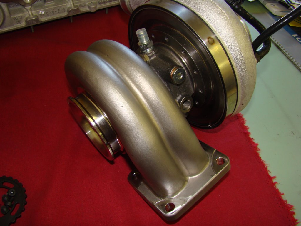

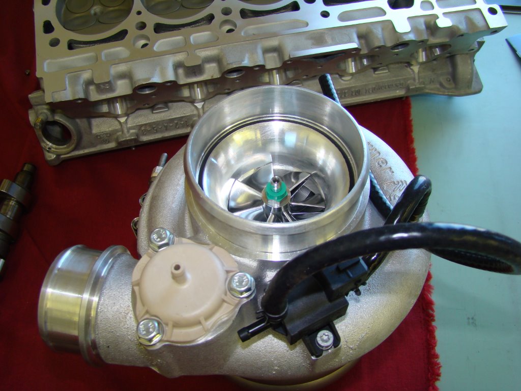

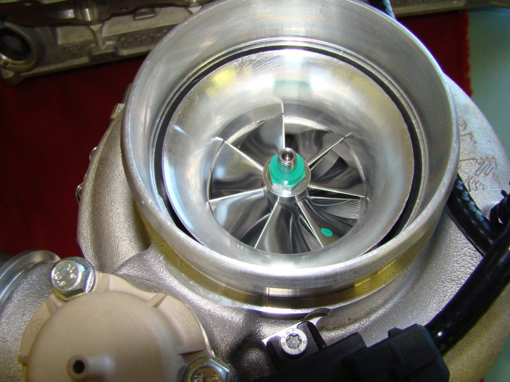

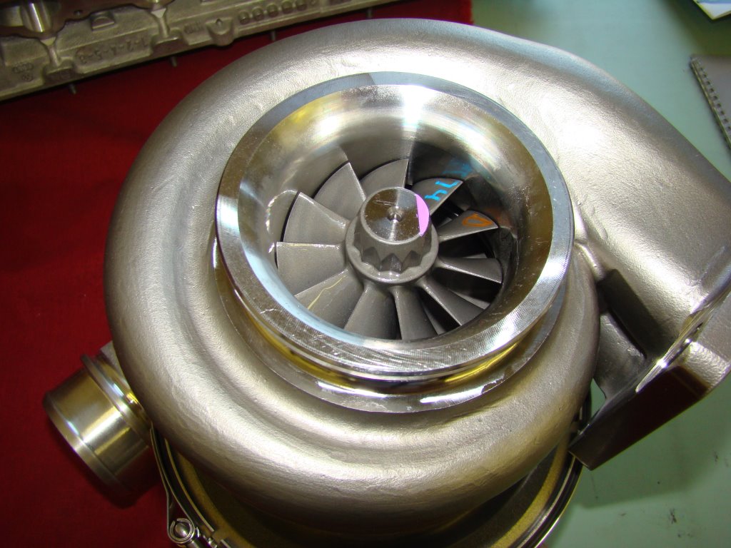

So I feel better about receiving my Borg Warner EFR Series Turbo. When I heard about these, I heard they were the best on the market but could not be had because of the stainless investment casting on the hot side. I heard that Borg Warner sub contracted this portion out and the majority of the housings could not pass QA inspections. I guess that is how this line got a bad rap and got many people pissed off at the looks of the hot side and how long it took to actually get one. Full Race was offering free ceramic coating to hide the looks of the hot side for a while. I like the way they are coming out now. I guess this is the new batch or series that are shipping out. I wanted to polish it to make it look better but it doesn't look all that bad to start with. It took a total of 5 business days from the time it was ordered until the time it was received. Back in the day when I used to call 034 Motorsport for parts, they told me a 1 year wait list.
So the rumor of having to wait 8 months to a year is cleared up. Full Race (Which is the main dealer that worked with Borg Warner) did tell me about 2 months lead time. I guess it is who you order it from.
So the rumor of having to wait 8 months to a year is cleared up. Full Race (Which is the main dealer that worked with Borg Warner) did tell me about 2 months lead time. I guess it is who you order it from.- Attachments

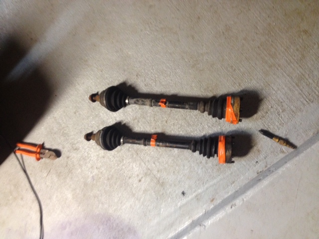

got the old axles separated from the old transmission and sending them to Hank so he can fab them to the right length for the O1E.

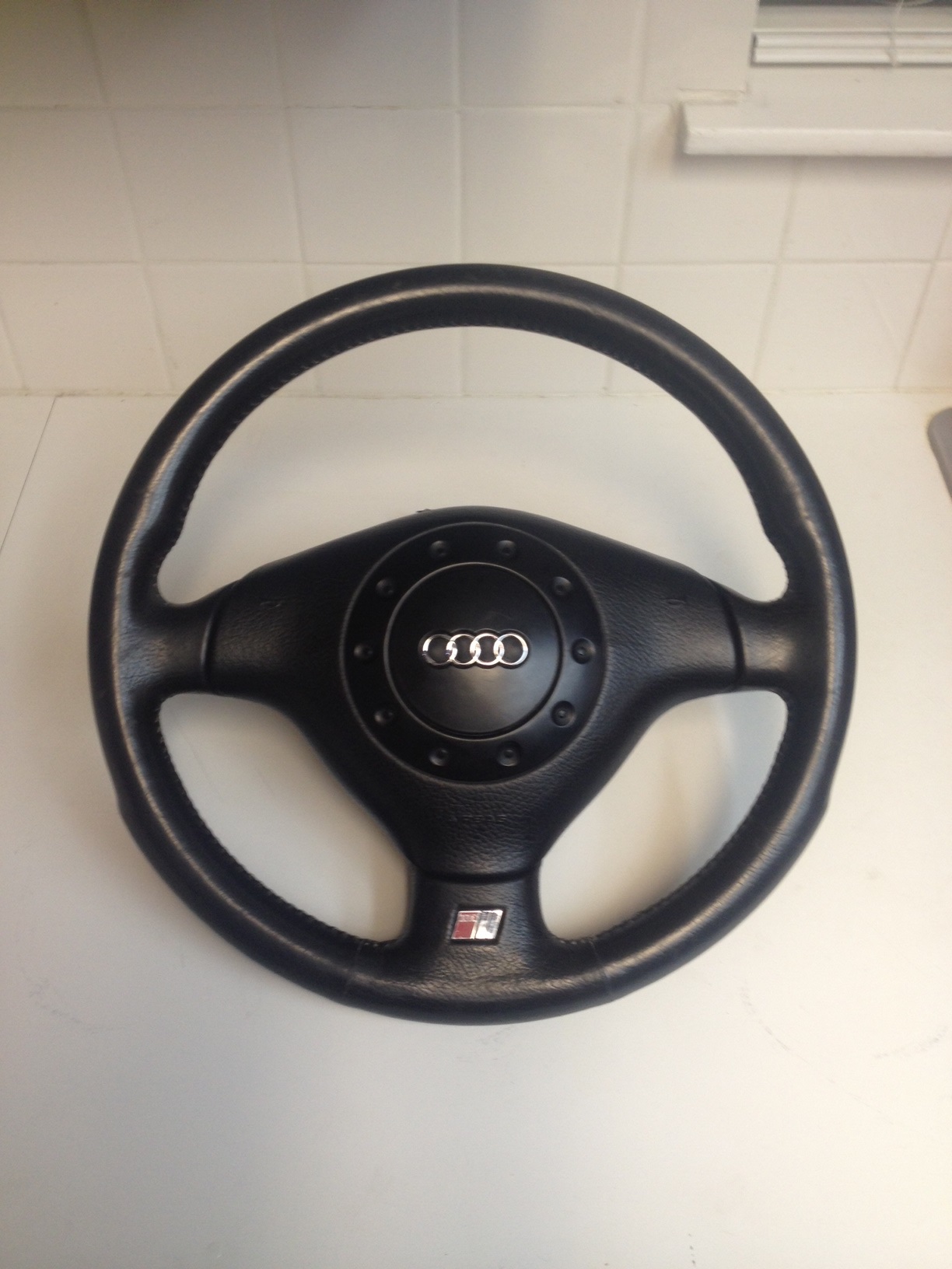

boring update but I got another project puzzle piece tonight. I was really shocked at how much the wheel and air bag actually weigh. If I had to take a guess, I'd say it weighs over 20 pounds. It looks good though. It should help bring the feel of the car out of the 80's with the ugly rectangle 4 spoke steering wheel.
- S-Line 3 Spoke Sport Steering Wheel.JPG (360.12 KiB) Viewed 35448 times
