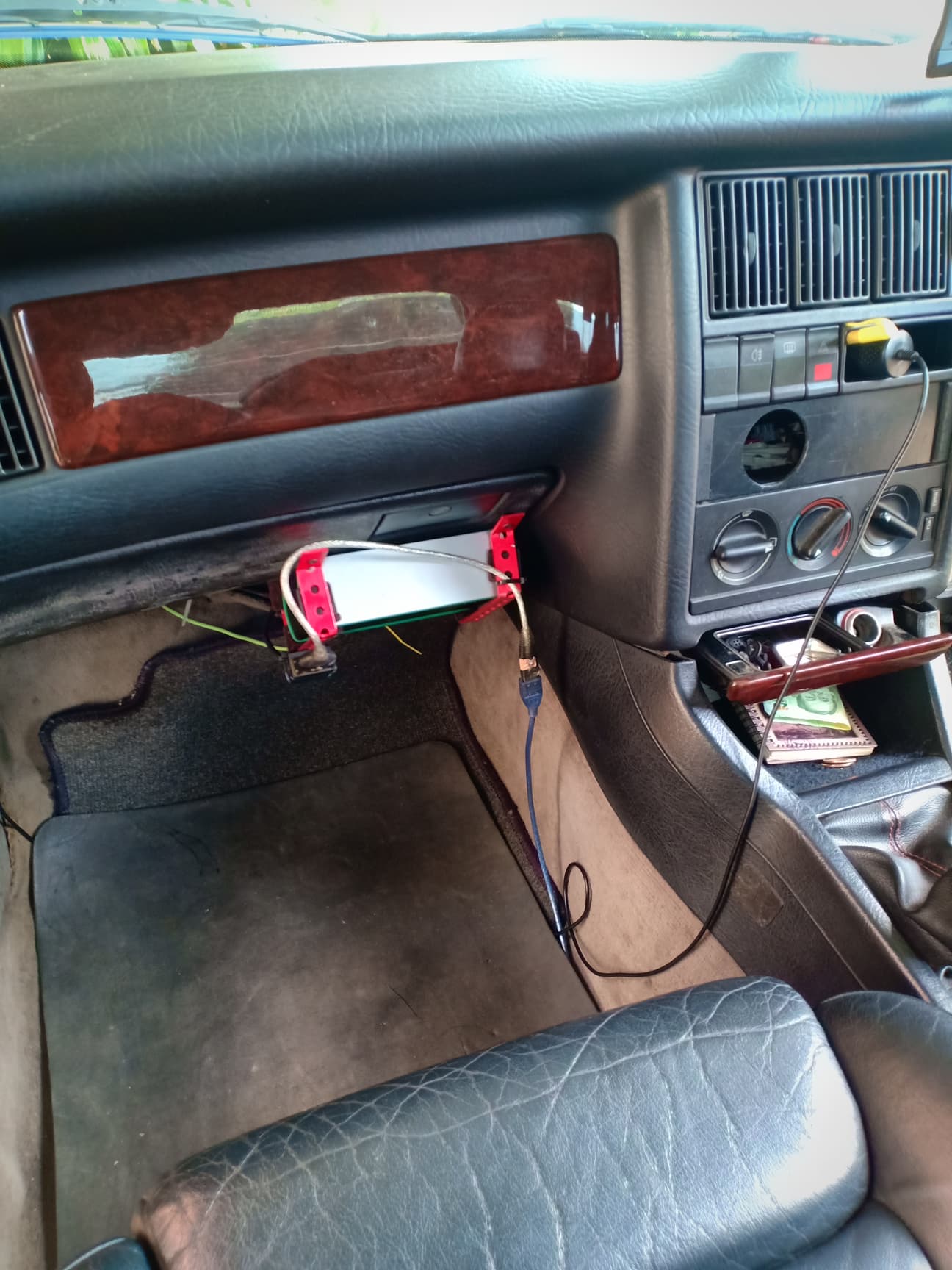

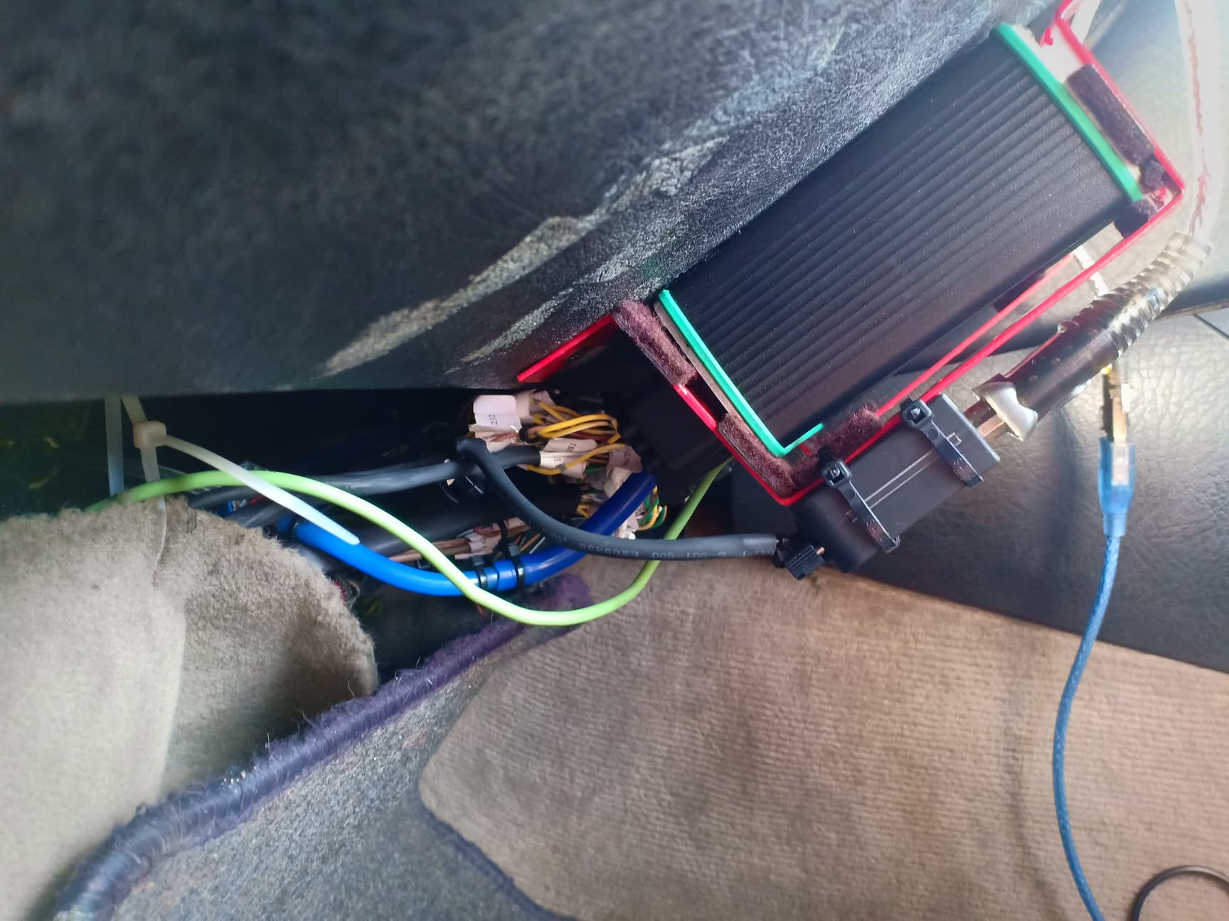

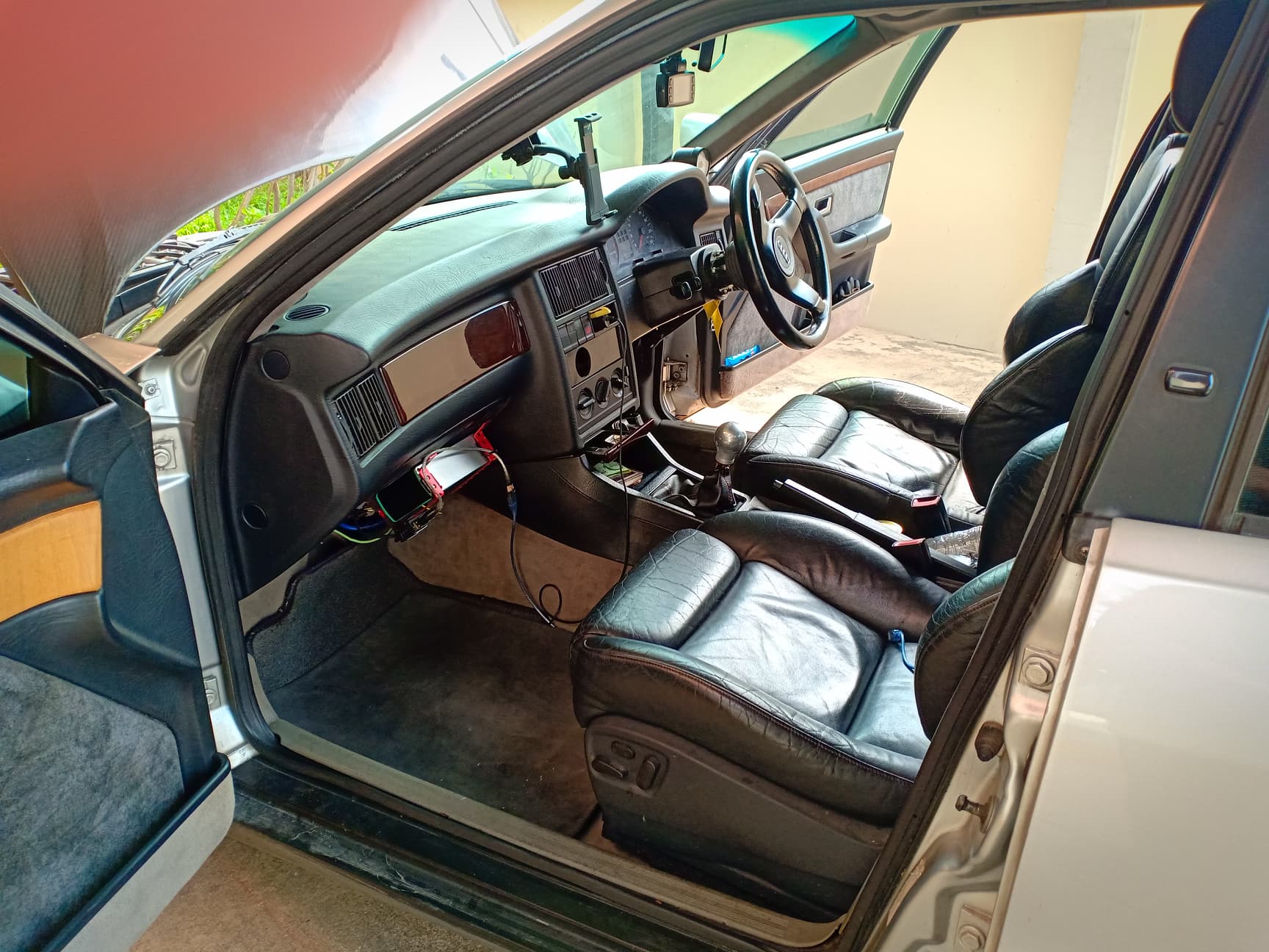

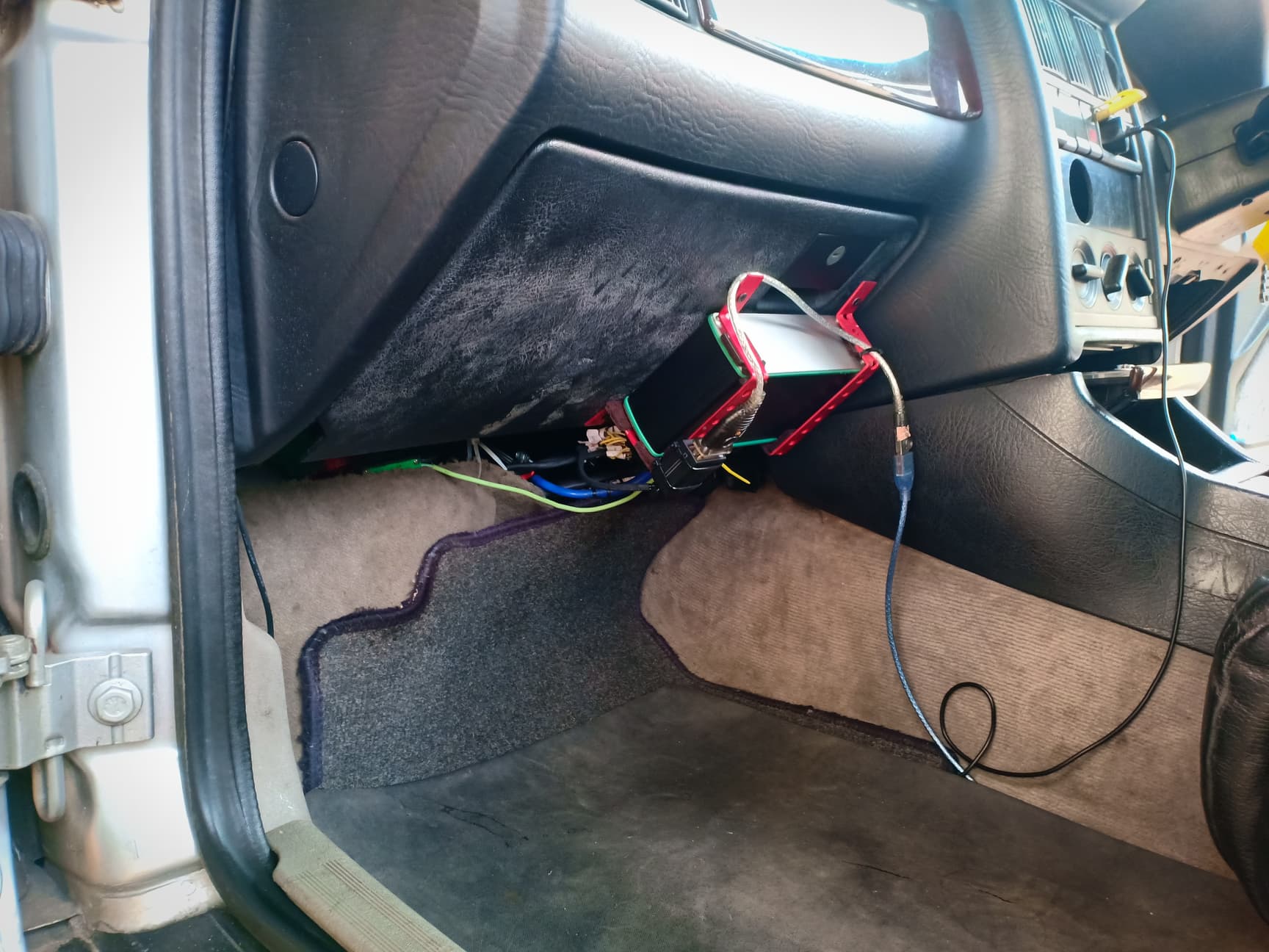

Regarding VEMS ECU placement, I made some crappy Alu brackets and bolted it to my glovebox lid. I'm RHD of course. The lock is strong enough to hold it and passengers are not hit in the knee.
I'll see if I can get a pic of it.
- Posts: 875
- Location: Bangkok, Thailand
Re: Ben's 95 90 Quattro 20vT - now with corn power!
Of course I can...
- 50465236_1284616518344673_5456738228532936704_n.jpg (202.64 KiB) Viewed 68076 times
- 50088491_2012242948851493_965695036836544512_n.jpg (182.37 KiB) Viewed 68076 times
- 50051922_233813934173641_7793672523182243840_n.jpg (194.98 KiB) Viewed 68076 times
- 49898216_233574667568772_6540973190213009408_n.jpg (246.24 KiB) Viewed 68076 times
Love those seats!
Thanks for the pics
I put mine in the glove box of the CQ; if I was starting over I'd find room under the dash.
My v8 CQ VEMS was in the glovebox too. I think where this one is works, the bitch of it is the attachment of the b4 stowage compartment. There are bolt holes at the top that don’t line up to anything. I made a little metal bracket that I have everything attached to now but it is not the best solution
