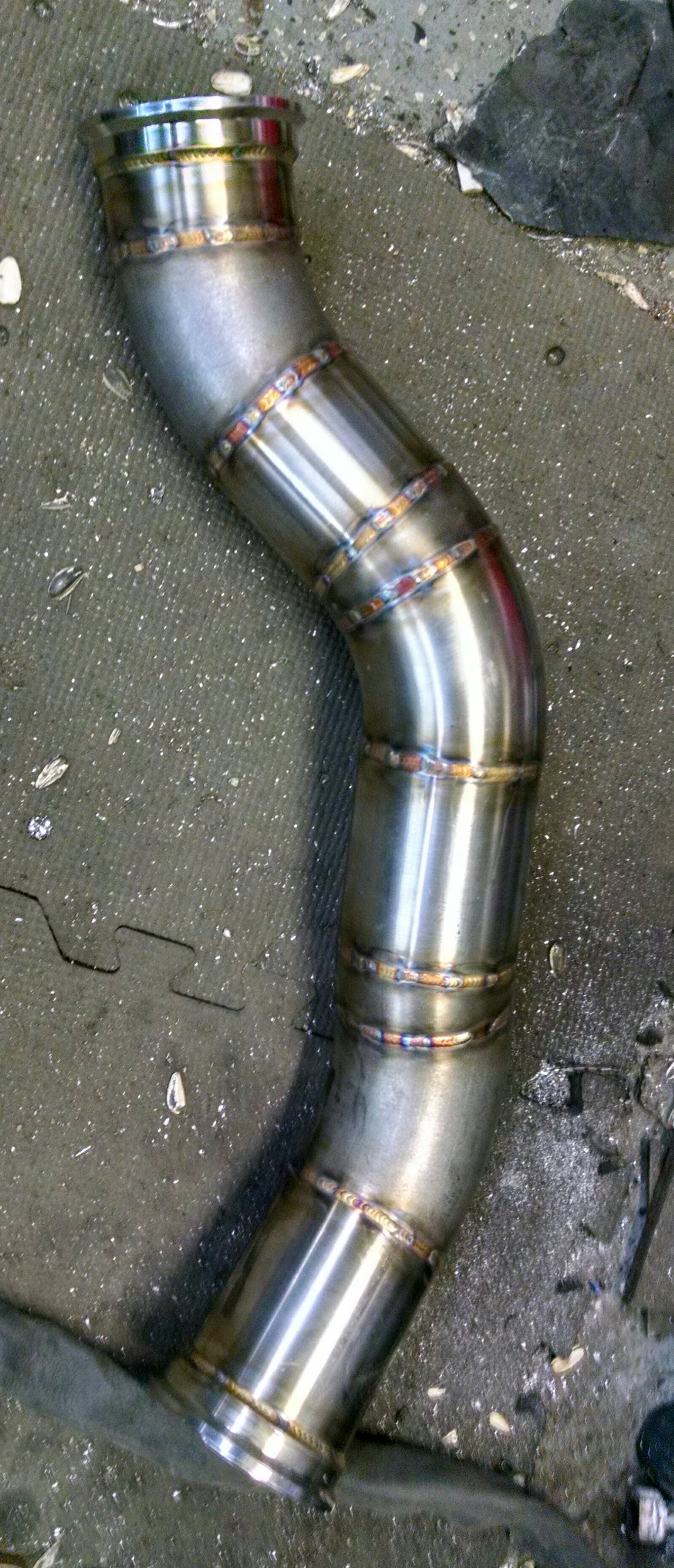

I got whistlebit on the exhaust, but I have a good portion of it done .
Downpipe
Middle section
Downpipe and mid pipe are finished, I just didn’t have time to get the back section wrapped up. I ordered some stainless bar stock to make hangers with , I don’t want to weld the back until I have the muffler hanging .
I was considering adding a V-band right in front of the muffler to make it removable and replace it with a straight through tailpipe section . It’d be like a 10 minute swap . This is what it will look like . Last few bend aren’t welded yet but I can get that done soon and then see what will fit for tips .
Now after doing this remember I was saying I thought about 3.5”. That would have been insanely hard to fit over the rear subframe .
Downpipe
Middle section

Schedule 10 IS thin wall pipe lol. Lots of welders hate that stuff. By doing two passes you're putting a lot of heat into it. Guys I work with (boilermaker and piping welders) would do it in one pass. Easier to get penetration if you're leaving a gap, typically about the size of your filler rod. What we do is bend a rod into a V and put it in between the ends, then tack three times, removing the rod a bit after each tack.

Exhaust looks great! Definitely agree, v-band both sides of the axle spool. A bit of prep now saves massive hassles later.

The 90Q (07k?)
Exhaust is finished . Here’s a pic dump of that.
I did end up using another V-band so I have 4 separate pieces
•downpipe
•mid pipe
•Over axle piece
•muffler

Also I put this engine in yesterday for testing and fit up of some stuff
If I can ever get my act together and get this car running its a perfect car to test things out because I could start with stock and not trash a built engine
