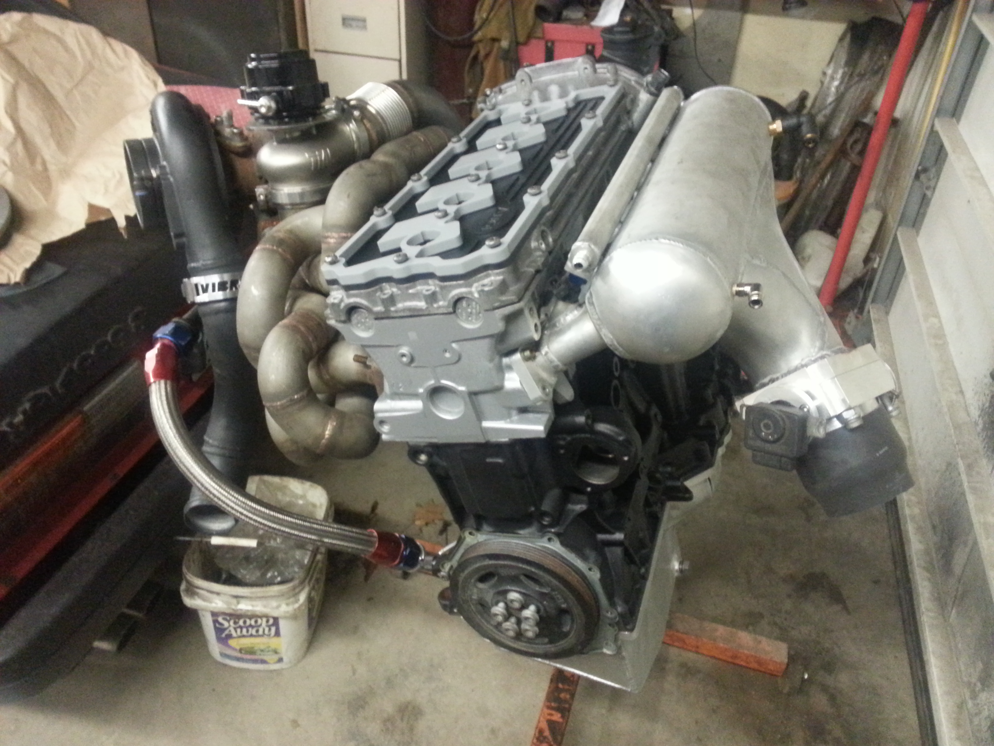

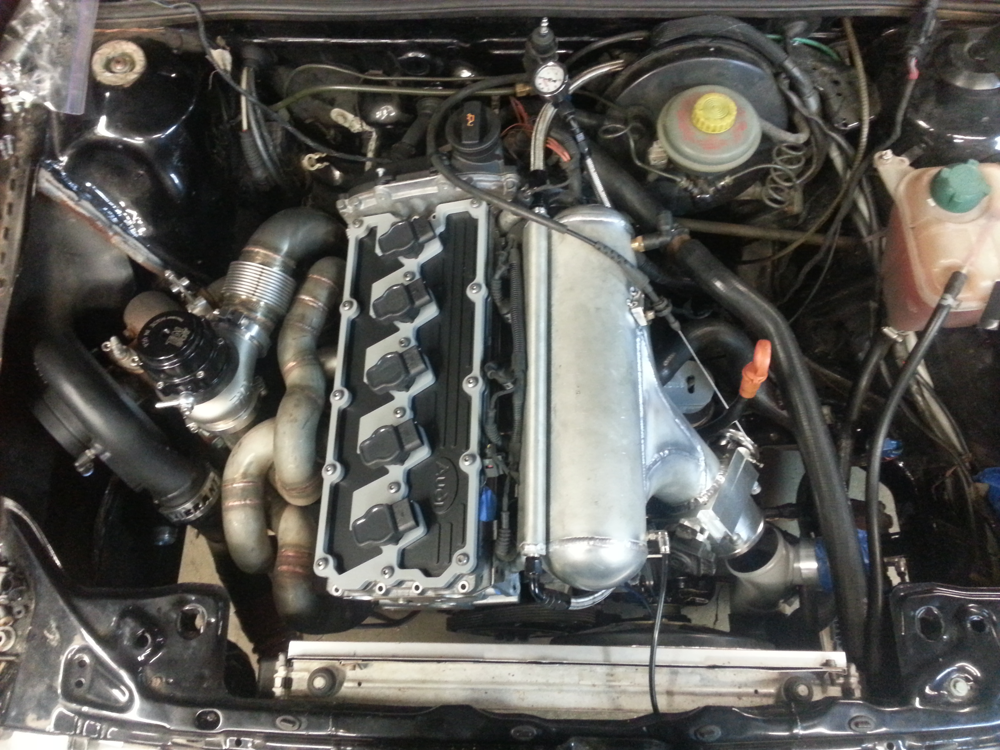

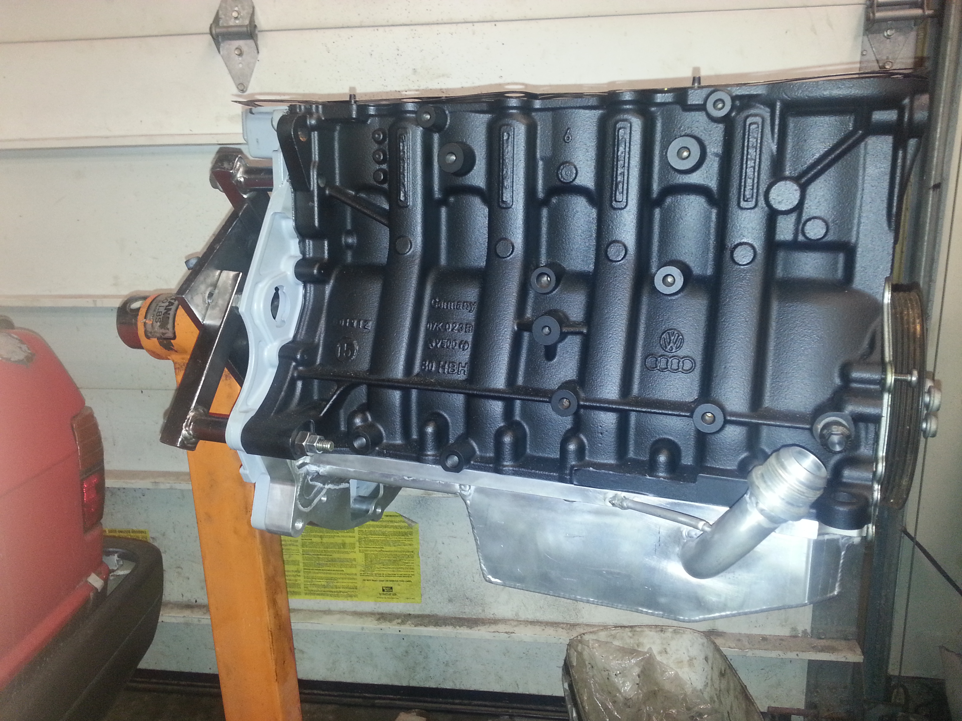

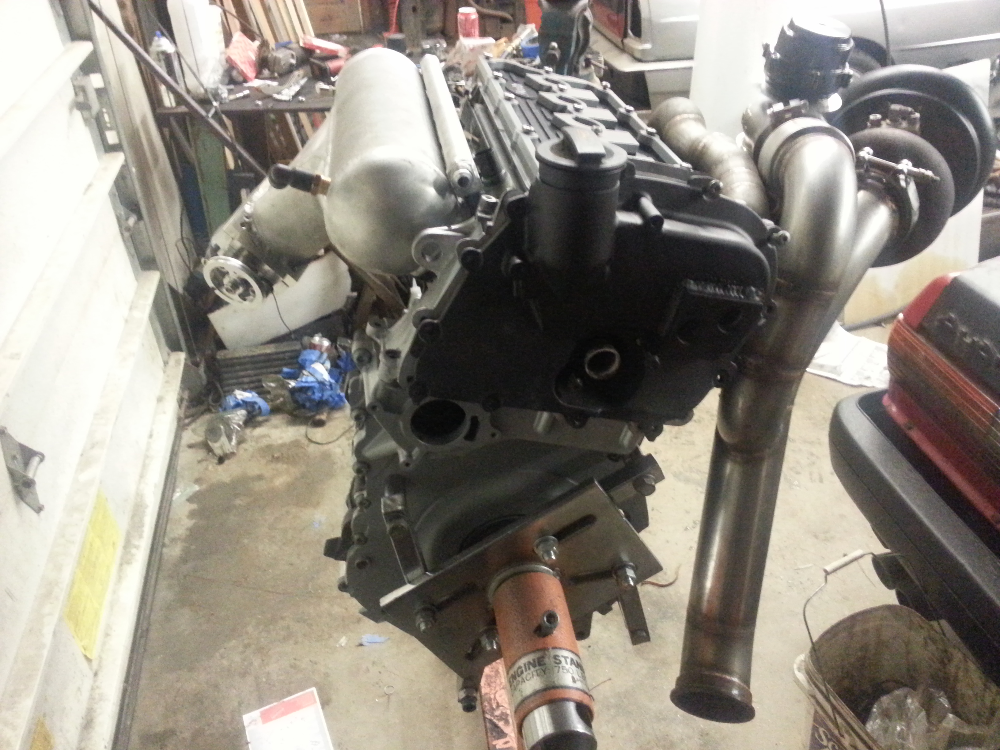

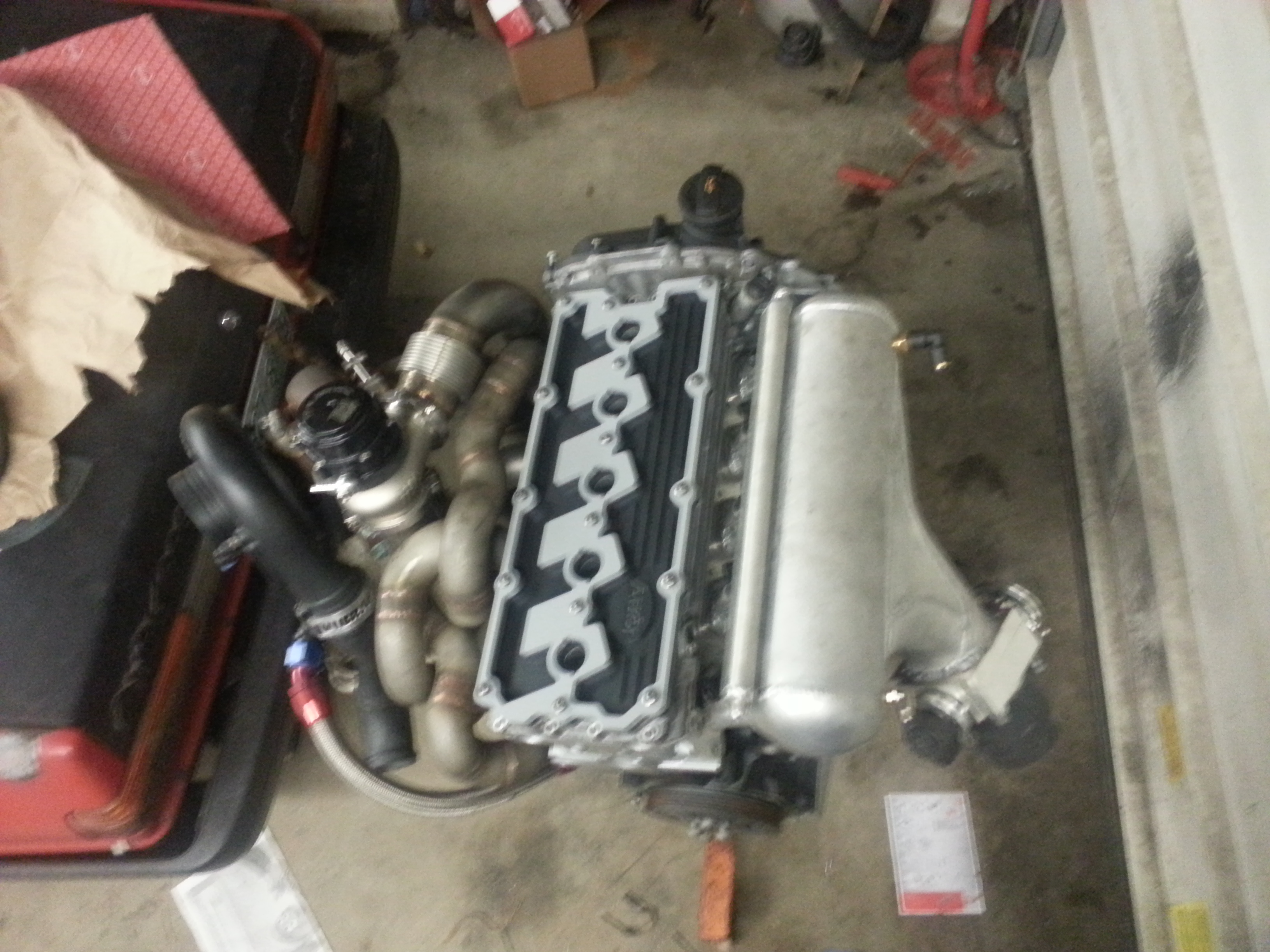

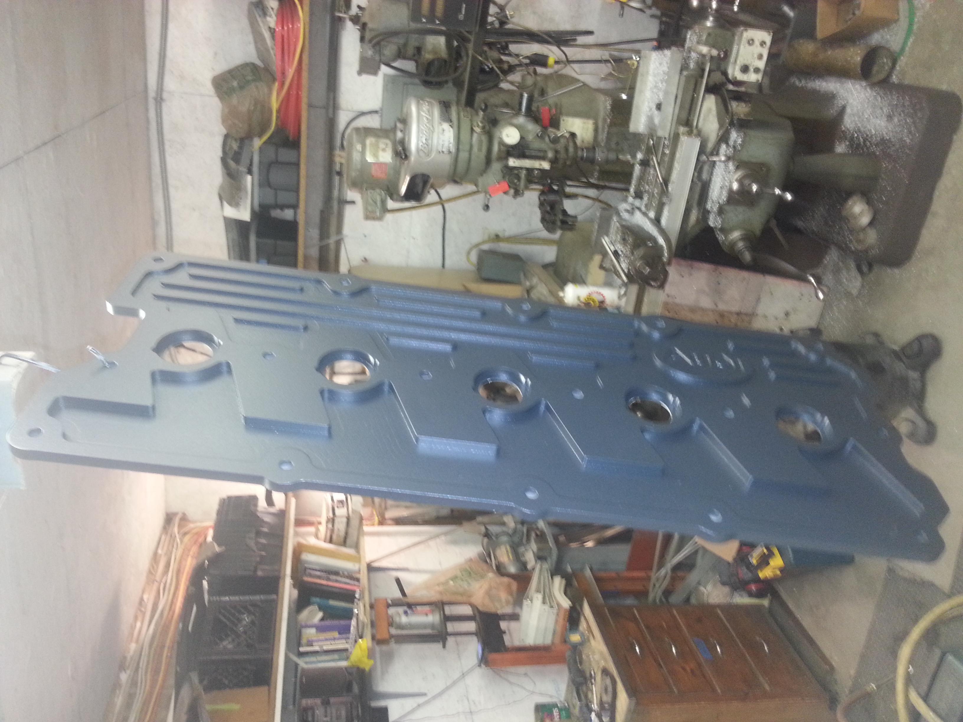

Re: Jim's 07K 84 Super HX40 4kq 83mm engine building:-D
Finally! Looking good!
Awesome work Jim...can't wait to see it in person. I'm sure you're itching to drive it!
Damn you Hank....those parts look awesome. I may have to 07K my UrQ if for no other reason than to see that valve cover when I open the hood!

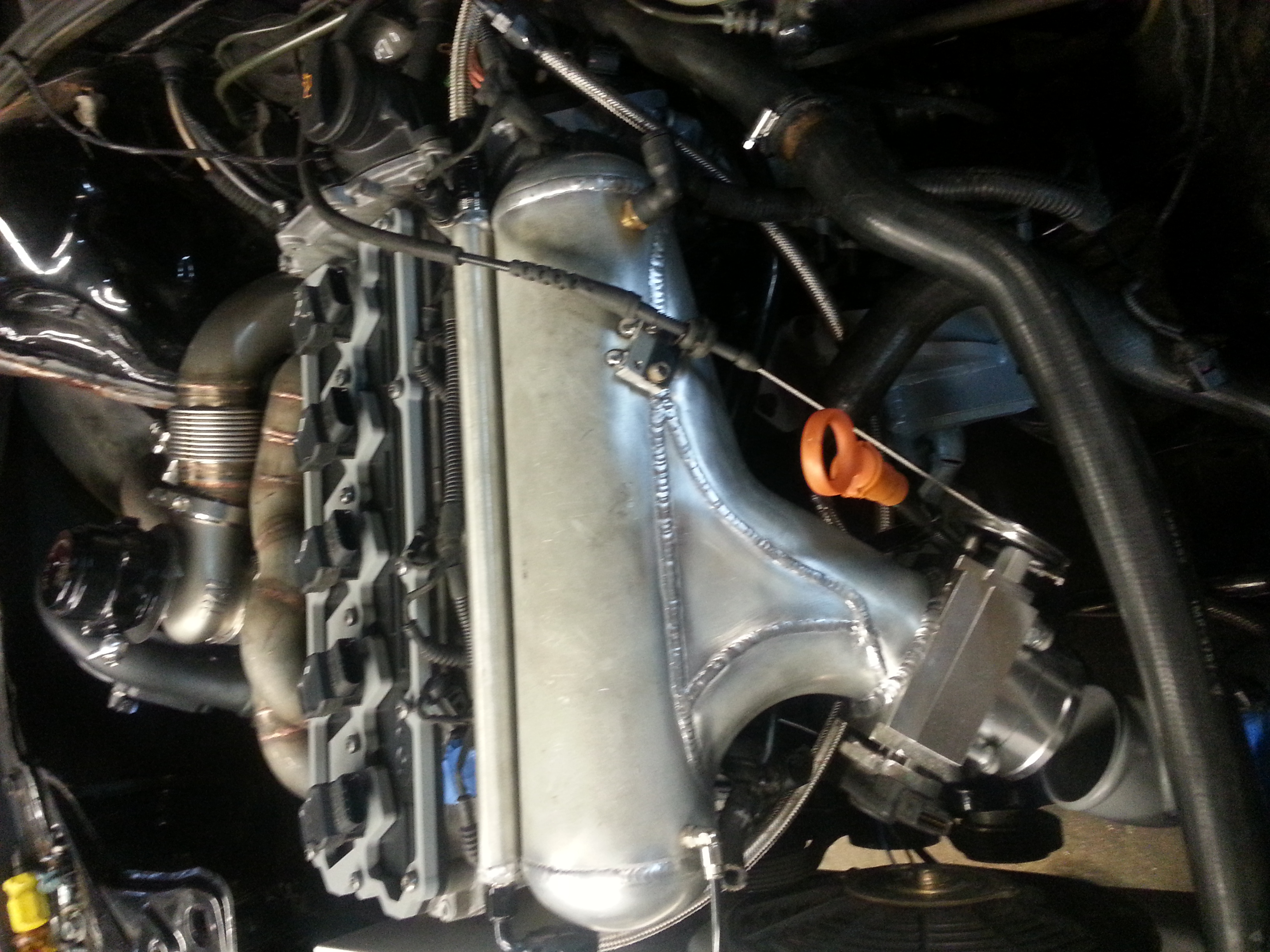

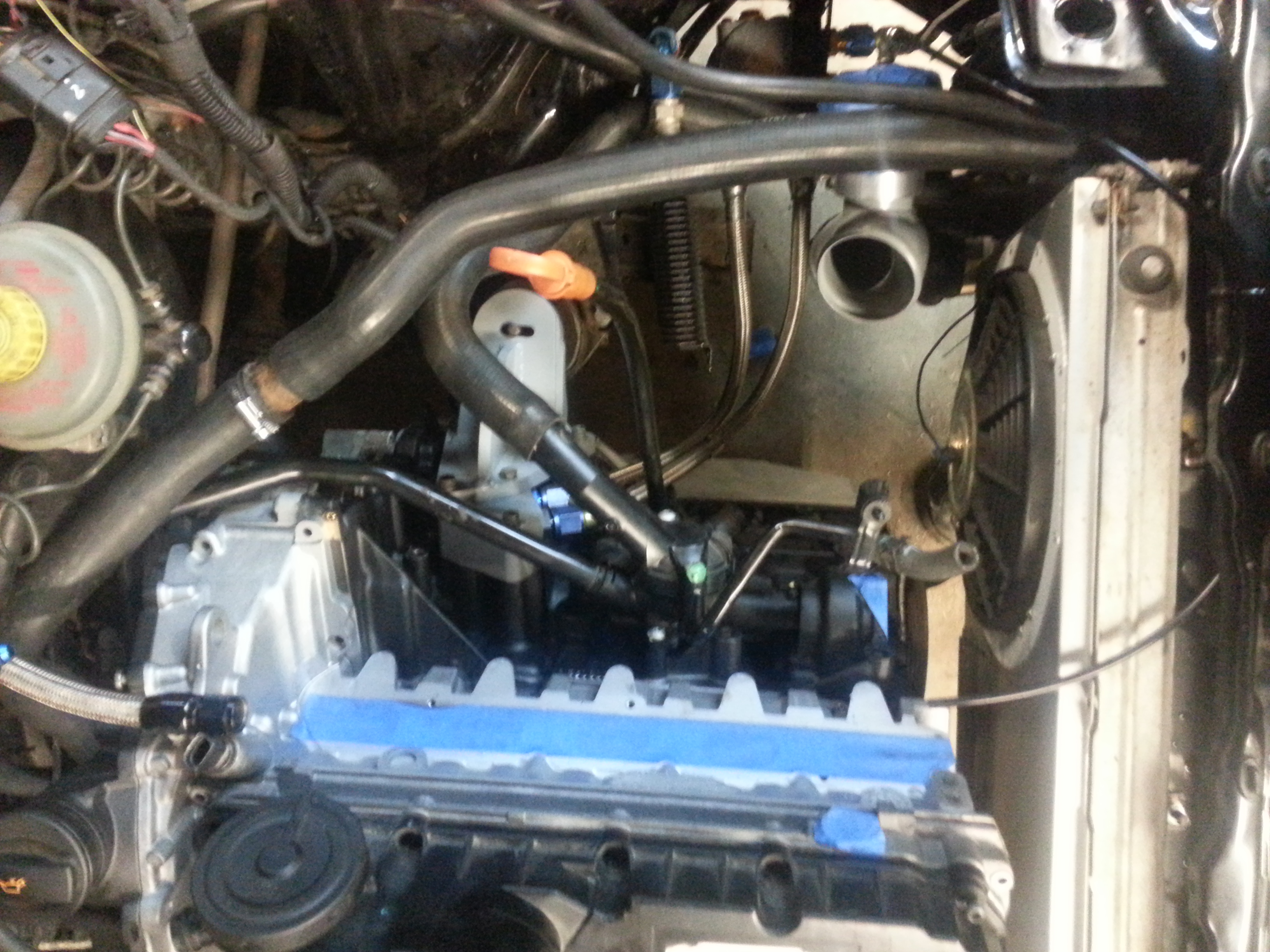

Not that it looks like it could go any higher, but is the turbo oil return above the oil level?
glibobbo21
- Posts: 659
on the oil line return...debateable. It worked for 1.8t's all this time. Also you can fit a garden hose inside of mine. :-D

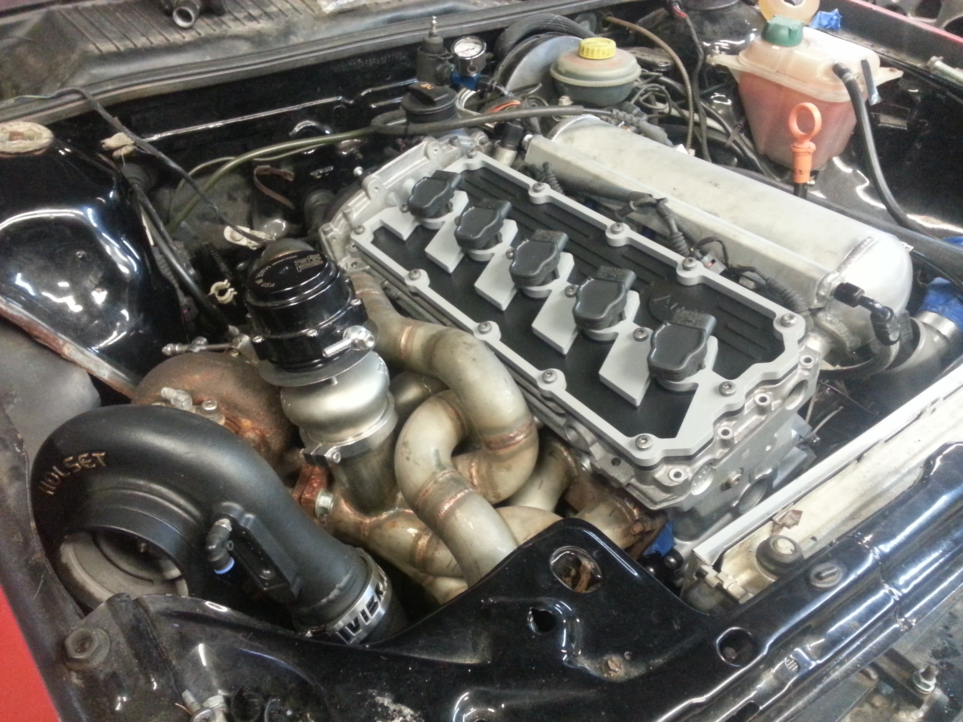

Very nice build, love the 07k swaps going on
Which hotside is that on your super40? 16cm2? Do you have any goal for a powerband?
I am also looking at the super40 for my next build
glibobbo21
- Posts: 659
its an old diesel truck garret housing machine to accept the super 40 CHRA
glibobbo21 wrote:on the oil line return...debateable. It worked for 1.8t's all this time. Also you can fit a garden hose inside of mine. :-D
If the line starts getting backed up because it is below the pan level, it will naturally start to flow back into the pan as soon as the level in the line gets higher than it is in the pan. It is simple physics and fluid mechanics (assuming crank case pressure and oil drain line pressure are similar). Hydrostatic pressure will ensure that your drain works fine.
loxxrider wrote:glibobbo21 wrote:on the oil line return...debateable. It worked for 1.8t's all this time. Also you can fit a garden hose inside of mine. :-D
I always thought this, but never knew how to say it like an engineer... haha.

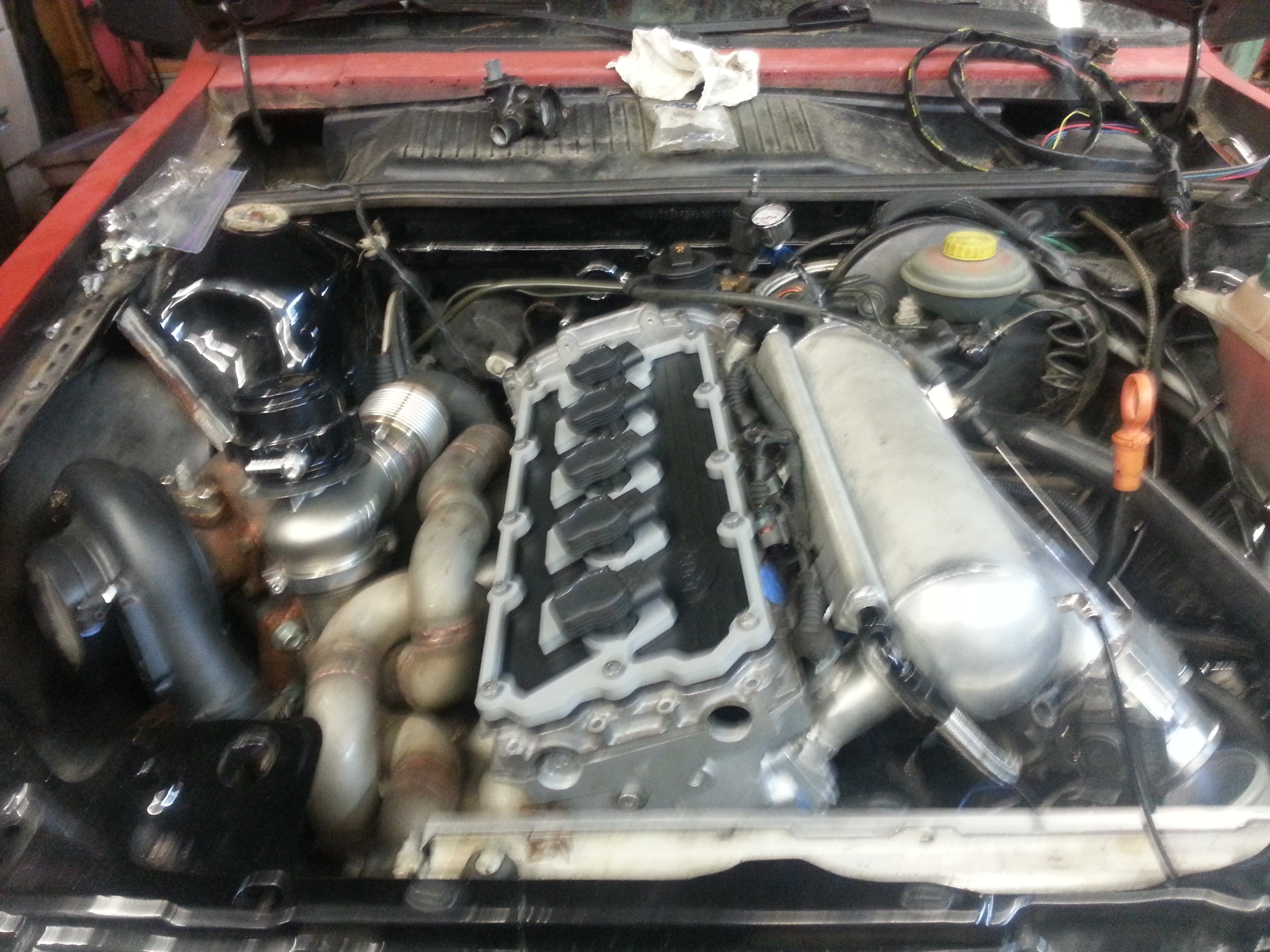

It may look close to done, but with my luck itll probably have to come back out next week. Haha

Not sure how i should coat the IM...
Match the IM to the VC and coat the fuel rail to look like the coil spacer.
