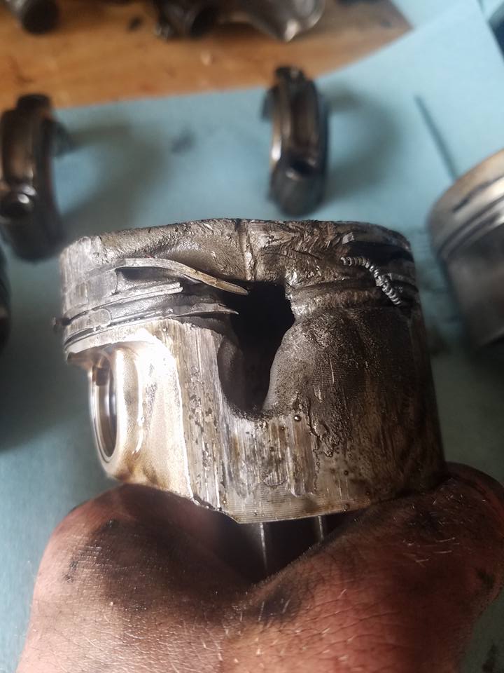

put out an APB and see if you can get a good used k24 shipped overnight from someone. I think thats your best bet to get it on the road ASAP. Good luck. Maybe we will see you down there. I'm planning on coming with a build that has 30 miles on it, and my road trip partner melted a massive hole in a piston two days ago. Pressure on!

oh we will make it, we are stubborn....maybe not smart, but stubborn.
