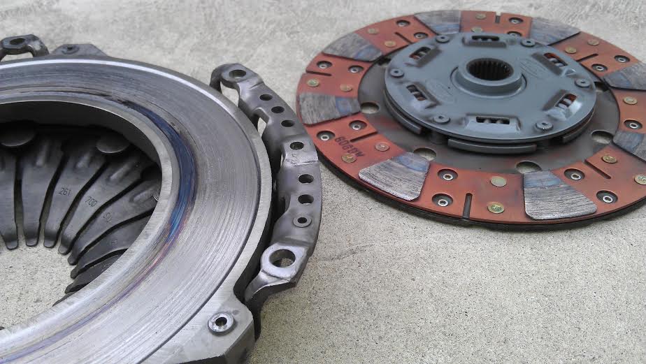

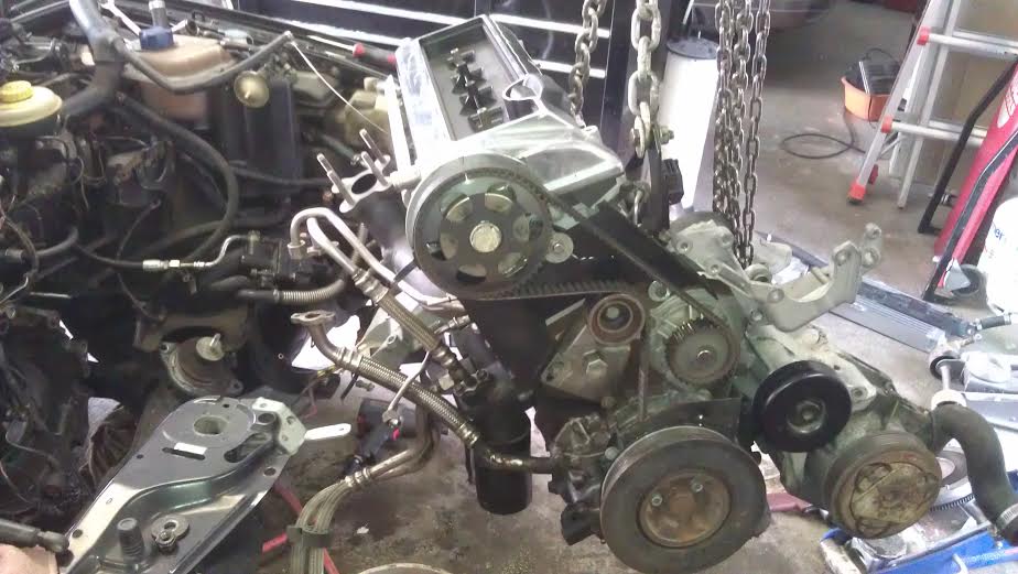

I finally found the time to pull the engine back out again hopefully for the last time.
Once out, found a very good reason why the clutch would not hold E85 power. the puck side they replaced had a pretty negative affect on the pressure plate. this is less than 5k miles since I installed it.

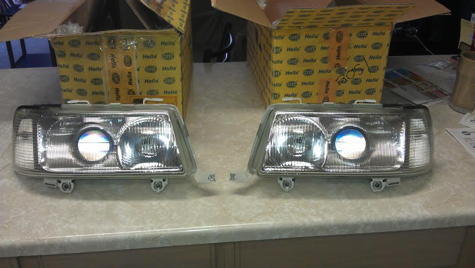

I also FINALLY picked up some RS2 headlights I have needed to bring the look of my coupe more up to RS2 spec.
RS2 headlights.jpg (60.42 KiB) Viewed 37078 times
So now the engine comes apart for machine work to install the ARP mains, new rings, coated rods and main bearings. The last of the go fast parts.
