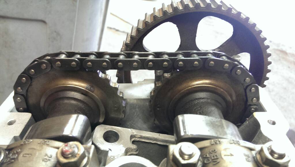

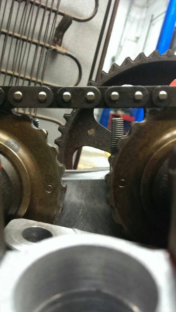

Take a wider photo so we can see the top of the cam sprockets and the chain.
If you count 7 teeth up on each cam from the marks (teeth with marks being #1), there should be 10 links between those two teeth.

picture is worth 1000 words

Re: A tale of Rubí... Bottom End Assembly Commences w/PICS
Spot on?

mushasho wrote:7a & 7a it is... Assembling now..
how many open links should there be an on chain now?
Hold on, how are you setting the cam sync? I don't think, may be wrong, that it is as simple as 180* off.

I believe I have it like soo

Right, that is the stock alignment.
I am saying, is this as simple as phasing the exhaust +-180* to make into a, properly performing, intake?
Oh I think you're under the assumption that I mix and match my cams... I went 7A Intake and 7A Exhaust in there intended location.... none of that "AAN Exhaust Cam as the intake & 7A Exhaust" stuff... Ain't got time for that right now... lol

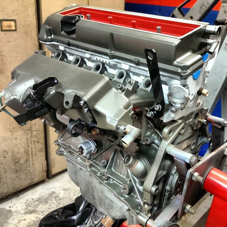

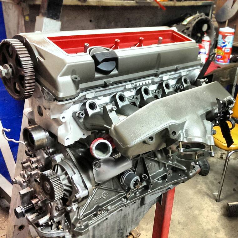

A little dress up...
7a intakes don't have enough duration to support power above 6800 on bigger turbos. By putting the exhaust in the intake slot, you can grab a bit more lift and a tad more duration. With the cost of 7a cams, it is coming close to what proper Cats or other cams are designed to do, with far better specs. Still, there are some really good dyno plots where the power does not drop off at 7000 like I am accustom to seeing on straight 7a cams. This is also why retarding the cams with a cam gear yields great results..
Hank wrote:7a intakes don't have enough duration to support power above 6800 on bigger turbos. By putting the exhaust in the intake slot, you can grab a bit more lift and a tad more duration. With the cost of 7a cams, it is coming close to what proper Cats or other cams are designed to do, with far better specs. Still, there are some really good dyno plots where the power does not drop off at 7000 like I am accustom to seeing on straight 7a cams. This is also why retarding the cams with a cam gear yields great results..

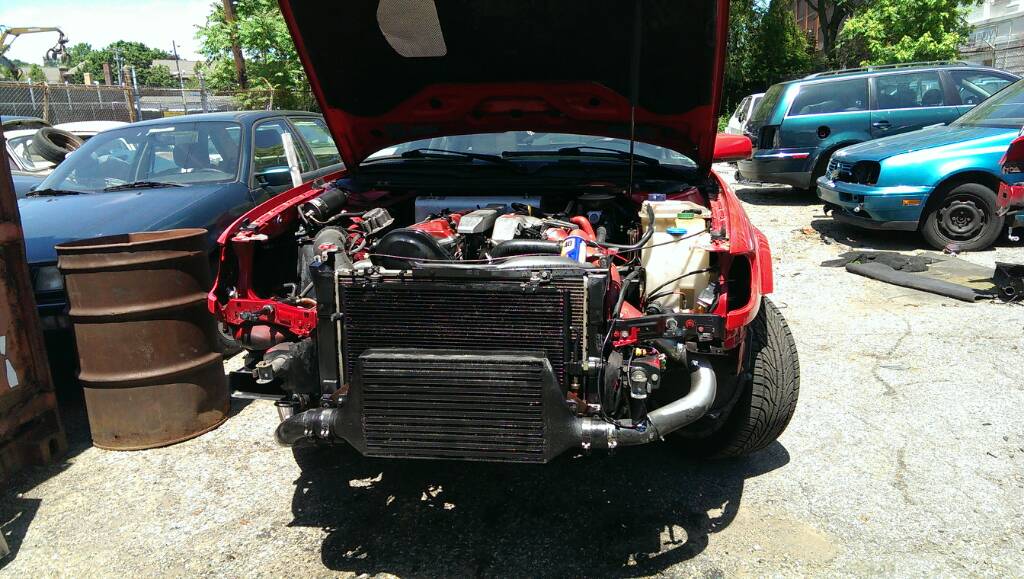

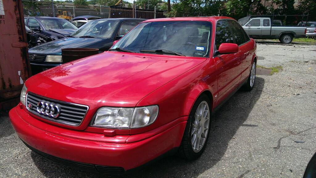

Re: A tale of Rubí... Break down w/PICS
Quick rinse out of hibernation..
Placed behind shop...
Commence break down...
