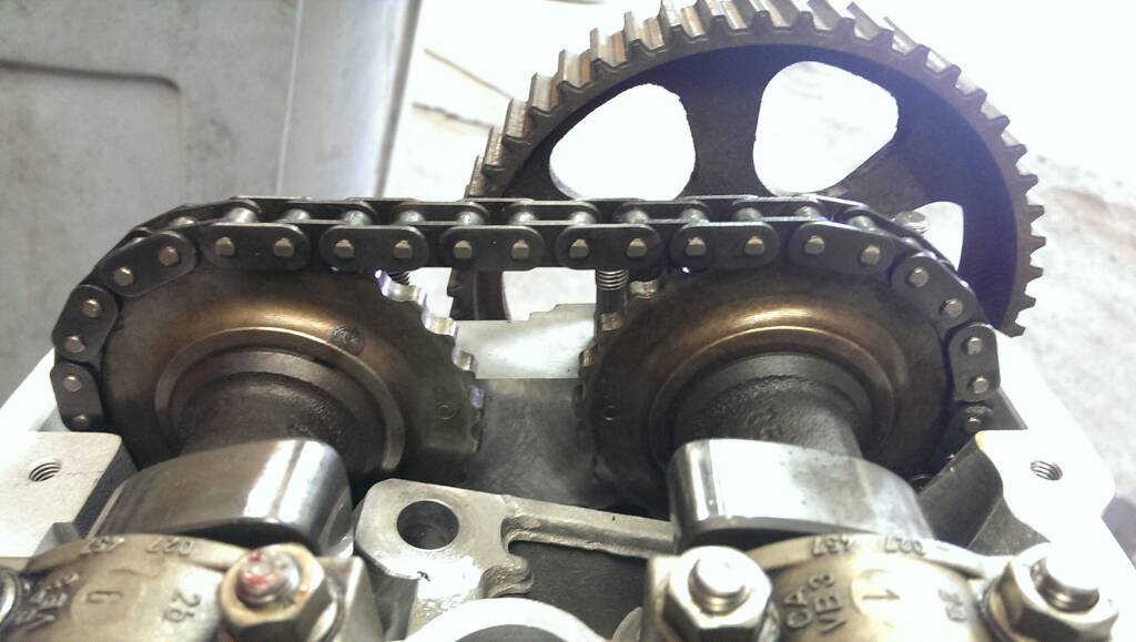

Take a wider photo so we can see the top of the cam sprockets and the chain.
If you count 7 teeth up on each cam from the marks (teeth with marks being #1), there should be 10 links between those two teeth.

picture is worth 1000 words

Awesome!!! Didn't wanna search for that with dirty fingers on my phone, I know I had seen this before and a conversation regarding the possibility of having to time 7a's a but differently in an AAN application... I think it was a thread started by Dave in QW. I haven't seen mention of it since so im assuming it was more of a theoretical post...

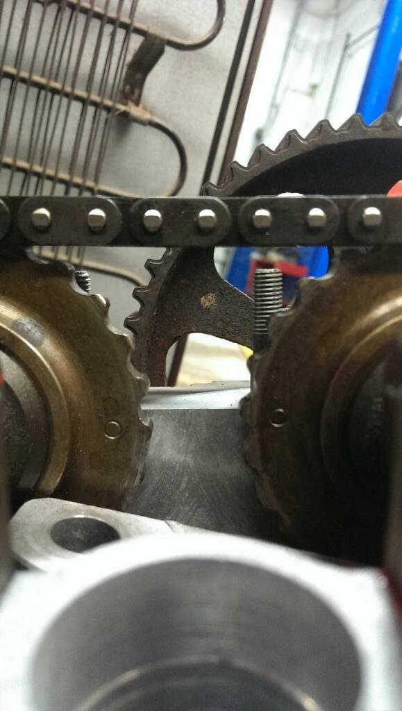

Spot on?

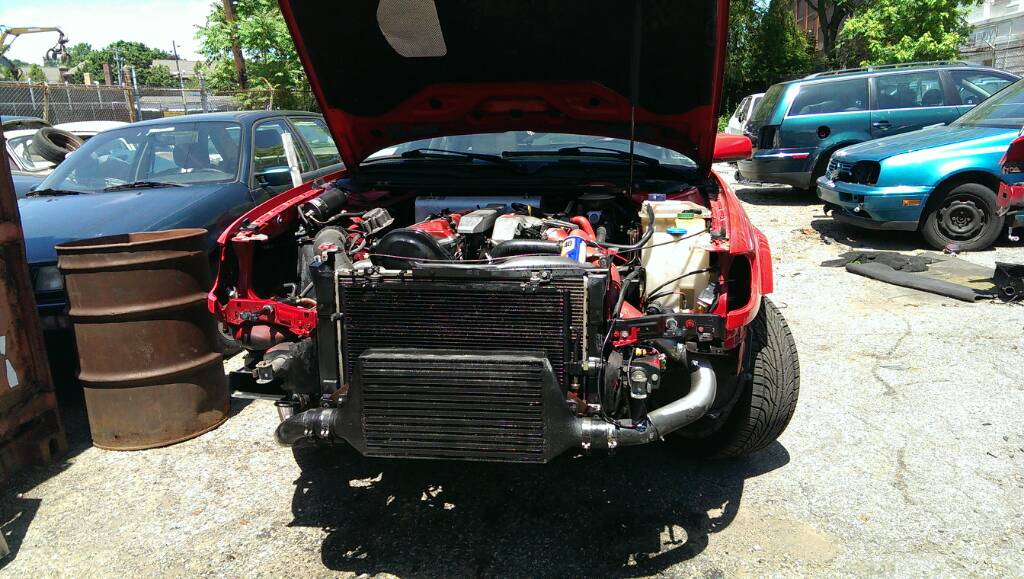

Re: A tale of Rubí... Break down w/PICS
Posted: Fri Jun 14, 2013 8:20 pm
by mushasho
Quick rinse out of hibernation..
Placed behind shop...
Commence break down...
