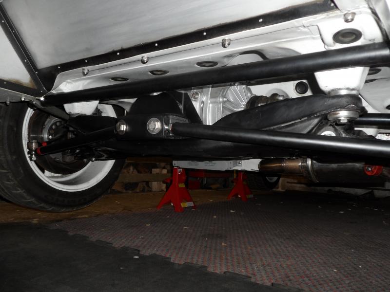

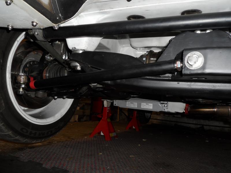

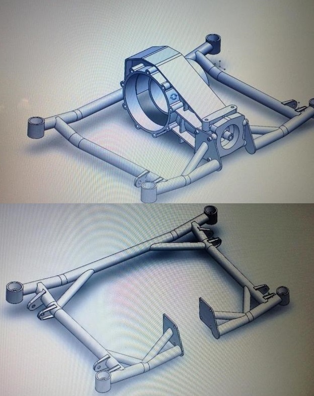

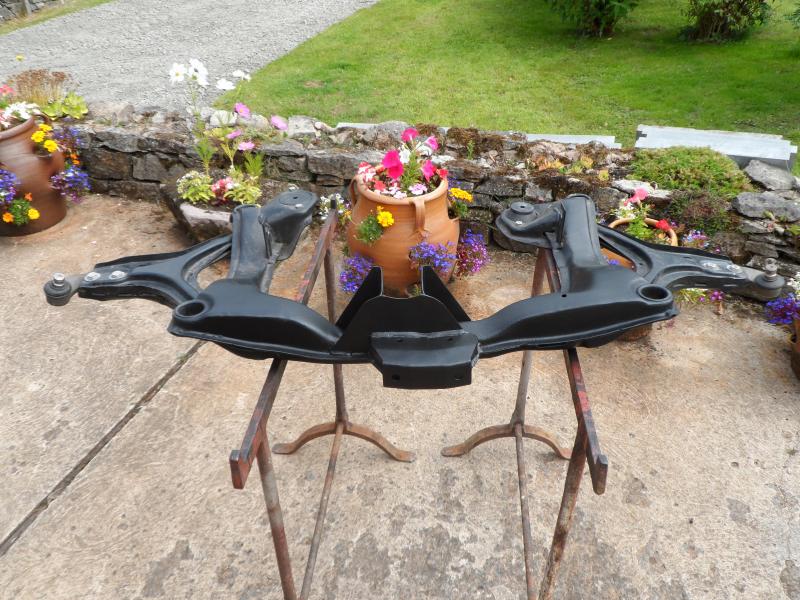

Both very good reads. Terrybullwon has some very nice tubular c-arms and offset/correcting kingpins for control arm angle. He has since developed a tubular subframe, while utilizing oem pickup points. Here are some renderings
terrybullwon SF renderings.jpg (154.92 KiB) Viewed 39105 times
G60Rallye, has a very nice relocated rear tie rod setup. They are longer, mounted much further inboard, and are adjustable pickups.
Heres a few pics

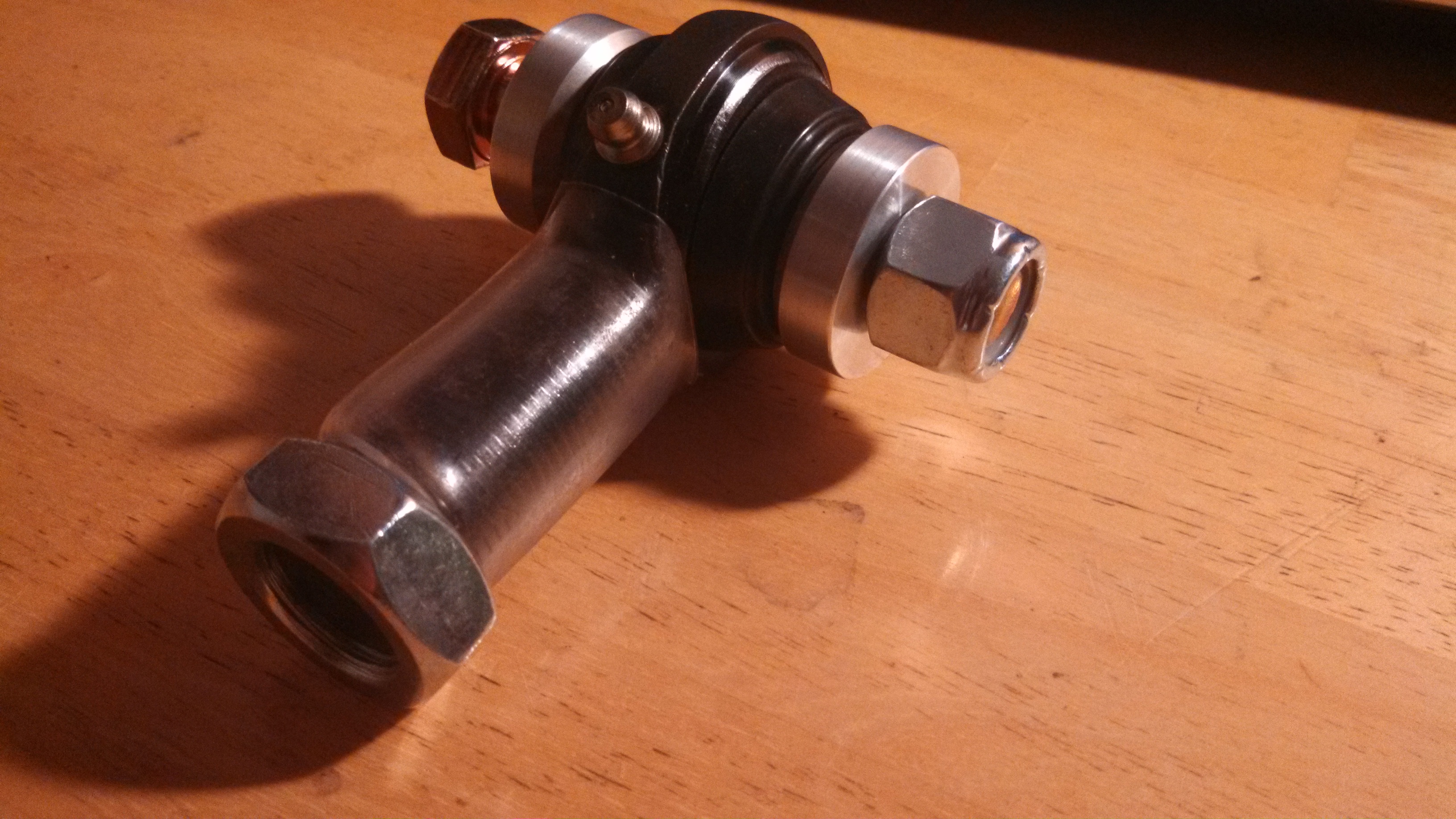

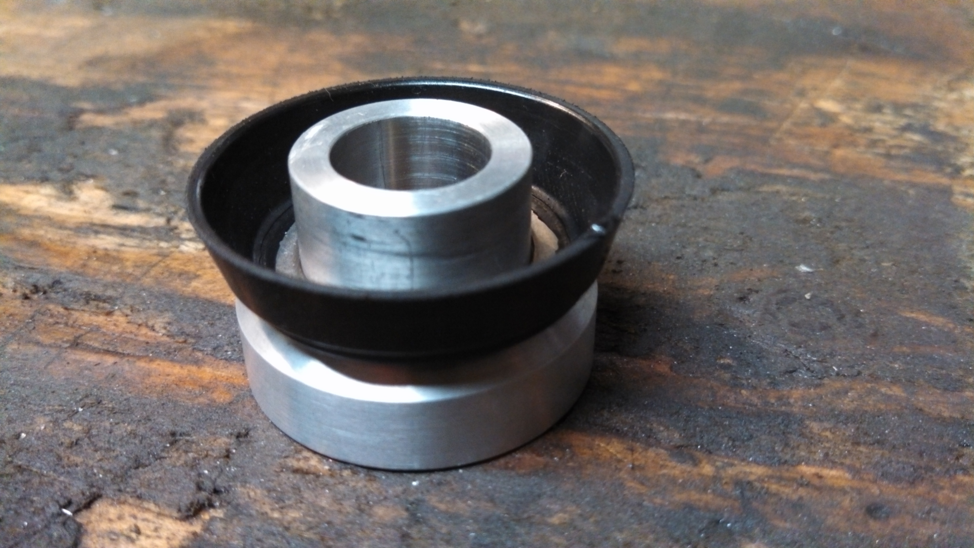

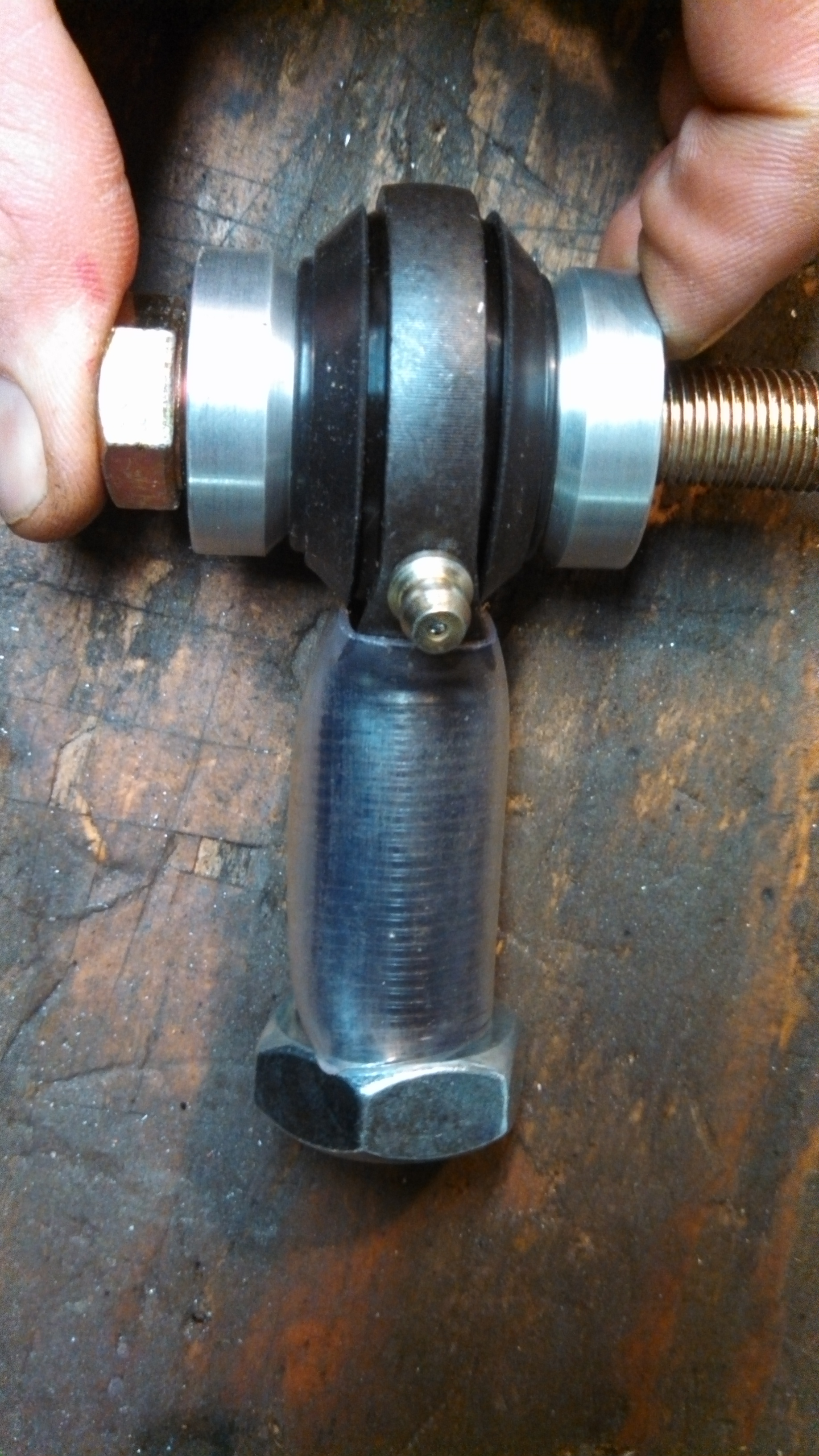

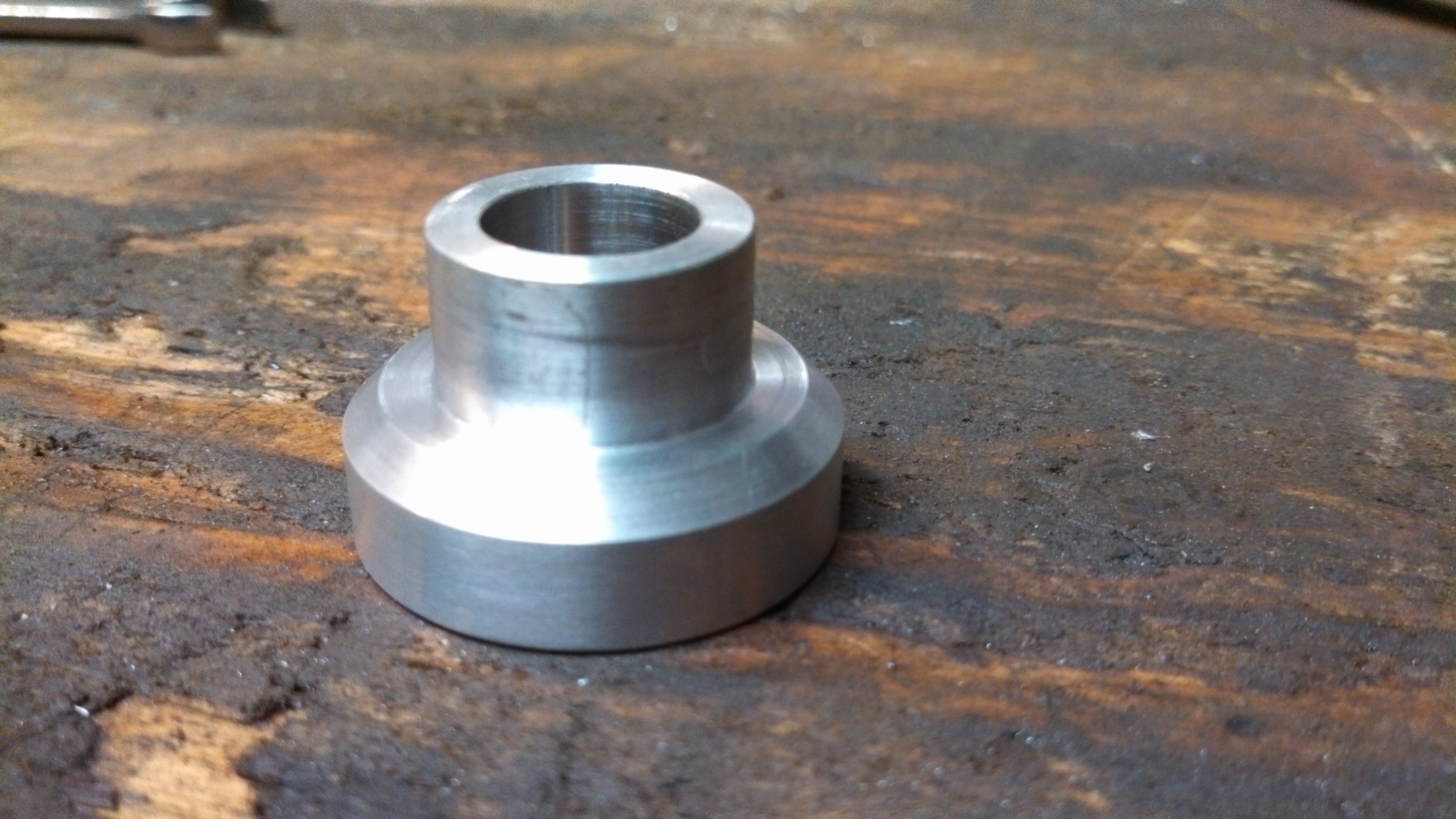

So I sat down and starting drawing up some spacers. I had my buddy the machinist whip up a test pair to check fitment. The spacers were designed to fit perfectly with ¾” head width, ¾” bore rod ends, and Seals-It seals, in factory subframe/c-arm mounts. Using ½”-20 bolts and nylocks. So some enlarging of stock subframe bolt holes would be required. So I can use the same design to make c-arms for stock subframe applications
Here are some pics of the spacers in test fit mode.
c-arm rod end spacer.jpg (1.61 MiB) Viewed 39105 times
c-arm rod end spacer with seal.jpg (1.45 MiB) Viewed 39105 times
c-arm rod end with spacers and seals.jpg (1.48 MiB) Viewed 39105 times
c-arm rod end with spacers and seals2.jpg (1.87 MiB) Viewed 39105 times

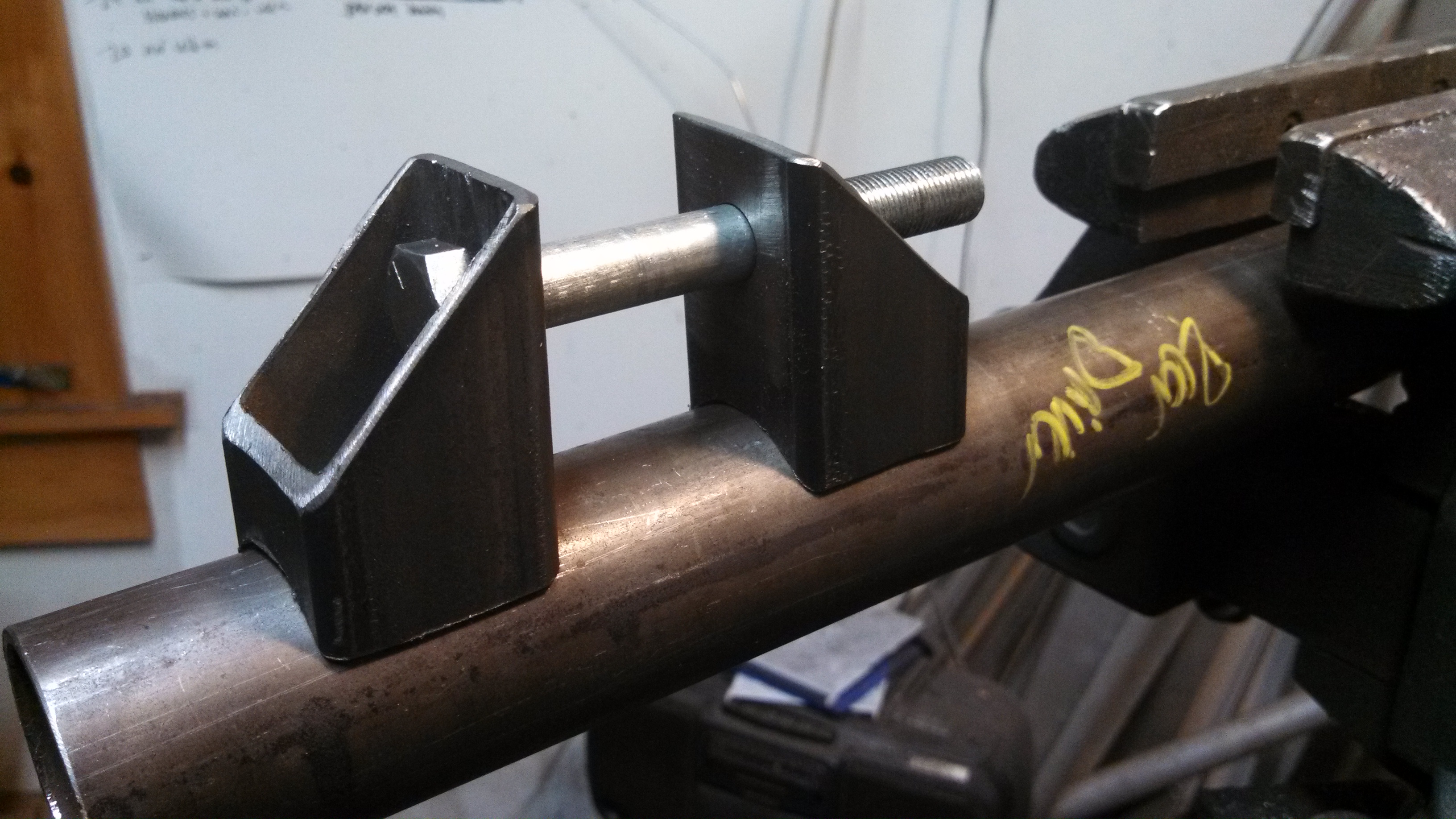

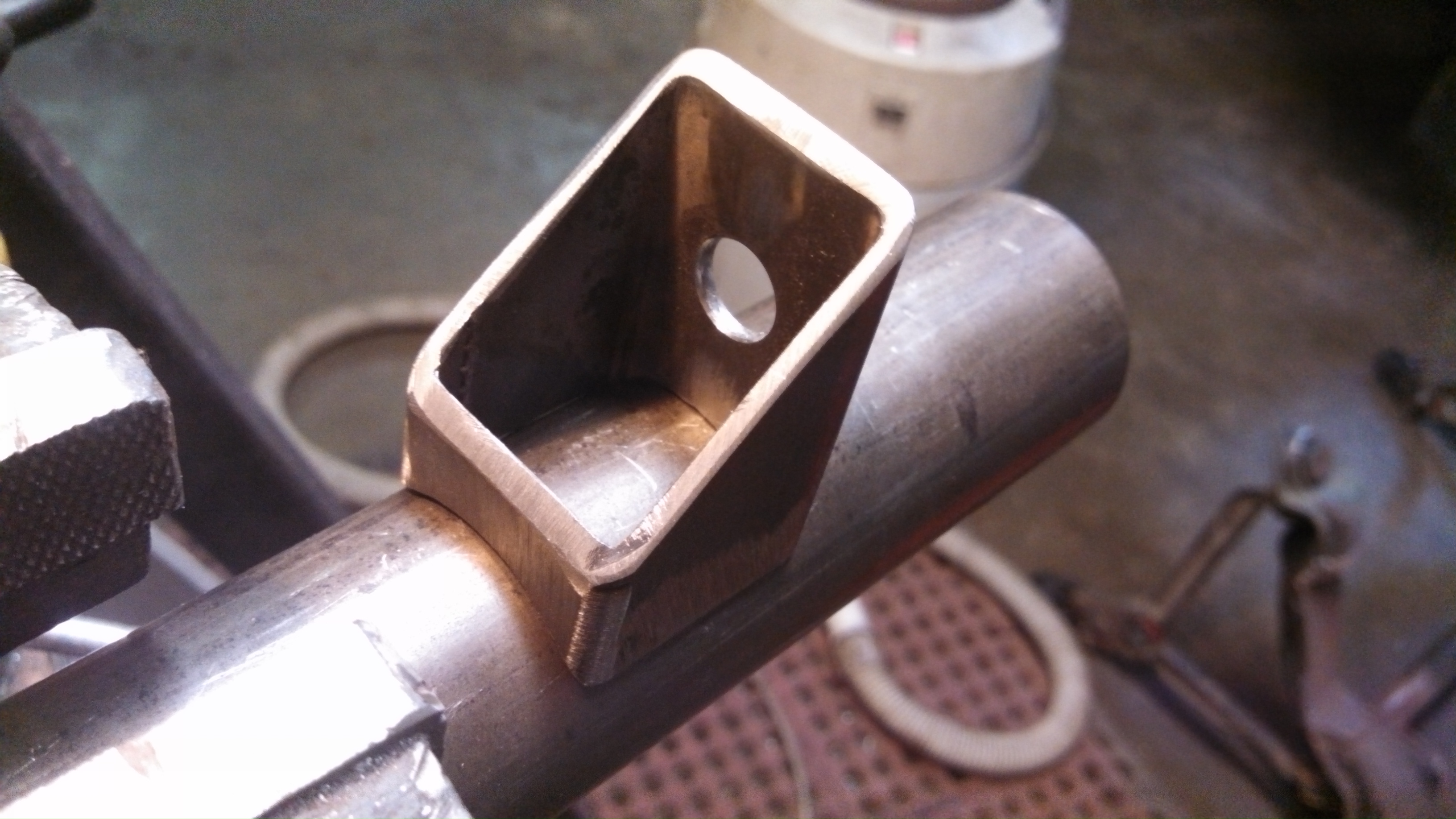

With the rod end/spacer/seal setup all sorted it was time to move on to mounting them onto the subframe. The longitudinal members of the front and rear subframes are 1.75” DOM 0.095”wall. the mounts are cut from 1.5” square, 0.120” wall. Bolt holes are ½” for the ½”-20 bolts.
Ideally the c-arm mounts would be facing directly out towards the hub,to put them in compression, but packaging constraints in the front prevent me from doing this. The front is quite different than the rear as far as mounting the c-arms to the subframe. In the back, the rear diff output flange is located much more centrally between the subframe to chassis mounts.
rear pass side c-arm mounting.jpg (1.35 MiB) Viewed 39105 times
In the front the trans output flange is located lower and much more rearward as the motor and trans have been pushed down and back. In the front atleast ill mount the tabs vertically so I will still have proper axle shaft clearances. In the back I may be able to put the mounts in compression as the flange/cv clearances will be much easier to deal with.
And here we have a good c-arm mount, now to make a bunch more ha
c-arm rod end mount.jpg (1.23 MiB) Viewed 39105 times
c-arm rod end mount pair.jpg (1.67 MiB) Viewed 39105 times
c-arm rod end mount interface detail.jpg (1.36 MiB) Viewed 39105 times

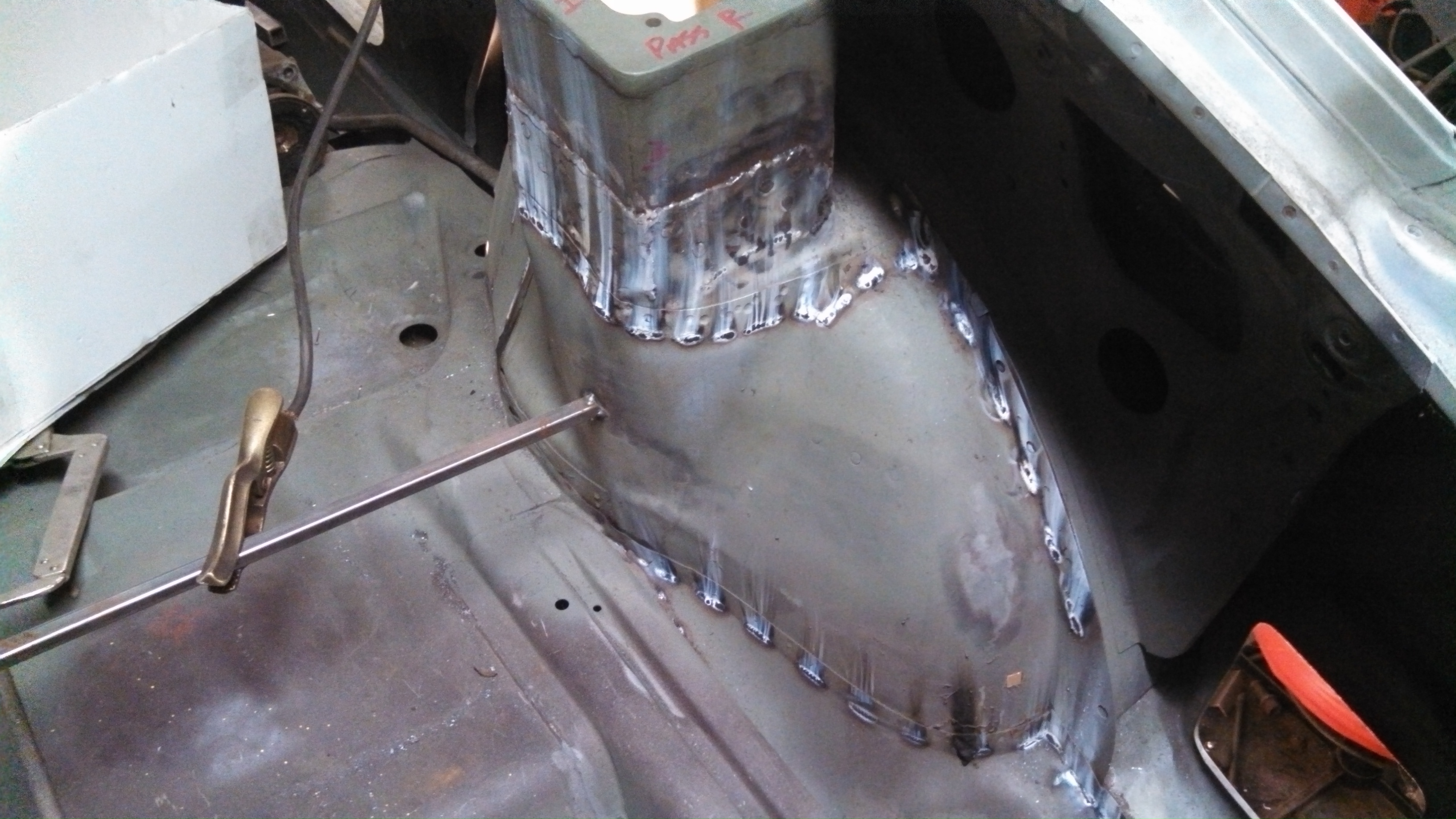

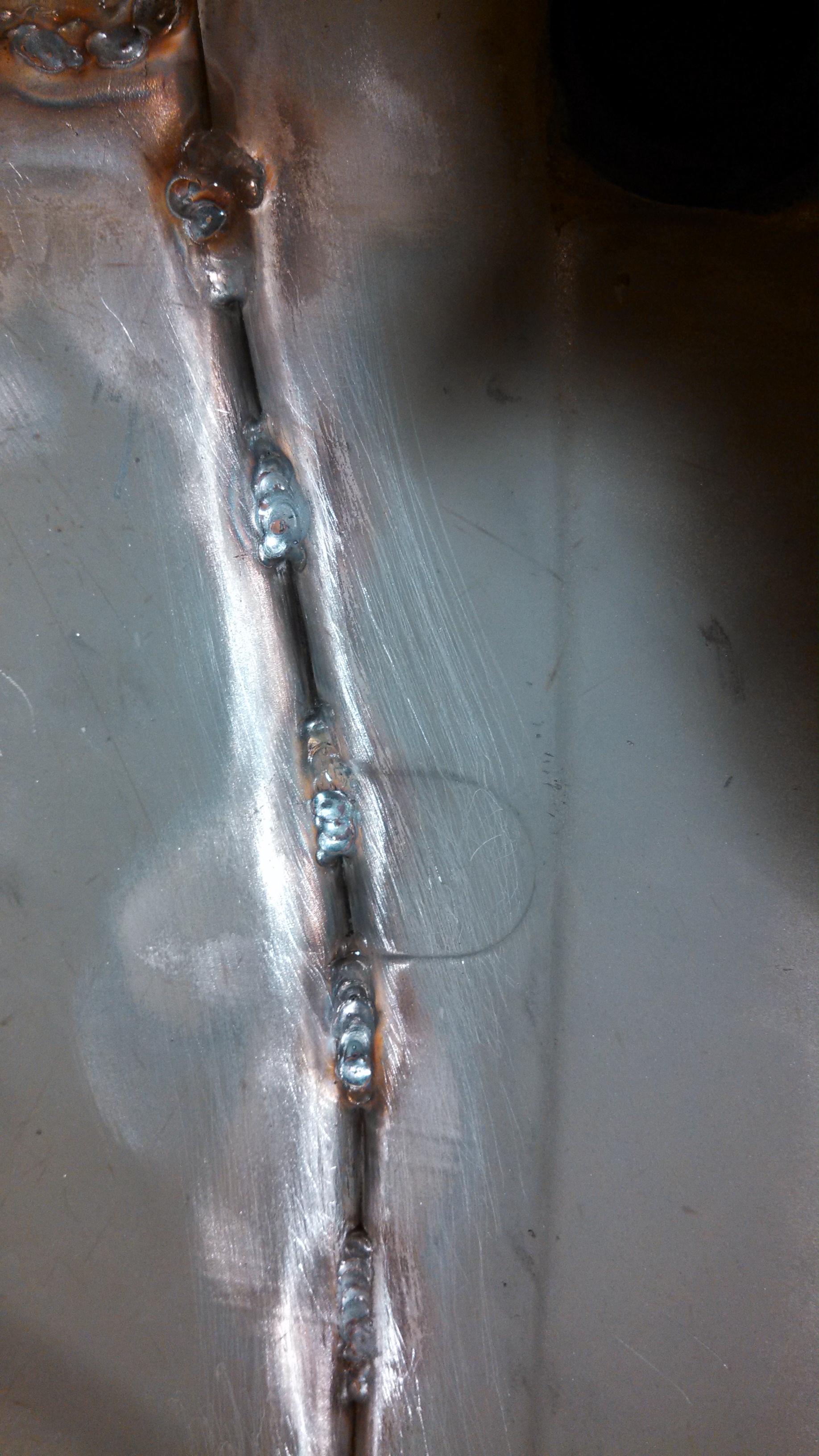

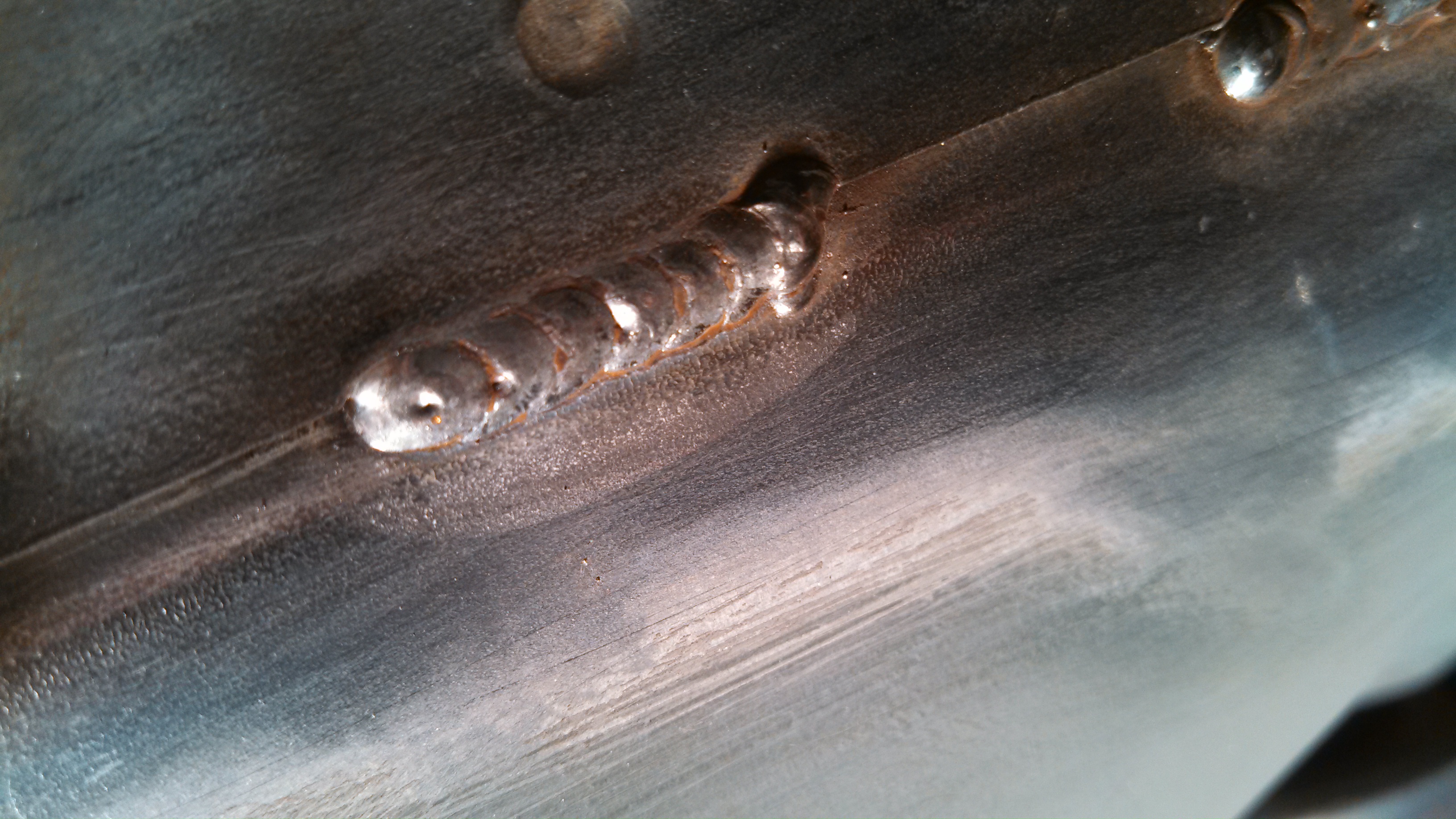

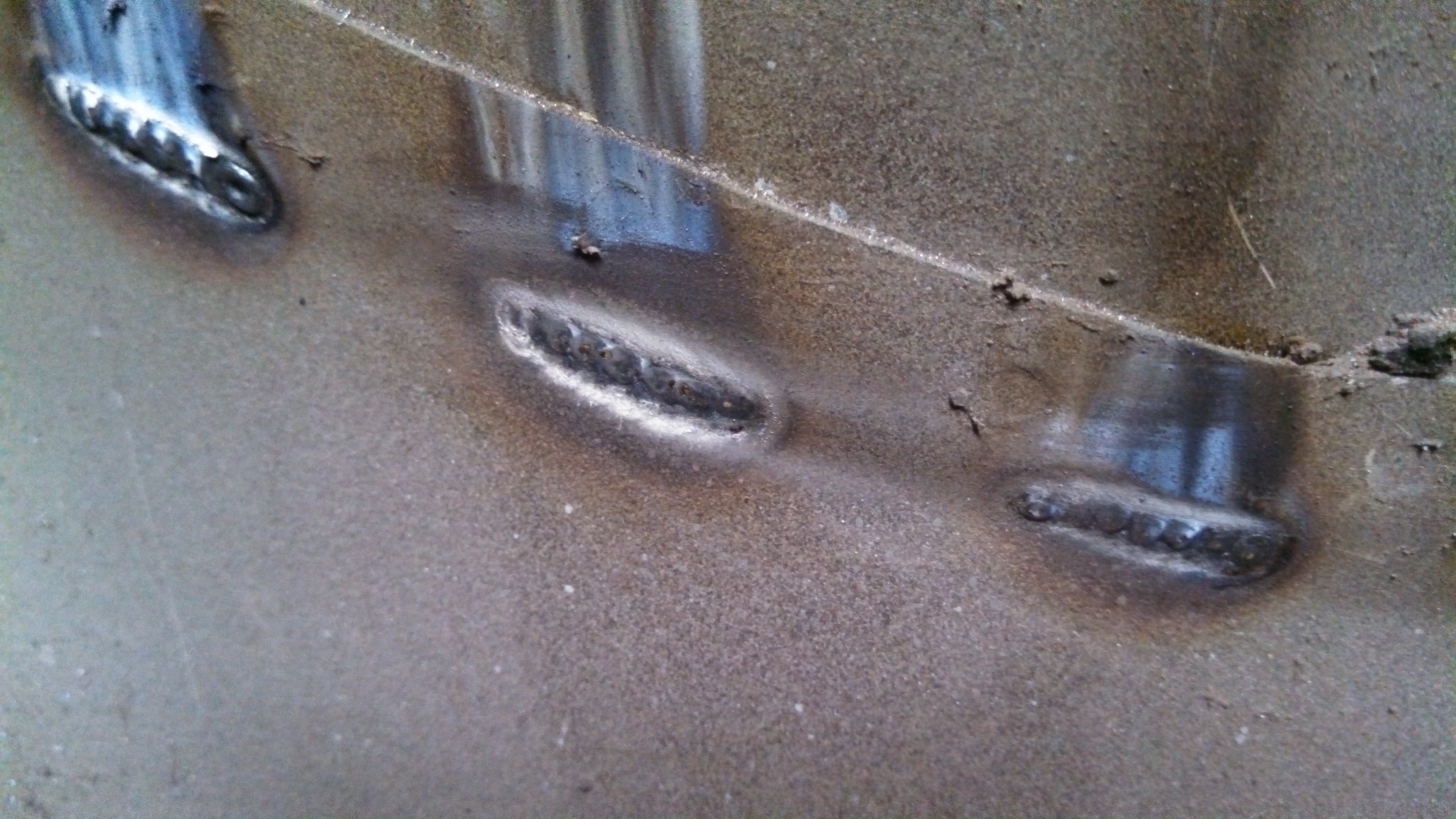

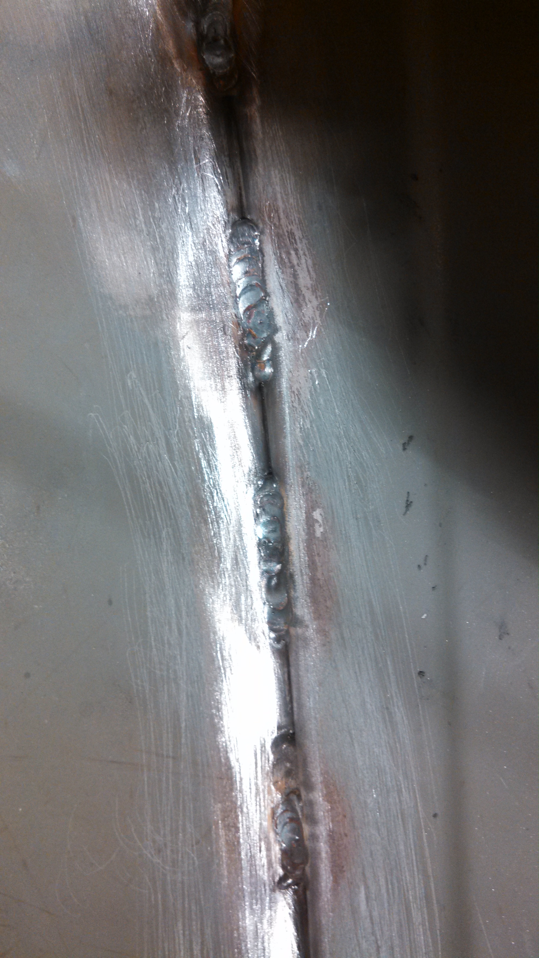

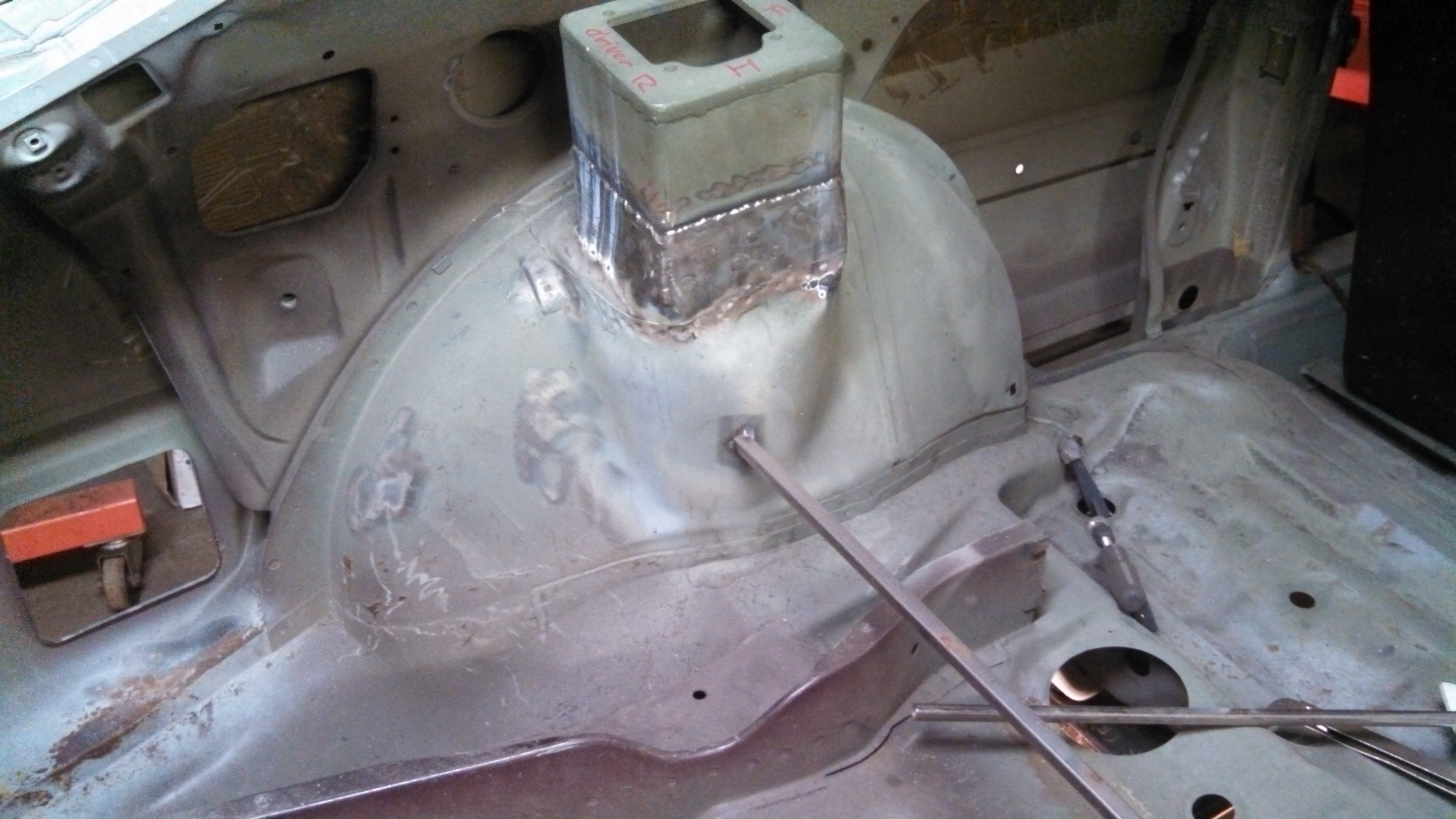

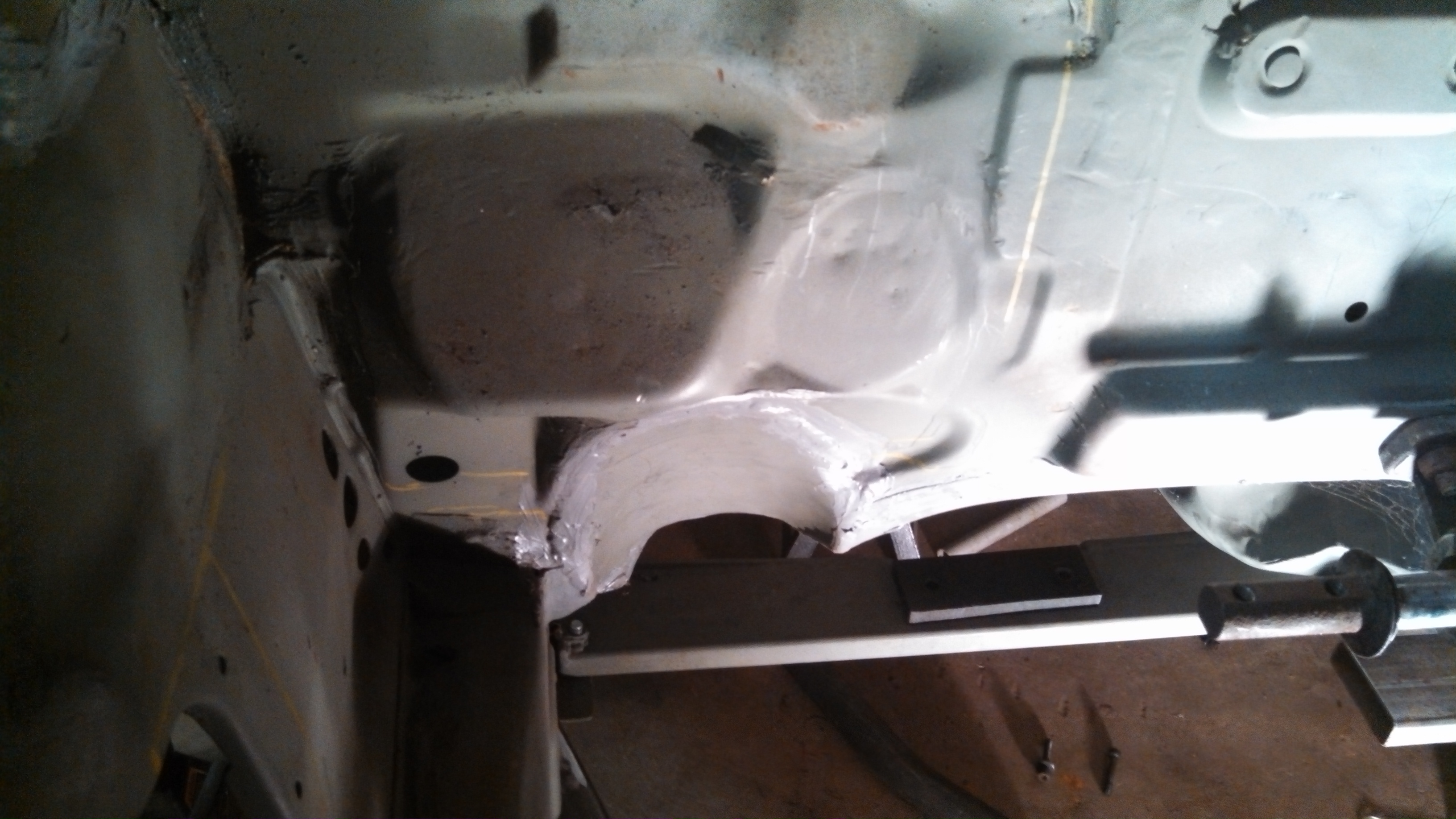

After welding up the rear strut tops, I wire wheeled the inner wheel wells and seam stitched them up. I welded about every other inch.
seam stitched inner driver rear wheel well.jpg (1.37 MiB) Viewed 38944 times
seam stitched inner pass rear wheel well.jpg (1.41 MiB) Viewed 38944 times
Then I did the in-cabin side of the wheel wells. I took awhile but it really does stiffen the chassis up. I have a few tiny rust repair patches to make in the back and it will all get seamsealed.

And some weld detail

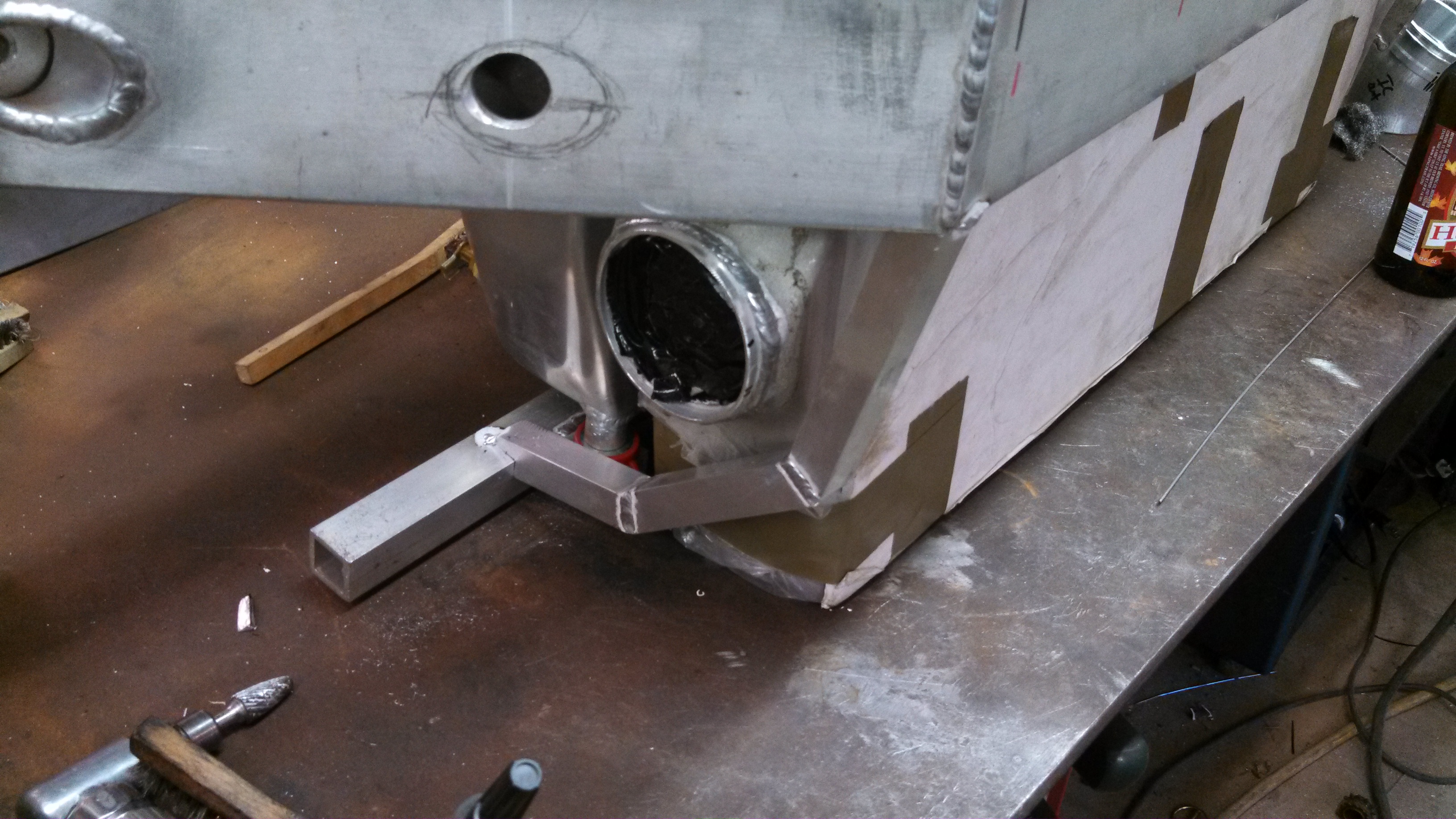

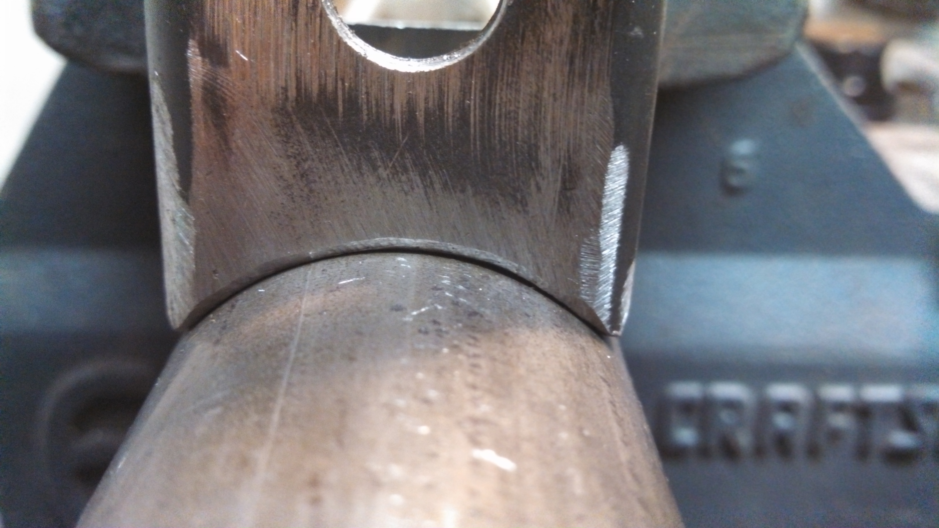

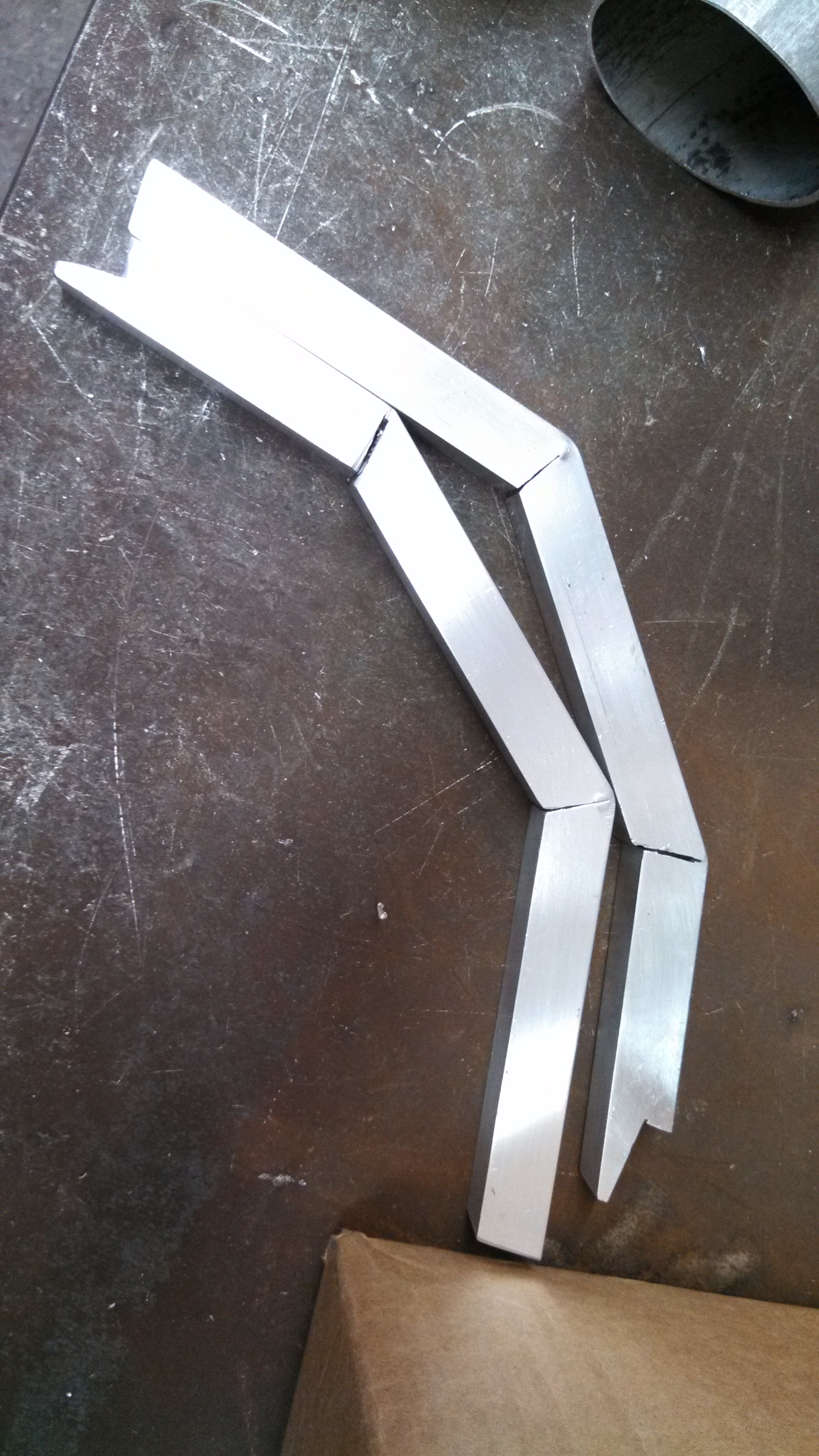

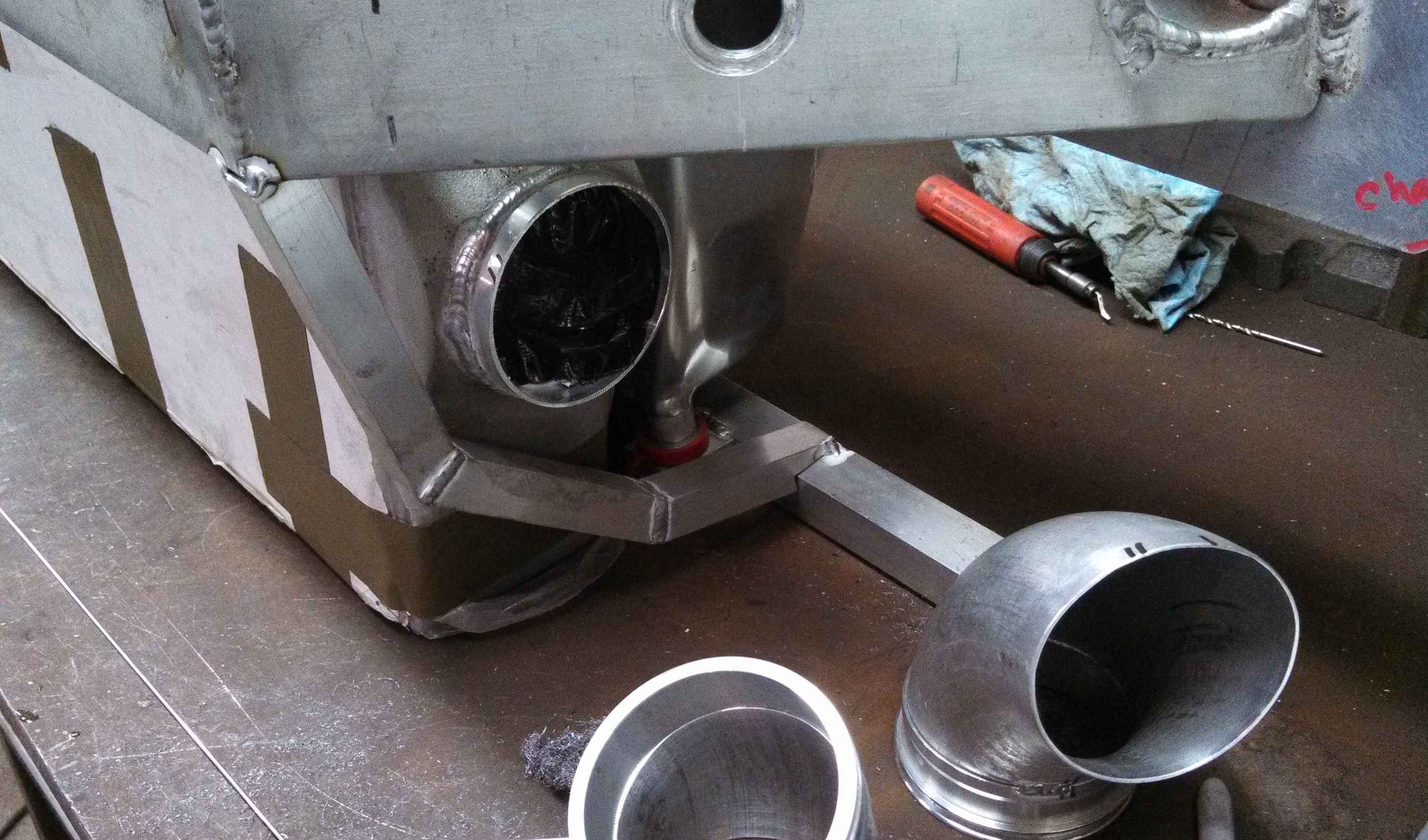

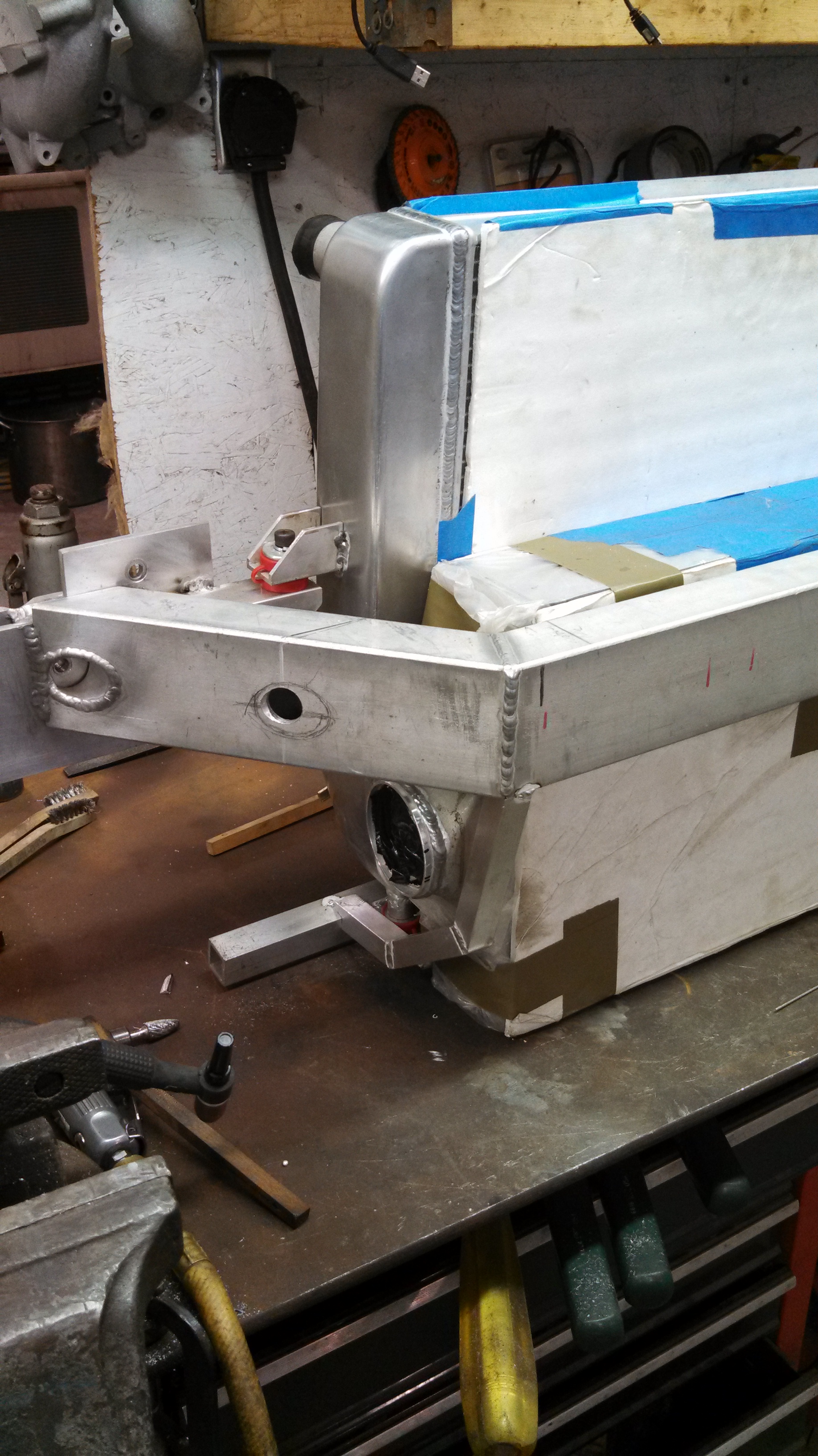

I also got a chance to work on the front cross-member. I made up some IC cradles out of some square stock, notched them and prepped them for welding.
front crossmember IC cradles ready for welding.jpg (1.9 MiB) Viewed 38944 times
Note the notch where it joins the lower bar, its quite strong this way.
front crossmember IC cradles joint detail.jpg (1.89 MiB) Viewed 38944 times
The IC upper mounts through the main bar. The lower will mount off a triangle tab welded to the vertical portion, and I can use the red silicone mounts there as well. I will add m8 female bosses to the IC at just the right height to fit well with the silicone snap grommets.
I had Ryan tack them up before I left.
front crossmember IC cradles tacked on.jpg (1.81 MiB) Viewed 38944 times
front crossmember IC cradles tacked on2.jpg (1.97 MiB) Viewed 38944 times

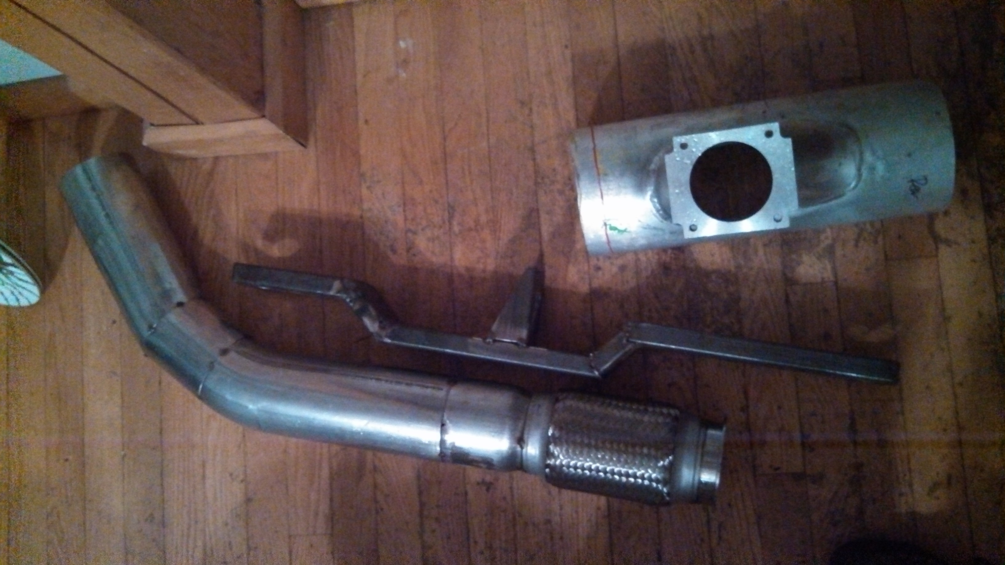

I also left Ryan @ Higbee Fab. a bunch of other stuff I had prepped. The Vanjen clamp flanges are ready to be welded to the short bends and welded to the IC endtanks.
vanjen flanges ready for seam welding.jpg (1.94 MiB) Viewed 39002 times

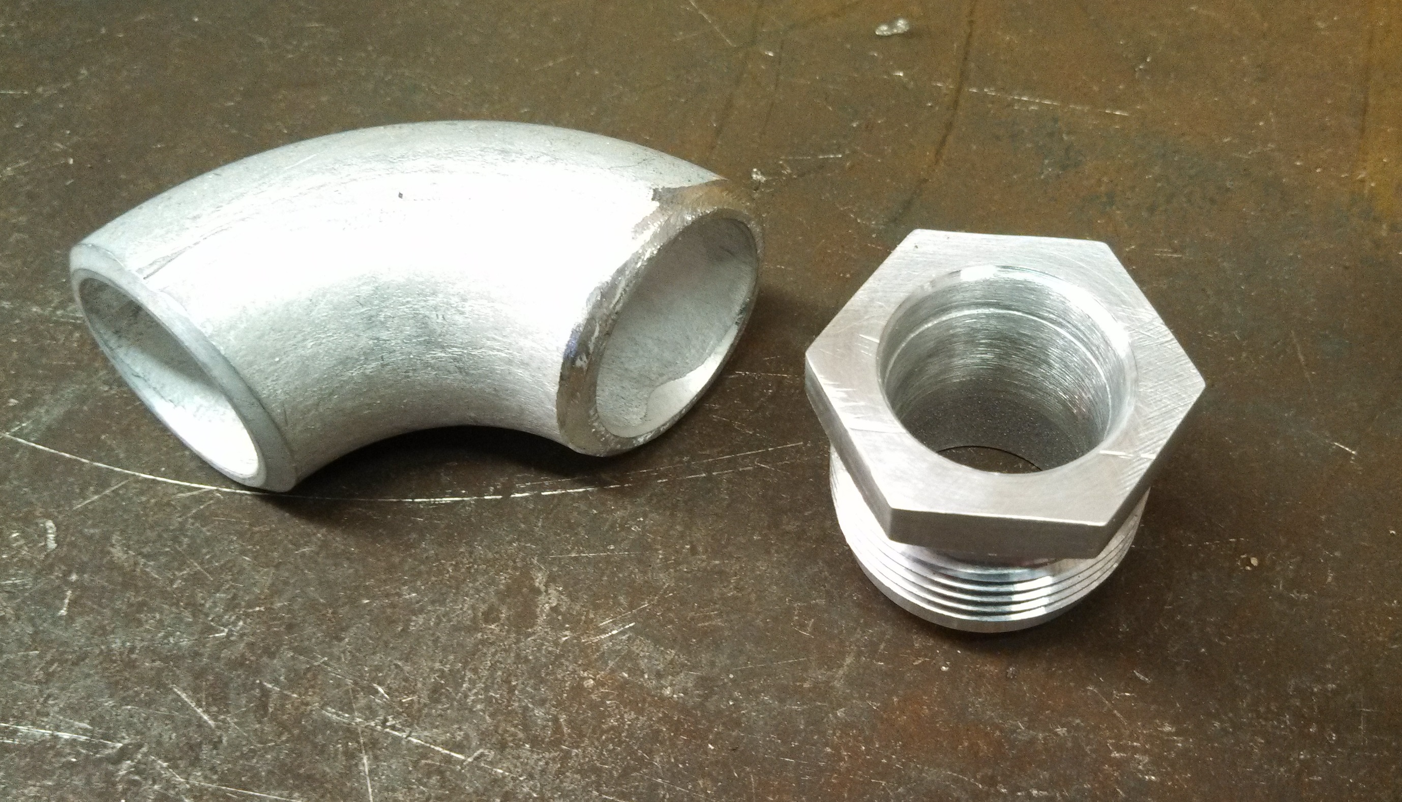

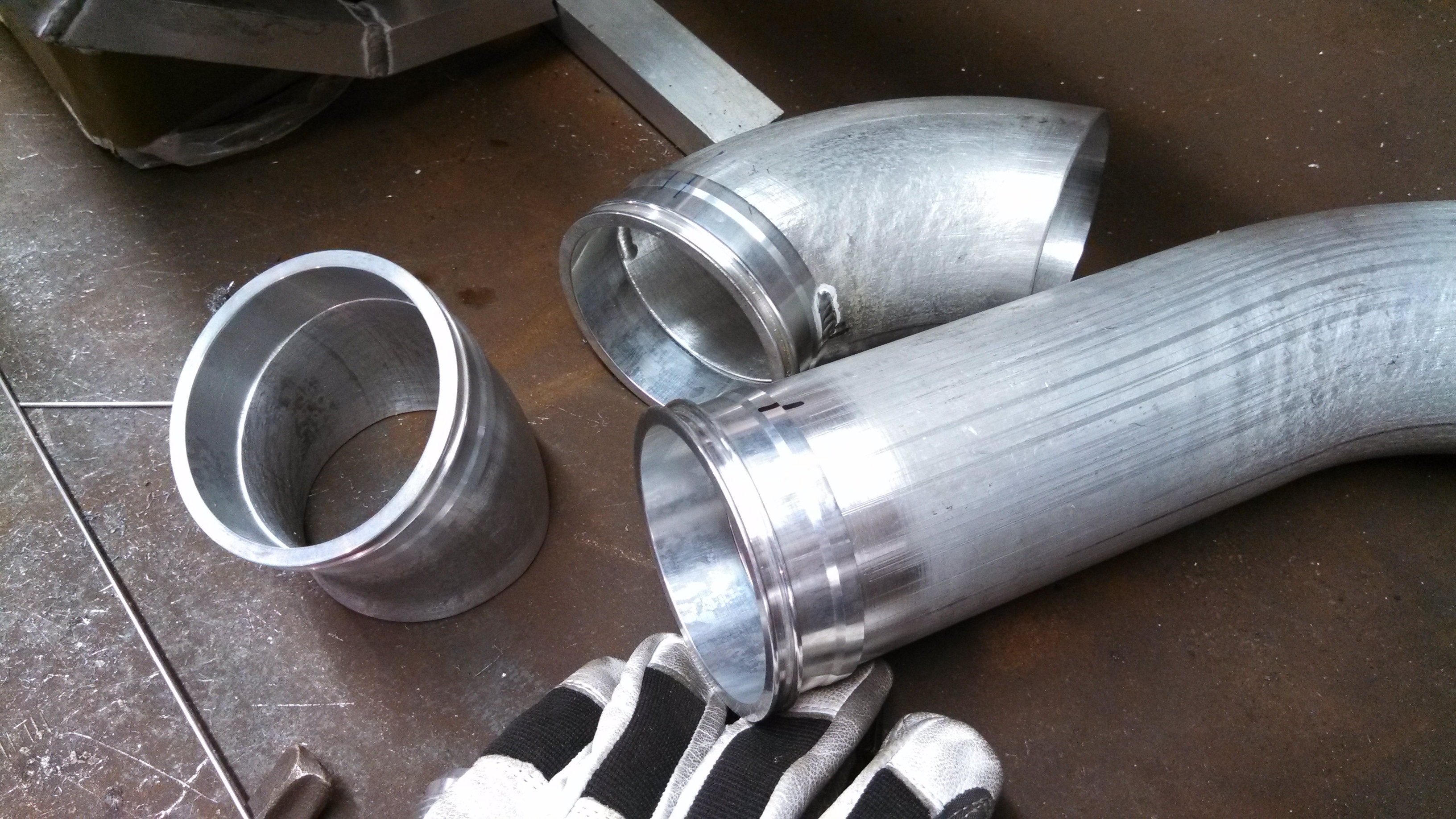

Also, the 16AN male to 1” aluminum elbow for the turbo oil drain into the oil pan.
16an turbo oil drain and elbow to pan.jpg (1.51 MiB) Viewed 39002 times
Also getting the DP seamed up so far, and the INNER portion of the IM seam welded! I got the inside all cleaned up with some new alu. specific carbide bits and its ready for seaming.

On the seam stitching, did you just grind the original seam sealer out, weld, then put seam sealer back over it? I need to repair some rust in that area in my 635 and wasn't exactly sure how to go about it. So grind out, weld, then put sealer there again?
Posted: Mon Sep 16, 2013 1:55 pm
by my2000apb
loxxrider wrote:Looks great Tim.
yeah, a long thin wire wheel to get it all out of the seams, a little propane torch and a wire brush help get it out of the little cracks too, the big thing is to constantly wire brush it off as you stitch, the welding heat makes the oem sealer soft and melts out back between the seams. weld, brush,weld brush etc
then grind, wire wheel, etch prime, seamseal and reprime, paint
