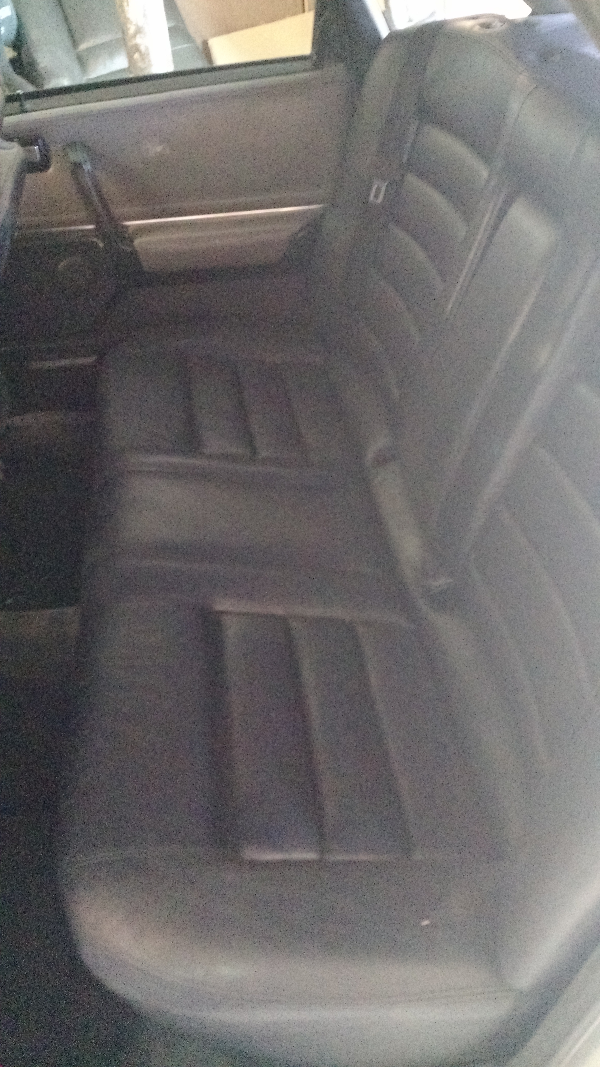

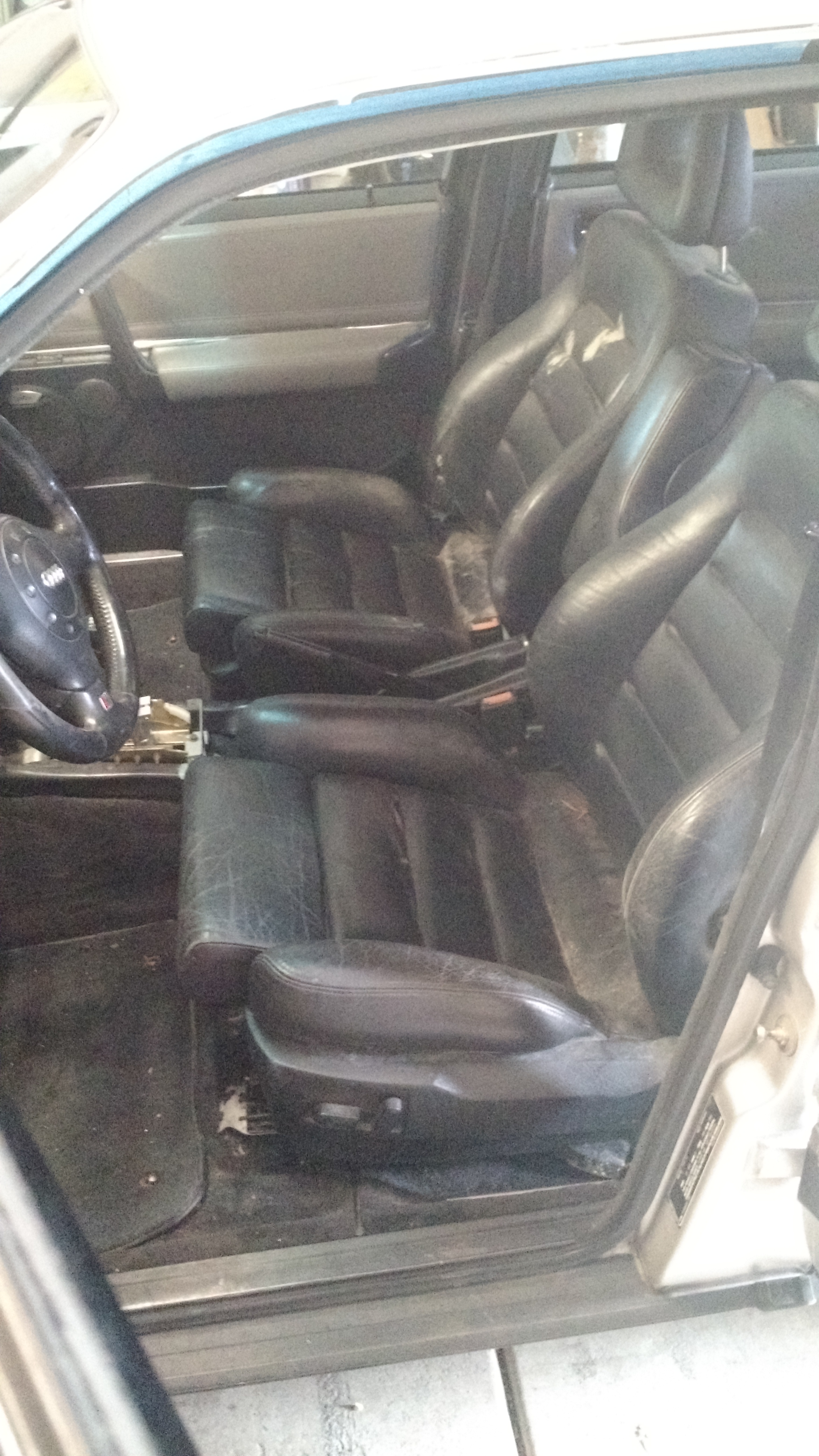

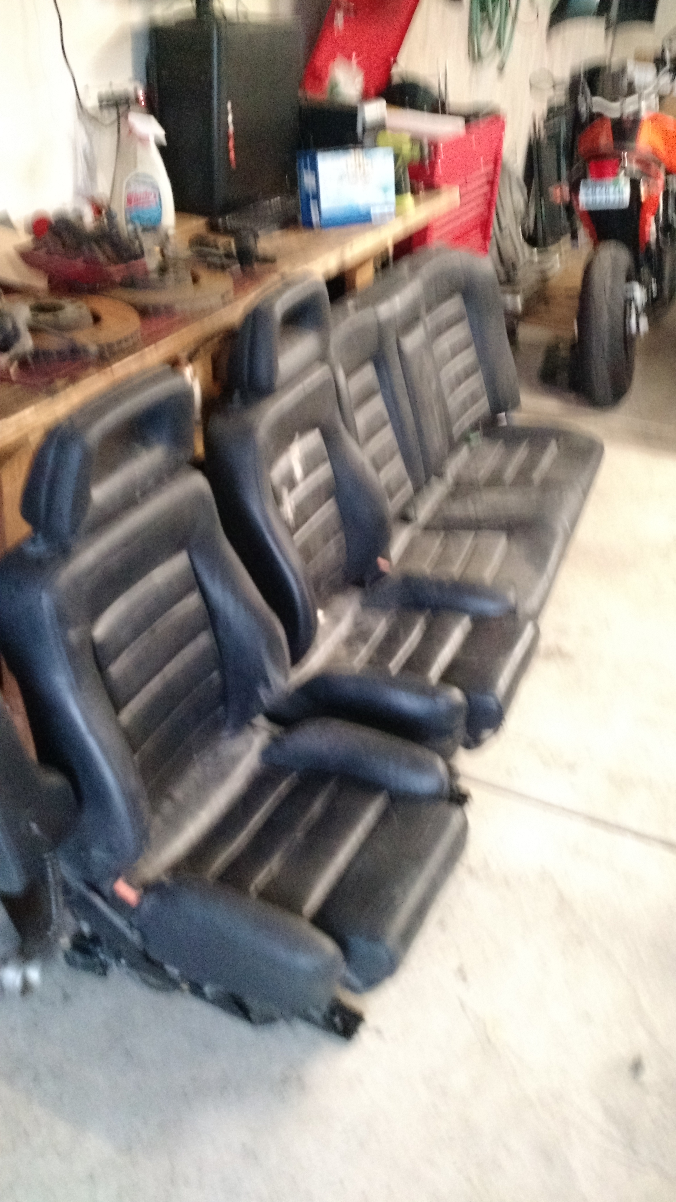

Posted: Sun Dec 11, 2016 5:37 pm
by pilihp2
Scuse shitty phone pics
but sweet
Re: Phil's 20vt 5ktq, Donuts are Delish
Posted: Mon Dec 12, 2016 11:51 am
Comfy!
