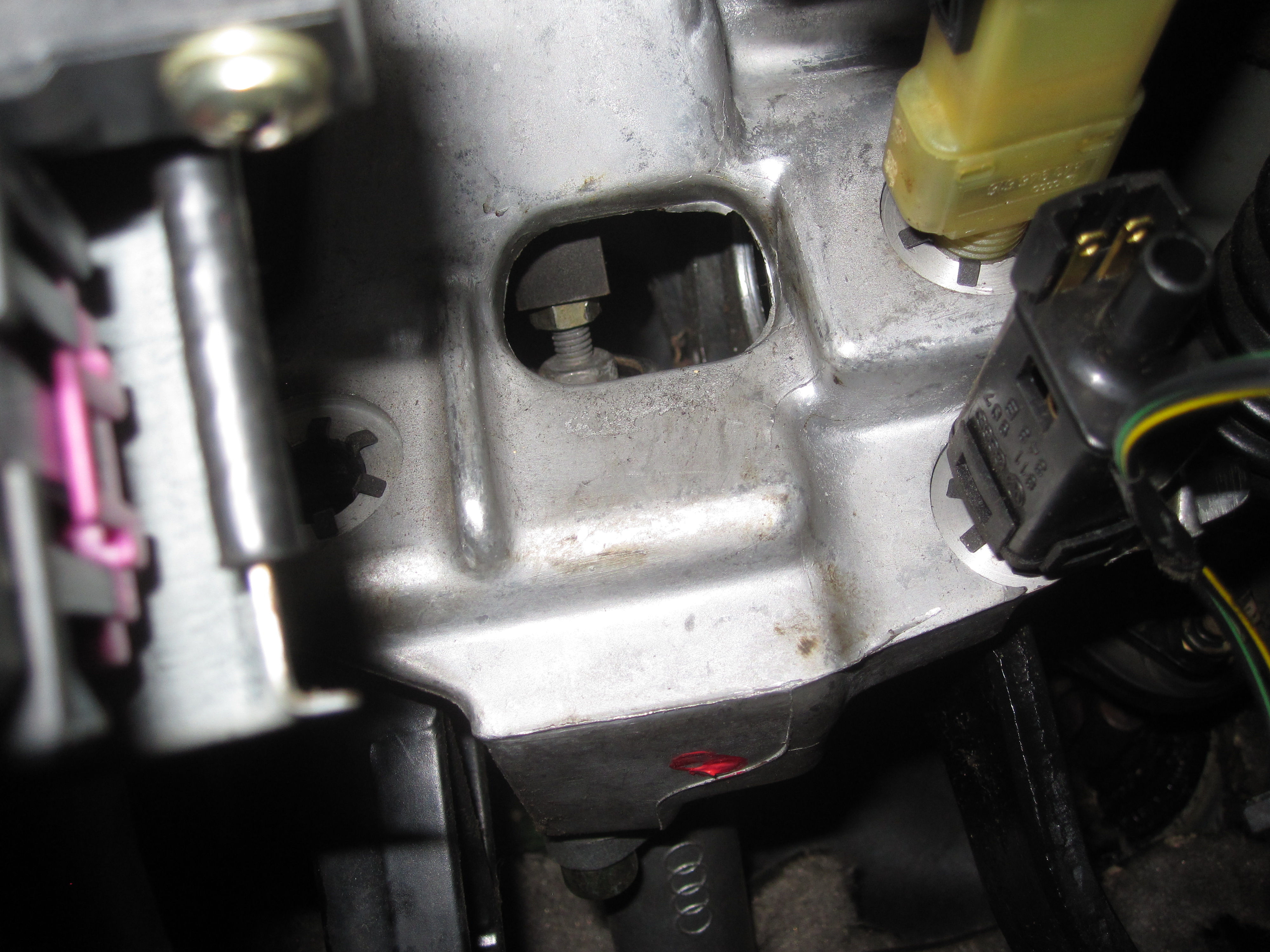

Also stupid question, i'm sure it's somewhere but can you explain in good detail how you went about adjusting your clutch grab point?

How to adjust clutch engagement point
Post by Aktapod »
themagellan wrote:Kevin(Sven) 100% go with the HPR stuff, the build quality is impeccable and they are powdercoated to boot!
Not a stupid question at all! In fact, when I first asked on MG, I was told it was not possible.
Start out by taking off the panel in front of the driver's knees (not sure what it's called) - the same one that's covering the relays. There are a couple of allen screws around the whole thing keeping it on, including two on the side underneath the cover on the left side that's against the door.
I'm sure if the next part is necessary from memory, but it'll help to gain access if you take the vent tube for the driver's footwell and rotate it out of the way or remove it completely. There are two phillips head screws that hold it in, on one either end of it. The left one just needs to be loosened and the other removed.
Now you just have to disconnect the vacuum lines leading to the clutch and brake switches, or remove the switches completely. They should be in the big metal assembly that the clutch MC is attached to. That should be it for disassembly!
On that same metal piece, you should see a little window between the switches that shows the a part of the pushrod from the master cylinder. It looks like this:
The top bronze-colored one is just a lock nut - loosen it in order to be able to adjust the pushrod. I think it's a 10mm. Then you just turn the lower grey nut (11mm?) to move the clutch. A little goes a long way, as it's pretty close to the axis of rotation. From the perspective of the picture, counter clock-wise will lower the clutch, and vice versa. There's not much space in the window, so I had to take my open-end wrench to turn part of the way, flip it over to get the rest, then rinse and repeat.
Then just lock the nut and reassemble.
The only problem I ran into is that my clevis (the dark thing it screws into) has a little play, so about 1cm of the clutch travel doesn't actually do anything to actuate the pushrod, so even though it looked just like I wanted it, I brought it back out 1 cm so it felt like I wanted it to. I'll problem tighten that up when the time comes for a new MC.
Anyways, that's that! Hope this helps!

Damn thanks dude - clever!

And to add to the clutch adjustment, there should be about an inch of play from the top of pedal travel to where it hits pressure. Dont adjust the play out of it or it will be under constant pressure, wearing the clutch prematurely. I was an automotive tech for 18yrs, so you can trust that info is accurate.

Sorry, I realize now the ambiguity of what I said. What I meant was to clean up the slop in the linkage from the clutch pedal to the master cylinder. It has a little play independent of the MC, both in the direction of travel and even some side-to-side.
