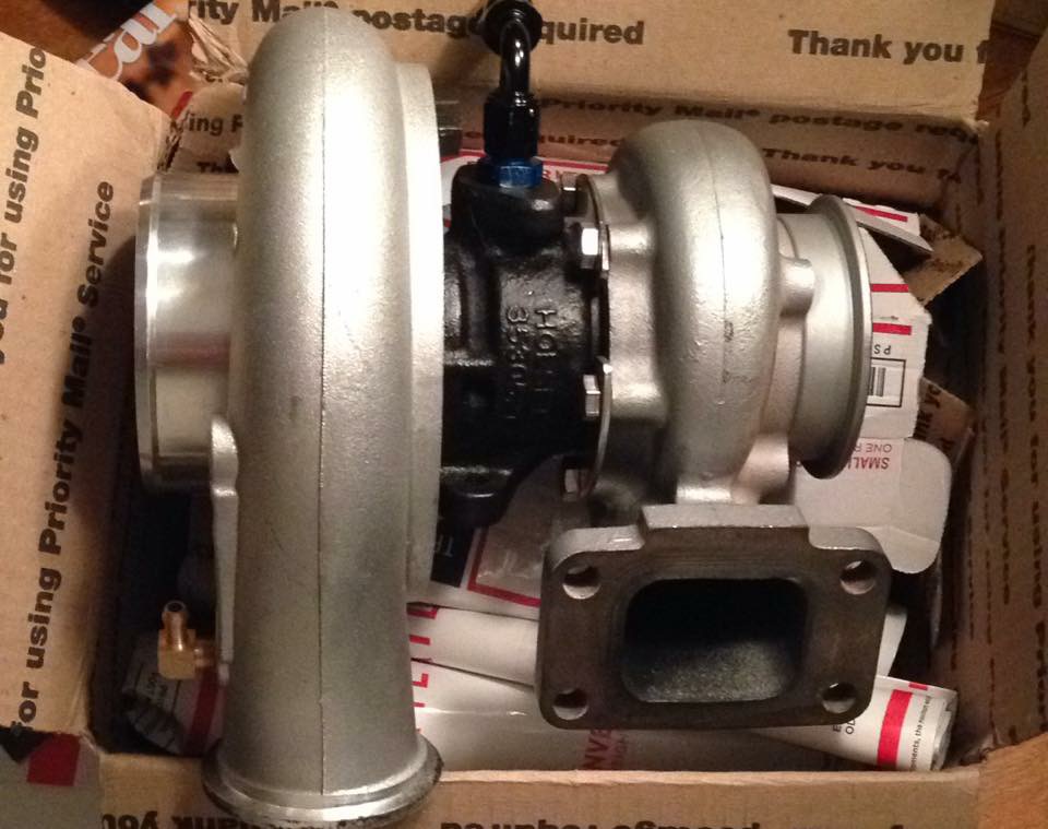

this car is gonna be a daily driver with mostly getting around traffic and the occasional HPDE. I am looking for the most responsive setup I can get from the hx40, which the 8CM2 will give me. Plus it came across my path with a price I really couldnt refuse. It's well worth the minor sacrifice in A/R considering my goal from the outset was to go with the BEP .70 A/R housing. Im not after dyno queen numbers but more after a fun as hell setup for romping on every day.
Re: LucidMatt's billet HX40 Super URS4: The Parts Hoarding P
ok, understandable. a 12cm housing still spools pretty damn fast. im jsut mentioning it as the purpose of going to hx40 over the hx35 is to let it breath more up top. 8cm will choke up well before stock redline. id think a 12cm housing'd hx35 would spin up faster even with the slightly larger housing due to there being less rotational weight to get spinning. id be wary of going to a too small a hotside if you planning on using pump vs e85
The housing is in! it's quite adorable. I am really intrigued to see what this setup does. If it chokes out, I can always go bigger.
