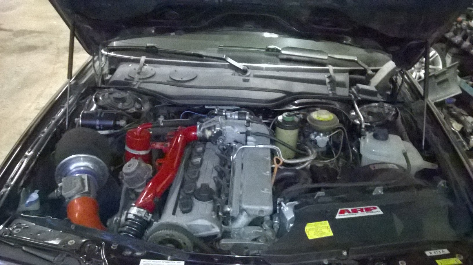

Things have moved on a bit again.
Still need to fix some issues in instrument cluster and assemble the front, but the engine bay is done at least for a while. :)

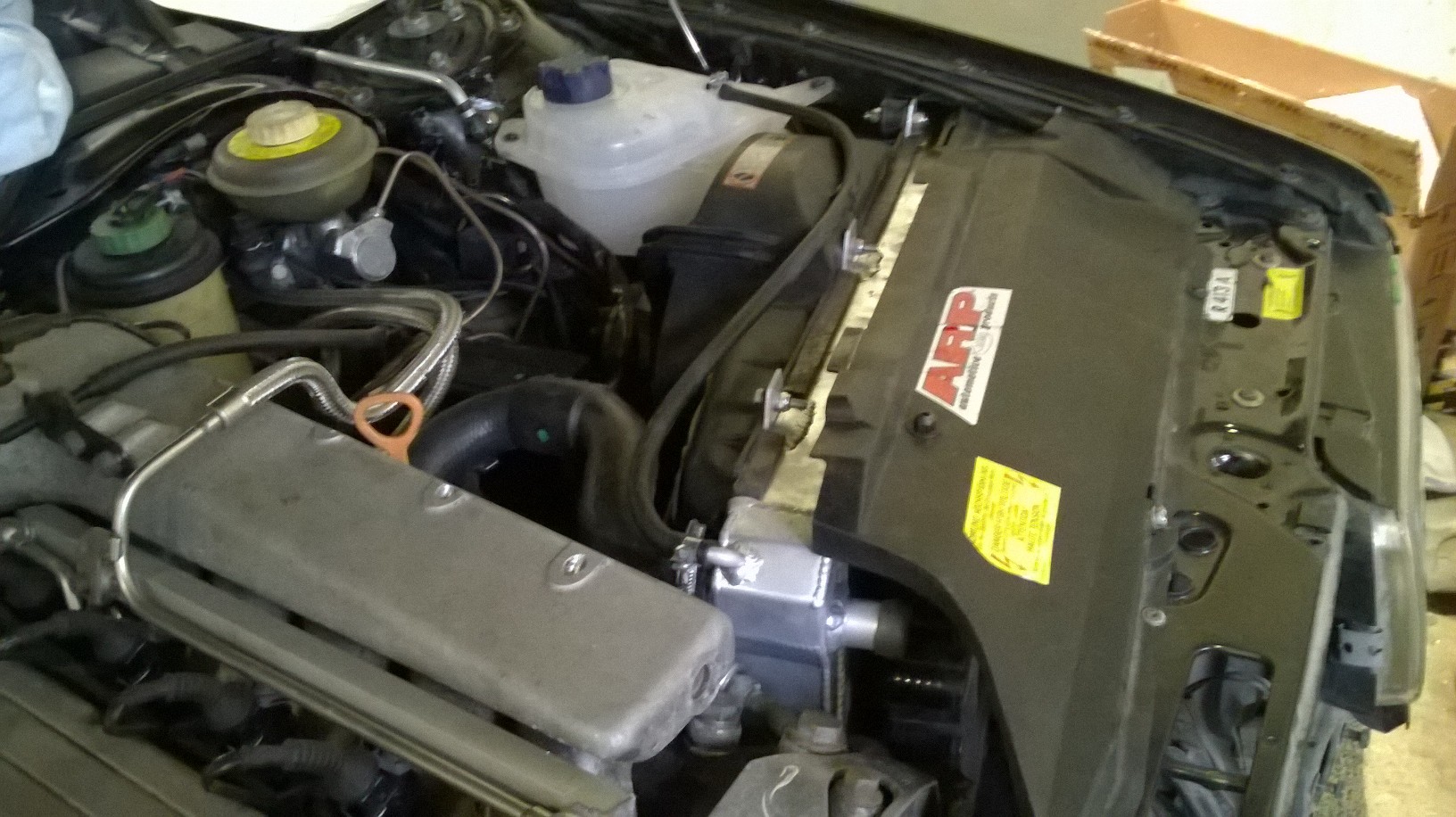

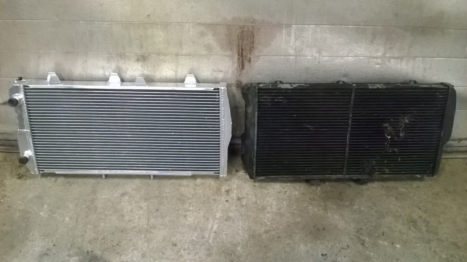

Got the new full aluminum radiator from ebay:
China made, but seems ok and bolted on just fine.
Had to plug the aux.rad. fittings thought since don't have it.
Repaired the washer fluid reservoir cracks and bought new pump, changed the a/c compressor since the one on the car was busted from day 1 and got a new fuel filter too.
Also painted some bits in engine bay, huge mistake. :roll:
Painting failed miserably, but I'll have to keep the hood closed from now on. :rofl:
Decided not to change the radiator hoses yet after all, 'cause cheapscate. :foff:
This will bite me back at some point I'm sure, but we'll see.

Nice work, hopefully the radiator lasts. Sometimes the Chinese ones are just fine. Hope to see pictures of your car at the car show.

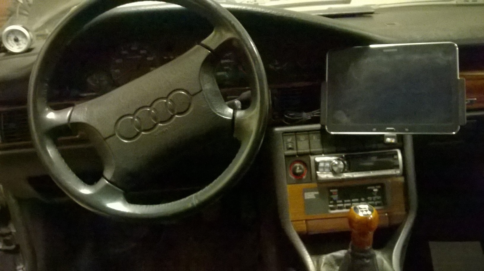

On a side note, I also got a tab mounted in the car with brodit holder as well as finished tampering with the instrument cluster.. 10 inch tab is a bit overkill. :lol:
Got this as vems display but the plans to get the pnp vems seem to go further and further...
That granpa steering wheel gotta go also at some point. Need to find something more fresh with an airbag.

I love the tablet for vems display! I'm interested to see what you come up with for a nicer airbag steering wheel. The only thing I can think of is the S4 or S6 wheels, but I don't think they look very good in the t44. Still a lot better than the grandpa wheel Haha. I always call it that too. Then again, the whole car is sort of grandpa-ish.

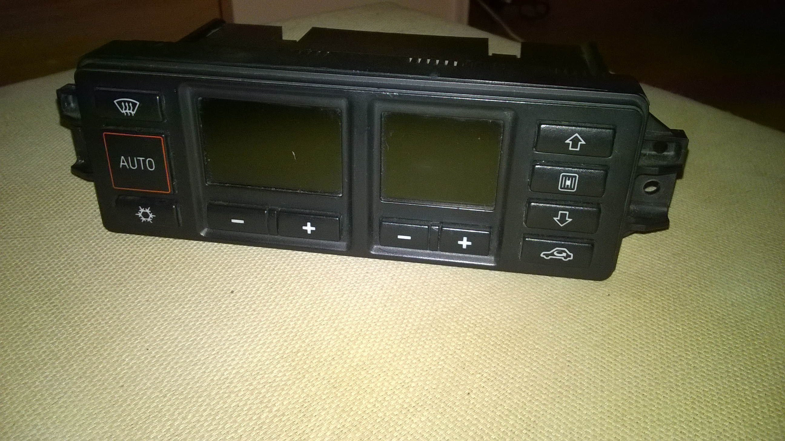

Also got this:
ilmastoinnin näyttö.jpg (1.56 MiB) Viewed 57091 times
A fellow audiclubfinland member sold it for pack of cigarettes. :D :thumbsup:

Hmm, I'll be interested to see if you get that climate control unit working and also how the steering wheel turn out!

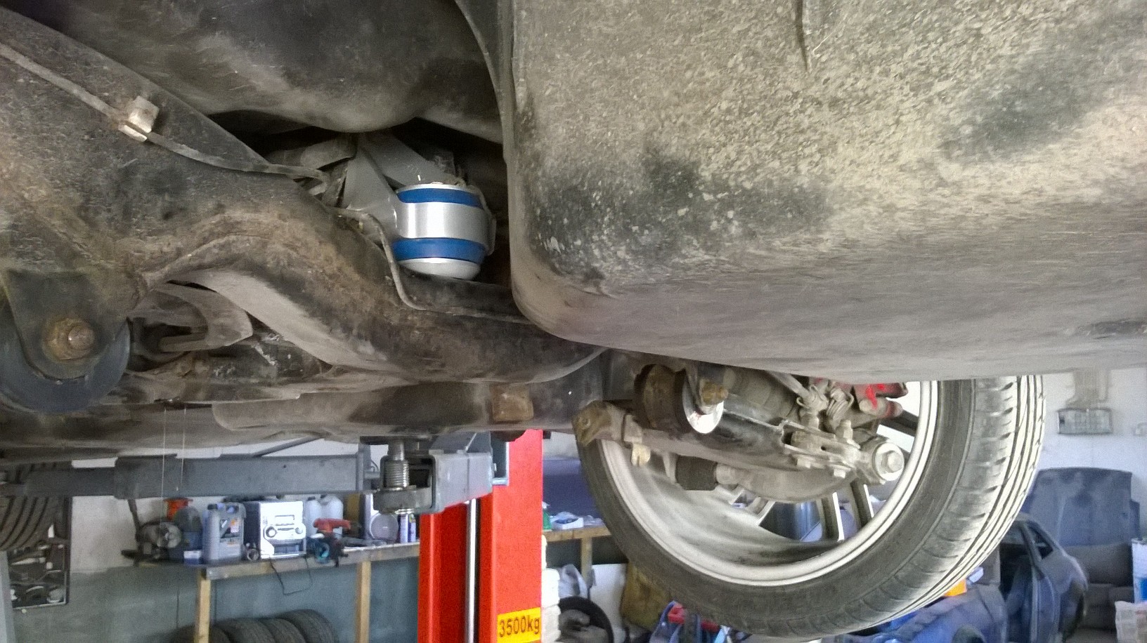

After I (and a friend who did the most work.. :P ) did the bushings for the rear xmember and all the bushes holding the rear diff, the bang that previously could be heard and felt going on and off gas was gone. 8-)
One pic also from the bushing work, the apikol rear diff mount is pretty sweet.

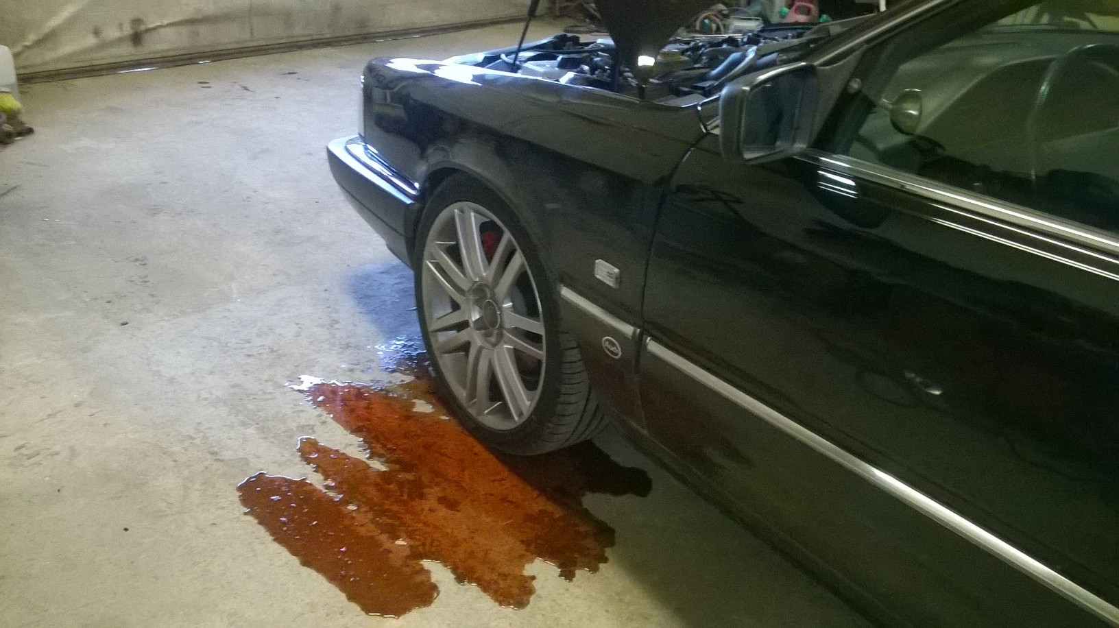

I got this one fully assembled again yesterday, and it seems I now have a leak free typ44... :o :wtf:
No need to say this, but it wasn't leak free for long.. :bangshead: Some coolant droping from somewhere, not much thought.
Need to adress this at some point.. Also the windshield gets foggy after I turn the heat on so new heater element is needed. Great.

What bushings did you use for the inner part of the rear control arm?
Re: 220vt from Finland
Your car looks great! I'm glad to see things are progressing nicely. I need to do all of my subframe bushings at some point too.
Juizer
Posts: 72
Location: Finland
Post by Juizer »
Thanks Loxx and scubadave. :)
I used Powerflex PFR3-206.

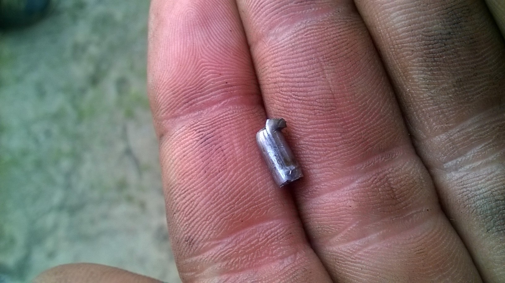

The 200 is also at no go. Drove it for maybe 4000 km or more in total and then problems started.

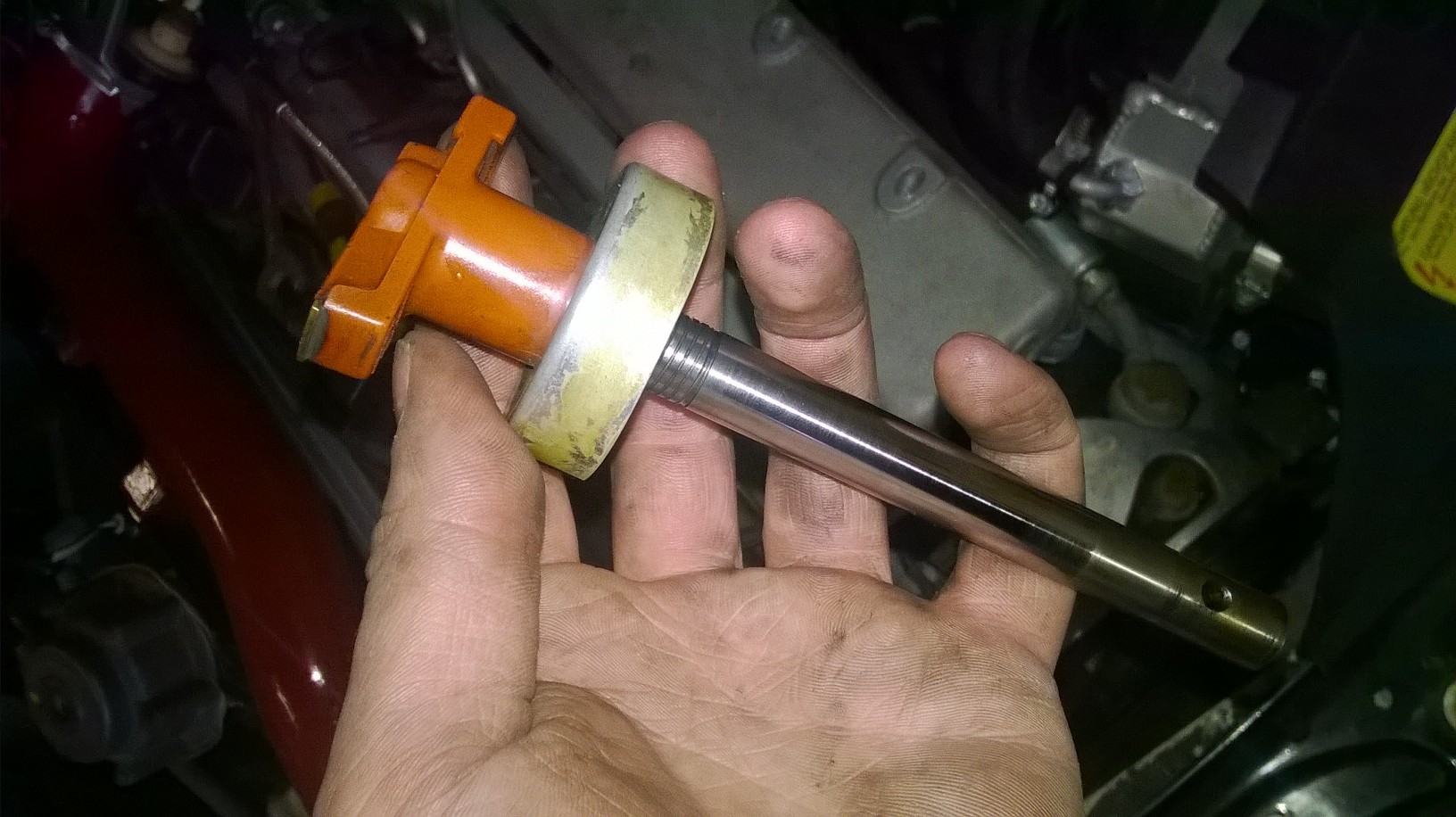

First time it died on supermarket parking lot. Got it home, red the fault codes and tadaa, hall sensor it is. :we:
Next, remove the distributor.
Got scared when the distributor axle ( or what would you call it.. ) came off whitout the distributor gear.
The pin was gone and all I found was this:
Gotta hope the rest of it is in the oilpan..

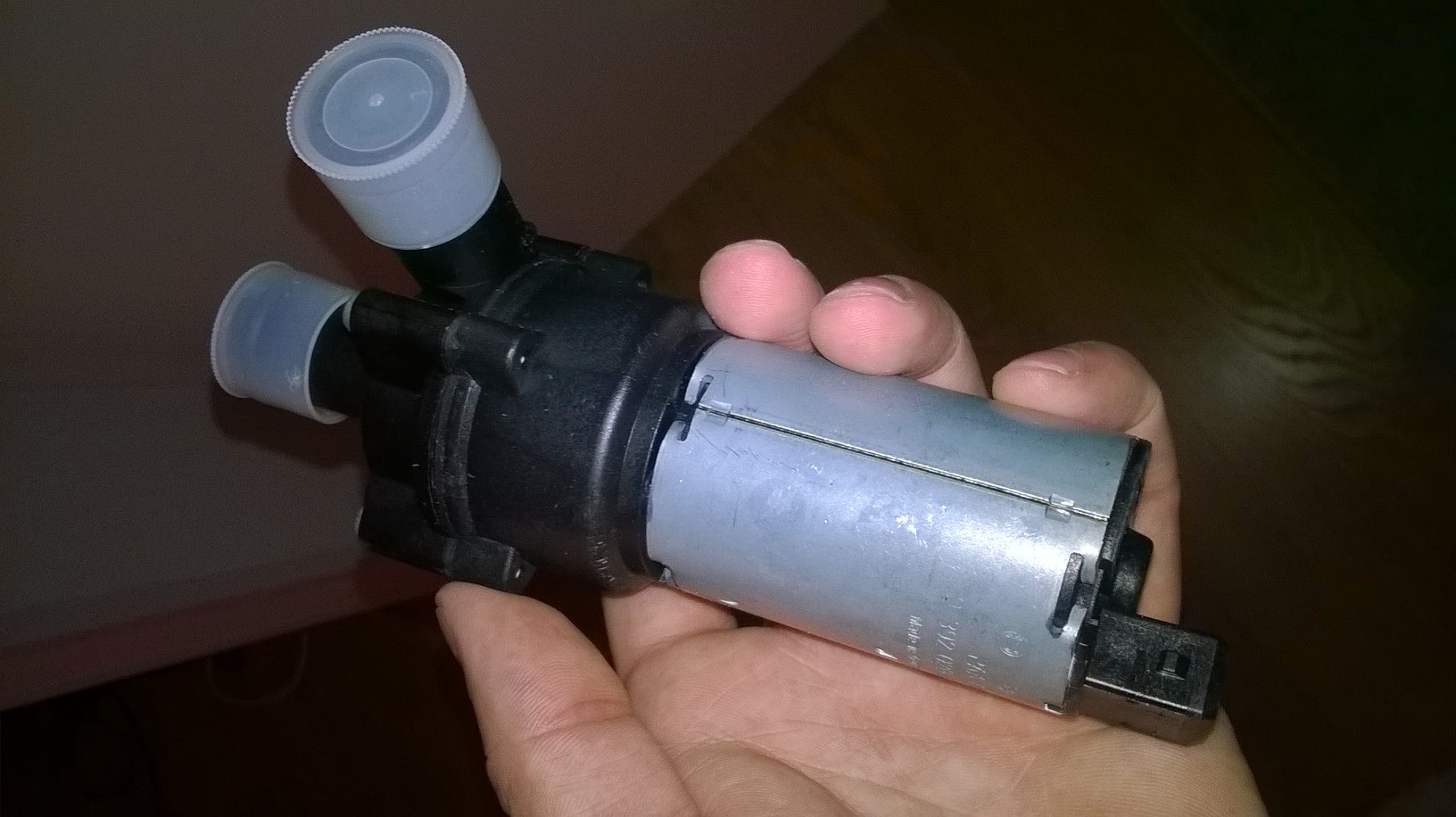

After I got the gear back in its place and everything ready to go, I bumped just a bit to the aftercooling waterpump and:
:bangshead:
Yesterday, a week later, I got a new pump and the car back on road. For a while at least.

Suprise, suprise.. It's the hall sender. Got the code again from vag-com.

Replaced the sender and bang, it started right away.
Also bought new after run pump which is a bit shorter than oem part, but fits nice and does the job. Replacement was also quite much cheaper, an Opel or Saab part I believe.. :roll:
Bosch part no: 0392020034
