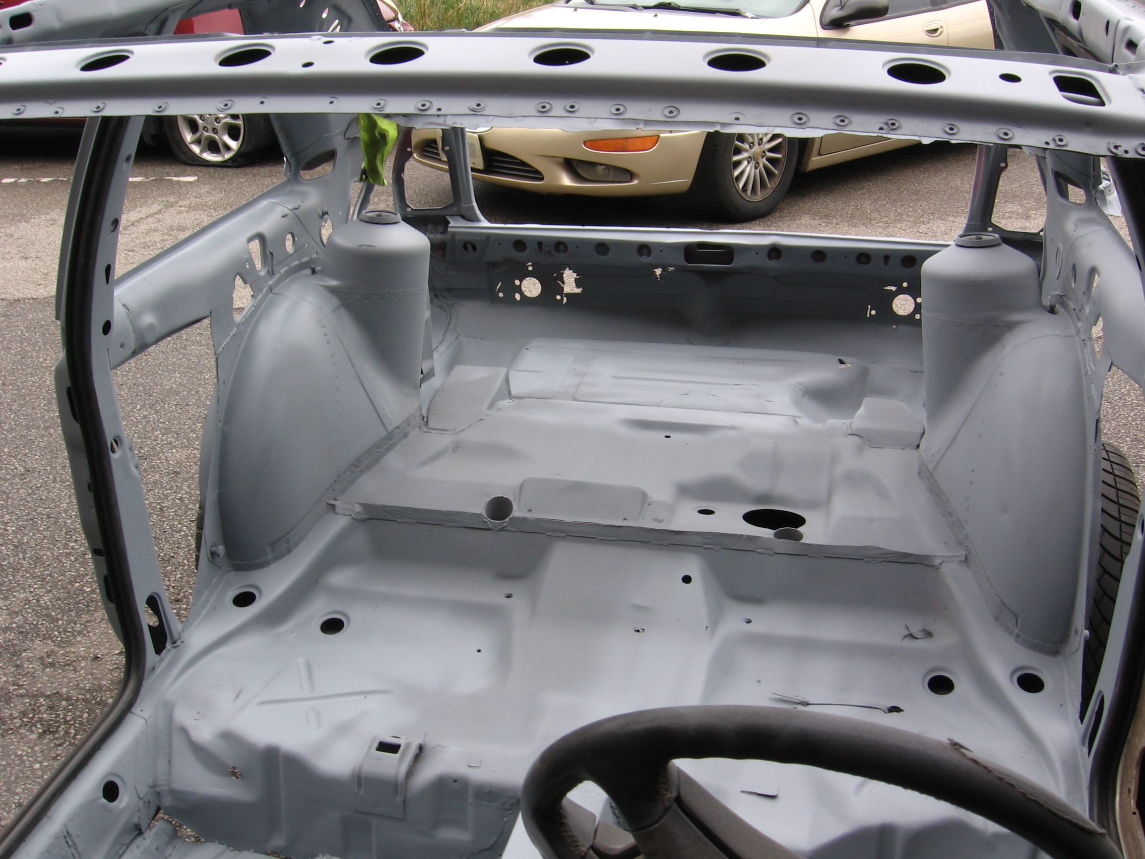

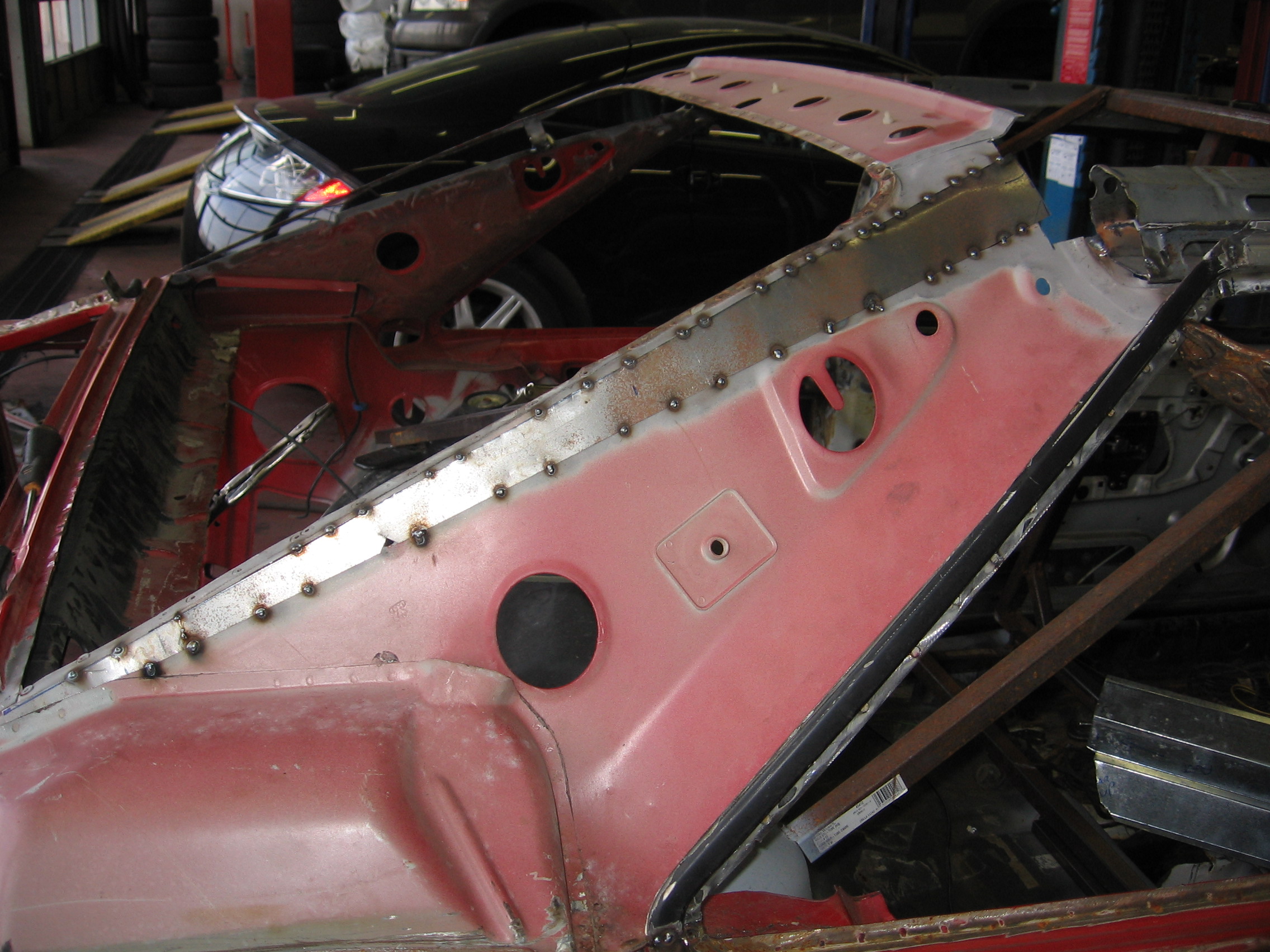

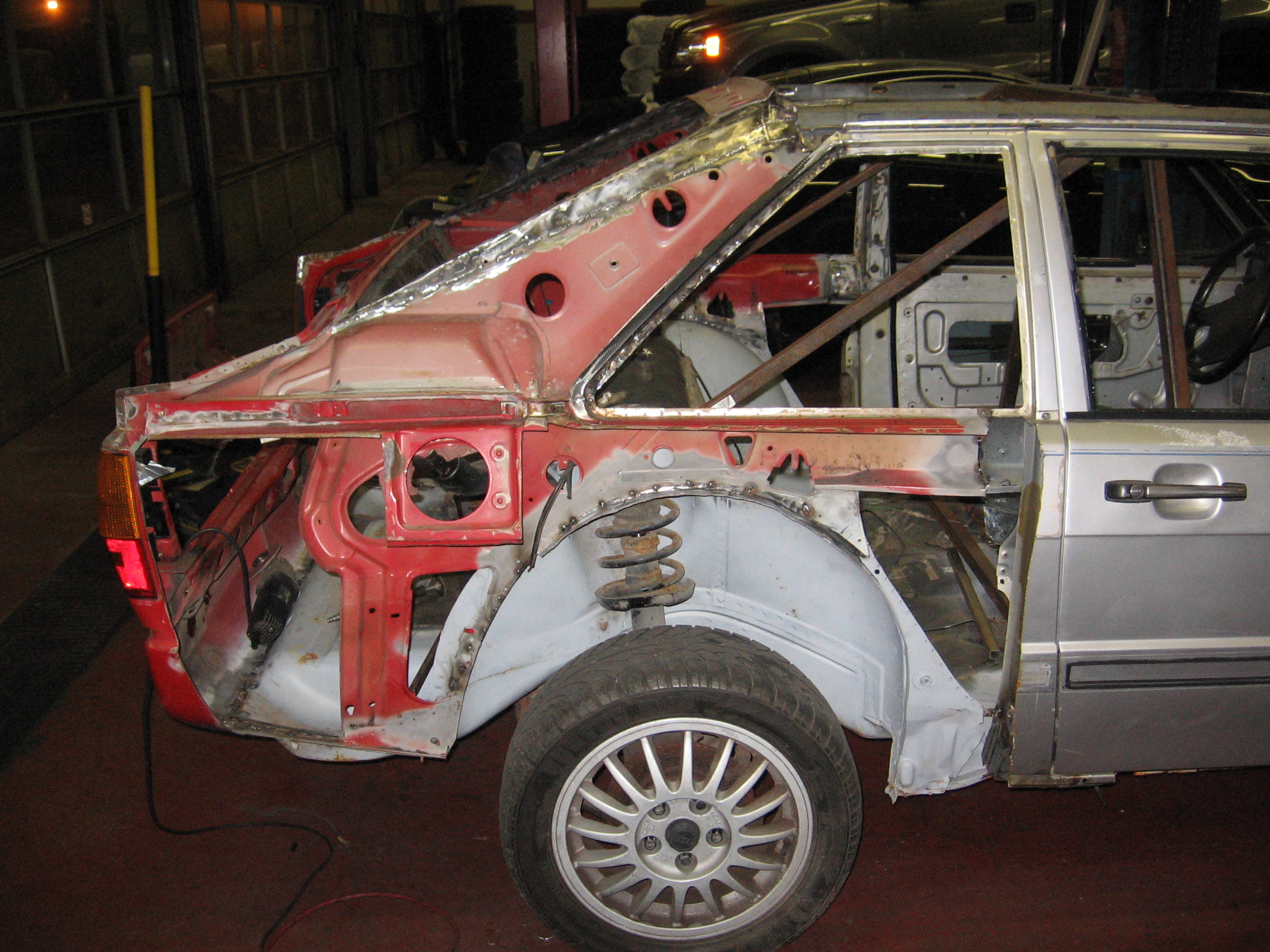

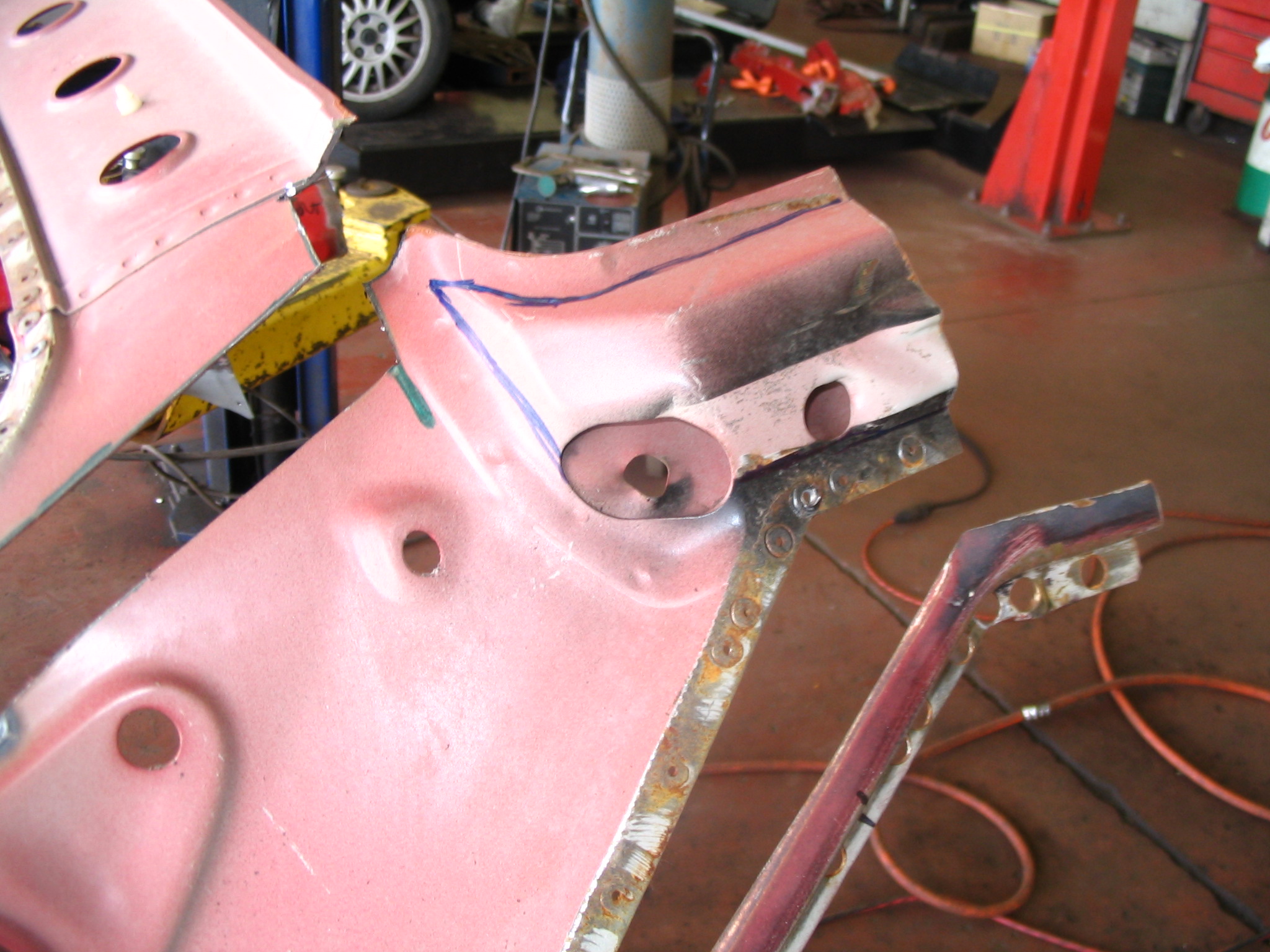

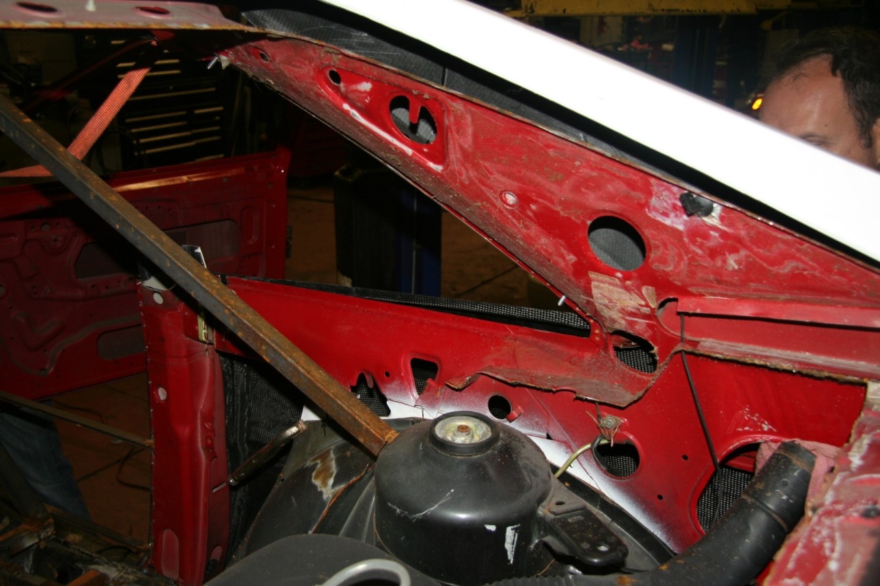

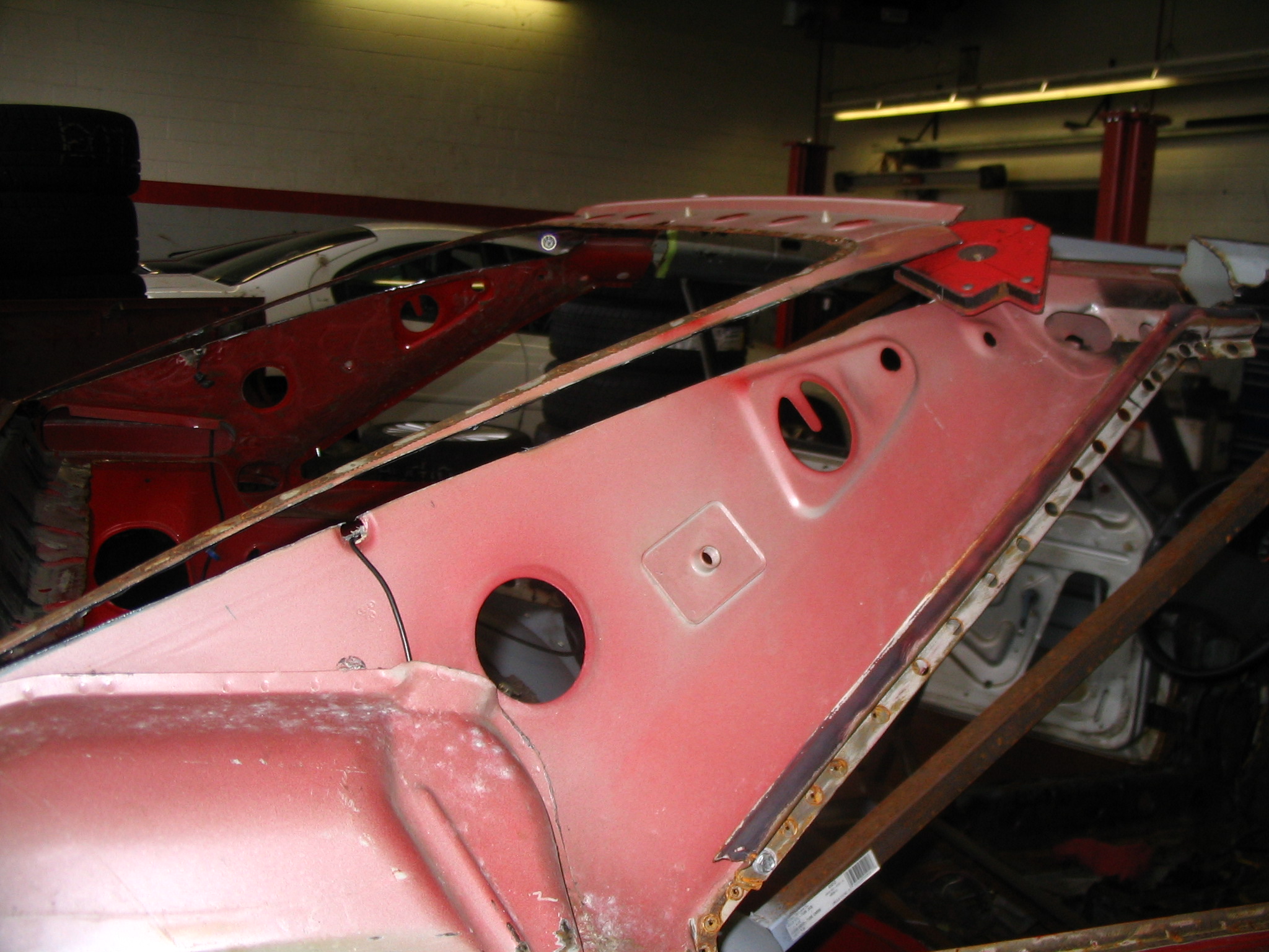

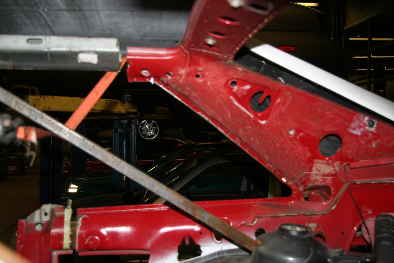

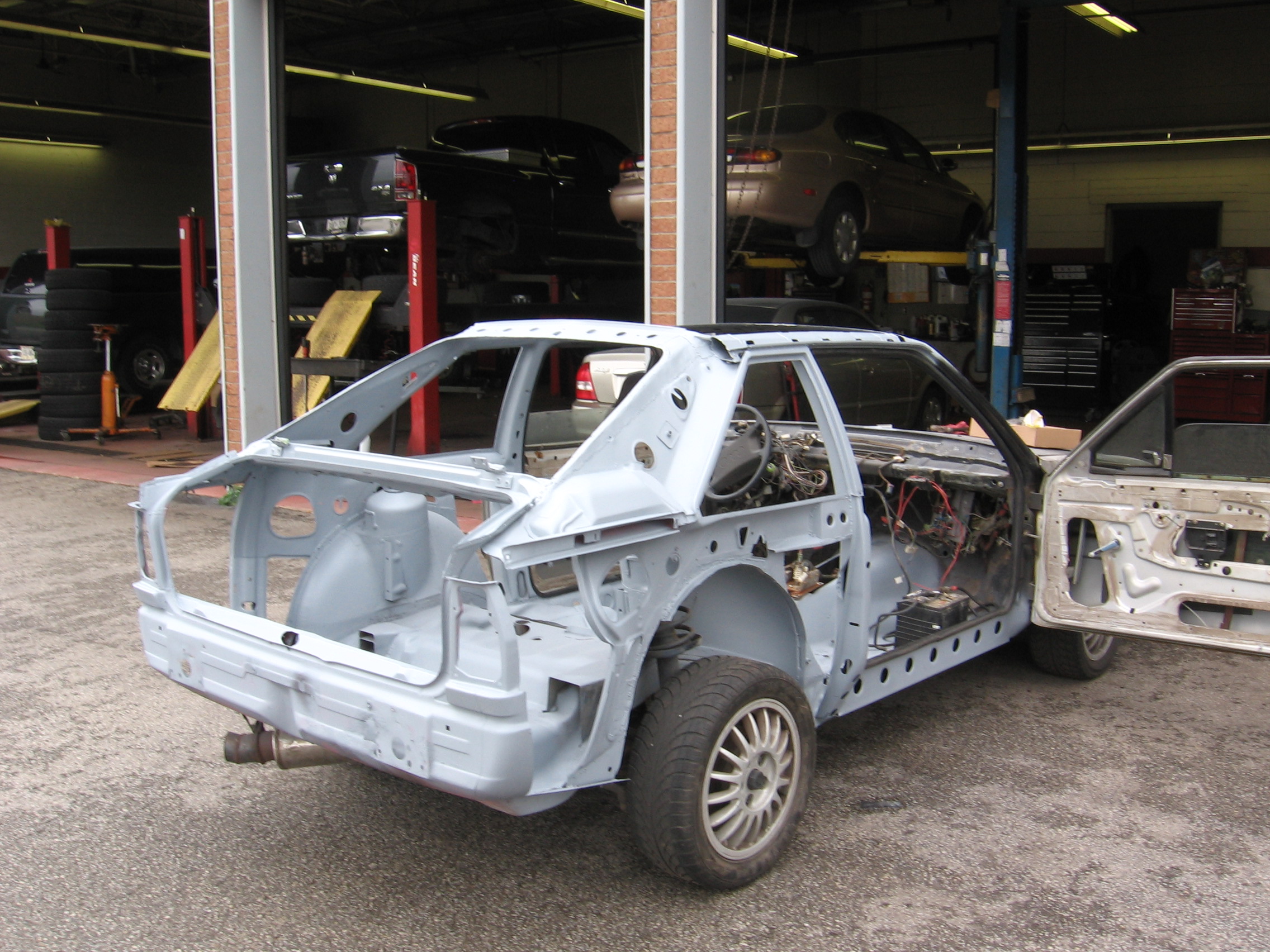

Next on the to do list is modifying the c pillar.
For the people that don't know, the sport quattro C pillar is different than the coupe C pillar.
Both cars use the same rear window,however in the sport quattro the rear window sits at a steeper angle.
So modifications are required.
In these pictures you can see what's required to get the sheet metal to match the Carbon Fibre
sport quattro roof.
Cheers,
Craig Cook.
sport quattro roof.
Cheers,
Craig Cook.

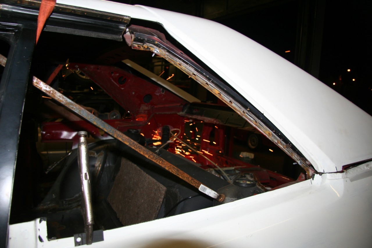

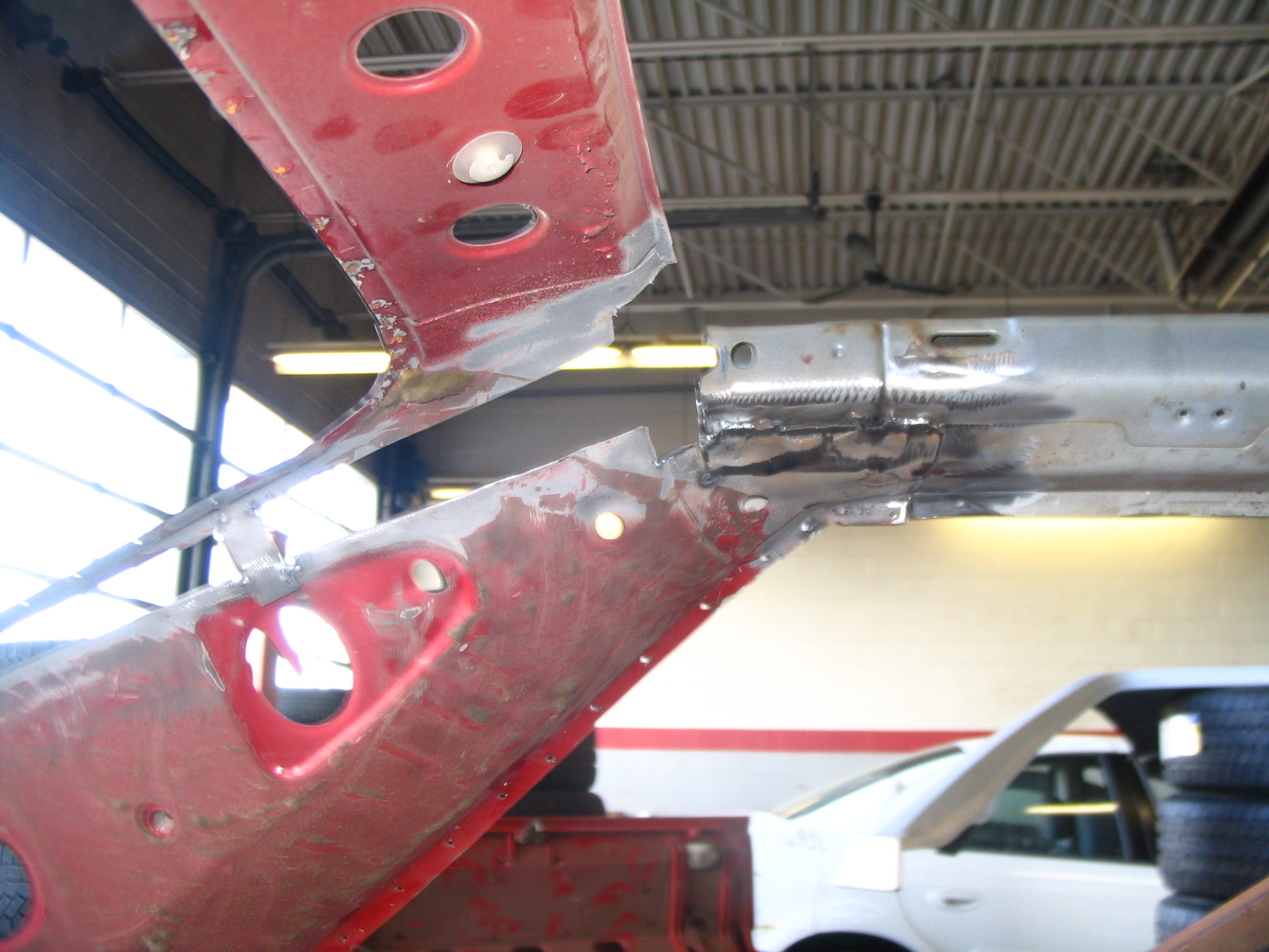

highlander69
- Posts: 279
Re: Craig's Sport quattro build

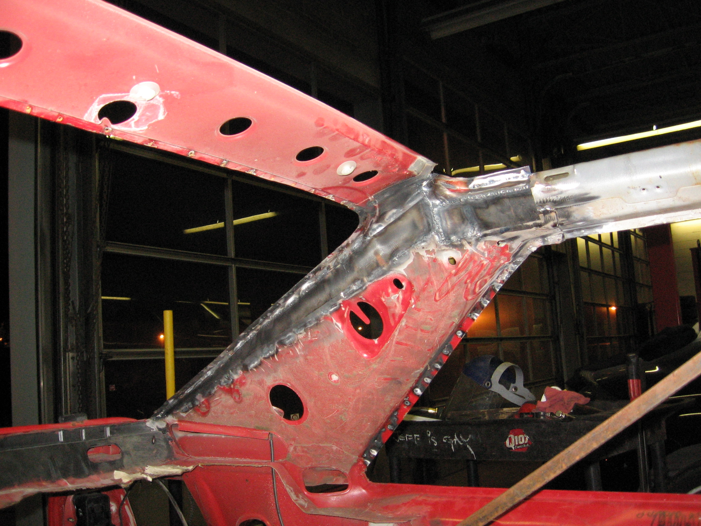

A few pictures of the cutting.
- IMG_1260.JPG (678.4 KiB) Viewed 35888 times
- IMG_1274.JPG (638.88 KiB) Viewed 35888 times
- IMG_1273.JPG (626.24 KiB) Viewed 35888 times
- IMG_1243.JPG (676.89 KiB) Viewed 35888 times
- c pillar modified 002.jpg (891.16 KiB) Viewed 35888 times
highlander69
- Posts: 279
Still final prep required. Grining welds etc. but you get the idea.

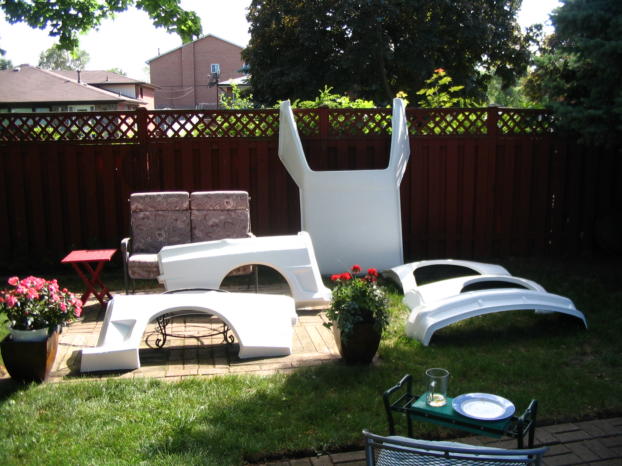

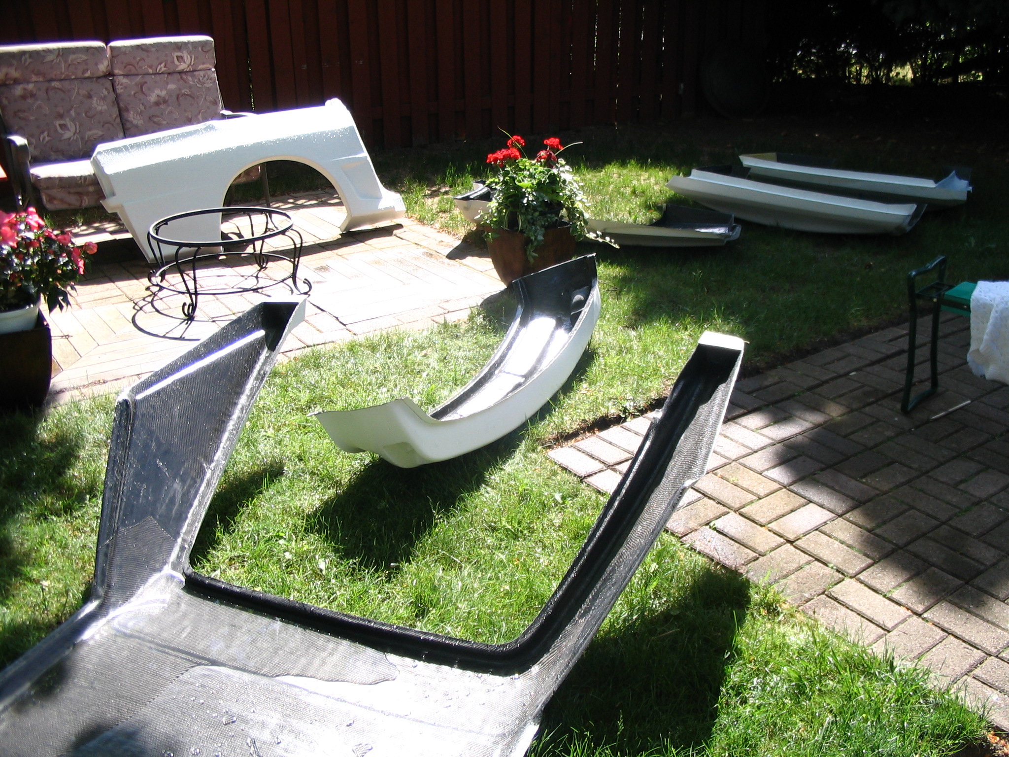

Finally my body kit was done.
I opted for the full Carbon Fibre version.
The hood and front grill still have to be done yet.
I'm really happy with it. Lot's of trimming to do, but I will spend the time
to make sure it fits correctly.
Cheers,
Craig Cook
Cheers,
Craig Cook

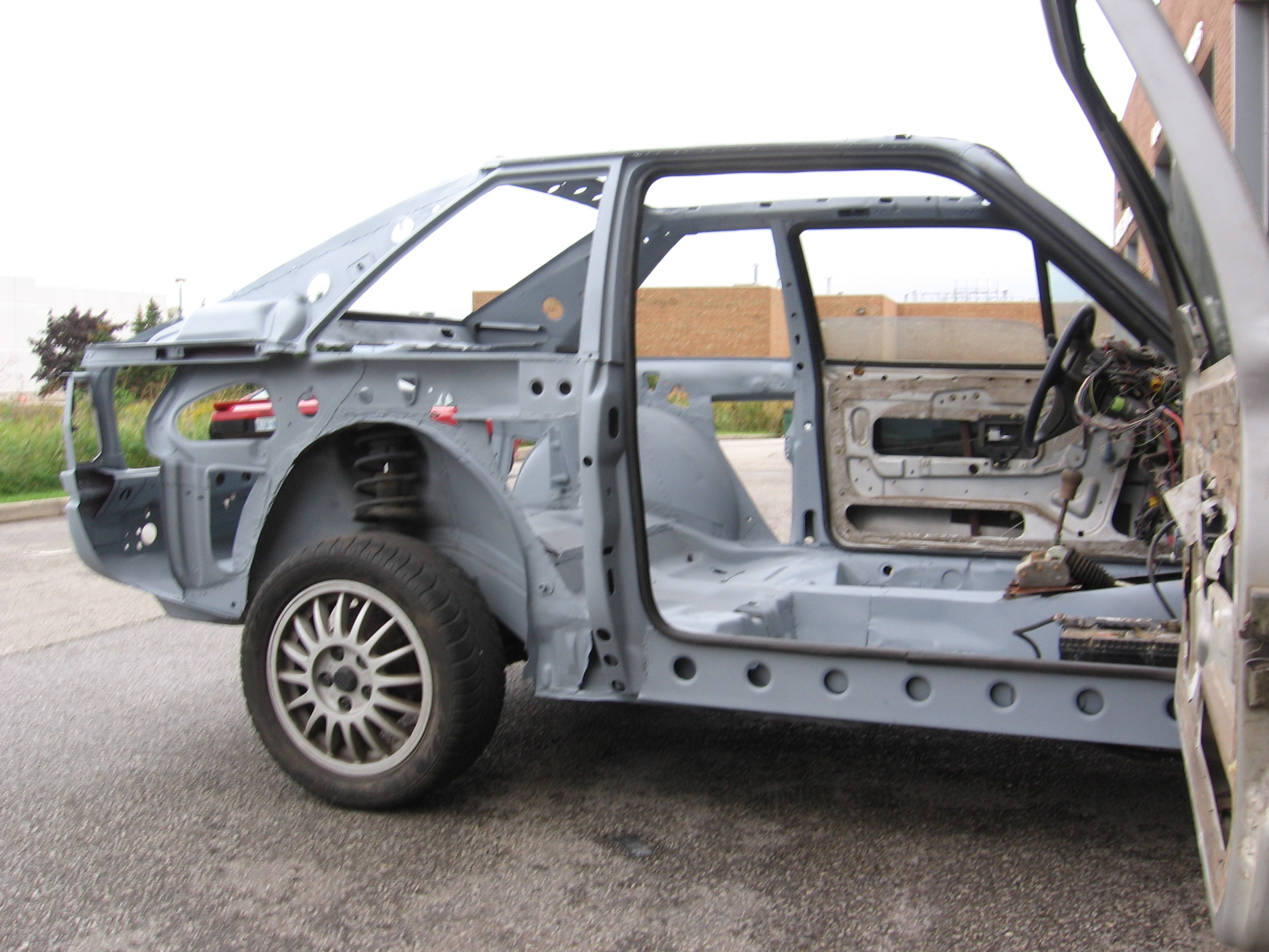

highlander69
- Posts: 279
Time to get some primer on this before it goes home for the winter.
- car in primer 001.jpg (958.35 KiB) Viewed 35888 times
- car in primer 002.jpg (887.69 KiB) Viewed 35888 times
- car in primer 003.jpg (864.91 KiB) Viewed 35888 times
- car in primer 004.jpg (784.69 KiB) Viewed 35888 times

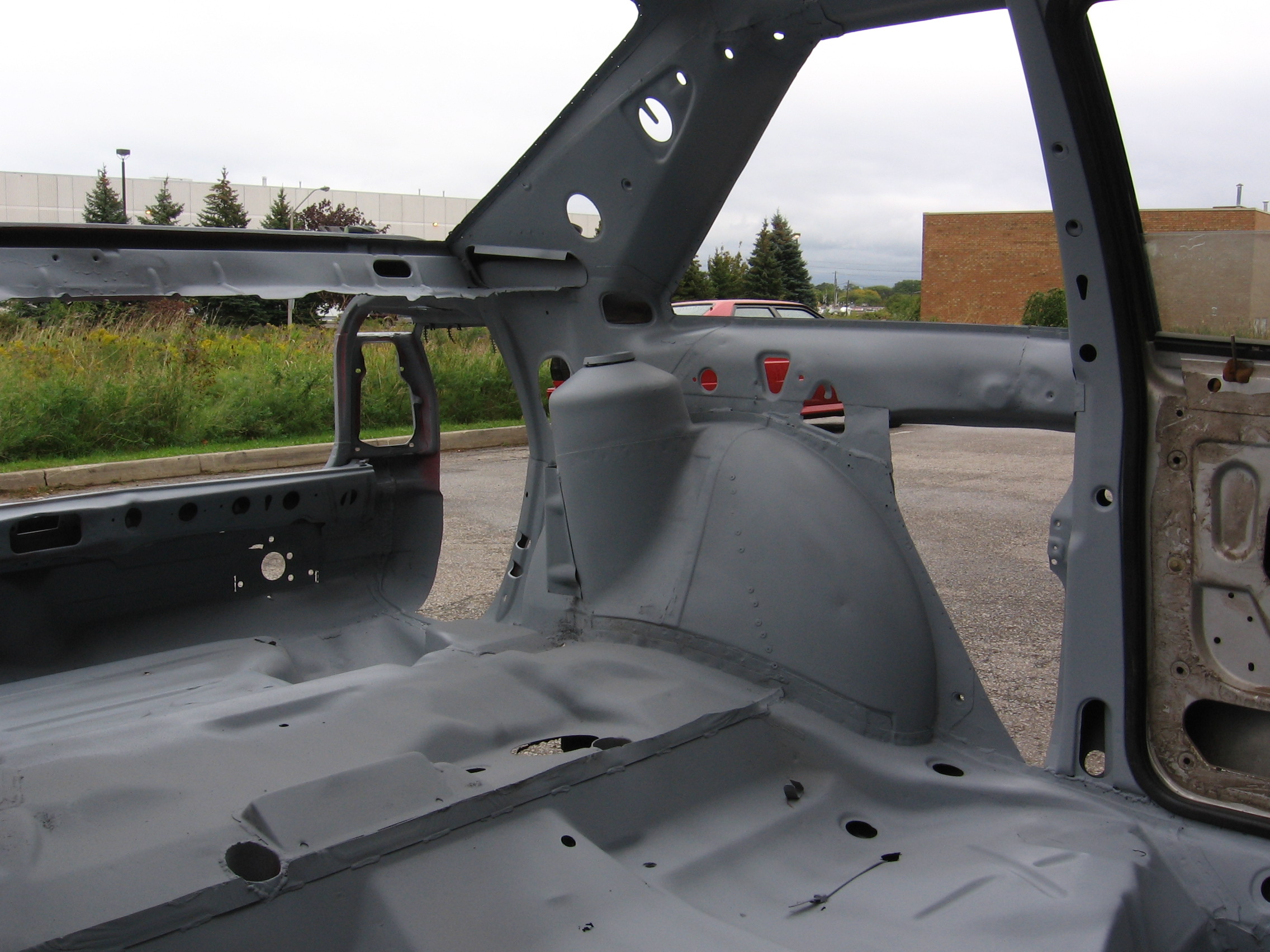

highlander69
- Posts: 279
Finally in primer
- car in primer 008.jpg (1.01 MiB) Viewed 35887 times
- car in primer 005.jpg (889.88 KiB) Viewed 35887 times
- car in primer 007.jpg (791.39 KiB) Viewed 35887 times
- car in primer 006.jpg (815.56 KiB) Viewed 35887 times

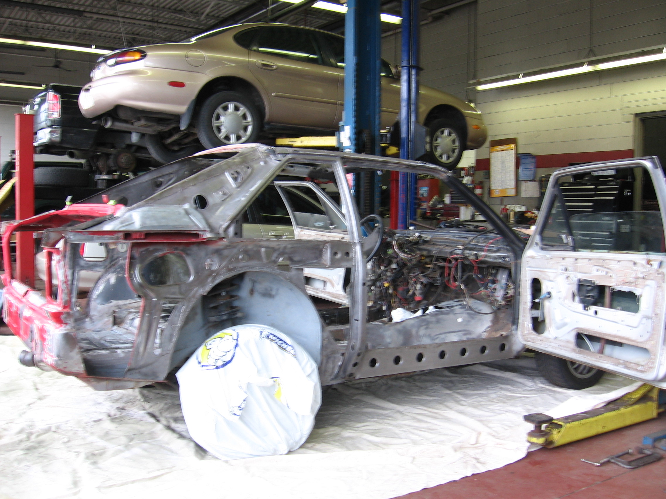

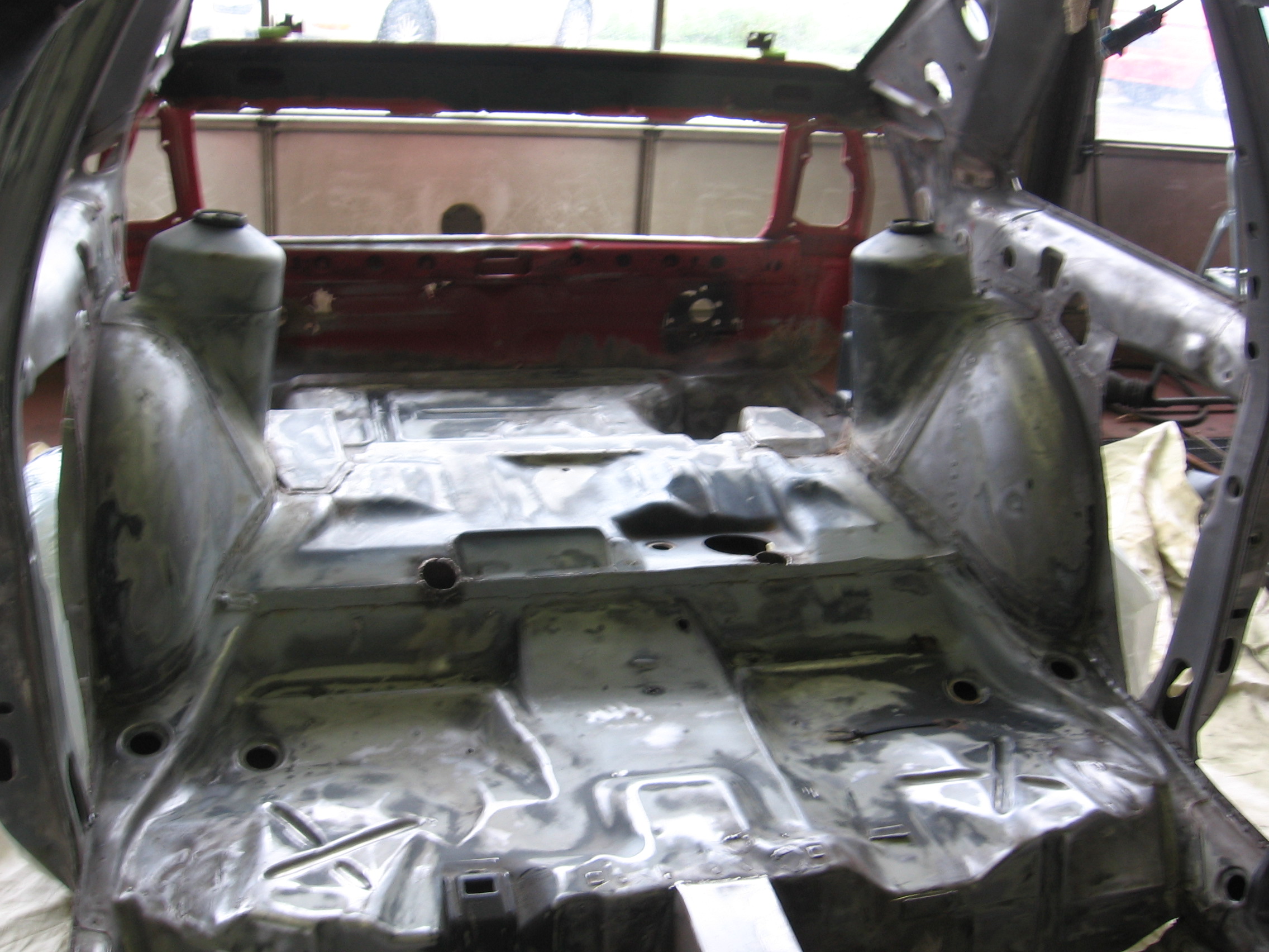

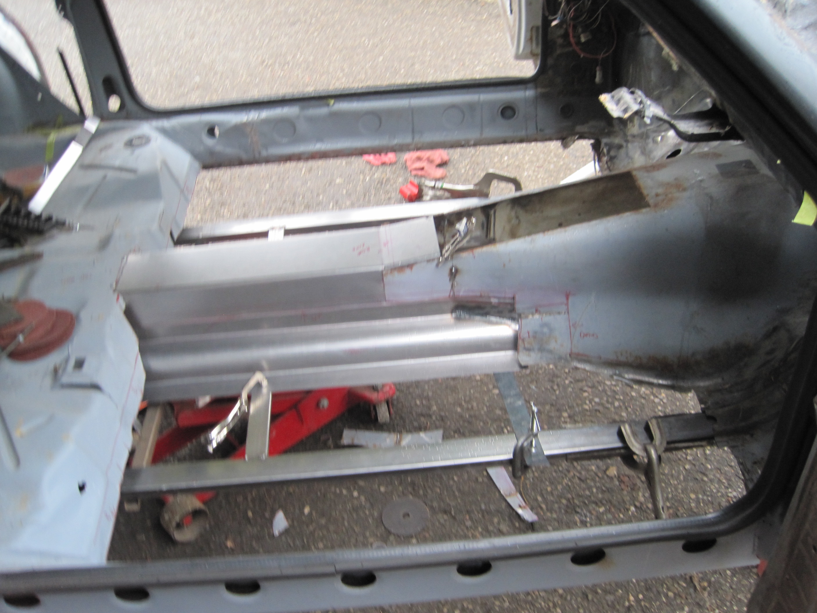

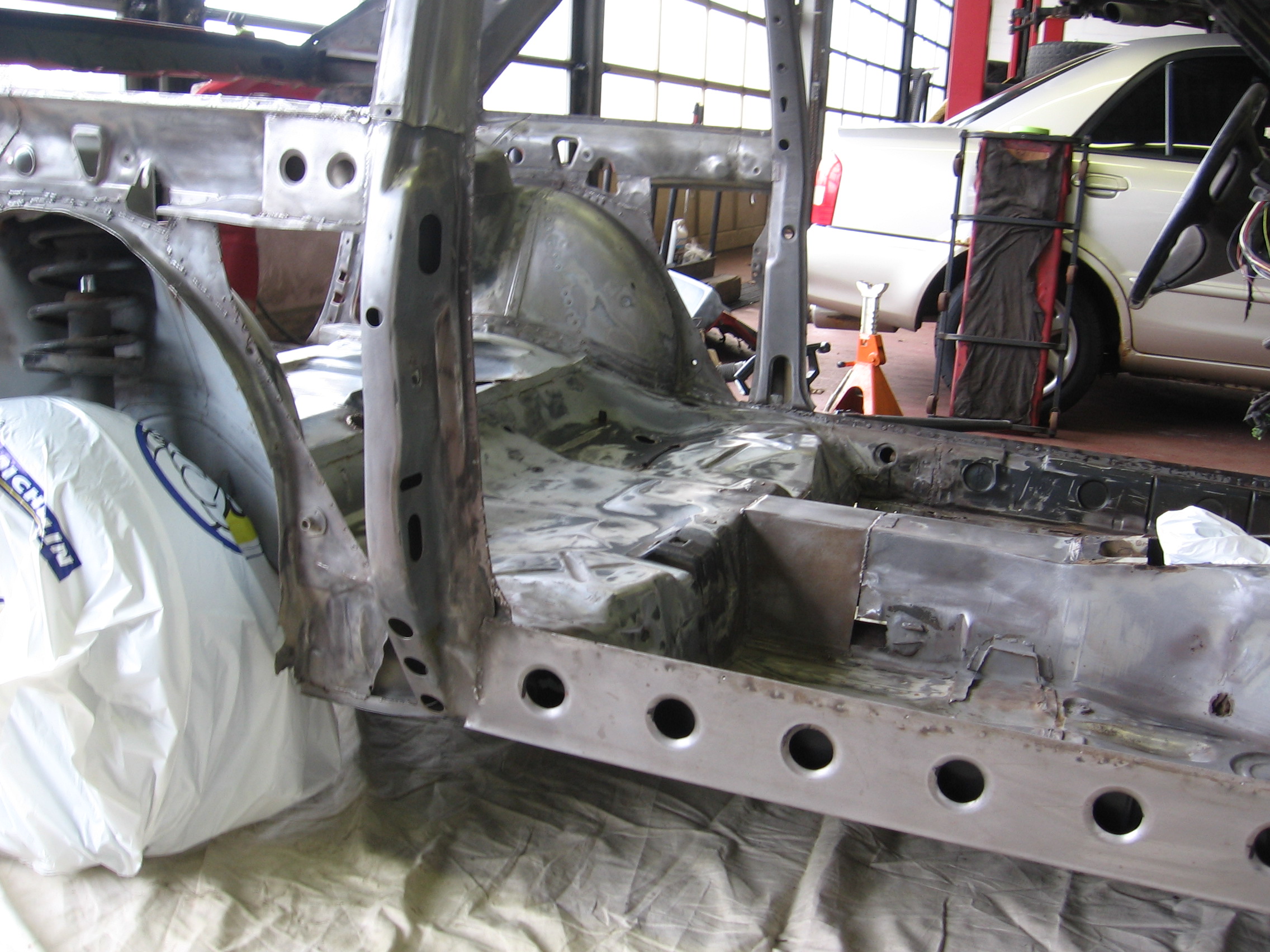

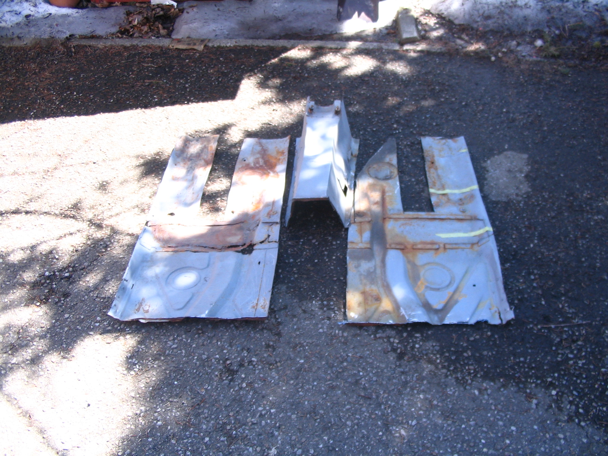

After drooling over Mike's floor on his sport quattro build, I though bollocks to this.
I spent the day cutting the floors out completely. I'm going to re- do the whole floor. It's going to
be better, and way stronger than the original sport quattro.
I'm also going to add box tubing like the factory rally cars, and my urq project.
Anyhoo a few pics of the day's events.
Cheers,
Craig
Cheers,
Craig

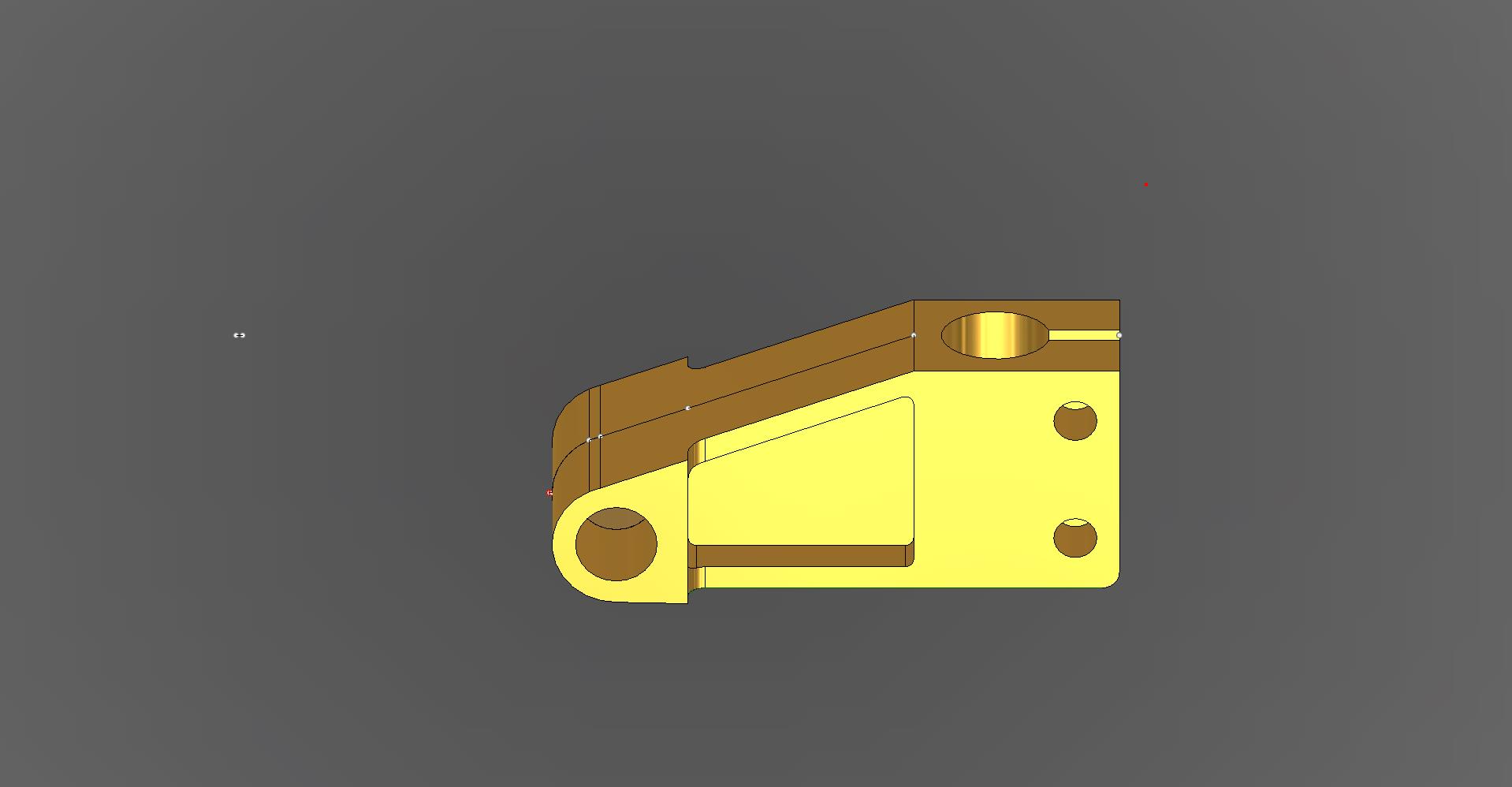

I started drawing up the gearshift assembly. The plan is to get it 3d printed to verify fit etc.
I've attatched a pic of the first part I drew for the shift linkage.
Cheers,
Craig

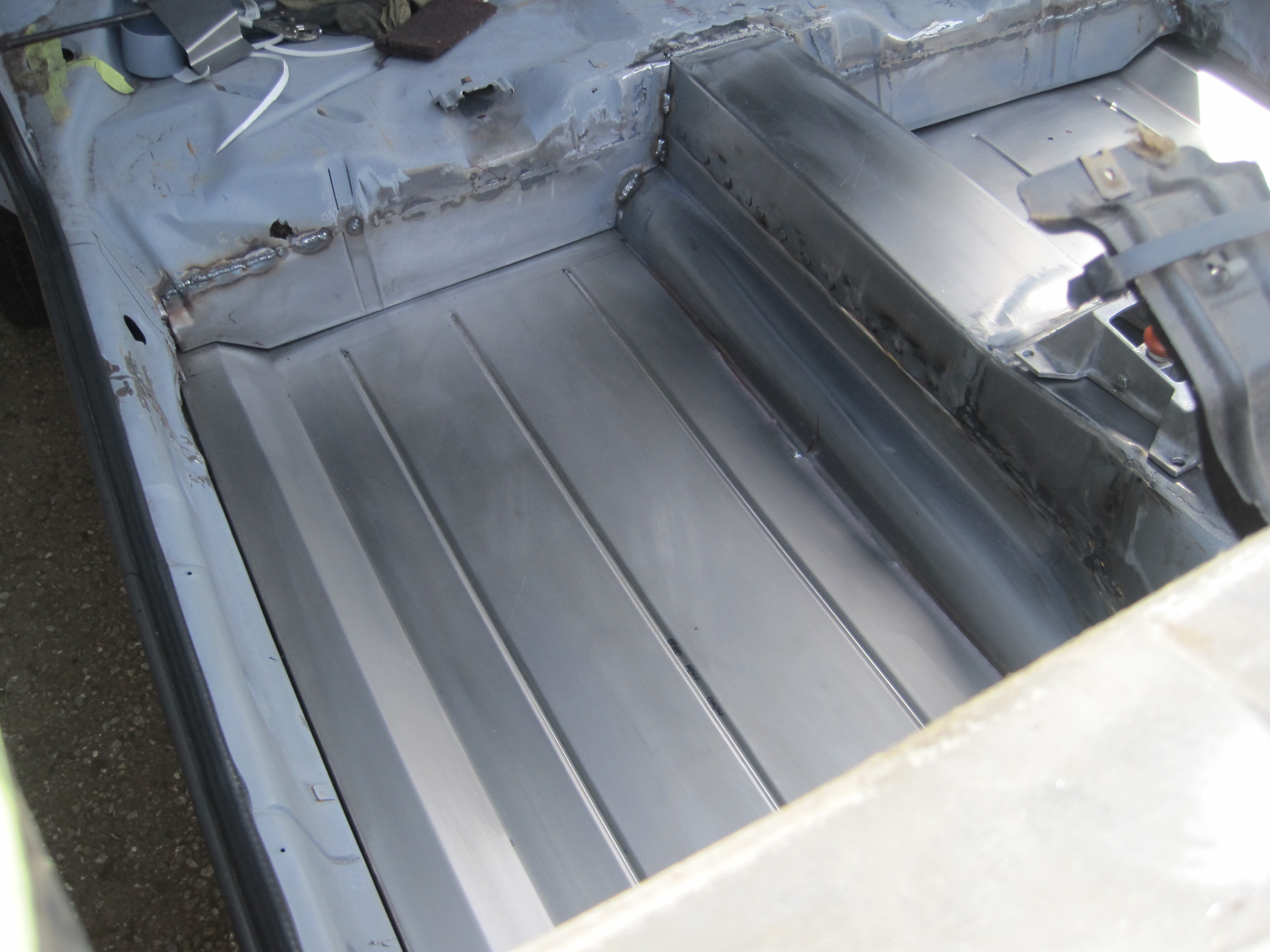

highlander69
- Posts: 279

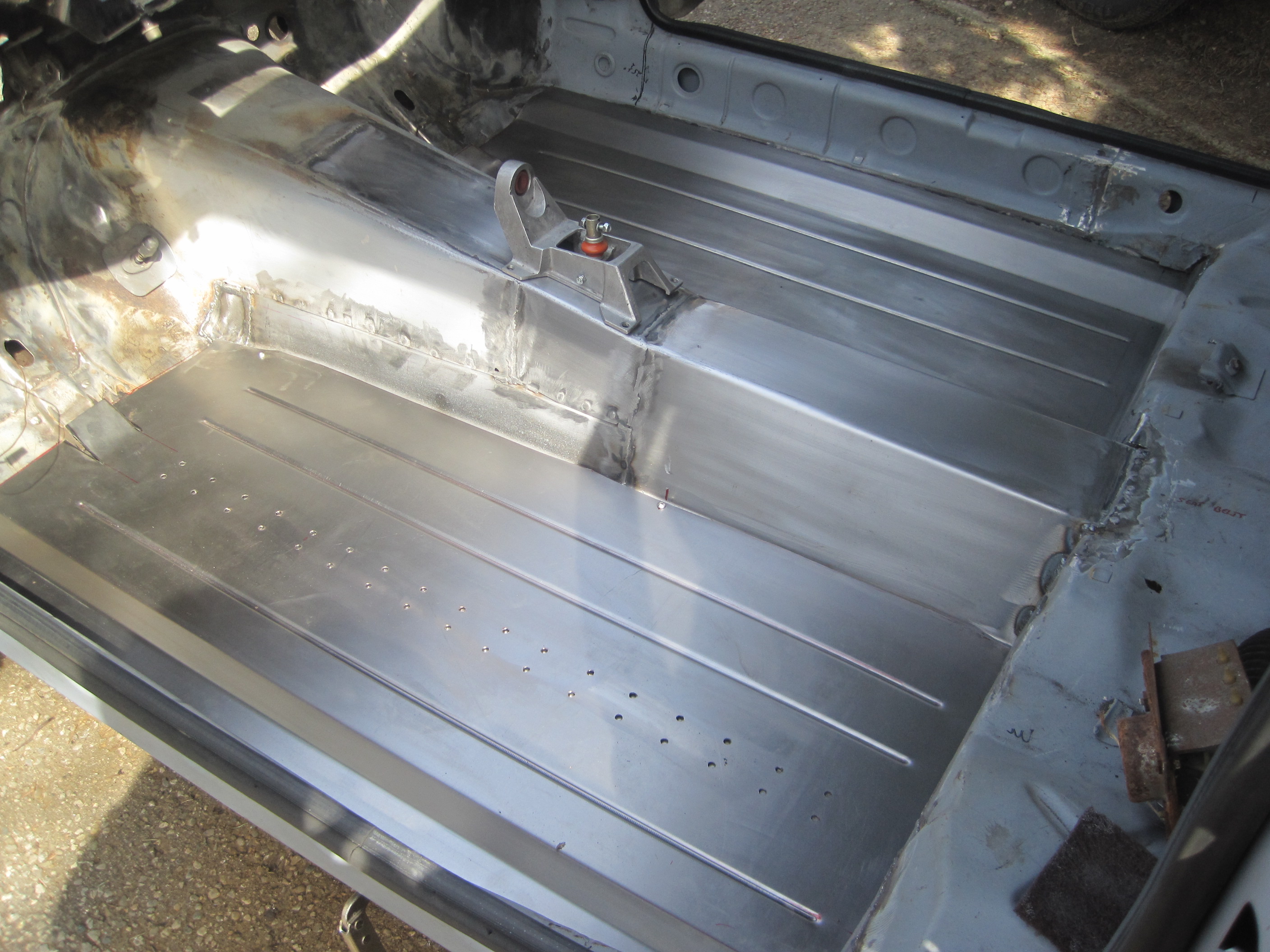

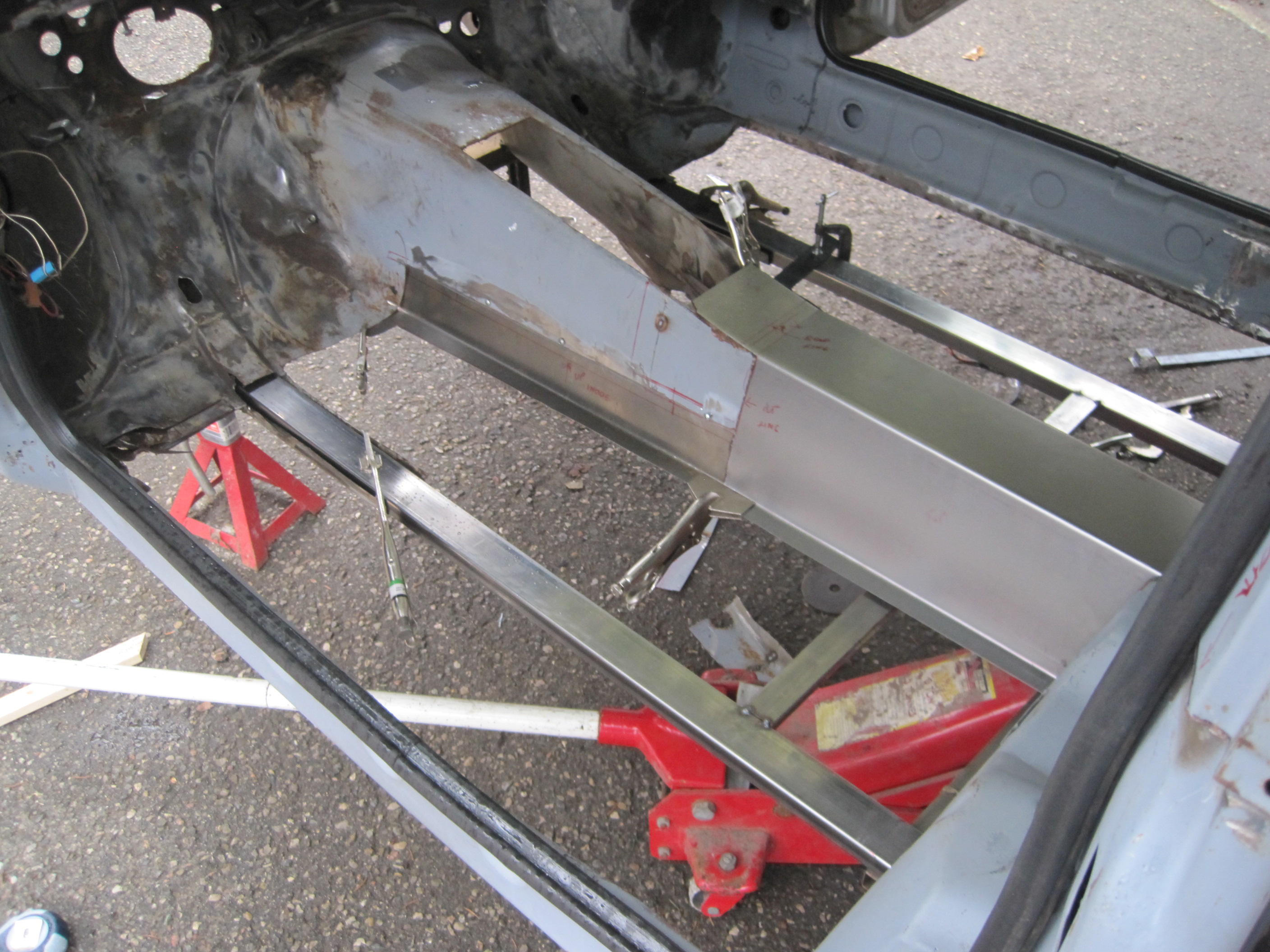

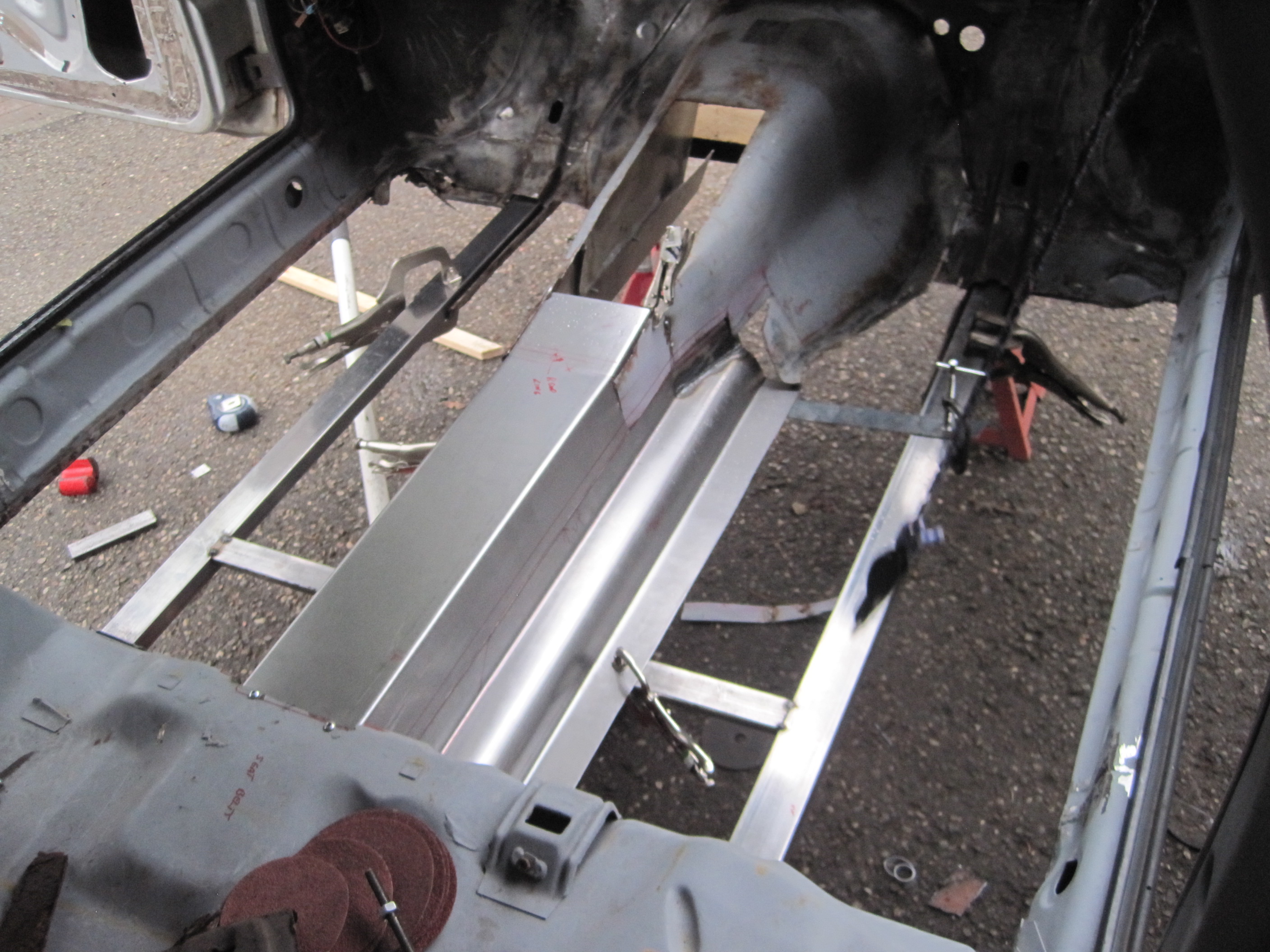

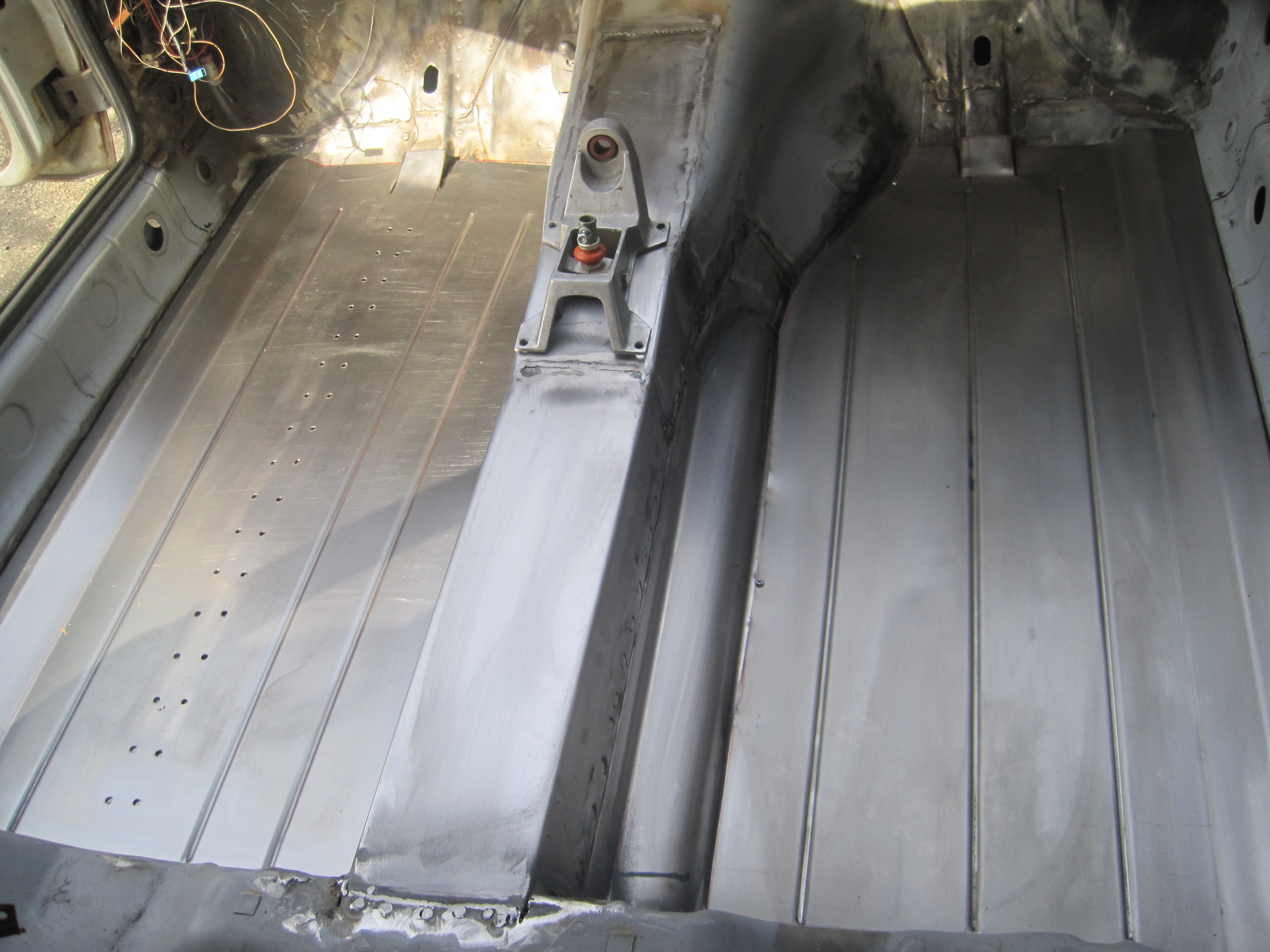

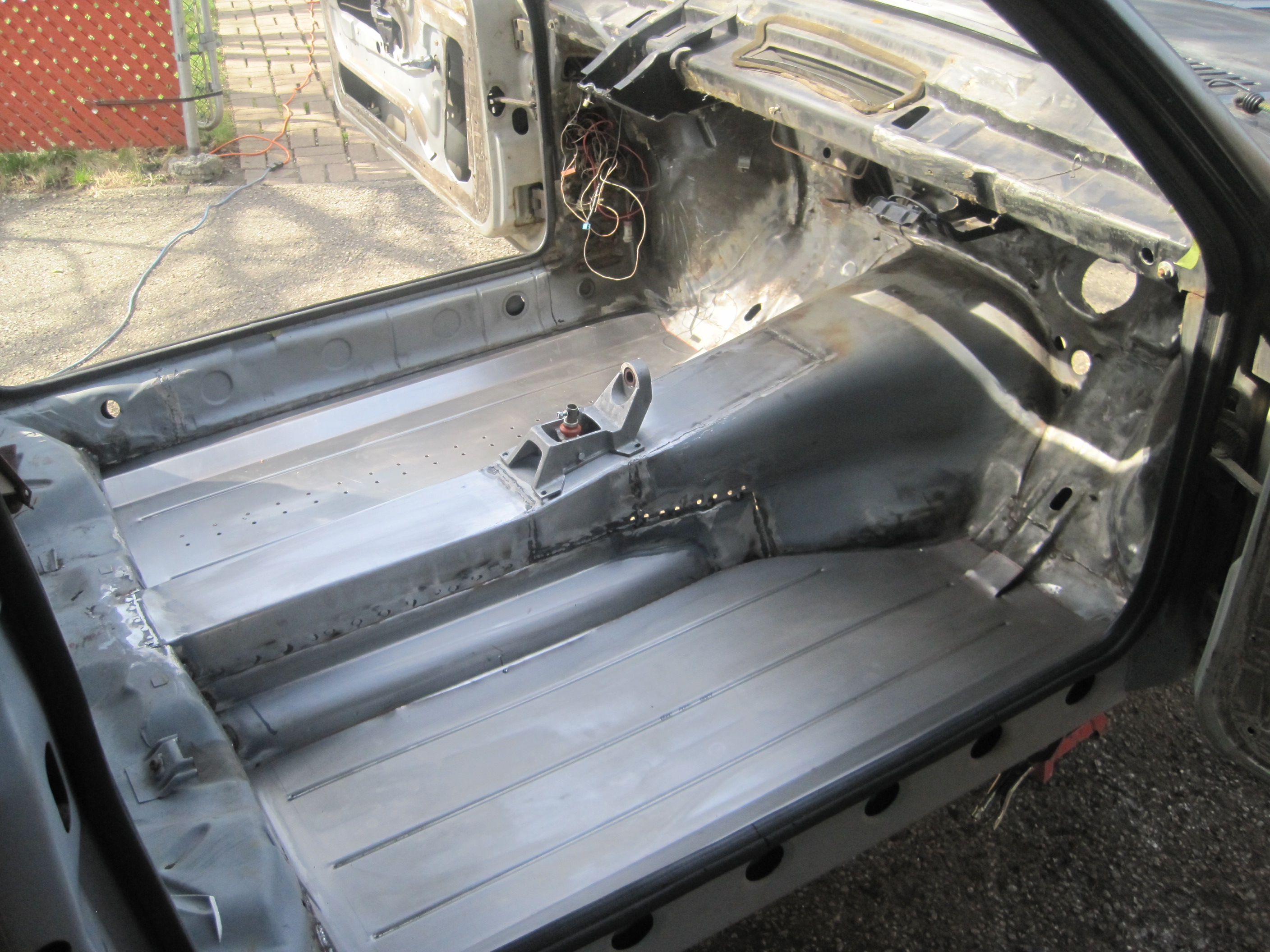

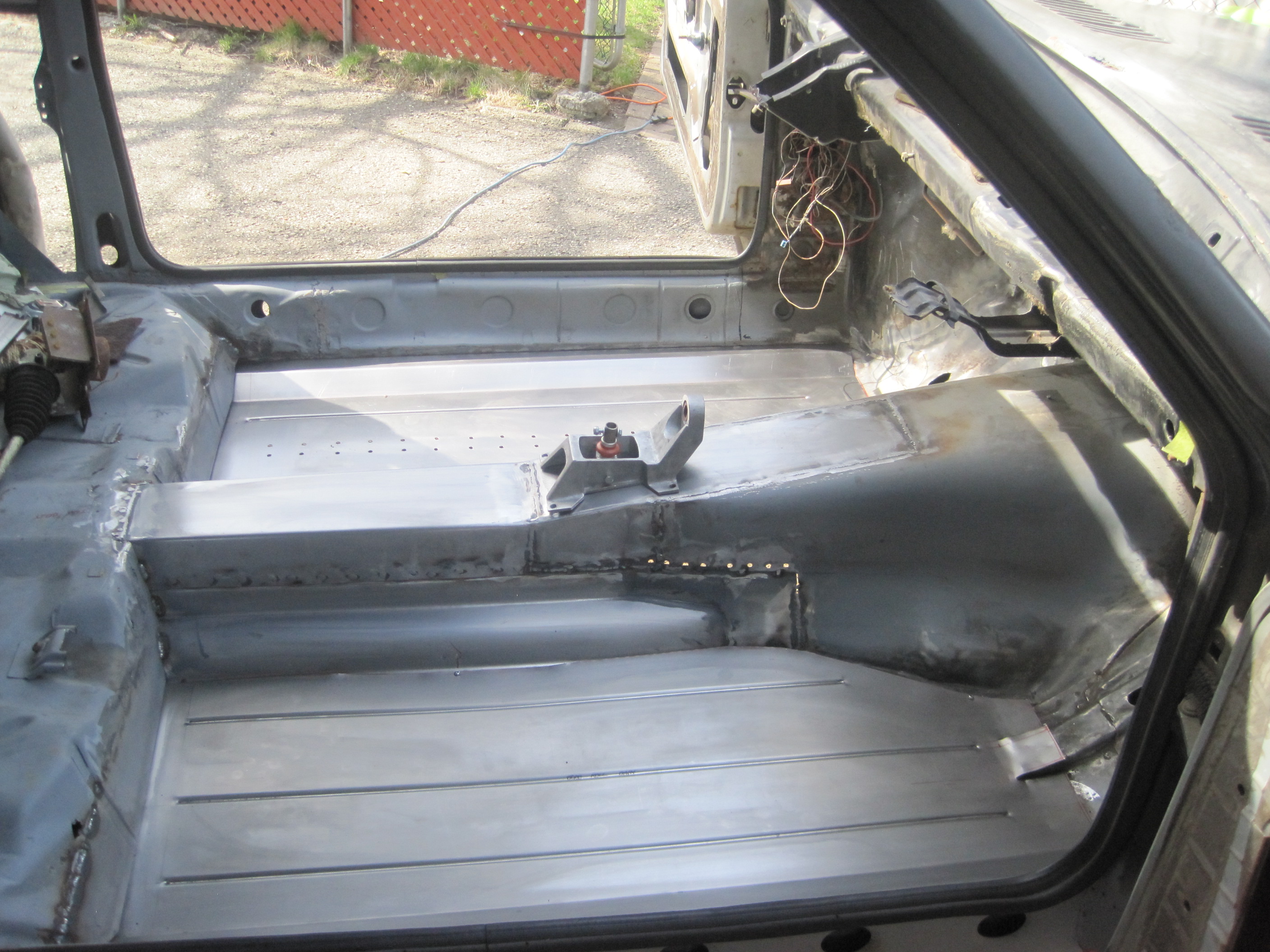

It may not look like it but I have easily over 10 hours in the floor so far.
I'm really glad I cut the floors out completely. It gives me so much freedom to build the floor the way I
want to.
I decided to use 2x1" tubing as opposed to the 2.2" tubing that I used on my urq floor. This dimension just seems
a little easier to work with seeing as I'm going to have a completely flat floor.
I also added a hump for the exhaust.
Here a a few pics of the unfinished floor. Not done yet but you get the idea.
Cheers,
Craig
want to.
Cheers,
Craig
- IMG_0488.JPG (1.15 MiB) Viewed 35755 times
- IMG_0487.JPG (1.28 MiB) Viewed 35755 times
- IMG_0486.JPG (1.3 MiB) Viewed 35755 times
