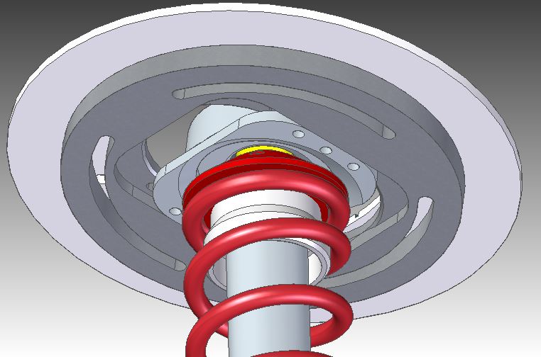

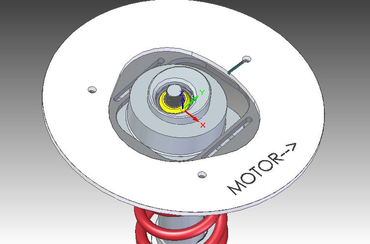

It's funny that your stud locations work becuase I had some of this stuff made (the lower plate in particular) before with different dimensions than yours for the studs and it fit well lol.
That's not a huge concern right now though. I can change that at any point, although it will affect stress analysis of that plate. Anyway, I will try to get more measurements when I see the car again this Thursday.
It's looking more feasible now. Just trying to compare adjustability to what's currently available.
Looks like from the centered position, I am able to achieve 1.96 degrees toward the more positive camber direction and 1.65 degrees toward the negative direction so far. I just came up with a new spin on the design though which will help us keep all of the adjustability and as much travel as possible.

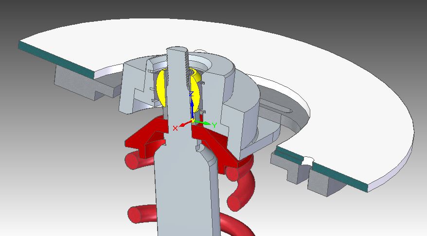

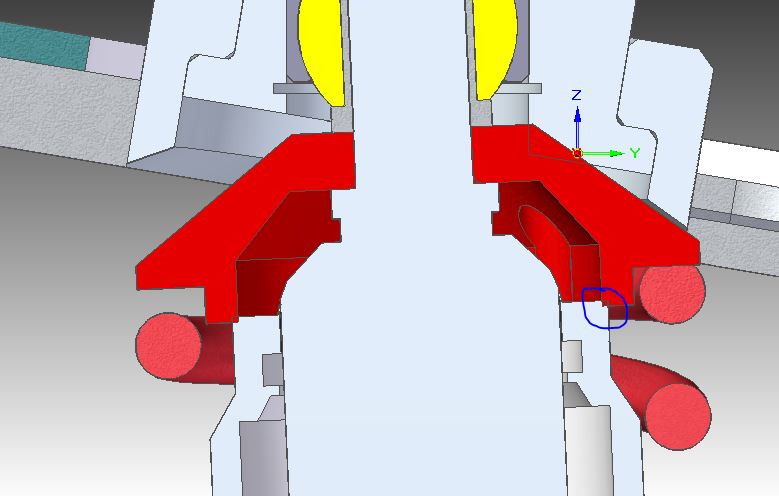

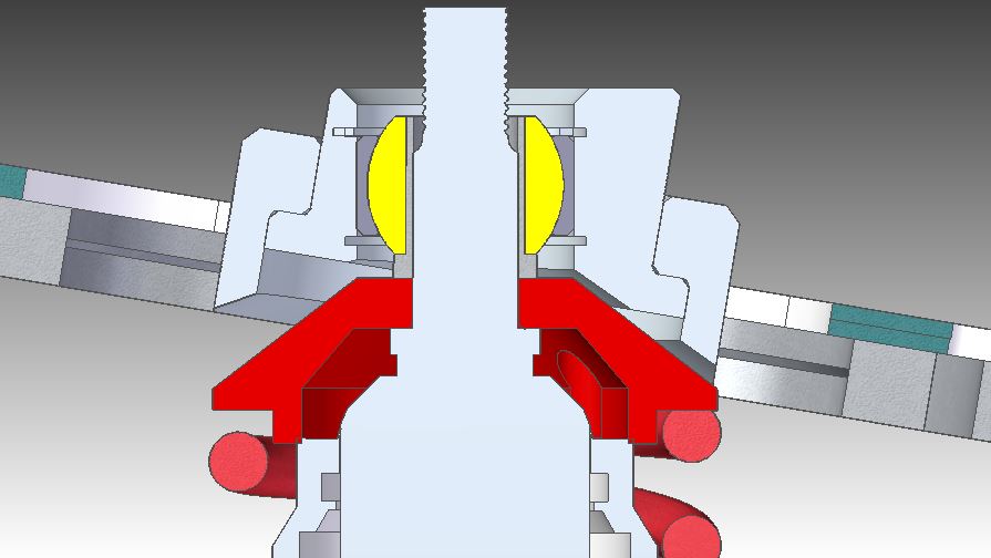

How's this?
The blue parts are just 1018 while the orange is 6061. Note that the strut drawn is a 5000 strut, not a 20vt, but the steps and diameters are the same between them. Well, except for the main shaft.
uberaudi wrote:Yeah I should of done that to begin with!
How's this?
Much better, I can tell what's going on now for the most part :)
Is that not still just loading the spherical bearing though? I don't see how you are taking any of the load off of it.

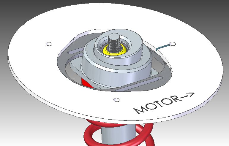

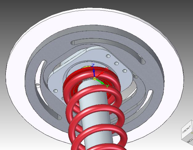

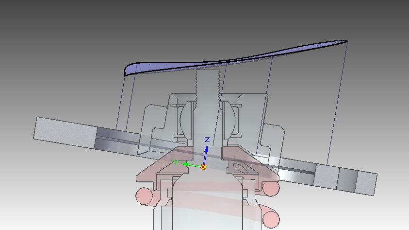

Things are looking more and more feasible by the minute. So far, this one sacrifices nothing. It should even be relatively cost effective to have made compared to some other ideas I had. Still lots to sort out and perfect, but it's much closer than ever before.
Strut Mount Progress 7.JPG (47.84 KiB) Viewed 86318 times
Strut Mount Progress 6.JPG (53.93 KiB) Viewed 86318 times
Strut Mount Progress 5.JPG (46.92 KiB) Viewed 86318 times

Cool idea on the eccentric castor adjustment, haven't seen that before. How do you lock it down?
When I was talking about taking load off the spherical bearing I was thinking more radially, not axially. Plus having a sealed bearing is important when your car is exposed to different weather extremes, and I could see longevity becoming an issue otherwise. It also provides bind free adjustments.
It's looking really good though Chris, glad you took this project under your wing!
uberaudi wrote:Cool idea on the eccentric castor adjustment, haven't seen that before. How do you lock it down?
You lock it down the same way you do for camber. Just torque the bolts.
Even if you are talking about radial load on the spherical bearing, I don't see how your design is preventing that. Either way, spherical bearings are much stronger in radial loading than they are in axial. This size bearing can typically handle 6-7,000 lbs axially, but 35-45,000 lbs radially! That's for a quality, Made-in-USA bearing though ;)
Weather-proofing is something I will have to look into. For now, know that the design is made to allow for easy hot-swapping of bearings if needed :)

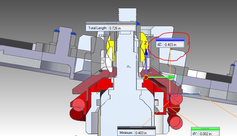

EDIGREG wrote:FYI, you can retain about 1/4" more travel by letting the spring hat rest on the tapered edge on the top of the Bilstein shaft. I turned a bit of material off the hat on the lathe
Ed, are those Bicknell hats? They look even lower profile. I think the gland nut is actually going to limit whether what you did there is worth a damn or not. Maybe not though depending on where the strut bottoms out internally and if the Bicknell spring retainer ID is bored out or not.
Pic for reference:
Strut Mount Progress 8.JPG (45.49 KiB) Viewed 86286 times

Here are the hats... they are very low profile. If I remember correctly, the ID is not correct for Bilstein, but once modified slightly on the lathe they fit perfectly. https://technotoytuning.com/universal/p ... 2mm-center
I don't think it's possible to have the hat interfere with the gland nut. I'm pretty certain the Bilstein will hit its internal bump stop before that can happen, plus I think the spring would be fully compressed before that happened as well. We're not exactly running long springs here
Something like this would be ideal for the needle bearing to keep it away from the elements. They don't list the dimensions of these on the site though so I have no idea how well they'd fit. Looks like you'd have to run a spacer between the needle bearing and spherical bearing to space them out a bit. https://technotoytuning.com/toyota/mx32 ... hat-system
Thanks for the info Ed. If I remember correctly, the Bilstein either can't interfere with the Bicknell or it's very close to it. I would love to use a hat as low profile as that, but you really aren't gaining anything once the strut is able to bottom out. Running one as low profile as that isn't possible with my design unless I sacrifice some adjustability.
Also, I don't see any point in running a needle bearing when you already have that degree of freedom available in the spherical bearing. The strength of those hats is also a concern. They are certainly compromised compared to the Bicknells and especially the A1.

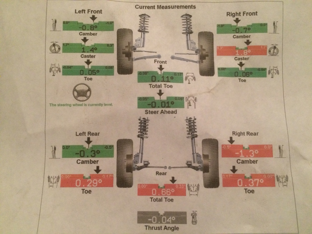

I just aligned mine, stock min/max specs are on there.
Thanks! That's the max allowable from the factory right?

That is just the factory spec range, so in theory test that is what the adjustment should be, but at this point it should just be treated as a target if the factory adjustment can get you there.

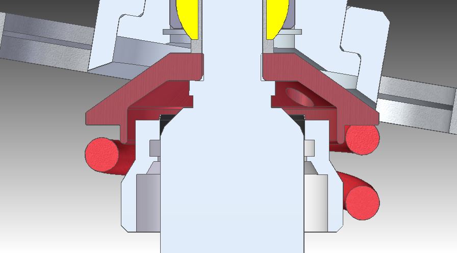

Progress has been made!
I took very good measurements of the strut tower bolt pattern (it was pretty close to the one you gave me in your CAD files Nick), the Bicknell hat (you got a little lazy on that one ;) ), and hood clearance (thanks Kevin!). From those measurements, I was able to come to a few conclusions.
1) The Bicknell hat has clearance for the Bilstein gland nut when the strut is all the way compressed. Woo! I thought that's what I remembered, but now I'm 100% sure of this.
