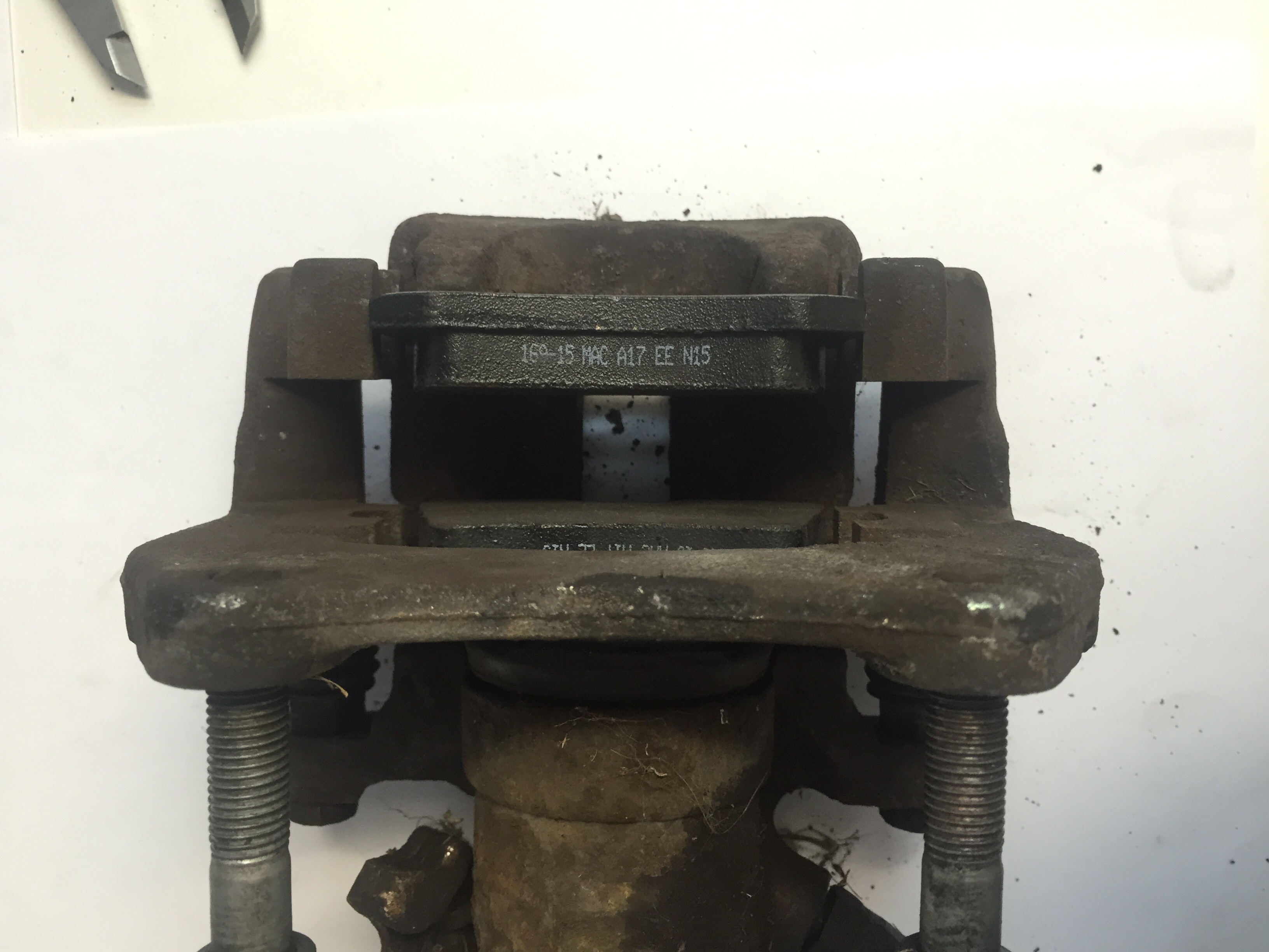

No, No, No, ...... Definitely still going to be using the 330 x 22mm rotor. That was the whole point... To mount the the largest possible size while still being able to run a 17" wheel, keep the parking brake function, have the parts be oem/easily accessible, and cheap, and not worry about piston bore volume size. Through this brake topic discussion, and sharing information, taking lots of measurements, looking up lots of part numbers, and buying several models of rotors and pads, I am 99.99% this is the best option and we don't have to turn the rotors down now. The last final thing that made this all work out right is using the B5 S4 pads. Surprisingly, they fit right into the older calipers from the C4 S4 / V8 / S6 / 200 20v. The key is that these pads are thinner and allow for the 22mm rotors. The B5 S4 pads are better design. The retaining clips hold the pads in better and the pads have a different shape. I bought the B5 and the C4 pads to compare and made sure the B5 pads worked in the older calipers.
So here it is...
2010-2011 S4 rotors 330x22mm $84/pair-local parts store
b5 S4 rear brake pads. $17/set-local parts store
Machined adapter $100/pair-shipped
Total.................................. $201.00. You can't beat it!
The machine shop is suggesting I have the parts dipped in a non toxic liquid As a corrosion inhibitor. They said it is what gun smiths use and would be cheaper than powder coating. trying to keep cost down...

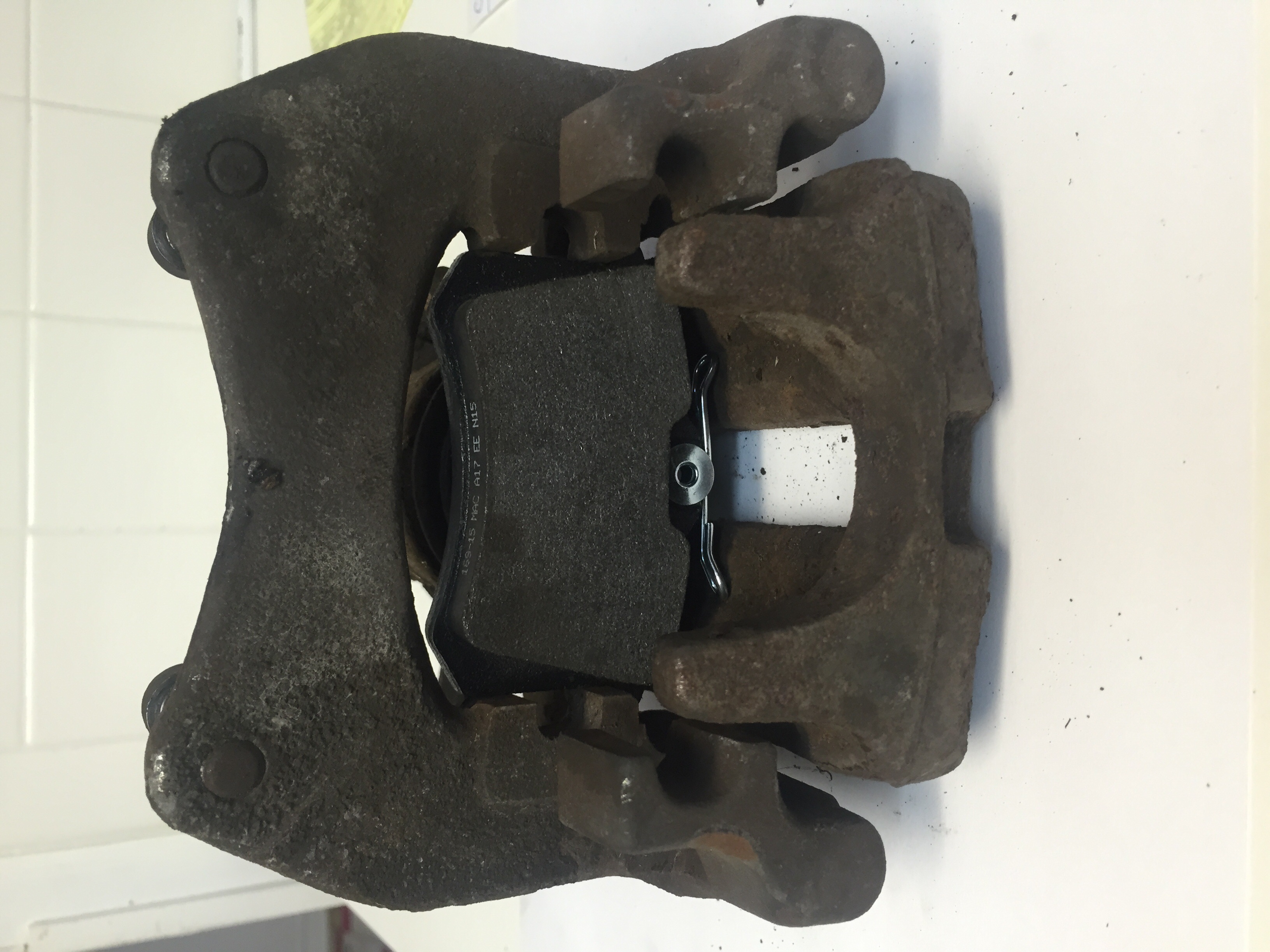

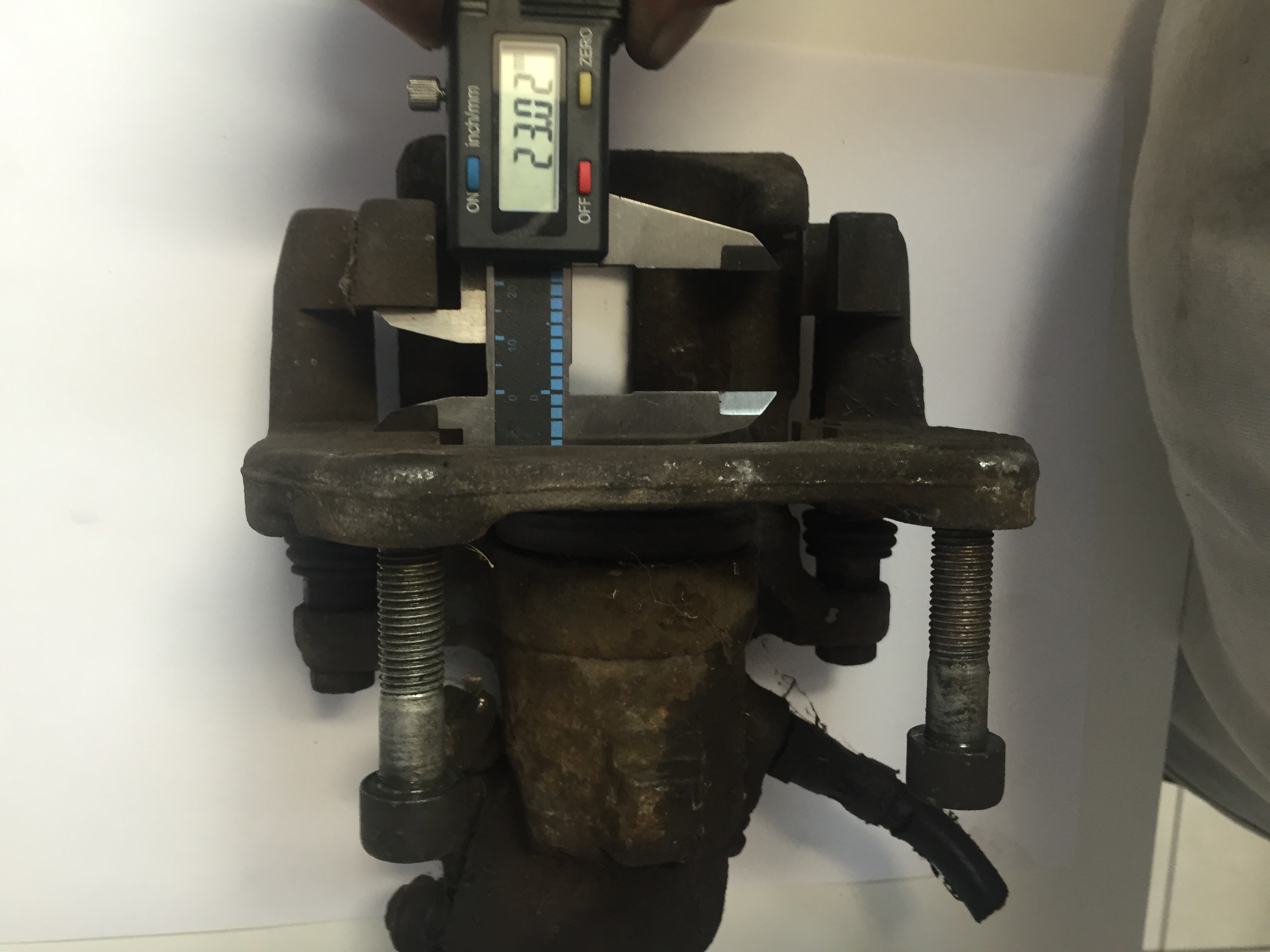

Here are some pics comparing B5 S4 pads vs. C4/C3, showing that they are thinner material, fit in our older calipers, and show that the throat of our older calipers is 23mm which is large enough to accept the 22mm wide rotor.

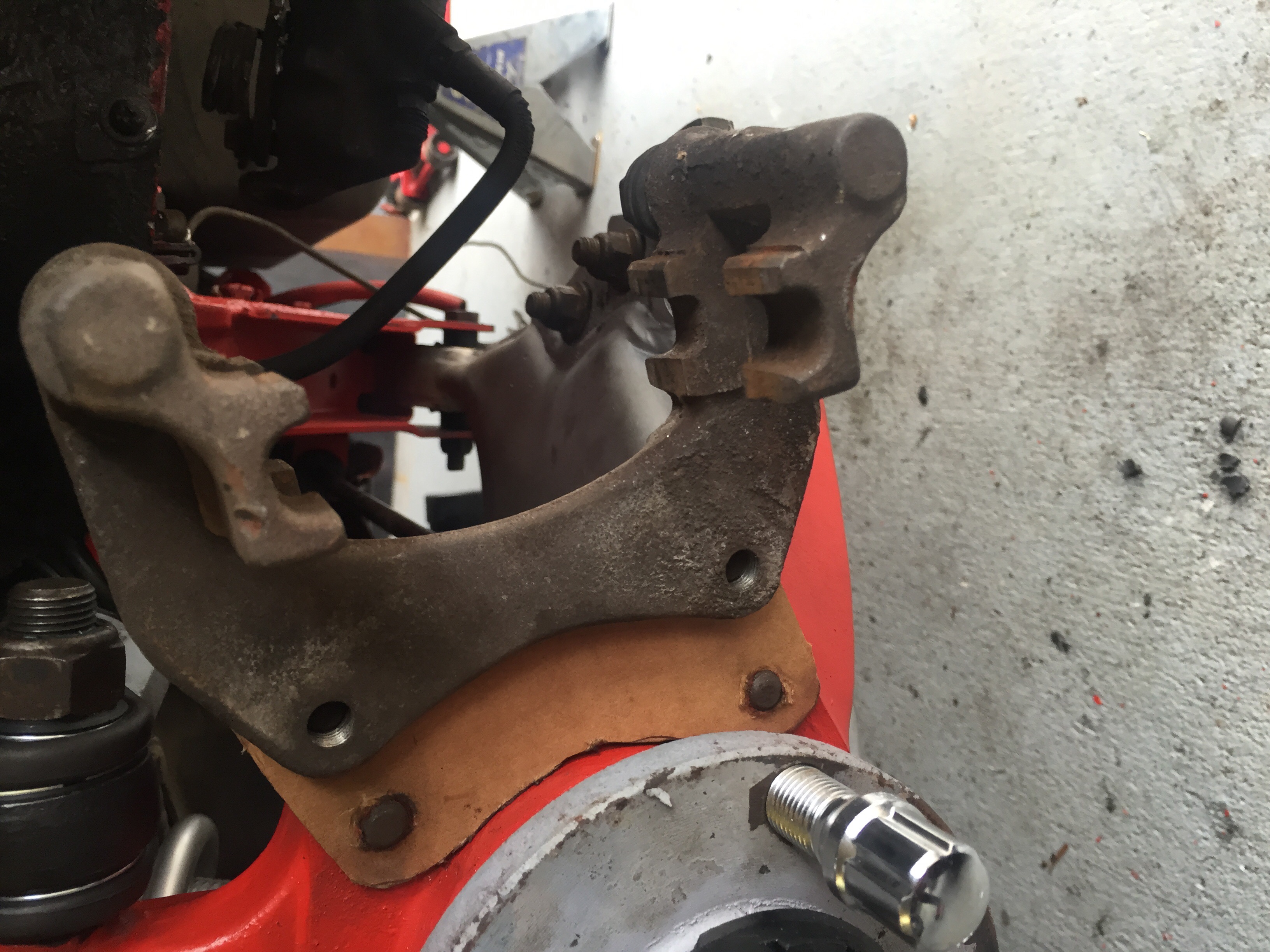

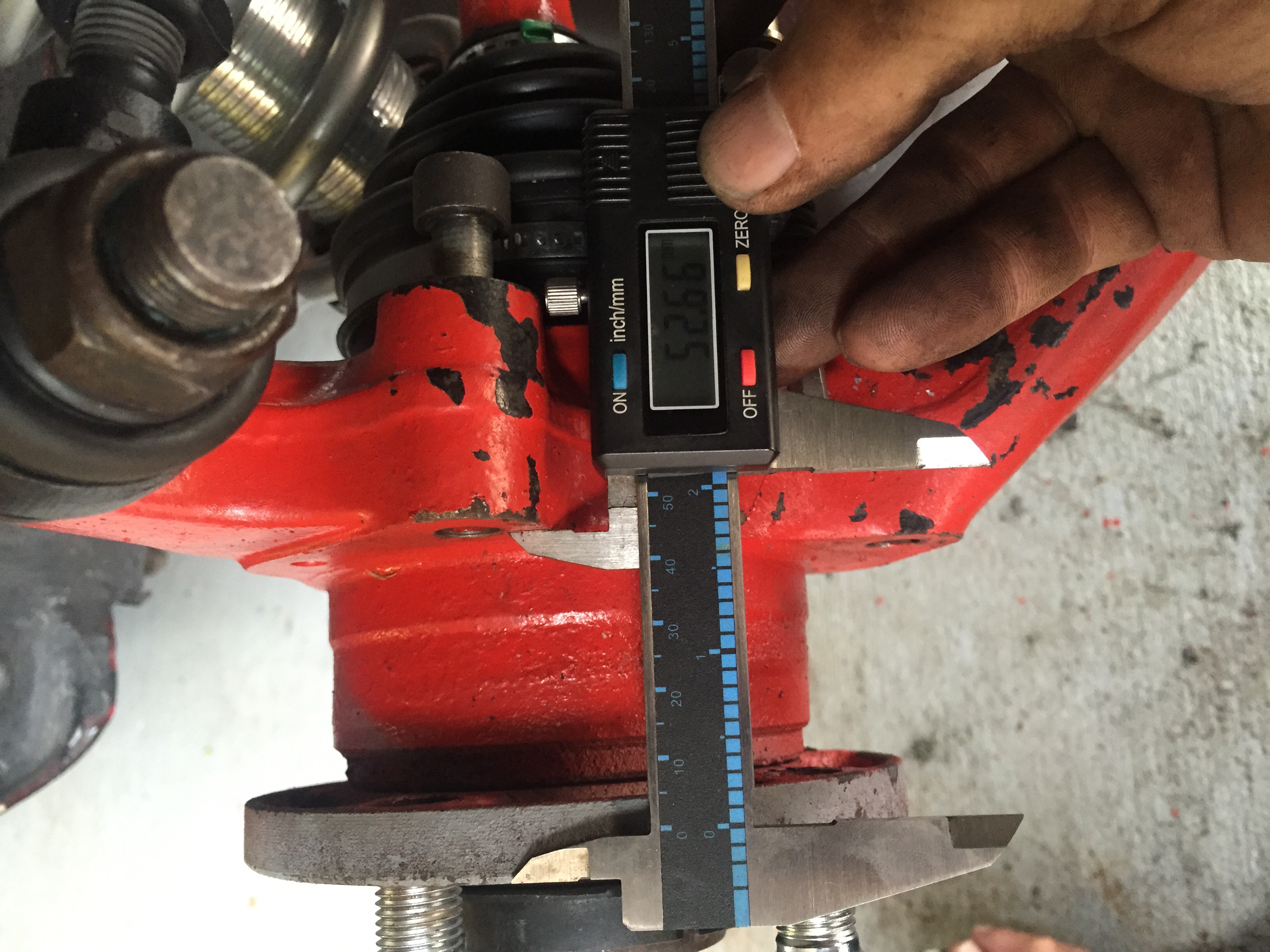

Ok, more measurements for documentation... I measured the distance from where the face of the wheel hub back to where the face of my carrier bracket bolts on to the knuckle and came up with roughly 52.5mm. This will be the base measurement of what the adapter plates are built from. That way if there are variance from year to year (which I don't think there are) then all I would have to do is get your measurement and mill down the difference or make the plate thicker.
Here is the super scientific cardboard template that I gave the machine shop. You can see how flat and simple it is. No extra spacers needed.

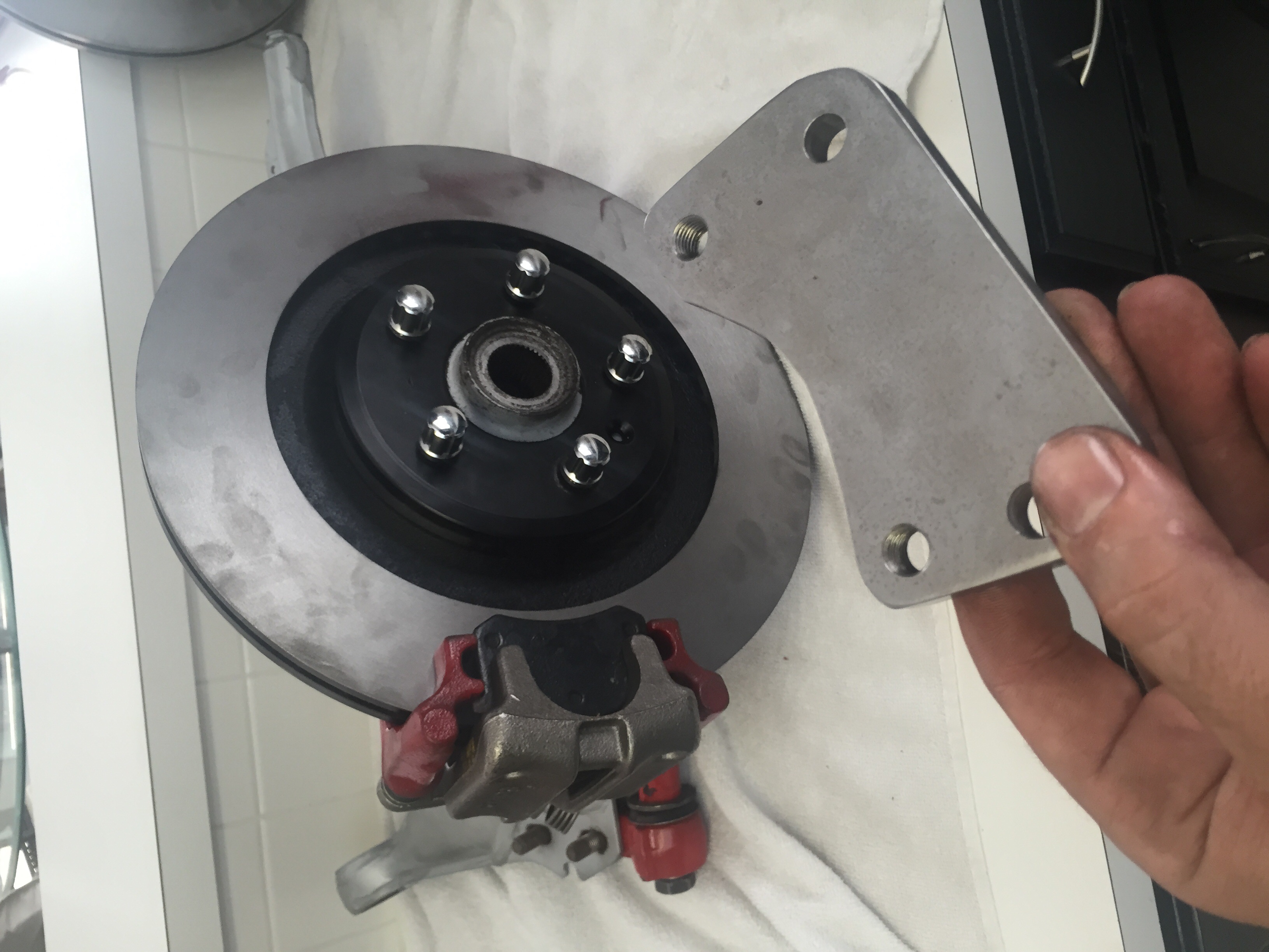

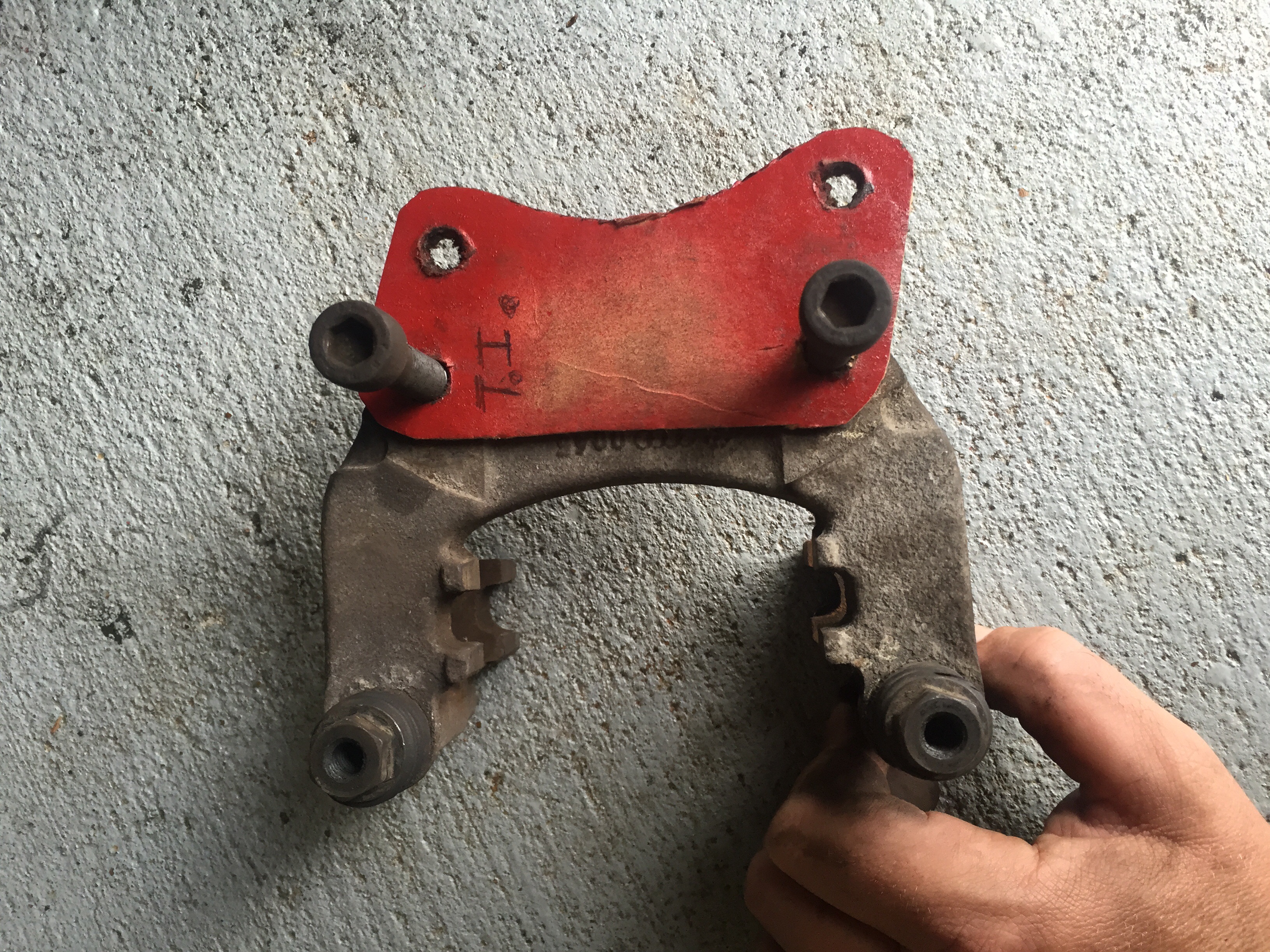

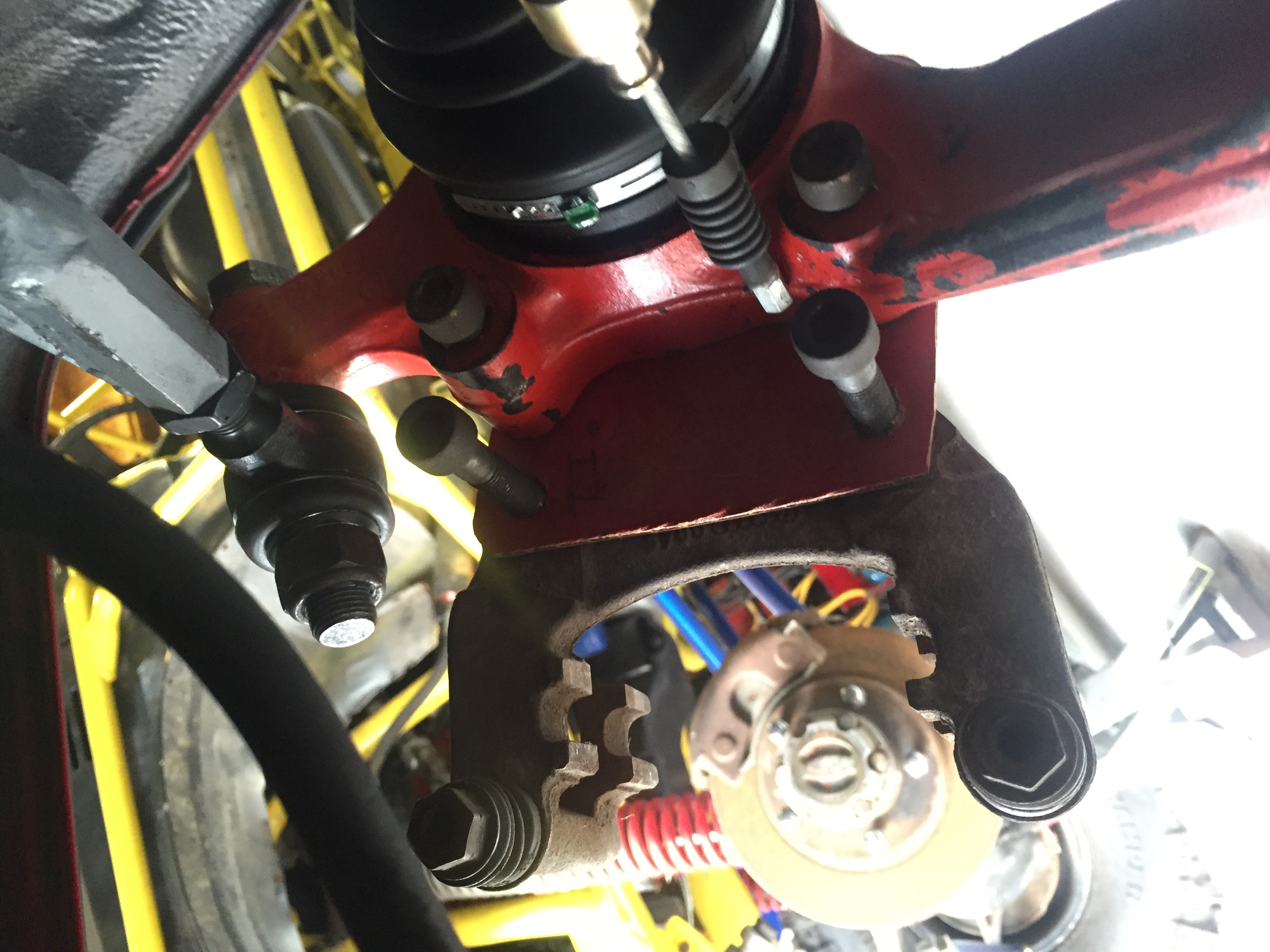

Here it is... Final product...
C3/C4 caliper, carrier, and pads
2010/11 S4 330mm x22mm (1mm turned off of each side and now 330x20) I didn't want to buy B5 carriers...
My adapters
2 bolts
[youtube]https://m.youtube.com/watch?feature=youtu.be&v=Sz4qYzA7ijE[/youtube]
