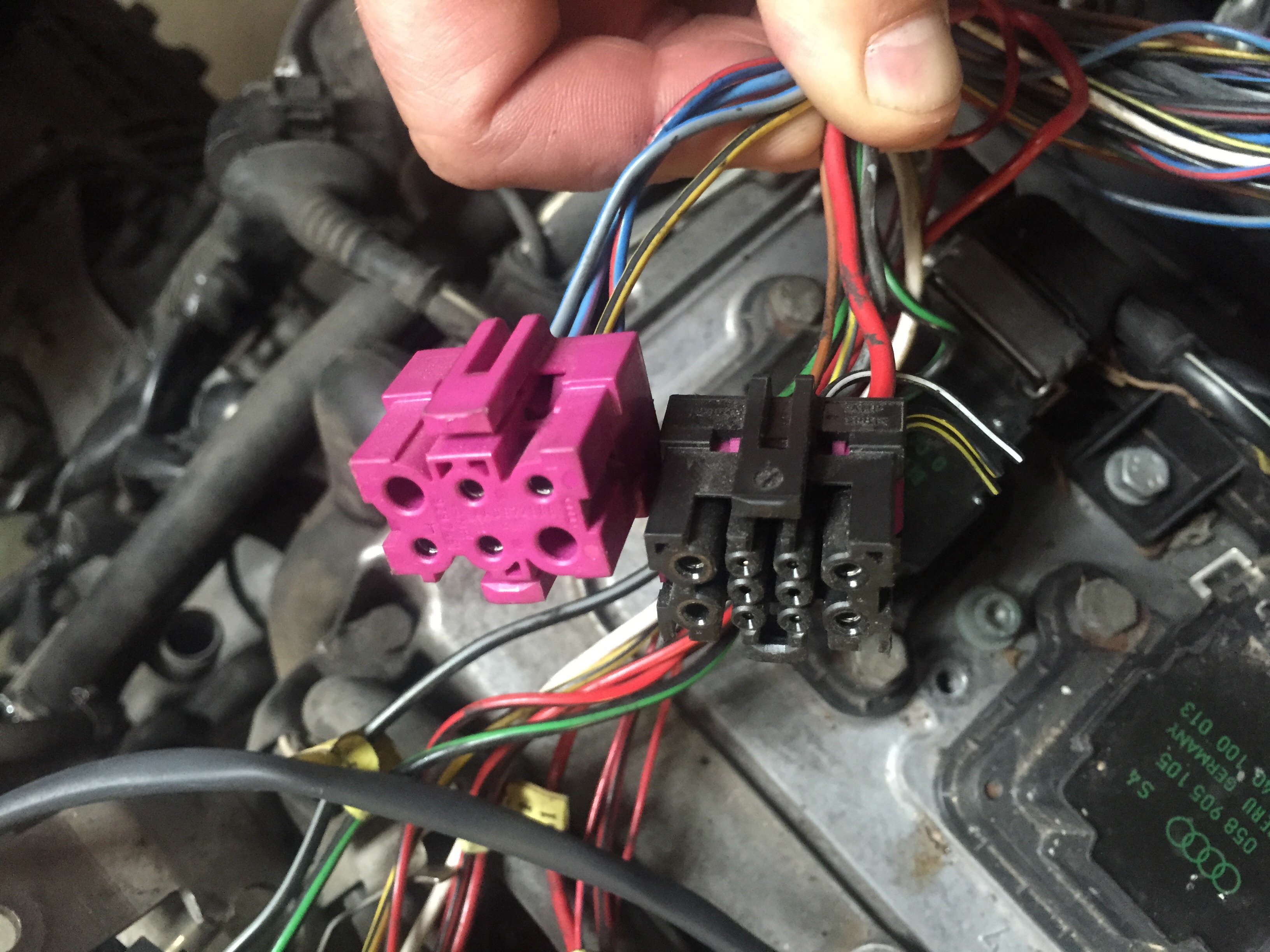

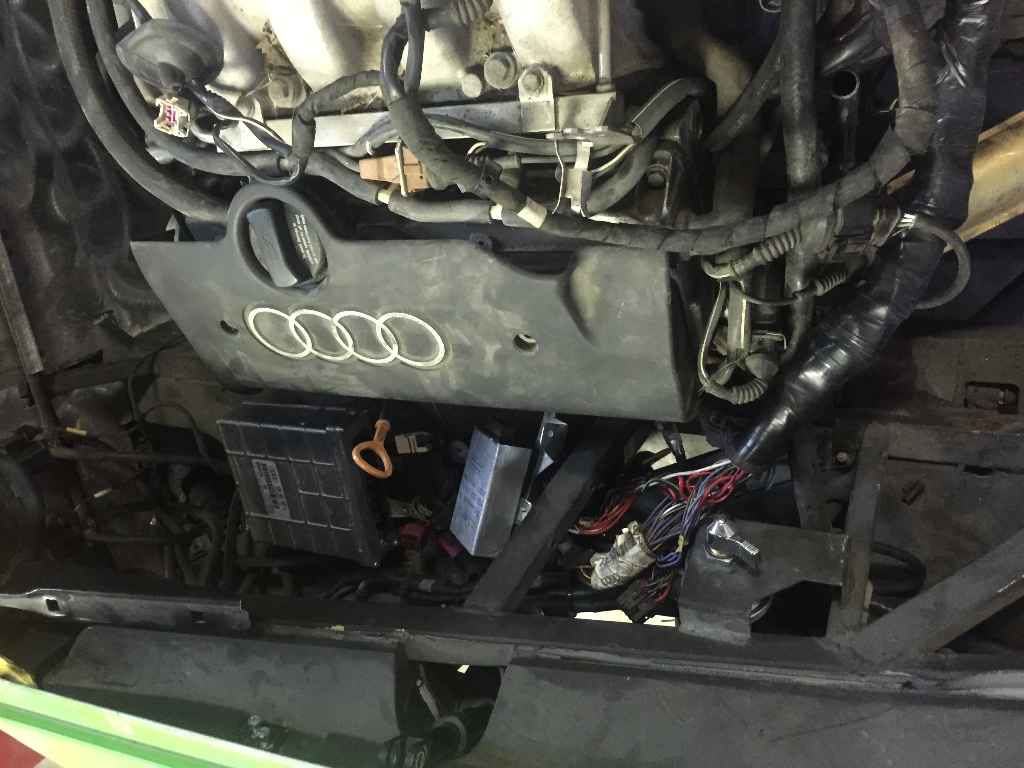

Made a little headway today just messing with the stock ECU and wiring. After doing a little looking my RPM sensor (not sure what to call it goes on the tranny) anyway didn't know my transmission had a place for it. I found the location plugged it in and it fired right up on some ether. Im going to continue working with the stock ECU for a little bit now that it is running and see what I can do. Plan is to use one of the Murci fuel pumps to run the motor, the Murci came with 2 one for each fuel rail both putting out about 50-60 psi (hope that is enough) flow rate shouldn't be a problem I wouldn't think. Need to start eliminating a bunch of wires find the fuel pump relay on the audi harness, and go from there. Here is a youtube video I posted. Im sure ill be getting a bunch of haters for me doing this but doesn't bother me.
https://youtu.be/lvbSh7-Nvfk

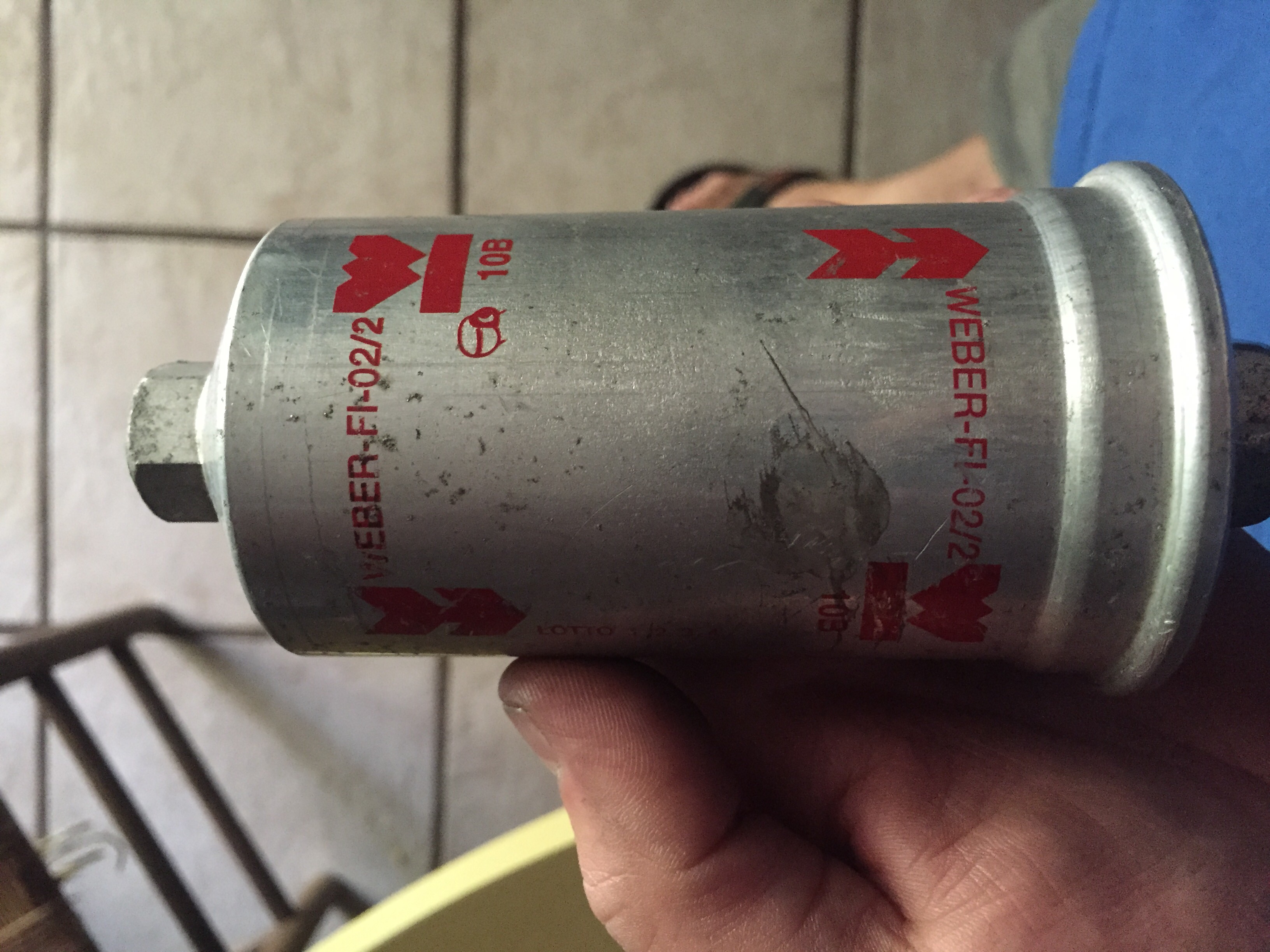

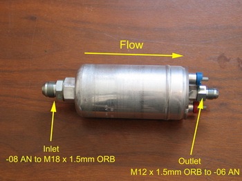

So continuing here, started messing with the Murci fuel system today, drained the tank (been sitting for a few years) and noticed whatever was coming out of the tank wasn't gas, it was water :boom: so needless to say jumped both fuel pumps and they are both bad. This weeks plan it to pull the tank, machine a cap for pump 2 unit (cap it off) and see if I can get a new Audi pump to fit in the Murci 1 pump's place in the tank. Then continue going forward!
Also thanks for all the followers, help and support!
2006 Murcielago 4.2
Re: Murcielago 4.2 Swap
Not sure if you know, but guys are having great success with some aftermarket pumps. Since you plan to go bigger in the future, might as well only buy the pump once, right?
Bosch 044, 040 and 005 are all very well regarded, depending on the application.
Walbro as well, but I'm not sure what models.
I tend to like the Deatschwerks DW300, which is super affordable, makes next to no noise and flows very similar to an 044 (better at some points on the pump curve).
Marc @ EFI-X sells all of the above, as I recall.

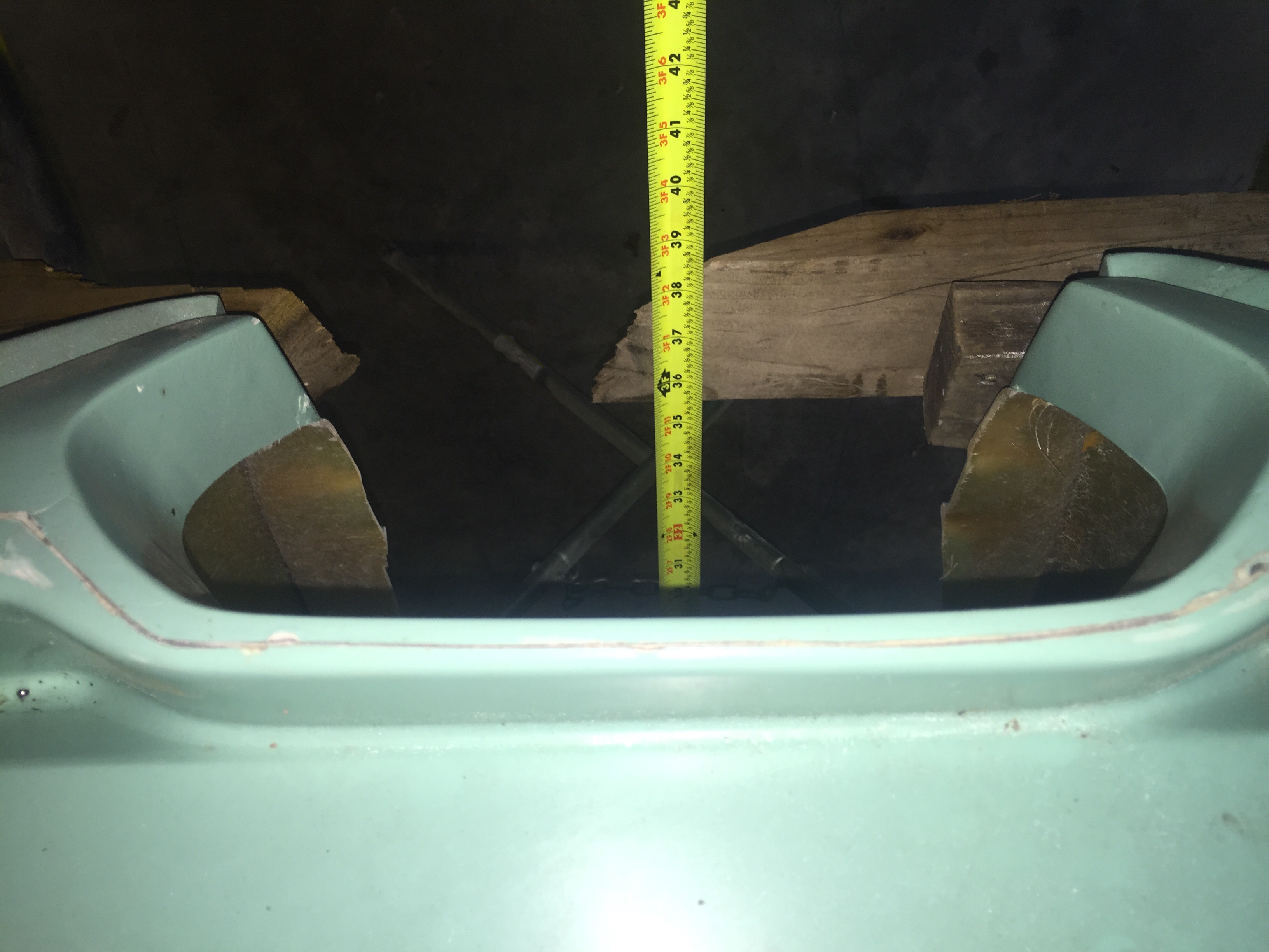

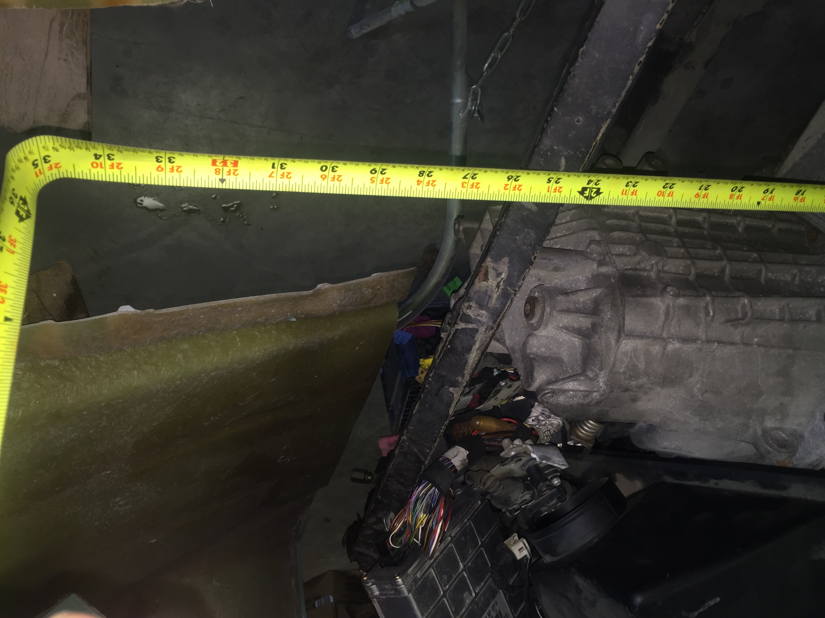

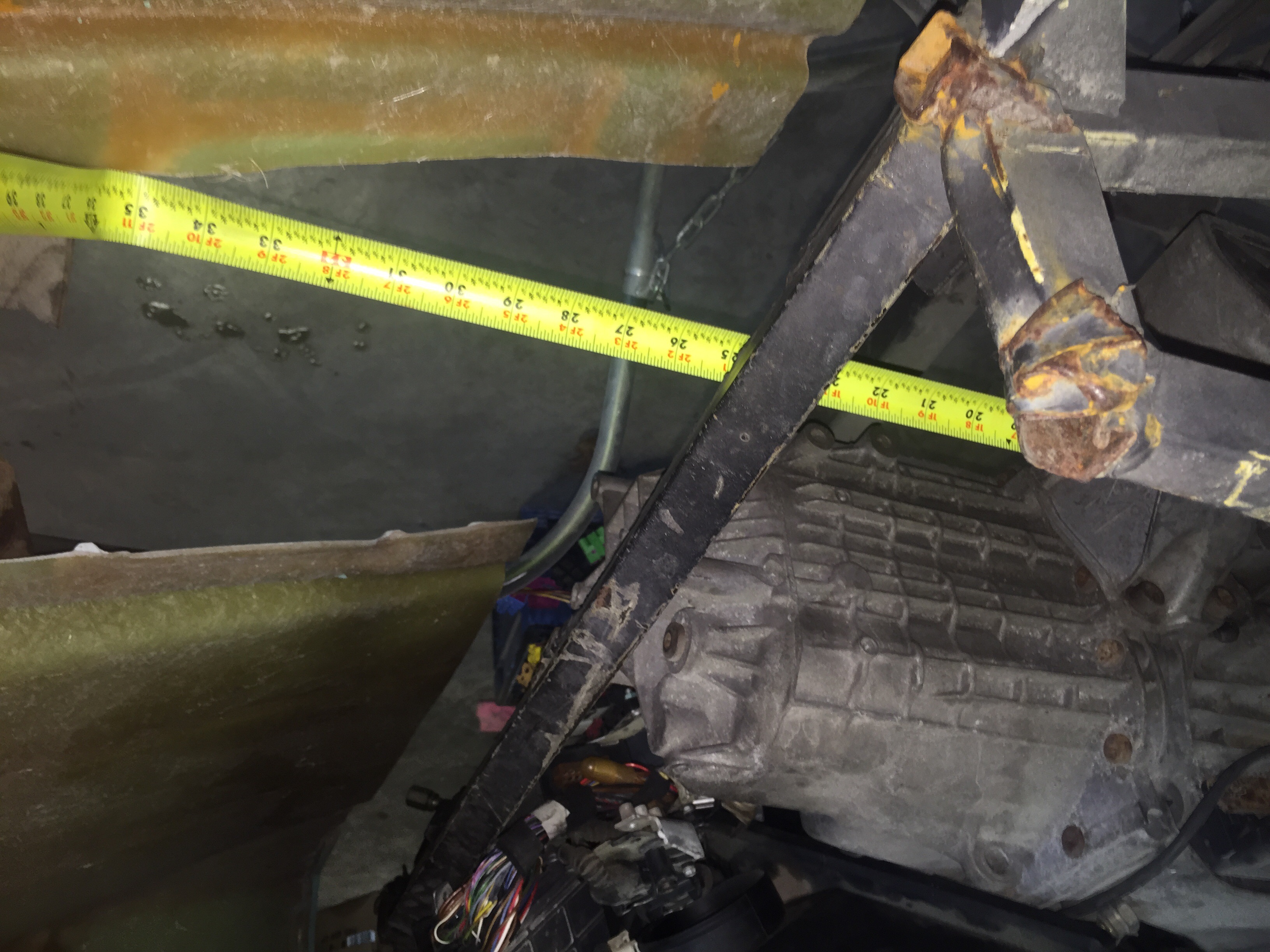

Im still working on finding transmission, I have a few leads im working. the plan was to go with a 6 speed Quatto 01E and have it welded but they are 33" long and will come out where my muffler is supposed to be. The 5 speed I have is 24" I need to try to find something that is 24"-30" long. Sorry for the crappy pictures but I had to moc up the panels to see where everything will come out.
Also what are my cable shifter options since these were designed to be shifted from behind?
2006 Murcielago 4.2

Haven't done it yet, but am planning on playing with the Boxter shift box and cables to shift an 01E in that orientation in my 914 project.
You can can also add a 6th gear (TDI) to a 5sp 01e. Just takes a bit of time and work. Could be a good way to make use of a cheap trans for now and upgrade over time.
In fact, you'd probably do well to buy the JHM 01e trans video to learn about the innards of the trans sooner than later.

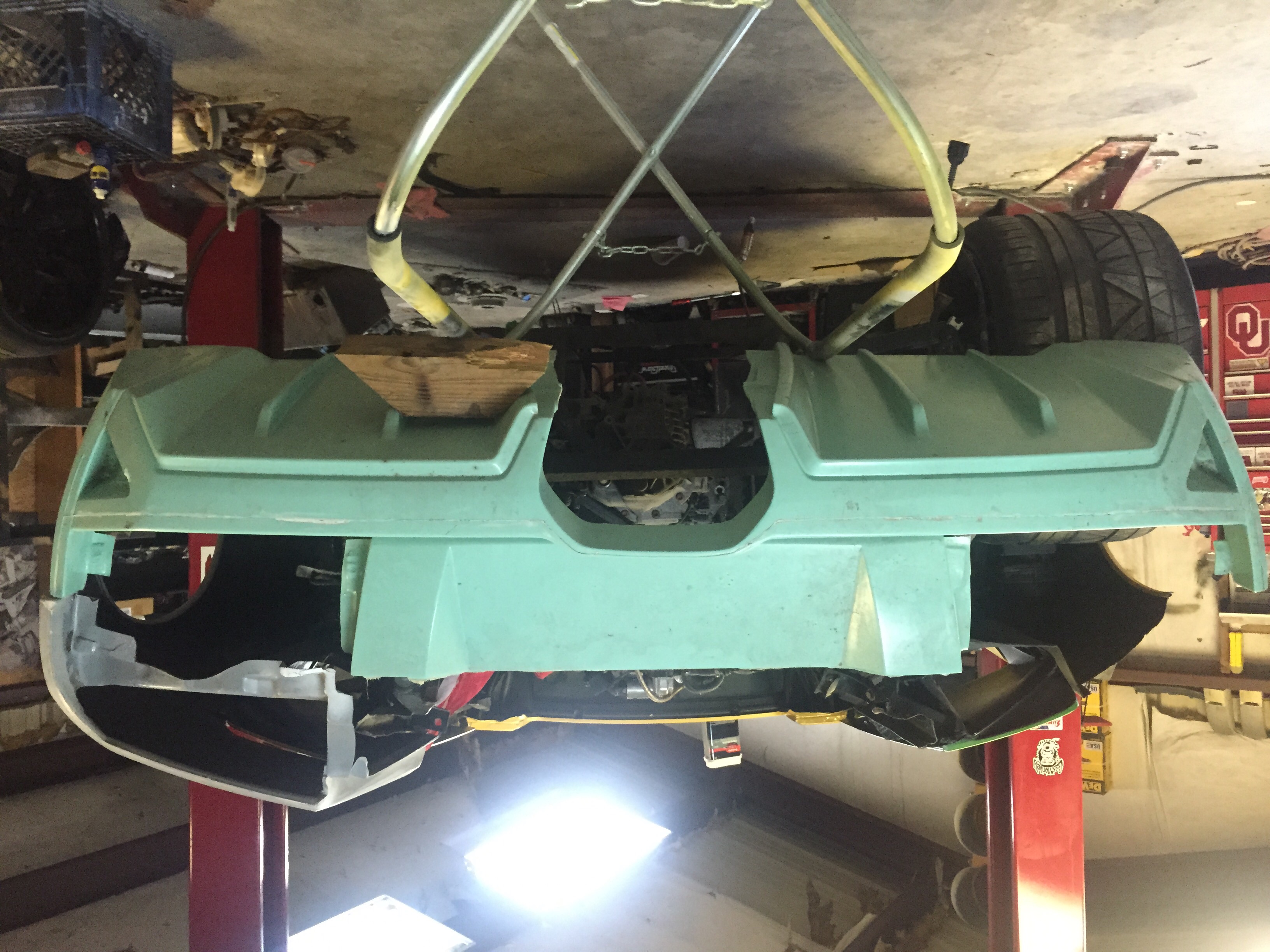

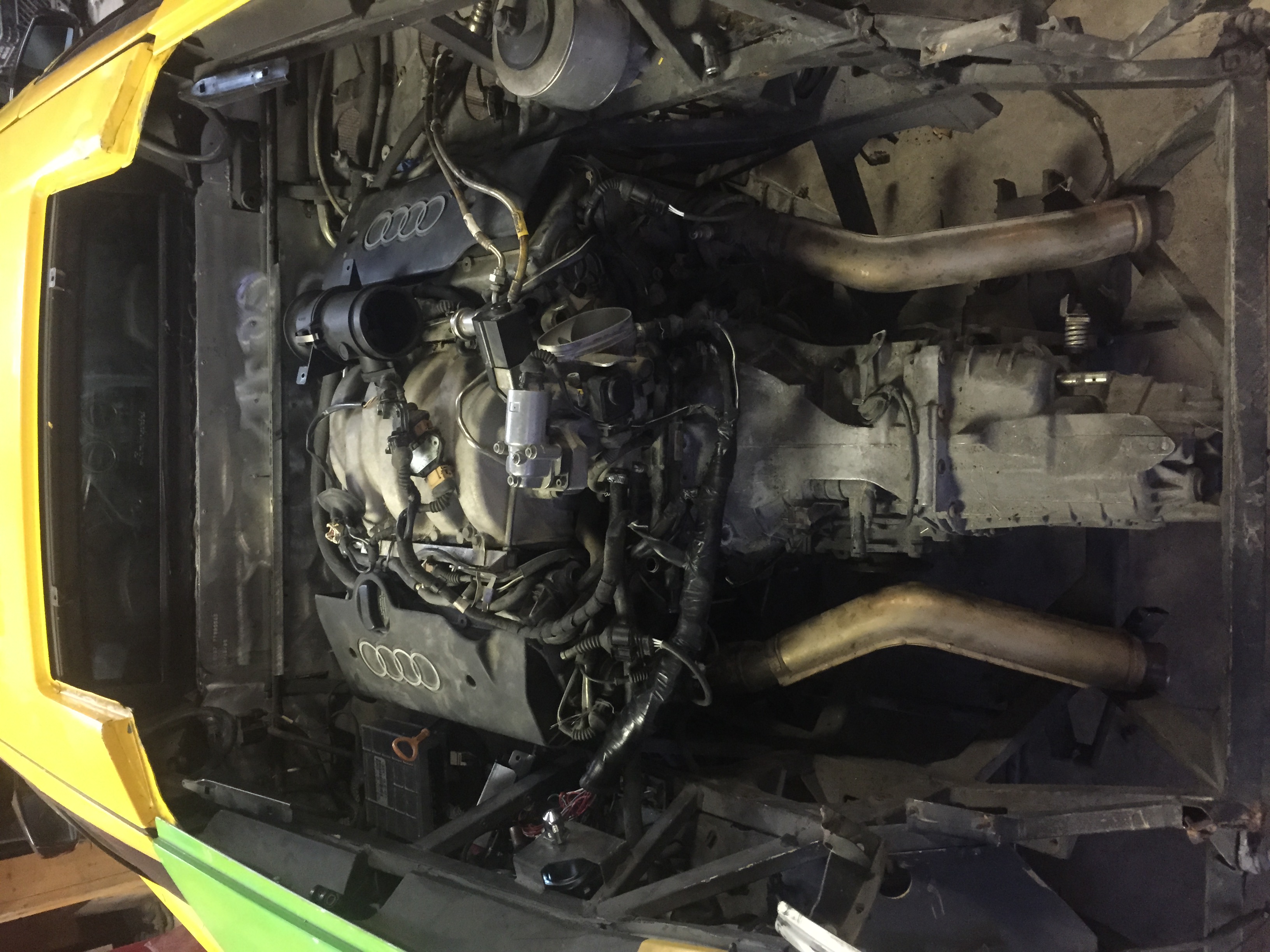

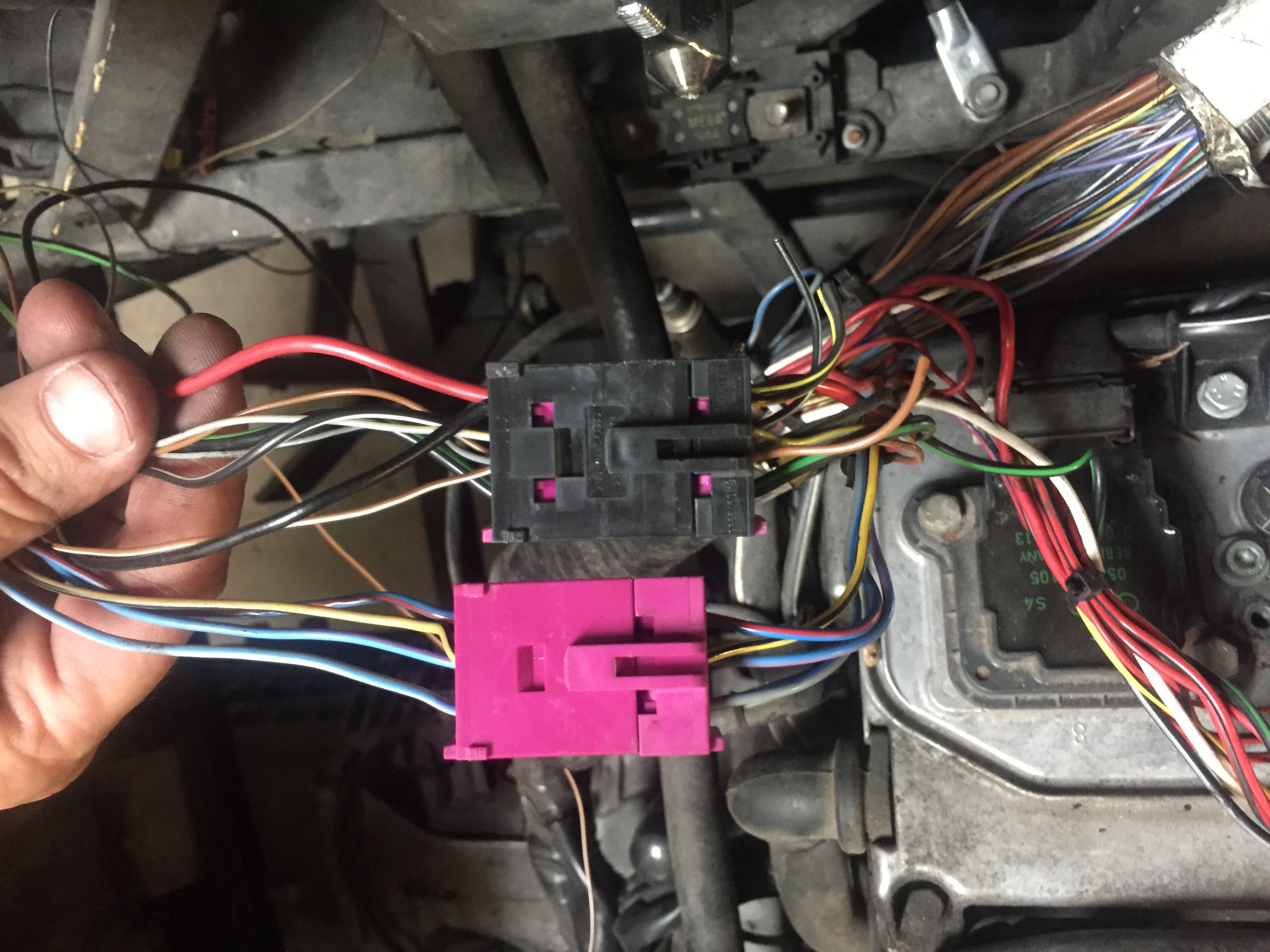

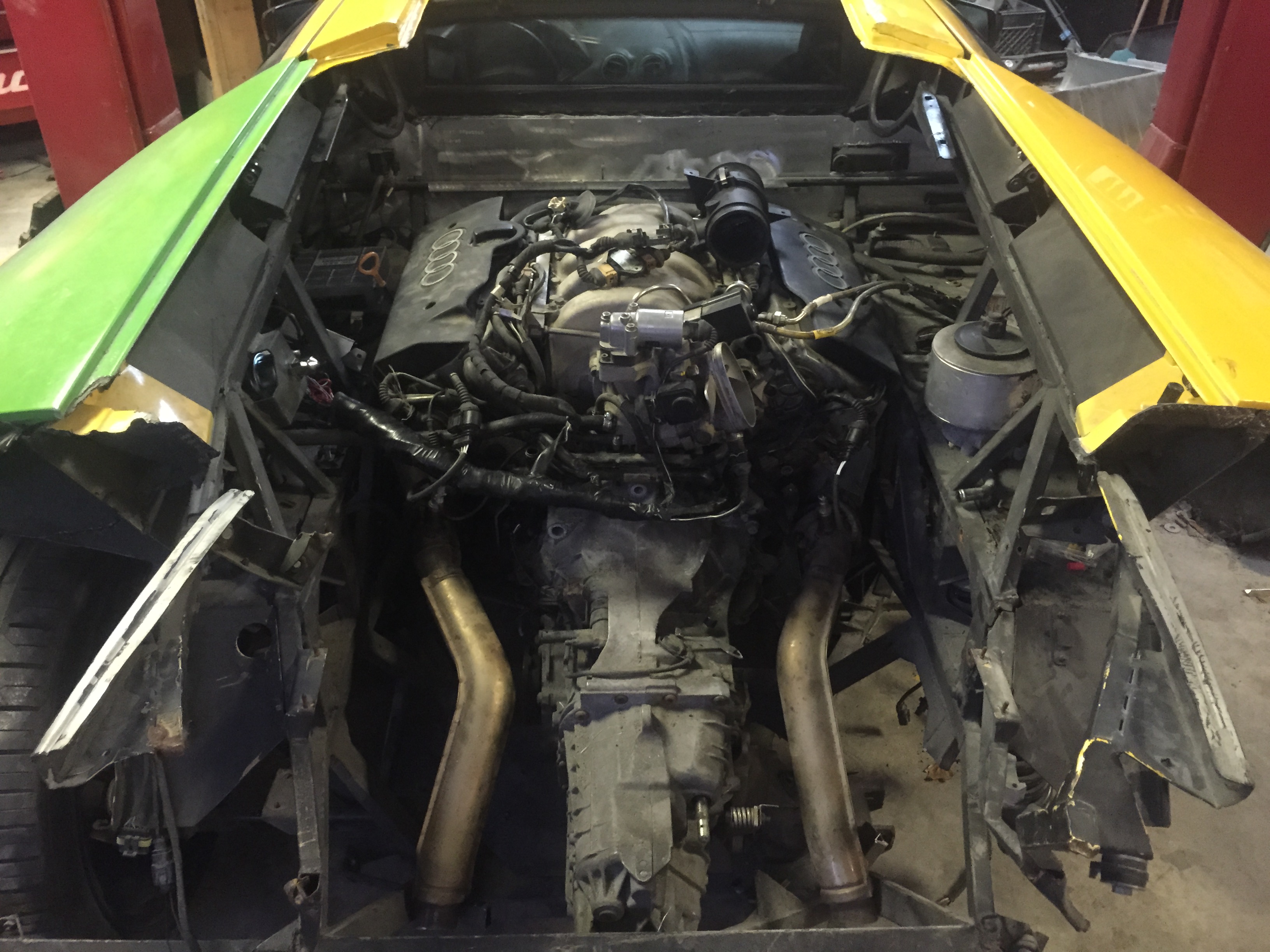

Not much to update… I pulled the Auto Transmission wires from the engine harness installed the down pipes & O2's, removed all of the evap system from the Murcielago and the 4.2 and ran the engine harness to the other side of the motor to be ready when the VEMS gets here. Fuel pump should be here this week also ordered radiators.
Aloso sorry for the upside down pictures not sure whats going on there... :idunno:

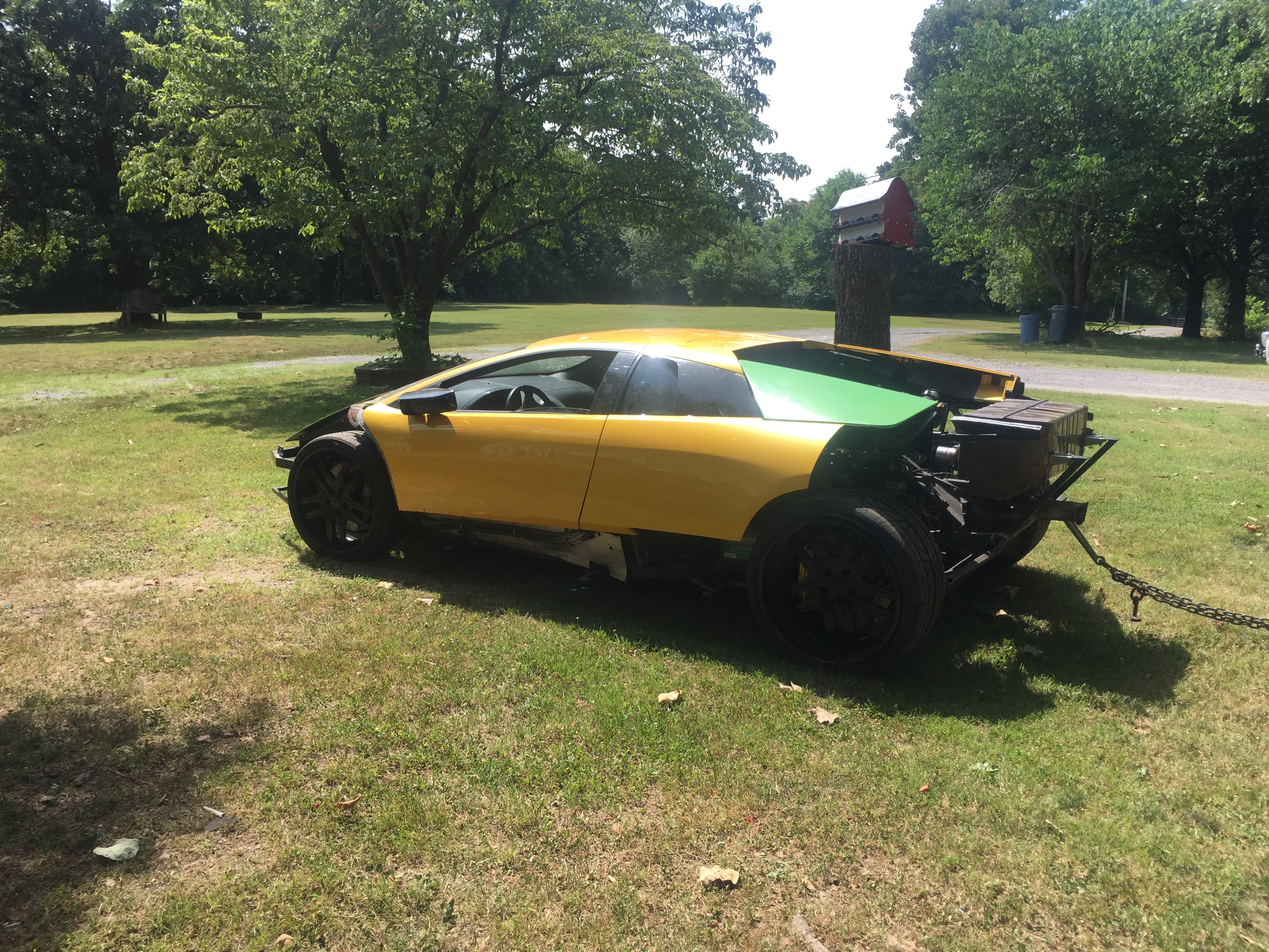

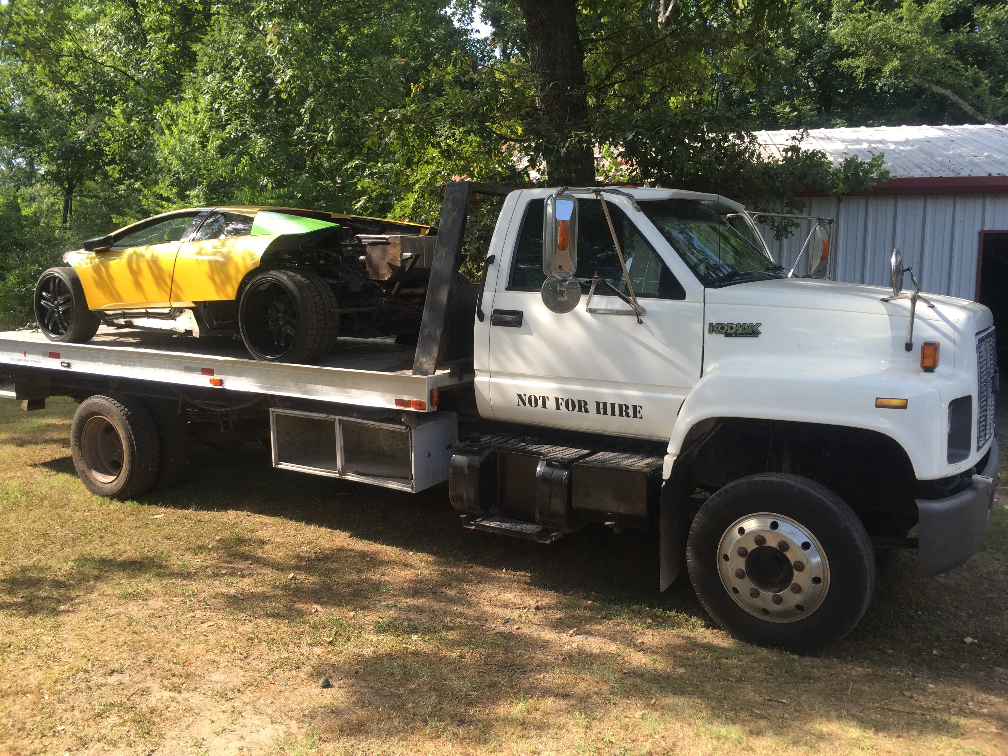

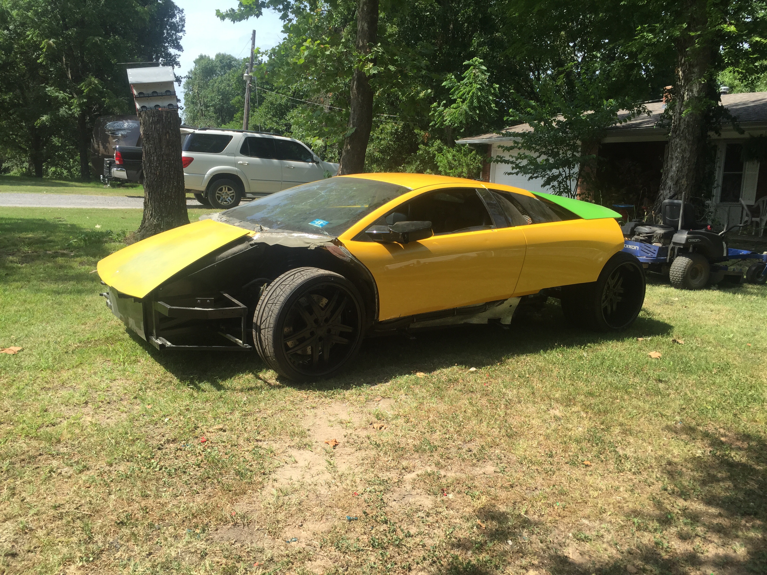

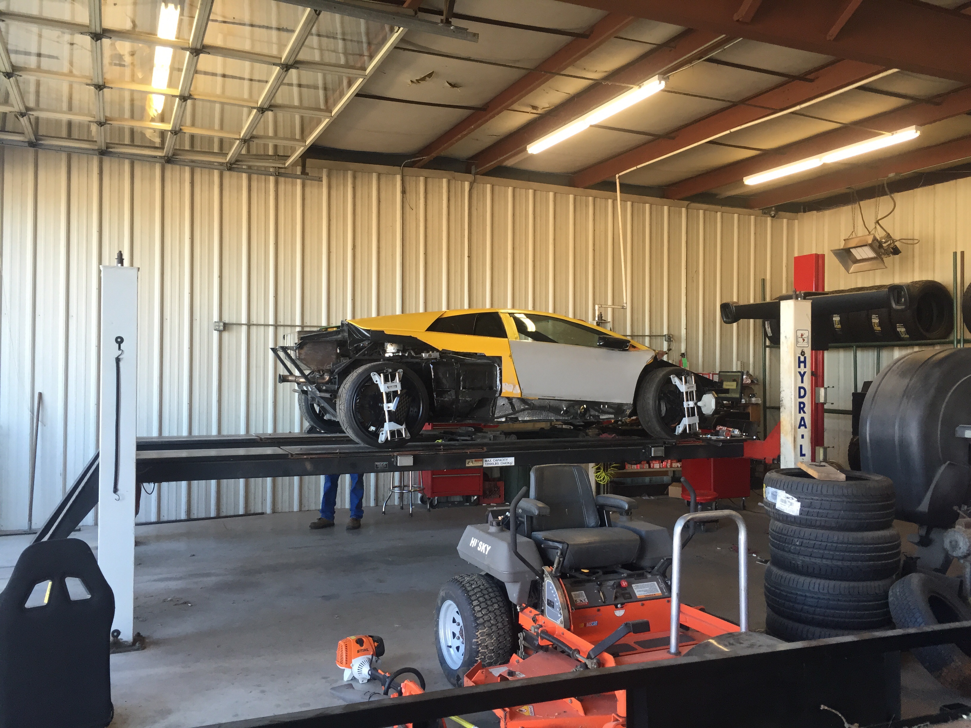

Time for an update, purchased a used rollback to transport the car around since it's so wide it won't fit on a car hauler and got sick of paying a wrecker everytime I needed to take it somewhere. Took it and got it aligned earlier in the week. Alos got the muffler all setup and mounted (have pictures of that as well but in my computer not my phone here). Picked up my LP670 front fenders to go with my LP670 bumper. Still working on getting other LP670 parts here from various places. Now rolls, has brakes, etc.

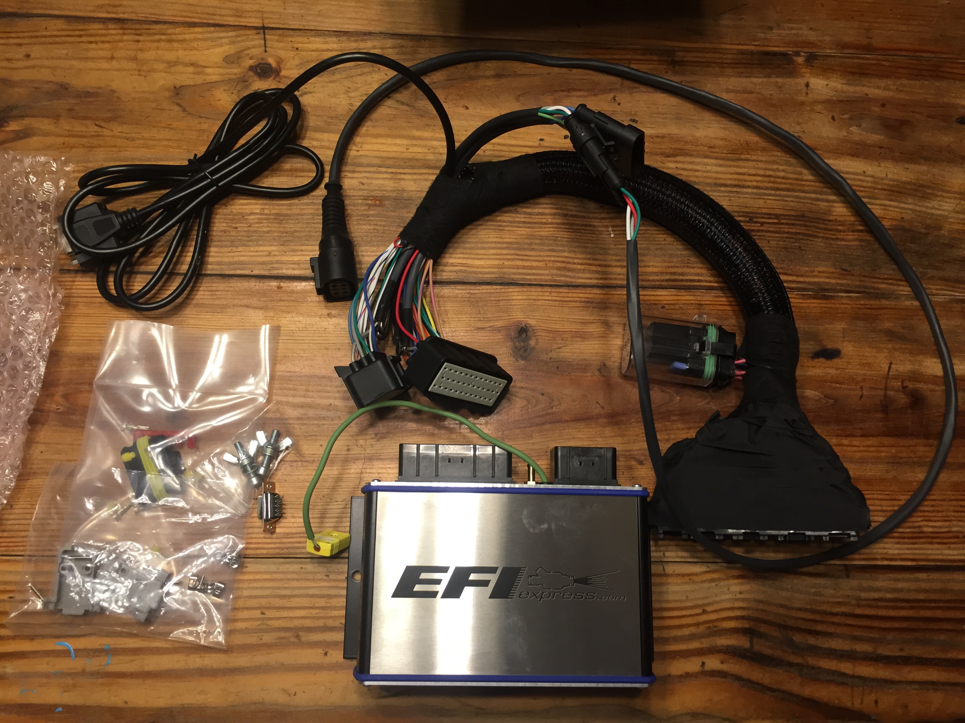

Finally got my VEMS in from Marc with the adapter harness and im very impressed with the quality of his work and the setup...! Really glad I went this route just hope I can get it all figured out! Currently trying to figure out where these wires need to go on the engine harness. Hopefully I can find a diagram or a good link to figure it out. Still working on finding a 01E transmission through Marc that will fit.

Lastly working on the fuel pump issue. I purchased a Bosch 044 type fuel pump and trying to adapt it to the original Murci filter and it's proving to be a little of a pain. I just went and ordered a bunch of metric fittings to make it work should be here next week. I'll post more pictures of this when I recieve some fittings.
