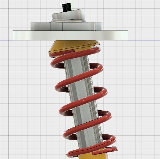

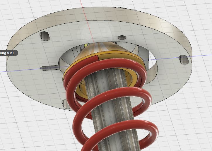

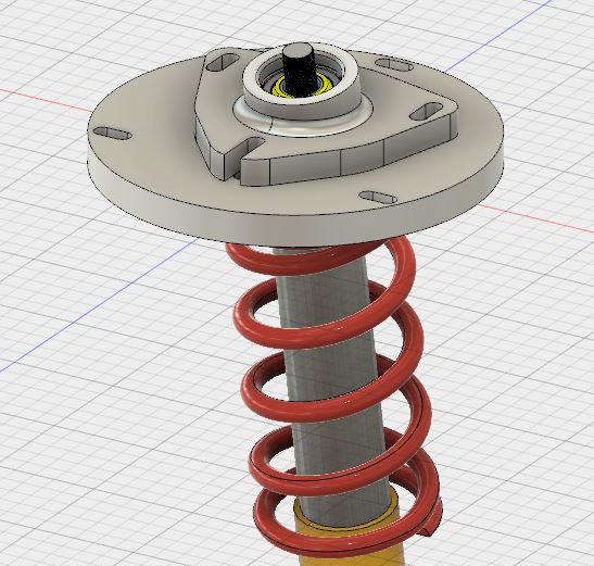

Here's a preview of what I was working on before. These are geared toward suspension travel as a priority. I may make some fundamental design changes to increase adjustability and fail-safe mechanisms. One of the most important aspects of the design is the angled spherical bearing mount. That helps keep the bearing in the middle of it's travel for proper loading and maximum adjustment range. When making a "straight" mount for a spherical bearing, the bearing will be almost at it's full range of motion while sitting at stock camber position.
Re: UrS4/UrS6 camber/caster plates for coilover setups...
This is the advantage of this mount. I still have to model lower profile hats, but you get the idea.
