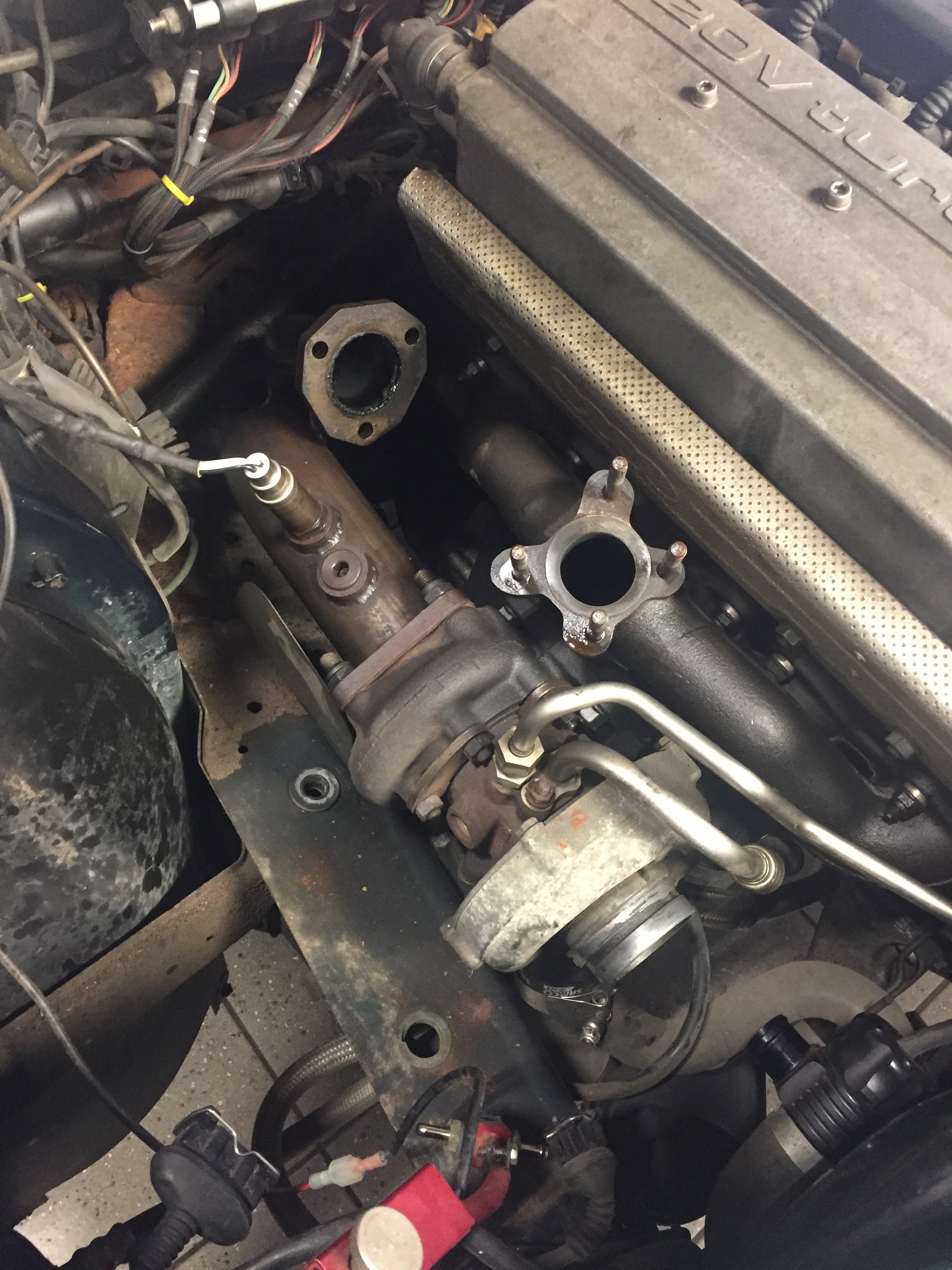

Re: TCombs UrS4, Wagner EVO Ex. Mani install soon.
Honestly it's not that bad to get to the exhaust manifold. The worst ones can be done with a ratcheting wrench from underneath looking up through where the starter motor normally sits. Some people advocate using an s- or c-curved spanner, but that's a lot of work vs. using a ratcheting wrench with some good ergonomics from the flat of your back looking up.
Re: TCombs UrS4, Wagner EVO Ex. Mani IS IN!
Well I did it! With a LOT of help from an Audi tech, but its in there. It wasn't as bad as thought it was going to be. It was pretty straight forward. I had soak everything a couples days in advanced and Im sure it helped a lot. There was only one broken stud but we think it was like that before we started the tear it down. A couple of the other nuts came off really easy, almost as if they weren't tight. There was one that I thought for sure it was going to break but it came right off which was nice. The tech was able to drill the remaining part of the stud out.
We removed the other studs after we installed the 4 short studs just to make sure we at least got those ones in. We then installed the new manifold but there was four studs on the tops that were to long and kept the manifold from sitting flush on the block so we ended up cutting those ones down as well. Everything fit after that and tightened up nicely.
Started her up and smoked for a bit burning off all the machining oil and the penetrating oil. No leaks that we could see or hear so all is good. I will check everything again in a week or so! I didn't end up using the "c" shaped wrenches or anything, just basic hand tools. But I did have the luxury of a lift.
I didn't have my motor mounts yet, so those will be going in when I get them in!
(Still haven't quite figured out the whole picture thing and why the first one is on last )

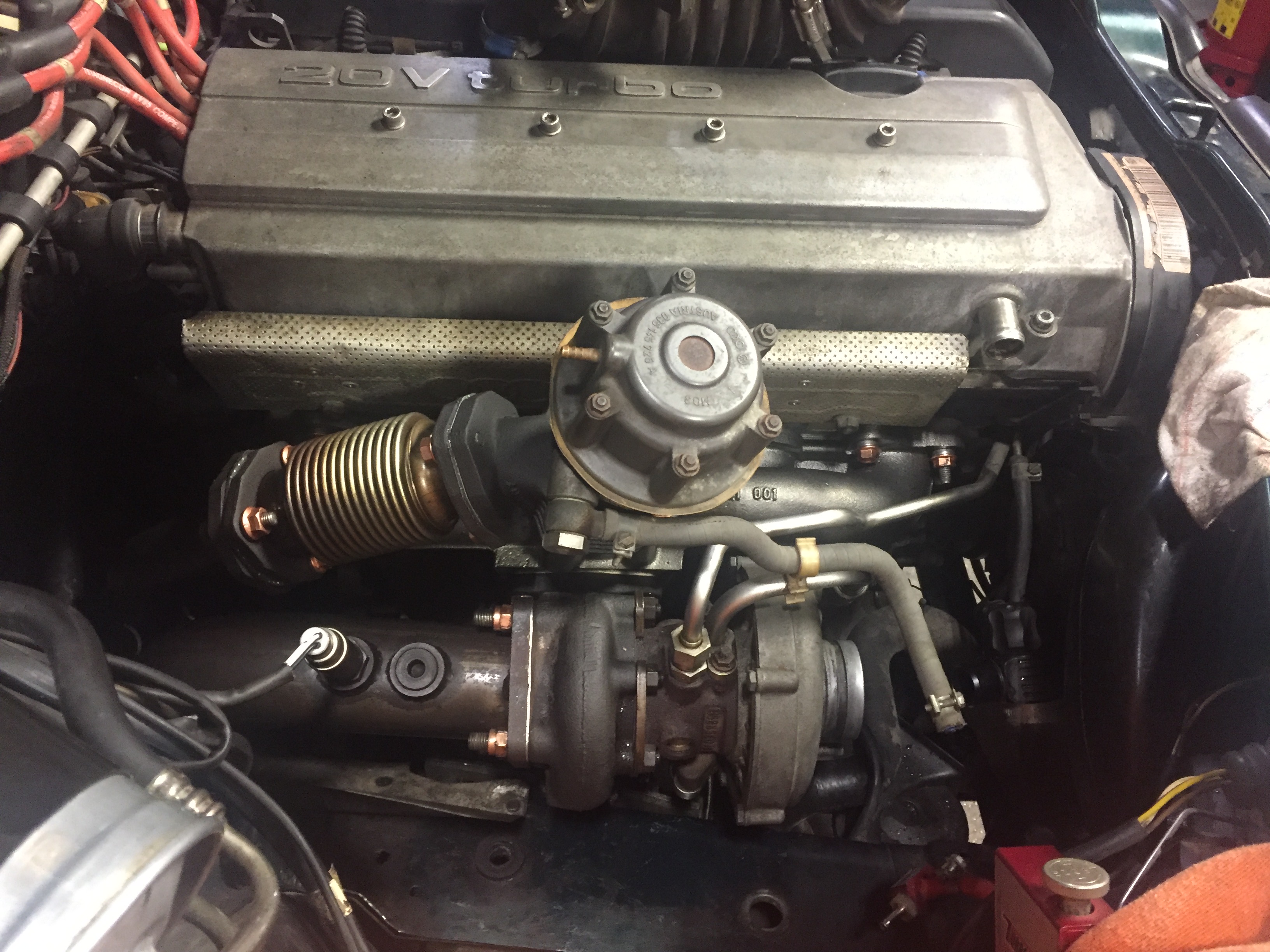

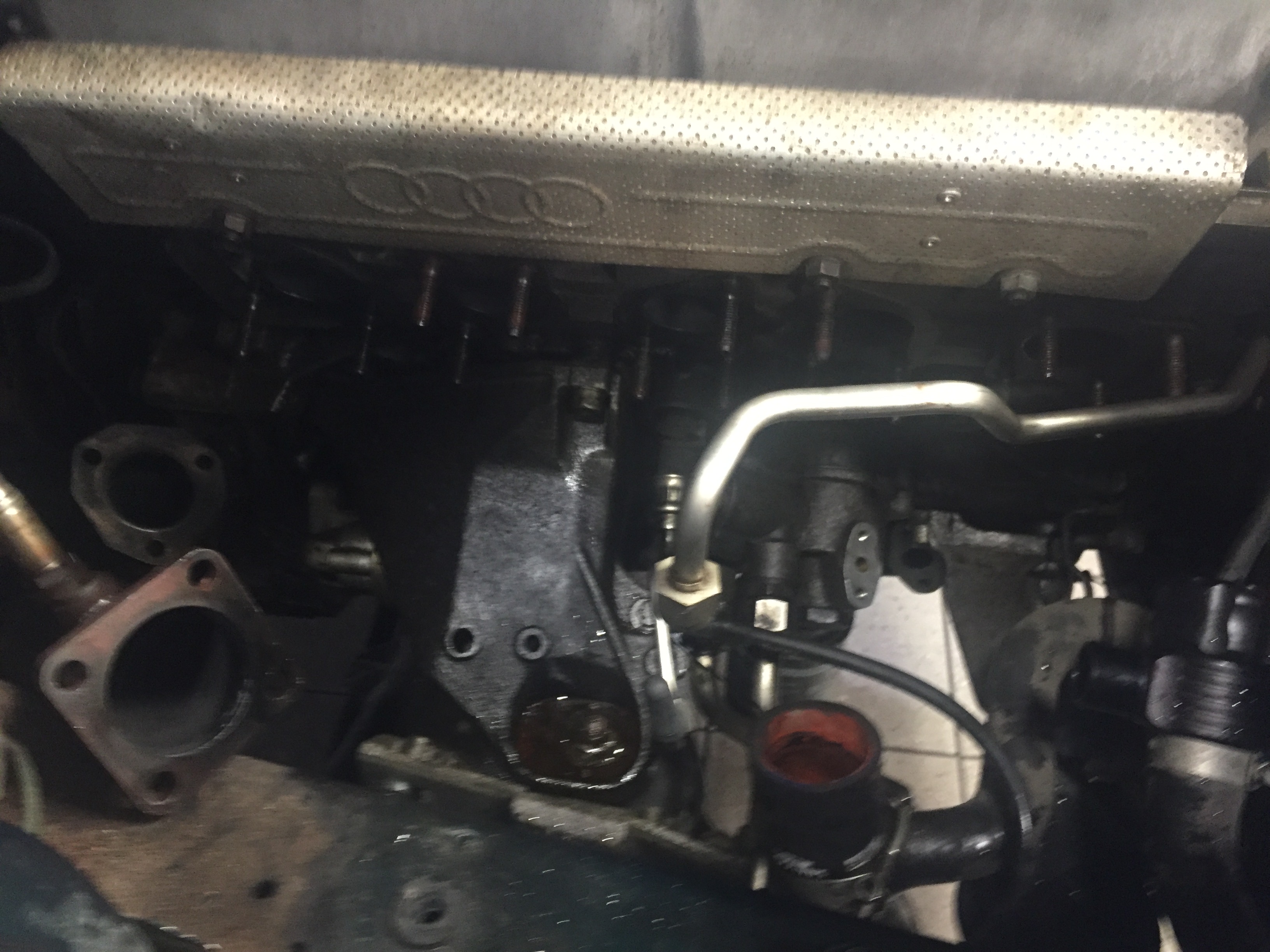

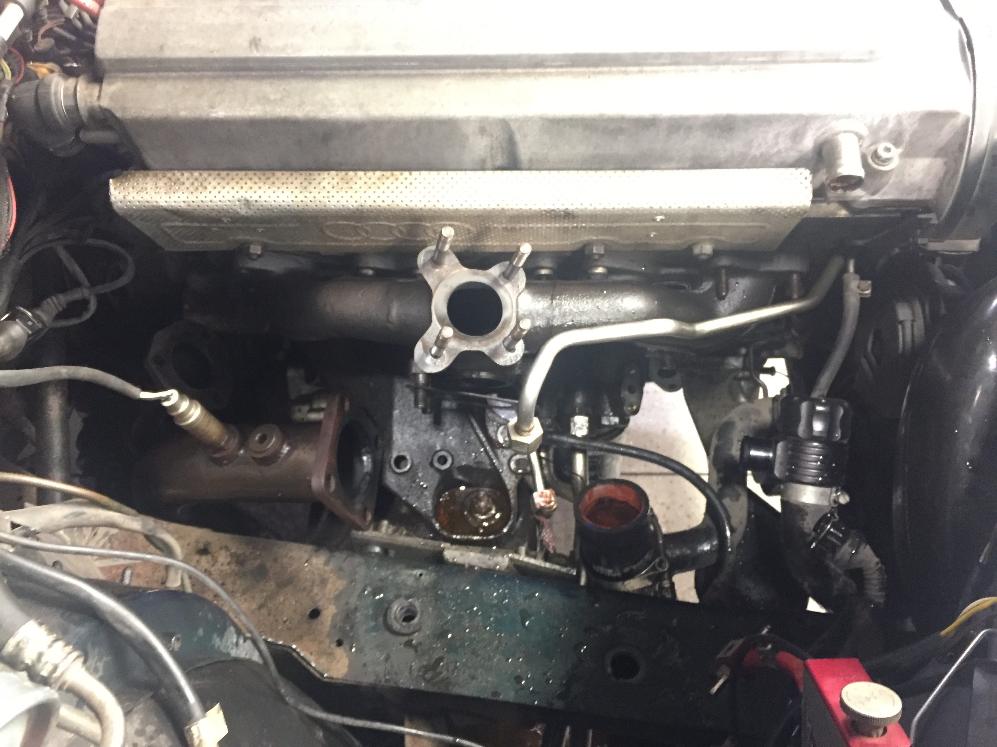

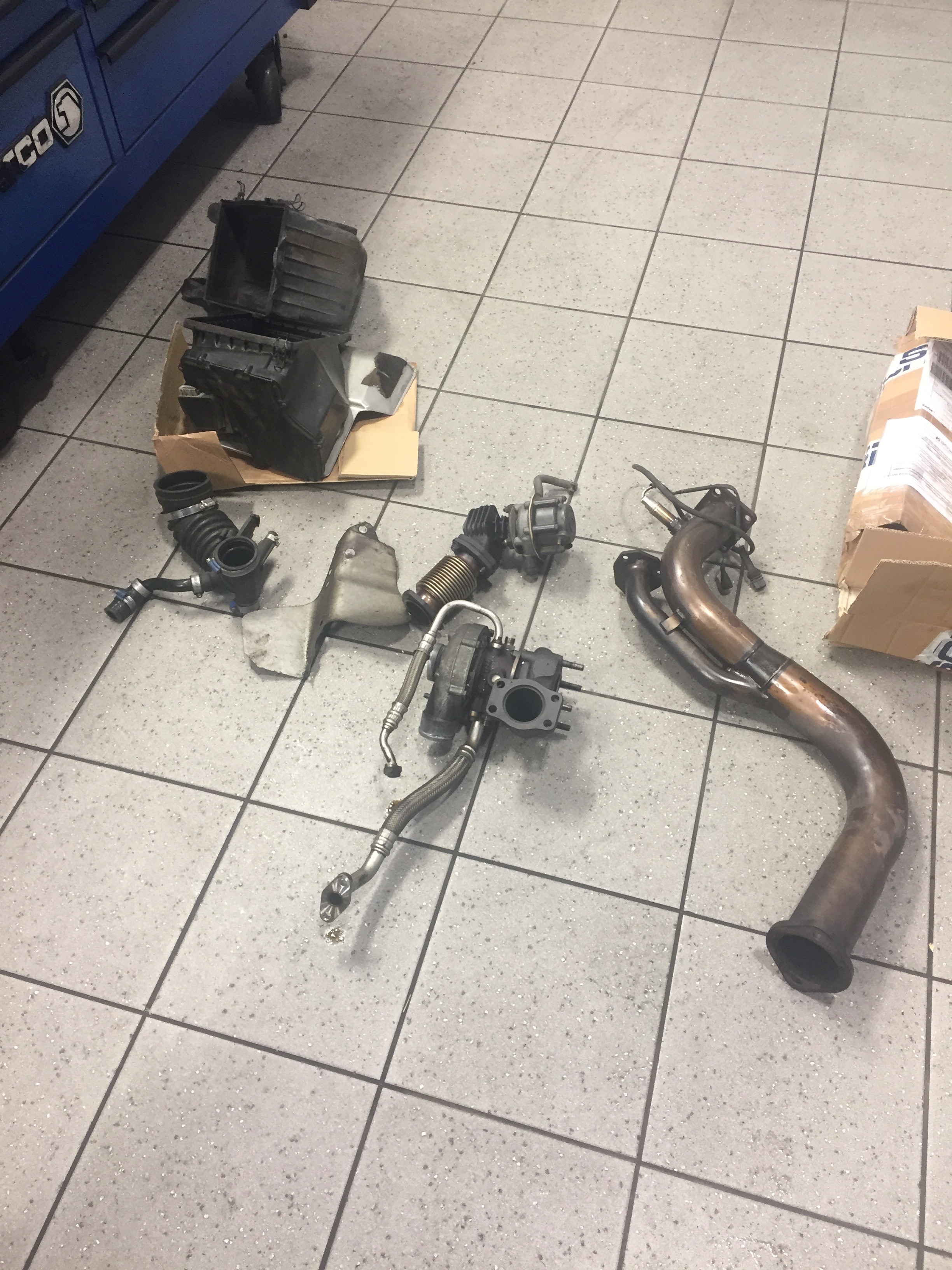

- The parts pile, ha
- IMG_7083.jpg (1.94 MiB) Viewed 66864 times
- Old mani off
- IMG_7078.jpg (1.14 MiB) Viewed 66864 times
- Turbo out
- IMG_7077.jpg (1.16 MiB) Viewed 66864 times
- Airbox and wastegate off!
- IMG_7074.jpg (1.47 MiB) Viewed 66864 times
- Step one
- IMG_7072.jpg (1.54 MiB) Viewed 66864 times

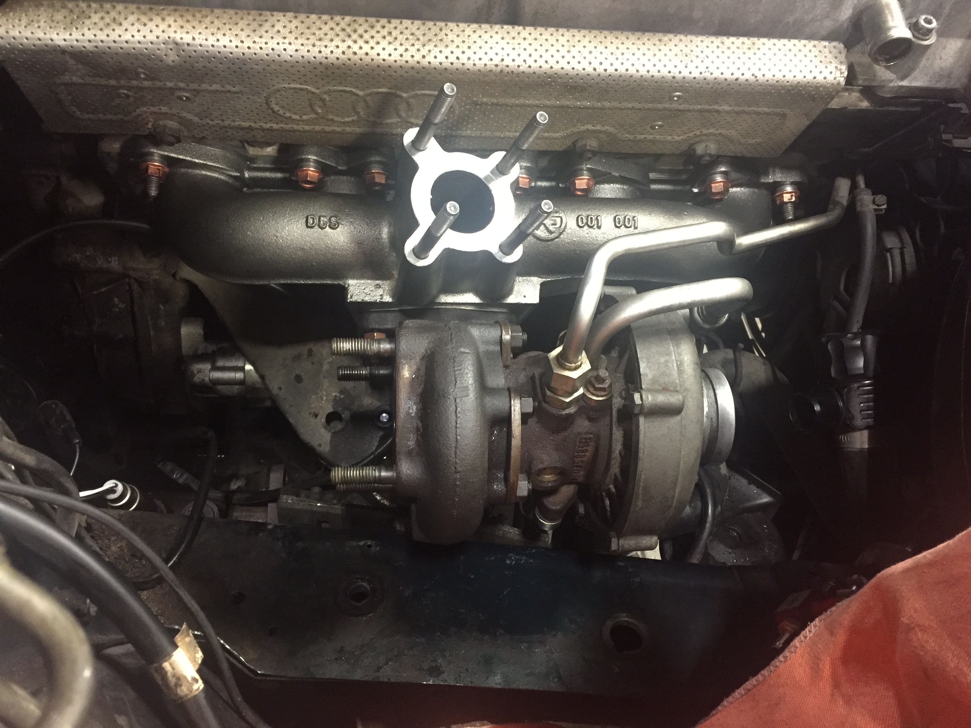

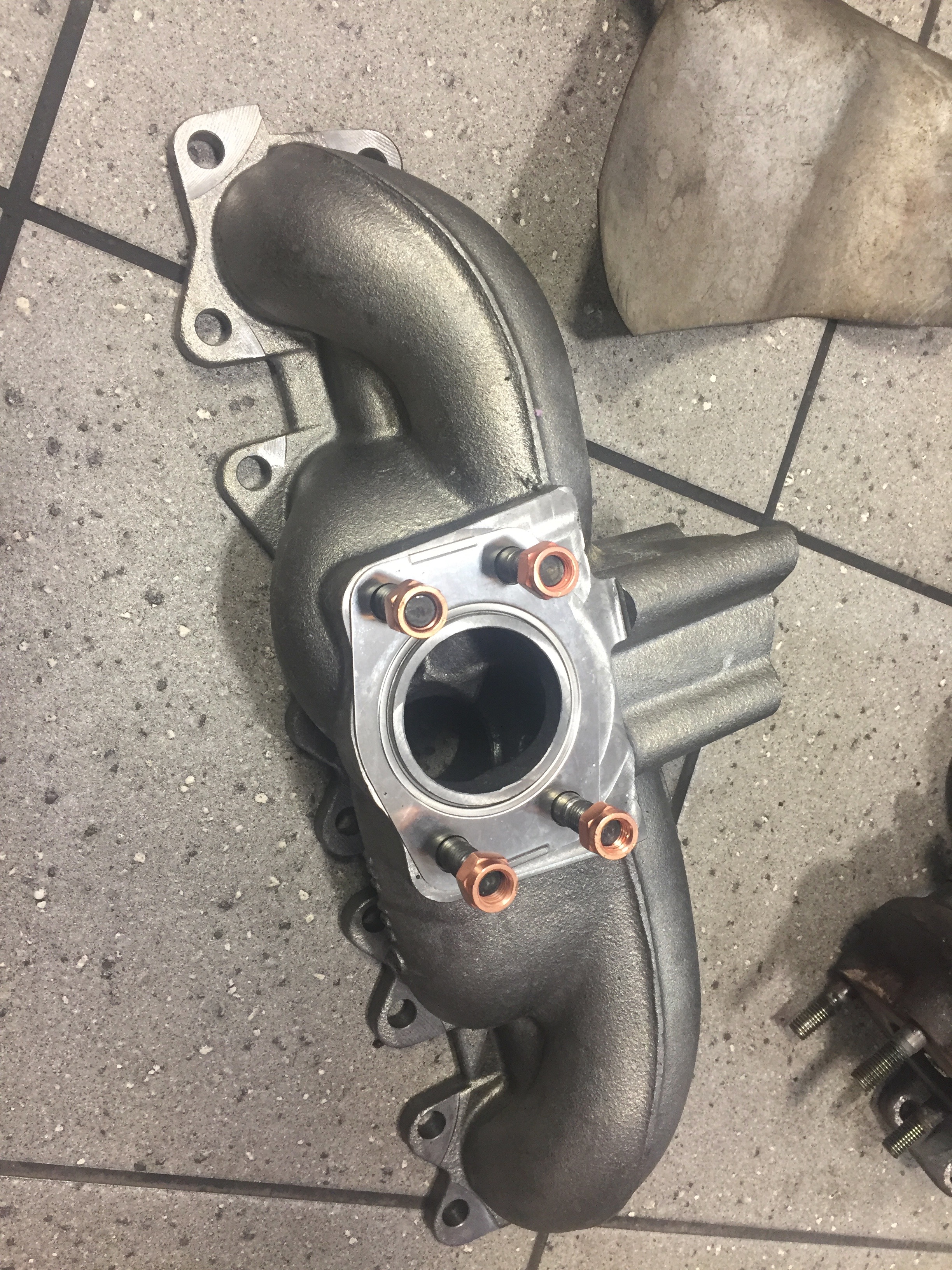

Re: TCombs UrS4, Wagner EVO Ex. Mani IS NOW IN!
More pics
- Everything back with new hardware!
- IMG_7091.jpg (1.39 MiB) Viewed 66864 times
- Manifold and turbo on
- IMG_7089.jpg (1.32 MiB) Viewed 66864 times
- New mani and hardware
- IMG_7084.jpg (2.59 MiB) Viewed 66864 times
