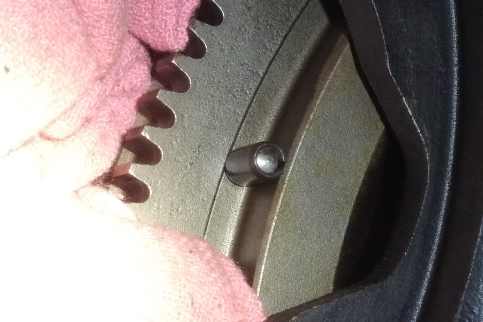

Ok first drive everything normal, up to 6000 RPM. I guess i consider this to be solved now.
Thanks for everyones input!

The tension pin is a freaken great idea!

Here is the first variation that ended up too close and hitting the sensor.
This is by far the easiest fix or at least troubleshoot to see if anything changes.
Its a little freaky that all it takes is a tiny bit of metal to make the car not want to rev whatsoever.
