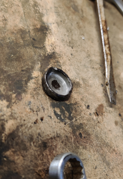

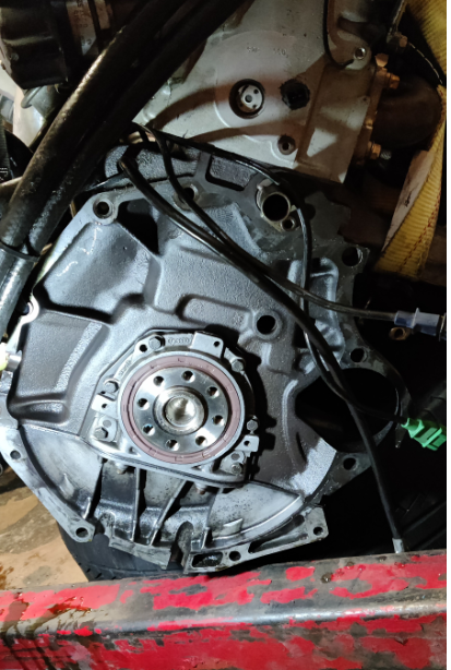

Been a while since an update. A few months ago i was cruising along the highway when the oil pressure light came on. Had to coast it to safety which took about 2 min at 1500 rpm. Turns out there was no oil in the engine.
Went back with a different car and saw that all the oil had leaked out within 3 car lengths on the highway.
There was no knocking or funny business before shutting the car off.
Pulled the engine recently suspecting the rear main seal and it turns out the oil galley plug fell out.
What is everyone's opinion on any possible engine damage? It has coated bearings and still spins freely.

- Posts: 2142
Re: quattrobros twincharged audi 90
I bought an old 80 quattro at the junkyard that they had for sale in the front for some reason. Sign said has rod knock. I took it for a spin around the parking lot, checked the oil, nothing. Bone dry. Put in my spare 2 quarts of oil from my trunk and it ran like a sewing machine for years. I went back and made them a low ball offer of $600 at the time and drove it home. I miss that car.
So I bet your engine is fine. I'd fill it oil and monitor for shavings.

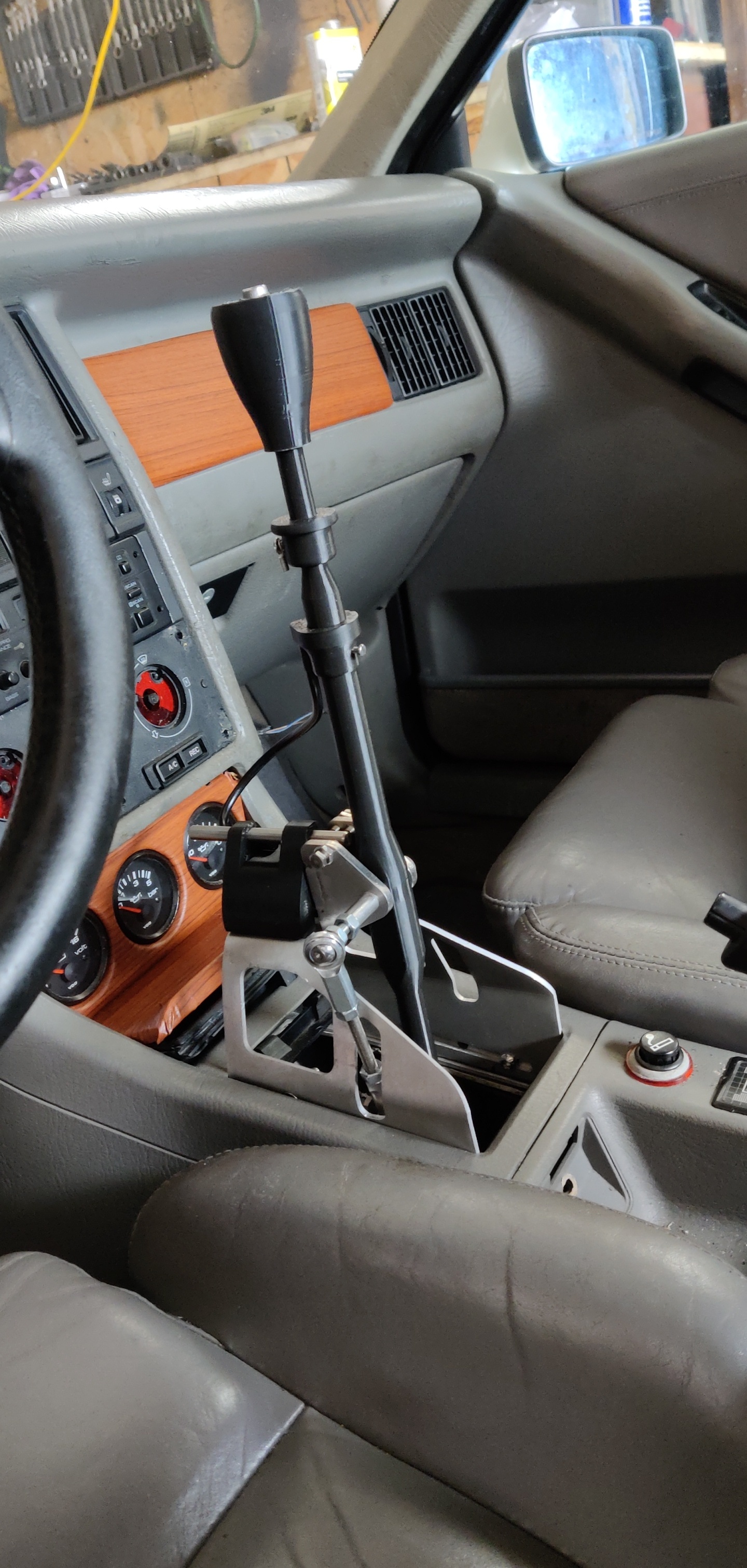

Things are about to get exciting for the 90 in the next couple months!

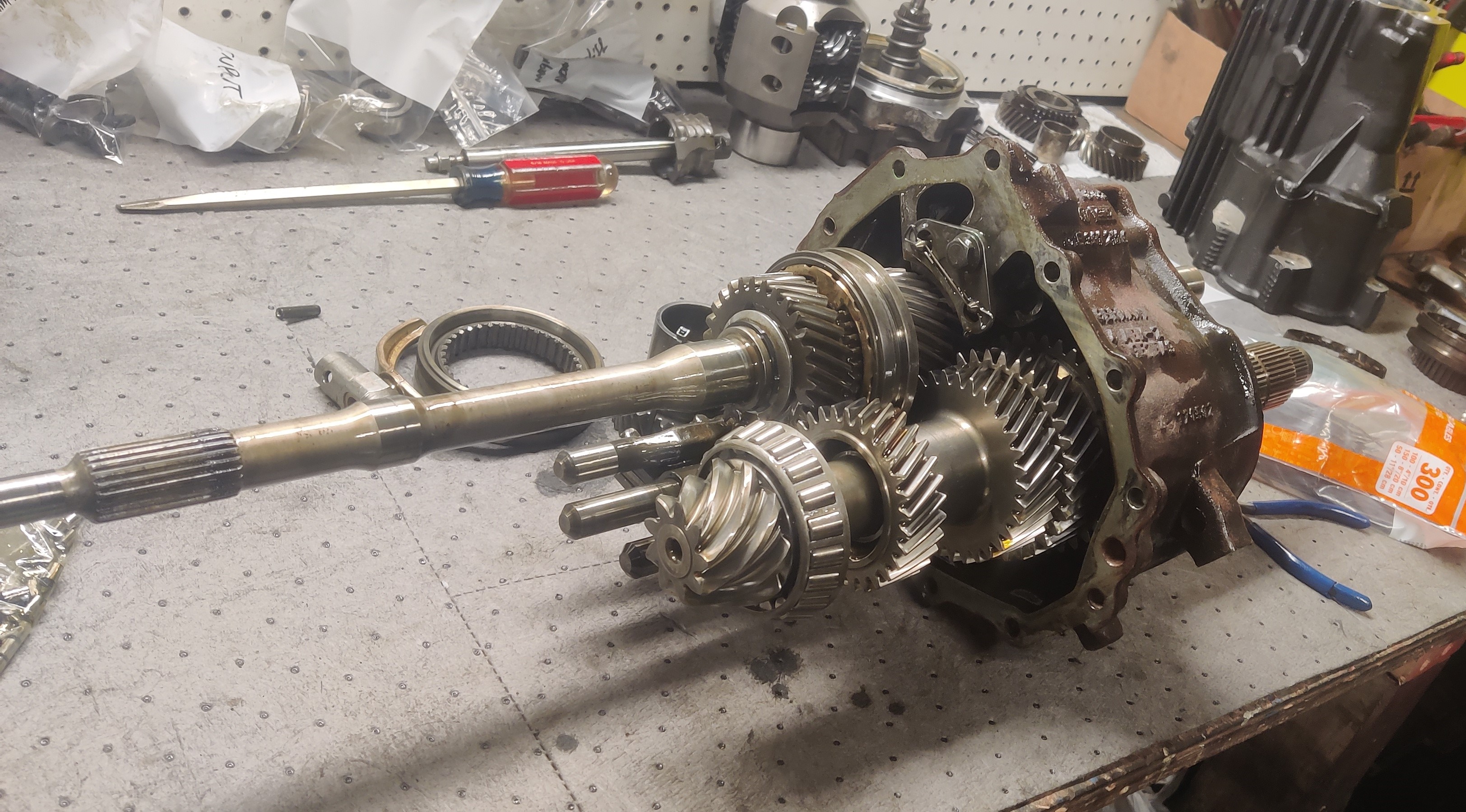

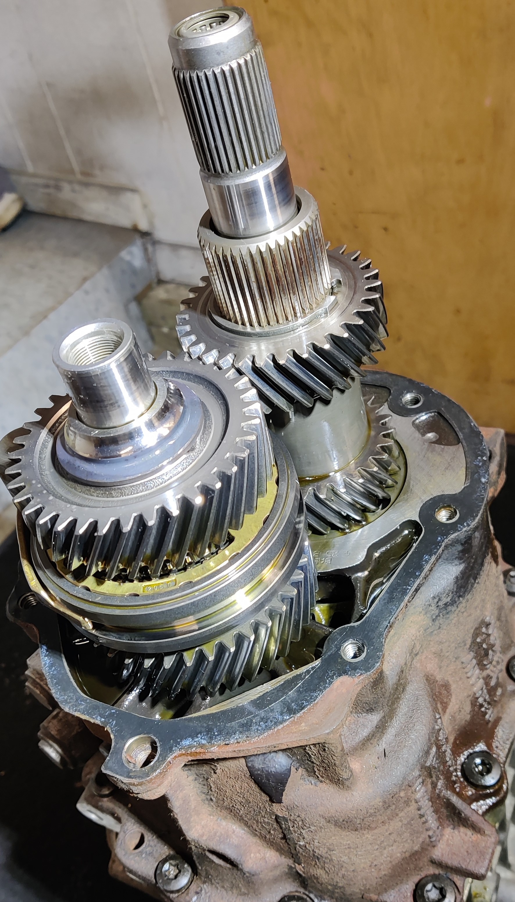

The replacement 01e i threw in last year ended up having an unfixable input shaft leak. This was causing oil to get on the clutch and ruining everything. Ended up pulling the engine 3X in one month and replacing 3 clutches thinking i had fixed it everytime. I ended up giving up and took a break from it for about a year. In the meantime i was searching for an FYF transmission.
Since then ive found a GBE trans with 100k on it that is getting a JHM rebuild kit and an EDU 6th gear swap.
I have also been working on that self centering cable shifter. Some of the parts are still 3D printed but im working on a way to get access to a lathe / mill.
Keep in mind linkage isn't connected or anything.
Ill have tons more pictures of everything once things pick up in the next few weeks.

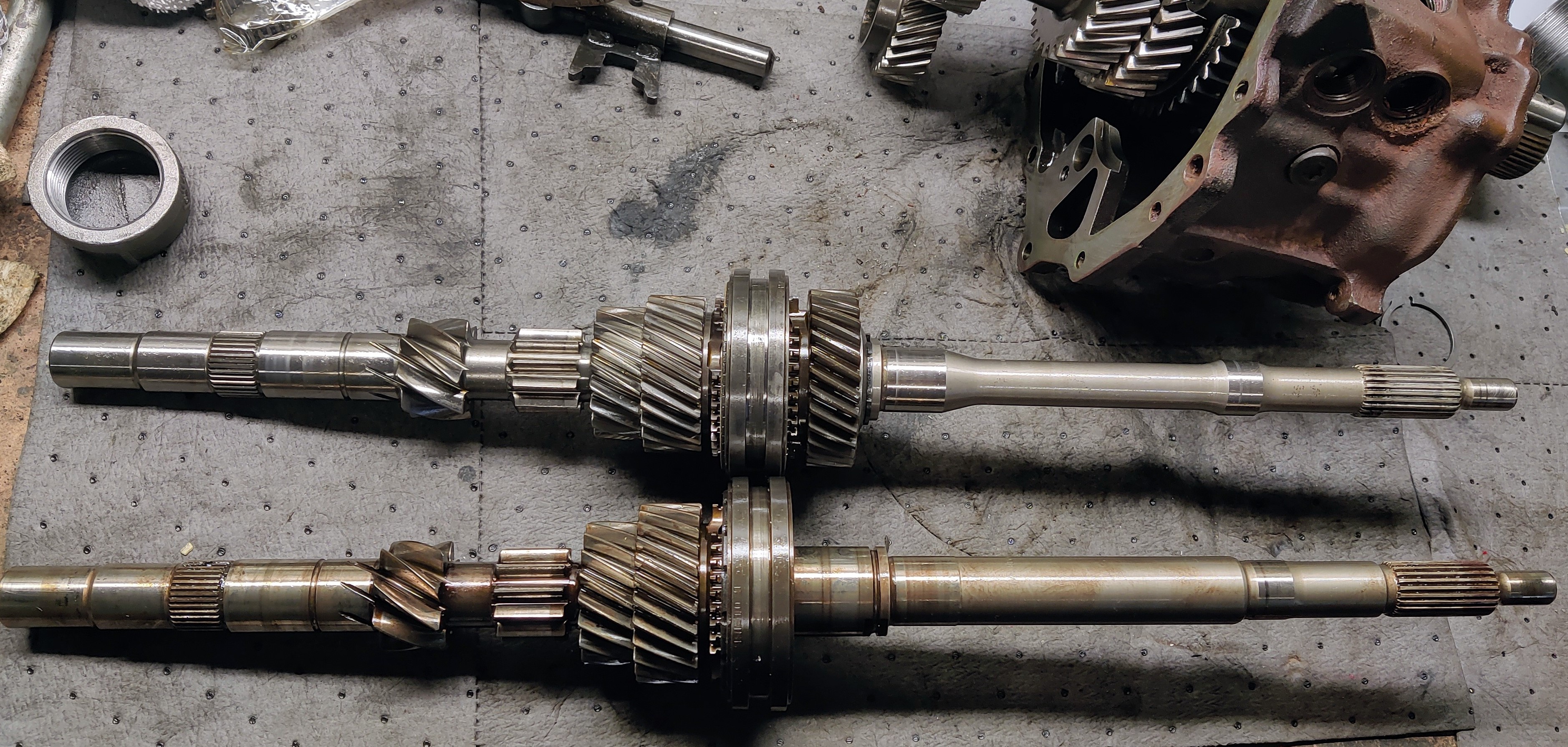

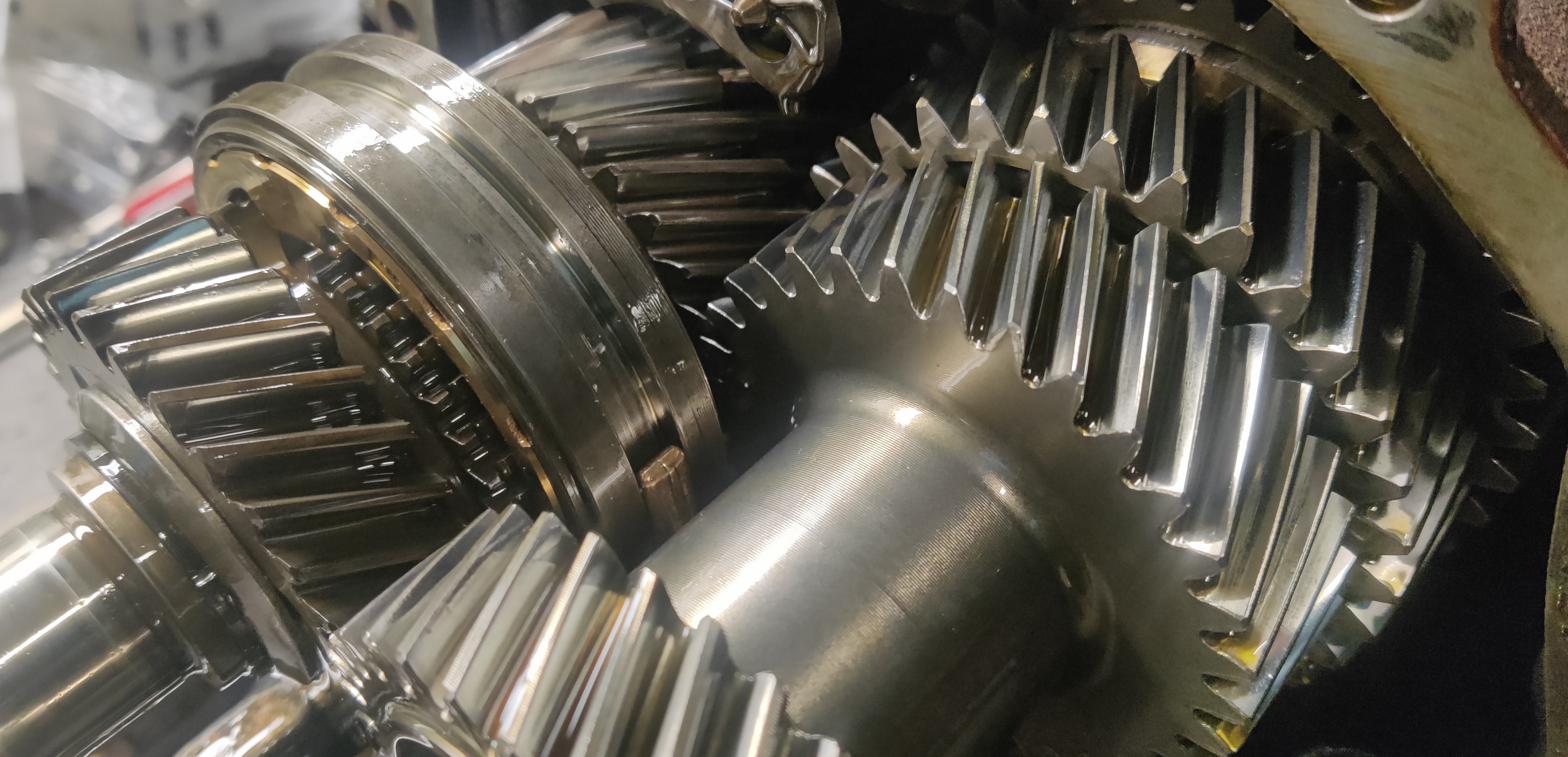

A look inside the GBE trans. Cant believe how clean this thing was. Also i think it has a flexible main shaft? I've read this is a good thing? If so, thats an extra bonus to this swap!
