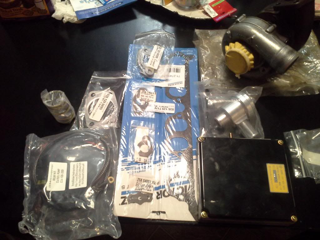

Whats up,
So after getting my 034 motorsport bypass valve. The last piece to my phase 1 on project 200. I decided to stop hoarding parts and its time to start installing them. So if everything works out how im planning this saturday i should be working on the 200. Ill be doing:
•Swapping chipped mac-14 ecu (thanks to Gtjeff for hooking me up!)
•Swapping 1.9 bar WG spring from 034 motorsport
•Installing fuel pump relay from 034 motorsport
•Swapping the s4 turbo
•Swapping straight pipe exhaust from the Fwd Exhaust
Since im gonna be removing the exhaust, down pipe and turbo. I was planning on installing new exhaust manifold exhaust gasket, upper oil feed line gasket for turbo, oil return line at turbo gasket, 4 hole turbo gasket, lower block oil return line gasket and the intake manifold gasket.
Thanks for looking!

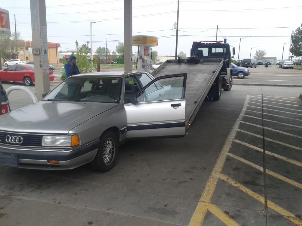

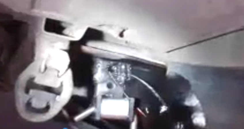

Its time for an update. So this past weekend i was planning on swaping parts, but i ended upnworking a bit later then i had planned. After work i was still determined to work on the 200 so i decided to take the 200 to a muffler shop so i could get rid of the resinsators and have it straight piped 8-) . After the work was done the 200s exhaust tone is orgasmic. So i decided to cruise for a bit before filling up on gas. I filled up my gas tank and before leaving the gas station i noticed a puddle under the trunk area.
I go look at it and found this:
The retard at the shop decided to weld the new hanger for the exhaust right onto the fuel tank :bangshead: so after arguing with the shop owner, which was very rude. I called a tow truck to get the 200 towed back to the shop so they can look at it.
So $80 bucks later for the tow and 4 days later of being at the shop being "fixed" i just got the car back yesterday. Seems ike they took the gas out, welded the leak and sprayed some kind of rubber on it. Which now has really taken my peace of mind. Im hoping this weekend ill be able to at least swap out the WG spring and install the fuel pump relay.
Ill post up videps of the 200s exhaust tone as soon as photobucket decides to work.

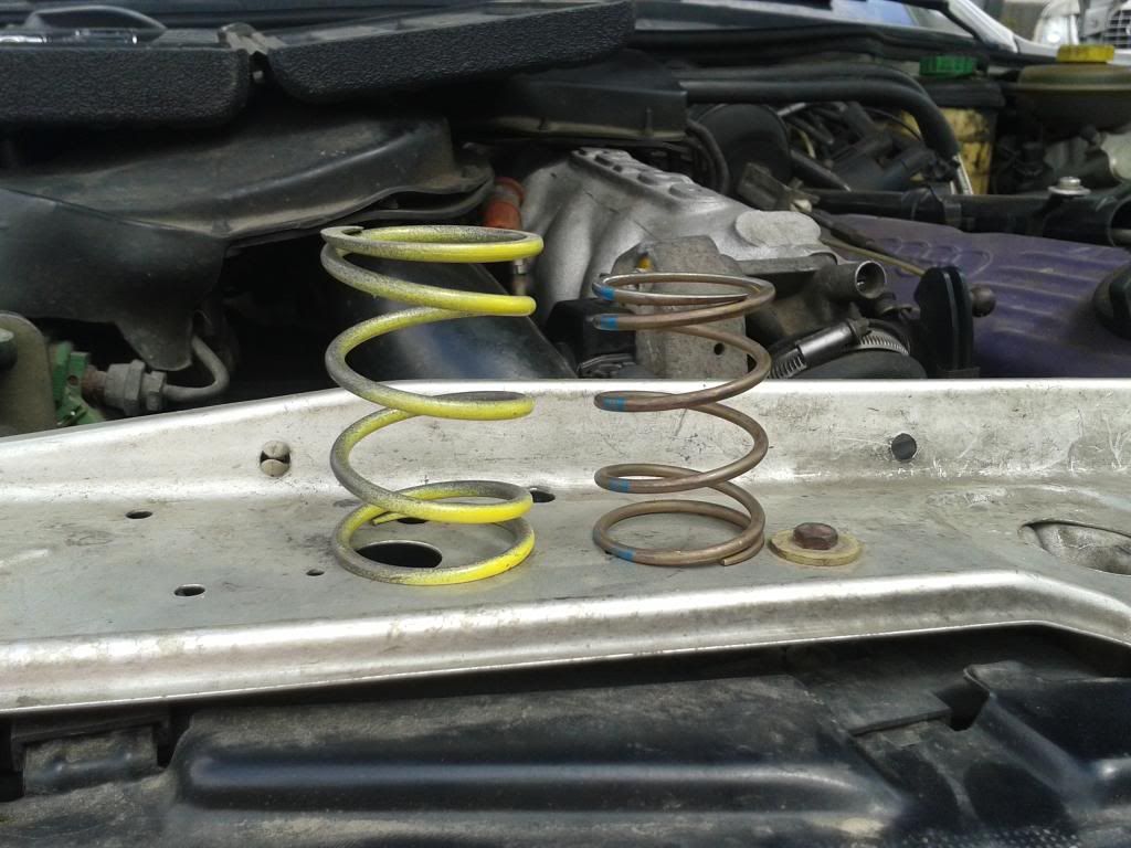

I figured it was time to share the great news. Finally after all the set backs and working late,, i was able to swap out the chipped ecu, 1.9 bar WG spring and new tps. Also i ended up up the exhaust videos to youtube since they wouldnt show up on photobucket. Thanks to gtjeff for all the advice!!!
Removed the Wastegate cap:
Comparing the difference between springs:
034 1.9 bar spring on left, stock spring on the right.
Wastegate diaphram seems to been in good shape:

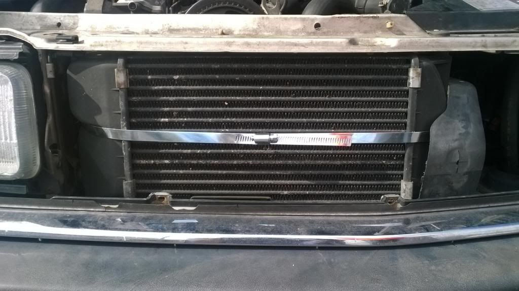

For now i decided to strap the intercooler, i was so excited to find the worm drive straps that i did it in the home depot parking lot :foff:

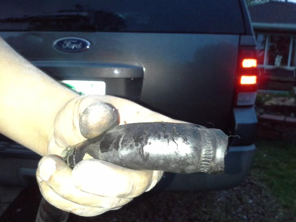

Even thought i won, i noticed the 20vt didnt pull as hard as it had been before. Once i got to my cousins house ( guy who filmed) i popped the hood and started checking to see what was going on.
Found the hose that goes from the cis boot to the 3-way breather hose on the valve cover was all cracked and creating a boost leak.
So for now i grabbed some black electric tape and covered thevcracks as a temporary fix. Im considering just replacing them with some silicone ones from 034 motorsport. Has anyone used them?

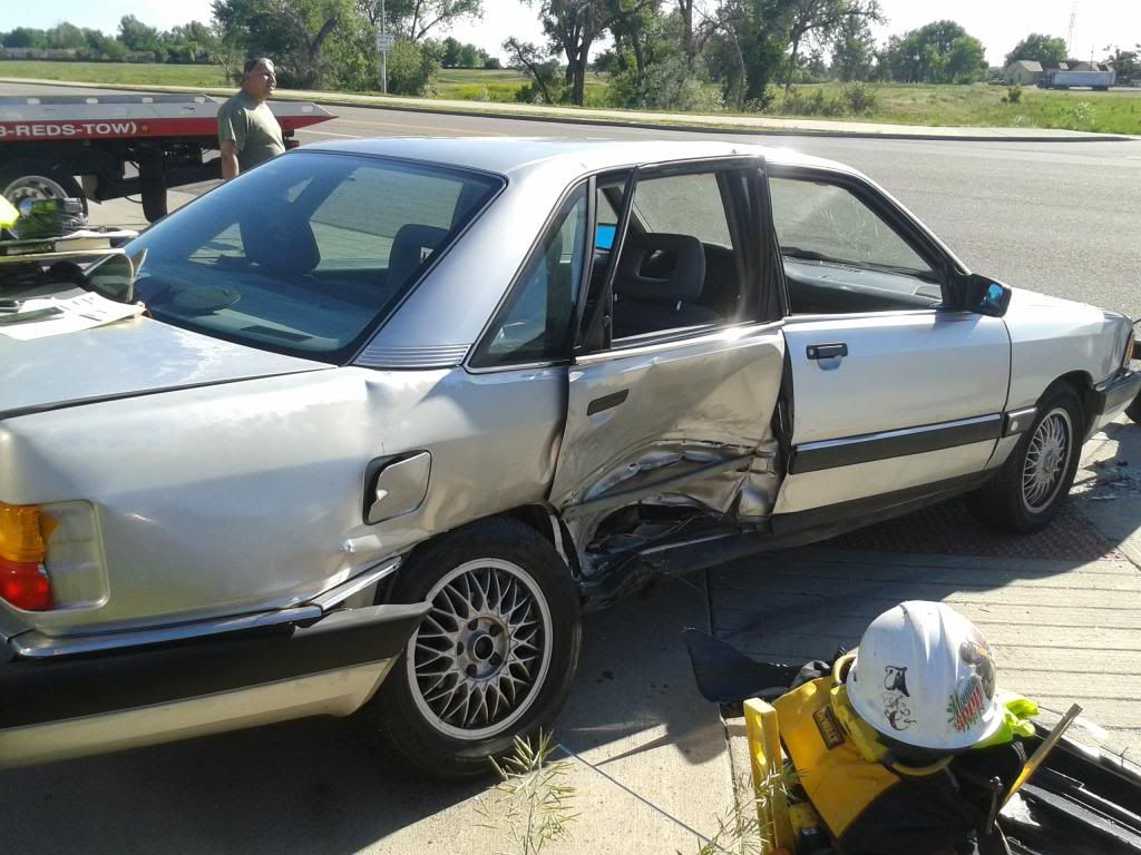

Re: Project 200. *UPDATE*- R.I.P 20v :(
Post by MHCAudi200t »
Sent from my SCH-I405 using Tapatalk 2
DrewC
Posts: 78
Joined: Wed Feb 27, 2013 12:29 am
Location: Denver, CO
Post by DrewC »
ouch you alright?
-Drew
1991 Audi 200 Avant (x2)
Midnight
Posts: 110
Post by Midnight »
:wah:
Jake
The Stable:
1999 Saab 9-3 5-door
2002 Saab 9-3 SE 5-door
That's the shits!
What's the story?
GTJeff
Posts: 101
Post by GTJeff »
Hope you are okay. Totally sucks but it looks like now you have a perfect running donor 20vt and running gear for a small chassis car.
That's either some insane understeer or you got t boned. Shit man i'm so sorry I hope you get a few bucks out of it for the 20v
If you end up parting it, I would be honored to run that front passenger door (if its good)- Mine looks like a foot ball player head butted it.
DrewC
Posts: 78
Post by DrewC »
and i'd take the drivers door (i'm in denver)
-Drew
HOLY SHIT!! I hope you and anyone else that might have been with you are ok. I hate to see that.
But I am with "GTJeff", time for another 20vt small chassis to be started!
