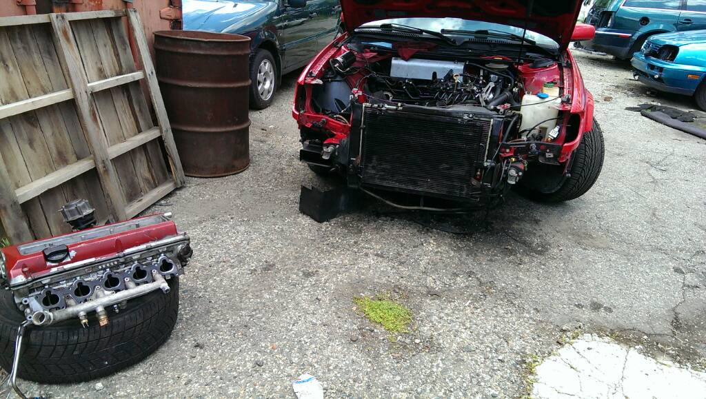

Original engine is coming out by hand, on the floor, bits and pieces being cleaned up and placed on the built motor on the stand. Seeing as I don't have all the hardware in yet to mount the turbo, I'll be pulling the head off this to inspect it's failure. So this motor should be out by tomorrow... I can then degrease and tidy the bay up for the built motor. If I get antsy, I might just throw the old t04e back on & break it in on the dyno, seeing as "recent" t04e numbers have sort of been requested for comparison sake and mainly just for my own...

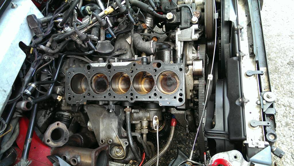

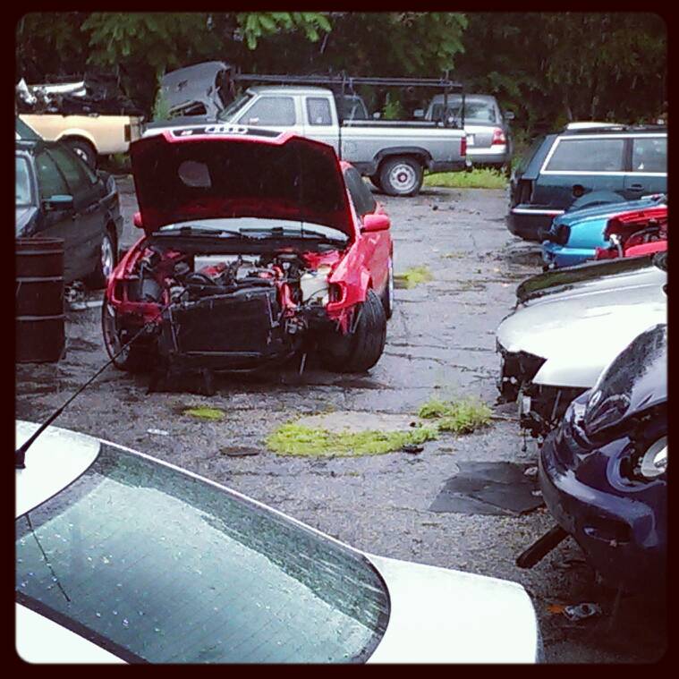

Head, intake, downpipe all unbolted ... Just need to pull it off then came the rain delay...

Looks like you wont be running a cam sensor..what trigger setup will you use?
95 Audi S6, VEMS, BW S362
00 Volvo S70 T5M
da_trem wrote:Looks like you wont be running a cam sensor..what trigger setup will you use?
Actually I will... I just threw the 7a cam gear to time it up against the valve cover...

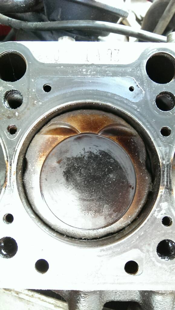

Cylinder 4
HEY THAT LOOKS LIKE DET, JUMP ON THE DET TRAIN WOO WOOOOOOOOOOOO
Or did the hg fail through cylinders? Can't see shit on my phone.
Sent from my Nexus 4 using Tapatalk 4 Beta
That is some bad detonation. Whatever you do, don't run that same tune on the new motor.
What do the rest of the cylinders look like?
ouch! I bet that t04e was scooting around.
