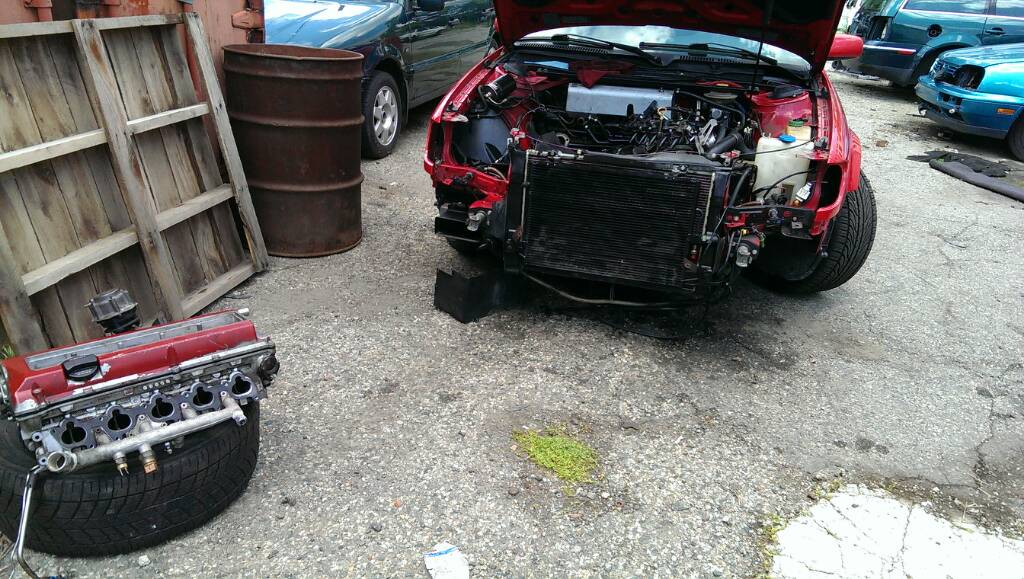

Original engine is coming out by hand, on the floor, bits and pieces being cleaned up and placed on the built motor on the stand. Seeing as I don't have all the hardware in yet to mount the turbo, I'll be pulling the head off this to inspect it's failure. So this motor should be out by tomorrow... I can then degrease and tidy the bay up for the built motor. If I get antsy, I might just throw the old t04e back on & break it in on the dyno, seeing as "recent" t04e numbers have sort of been requested for comparison sake and mainly just for my own...
I doubt that will happen as I wanna take advantage of an empty bay to figure out/route my meth kit & my oil cooler kit. Oh and that reminds me, have you been able to get a quick pic of that passenger side motor mount? I can possibly use those Mustang Motor mounts too, if I get my Summit order...
I have plenty to do though like that shiny new fuel pump that's just sittin there, though I'd like to leave that for after the motor runs. I wouldn't wanna introduce too many variables if a non start condition arises...

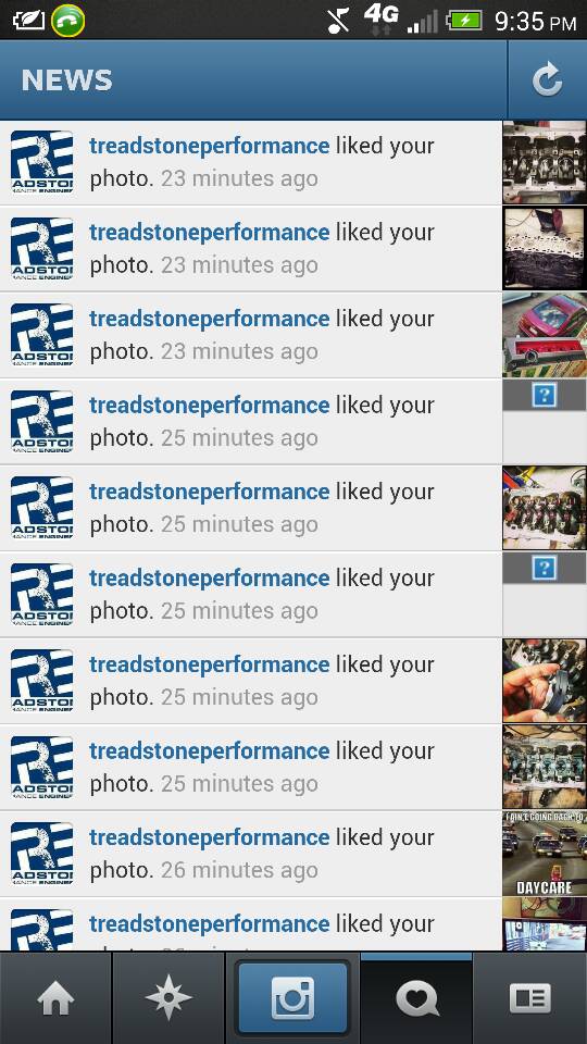

Someone at Treadstone has definitely taken notice of Rubi's build on my instagram... Pretty cool I guess...

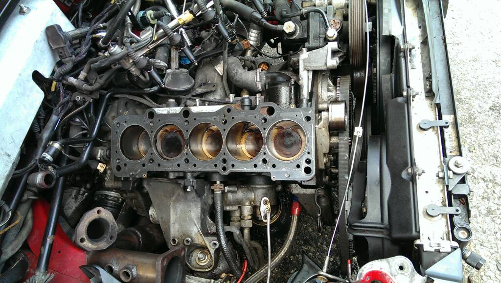

Head, intake, downpipe all unbolted ... Just need to pull it off then came the rain delay...

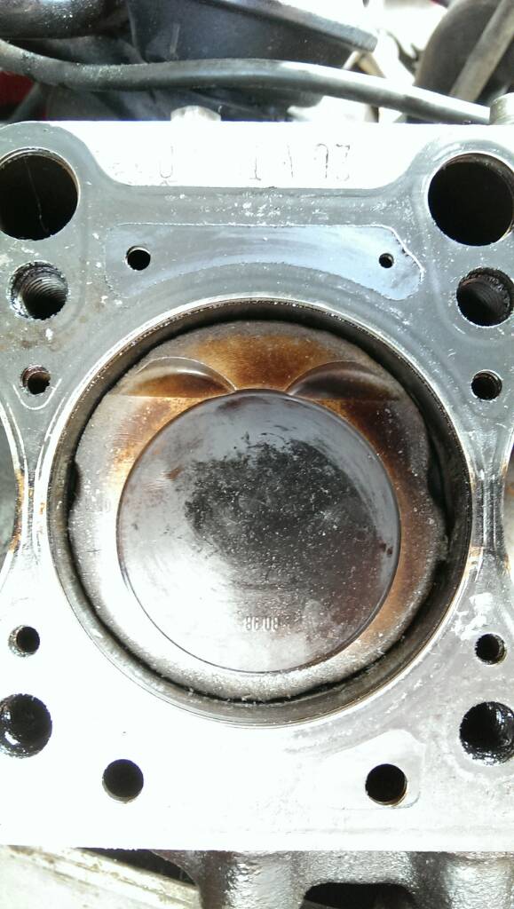

Cylinder 4
Posted: Wed Jun 19, 2013 11:47 am
HEY THAT LOOKS LIKE DET, JUMP ON THE DET TRAIN WOO WOOOOOOOOOOOO
Or did the hg fail through cylinders? Can't see shit on my phone.
Sent from my Nexus 4 using Tapatalk 4 Beta
Posted: Wed Jun 19, 2013 12:06 pm
by EDIGREG
That is some bad detonation. Whatever you do, don't run that same tune on the new motor.
What do the rest of the cylinders look like?
Posted: Wed Jun 19, 2013 12:38 pm
by Hank
ouch! I bet that t04e was scooting around.
