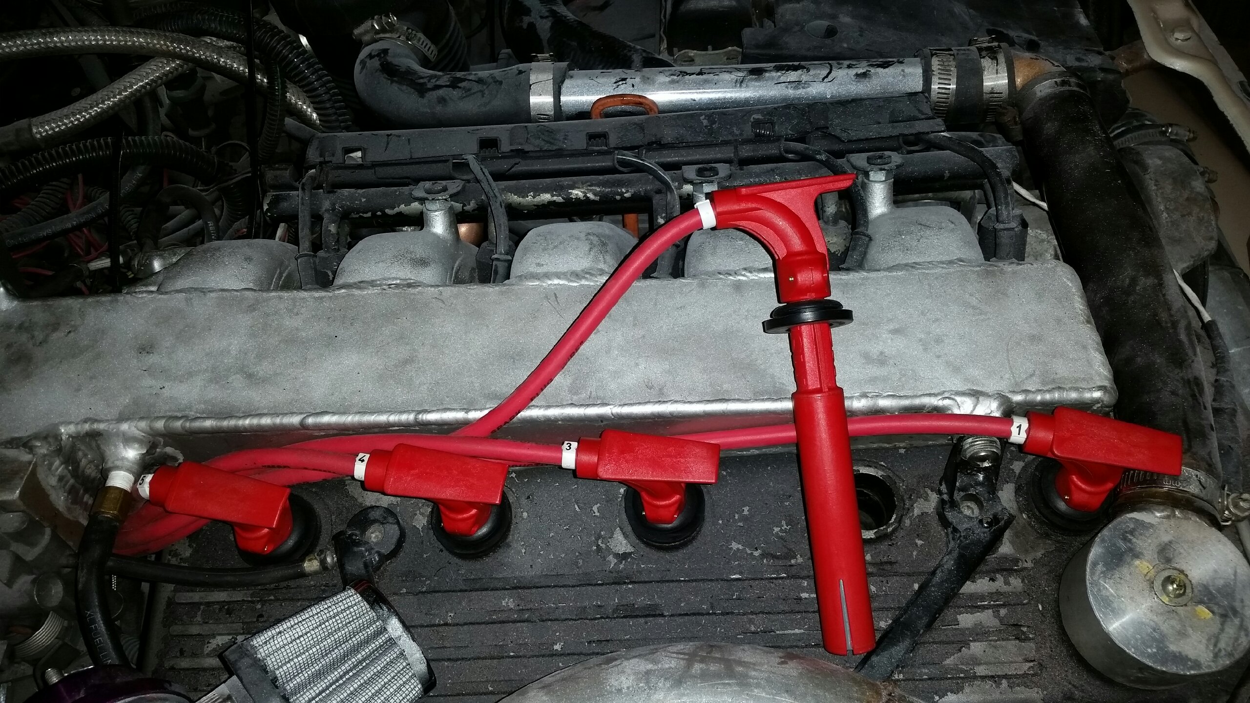

msd hemi wire kit plus five autozone 5/8" pcv grommets for dust covers.

Re: MSD universal hemi wires....nice red ones
That looks great

pkw wrote:msd hemi wire kit plus five autozone 5/8" pcv grommets for dust covers.
Awesome thread, nice work all around.
Any specific information on this? Ie, part number haha!
msd #31539
autozone pcv grommet #42066 to use as a dust cap x 5
summit racing's pic is incorrect but it gives you an idea.
wires come with hei ends and they worked fine for my 034 dis coils

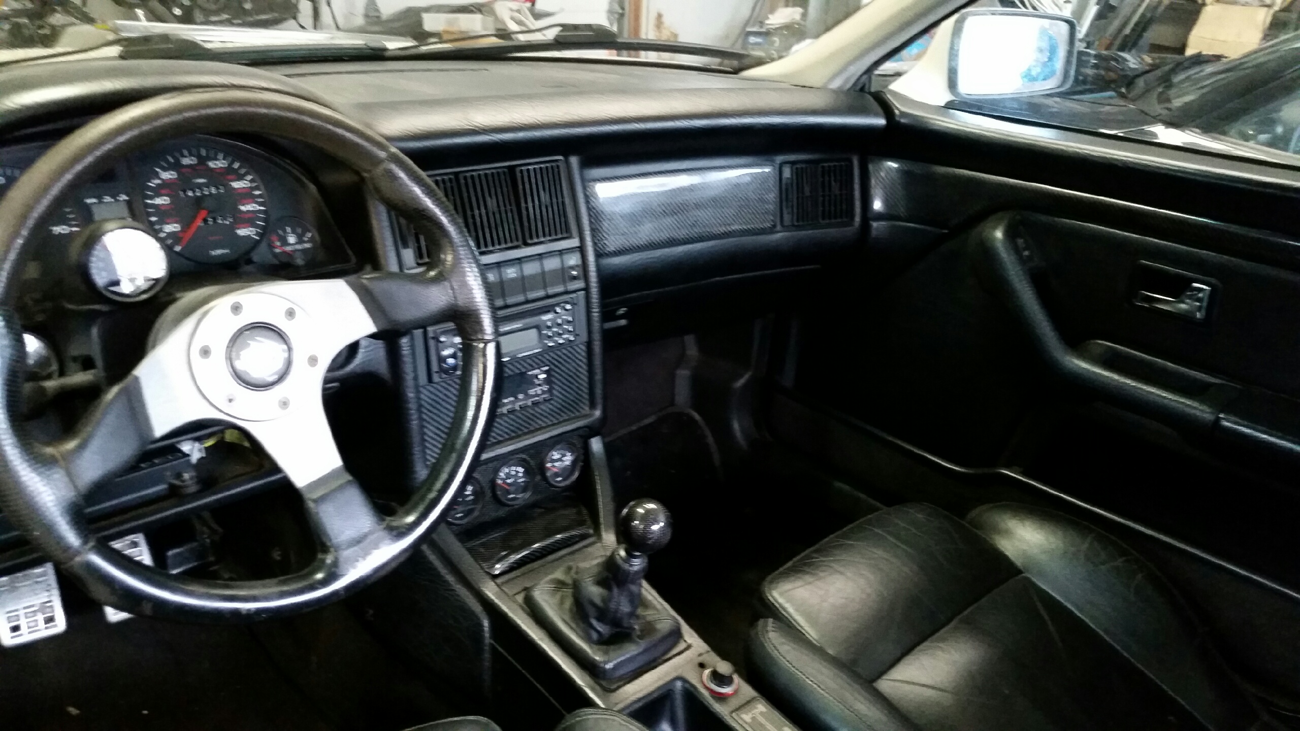

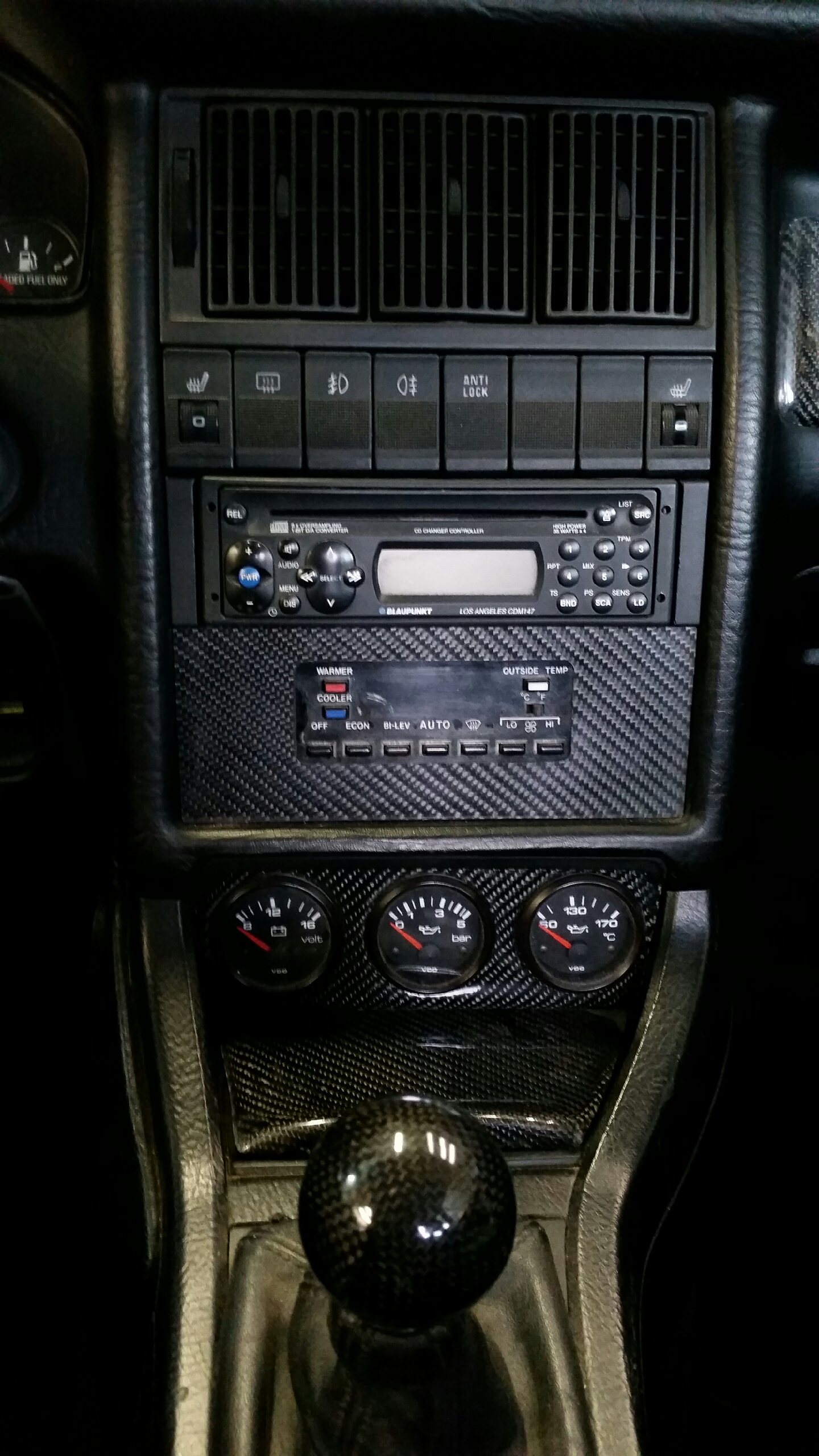

Re: black interiors matter!
- 20160424_145411.jpeg (890.83 KiB) Viewed 51039 times
- 20160424_145009.jpeg (905.75 KiB) Viewed 51039 times

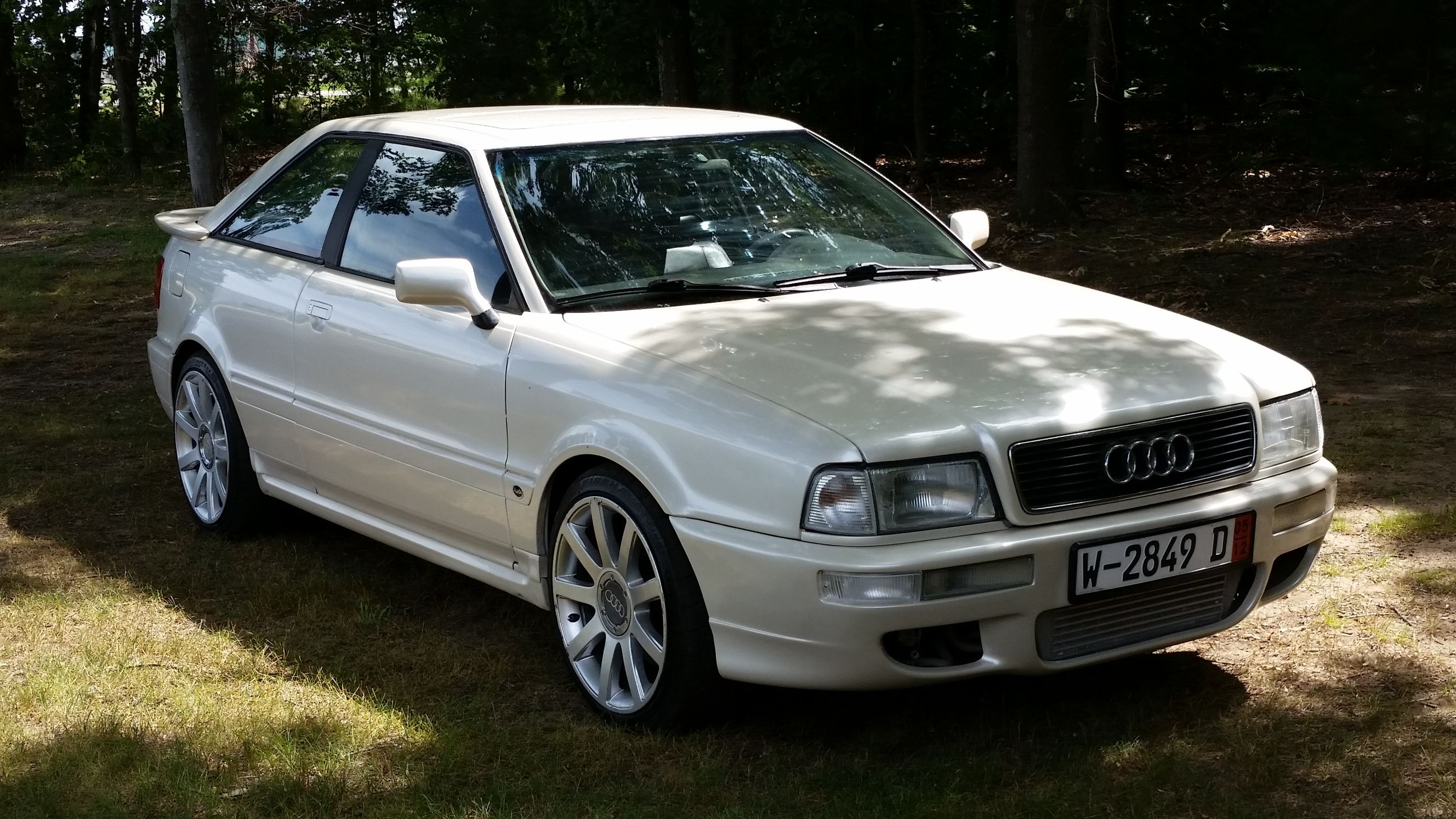

Re: Done ish. pics
proper s2 offset for 5 lug swap at all four corners.
01e 6spd.
01e 6spd.
- half20160710_121050.jpg (647.13 KiB) Viewed 50766 times

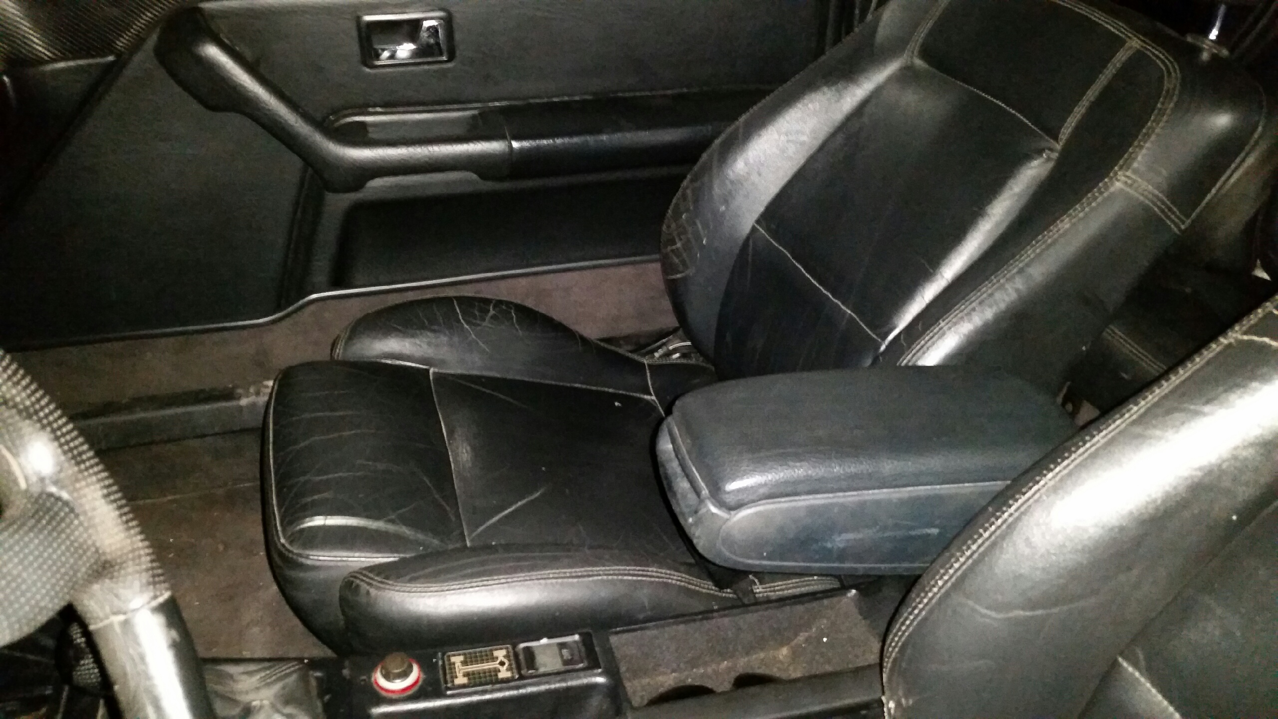

Re: CQ is done ish. pics
Installed an armrest today because I love to lean my right arm on something during long drives. Works well.
- 20160724_224026.jpeg (991.15 KiB) Viewed 50657 times
